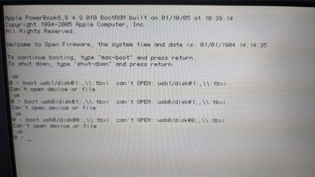

I tried, no success.

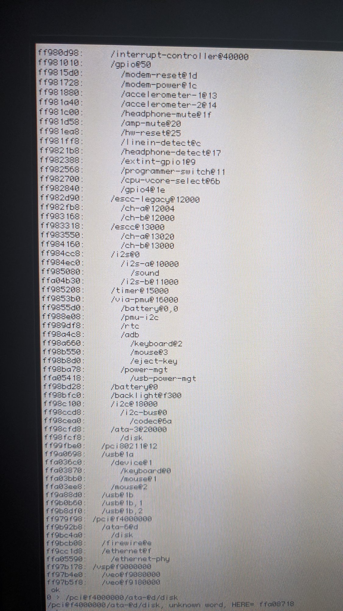

I tried:
Command ⌘+Option+O+F dev / ls, no USB disk on the list.
boot usb1/disk@1:,\\:tbxi, the same.

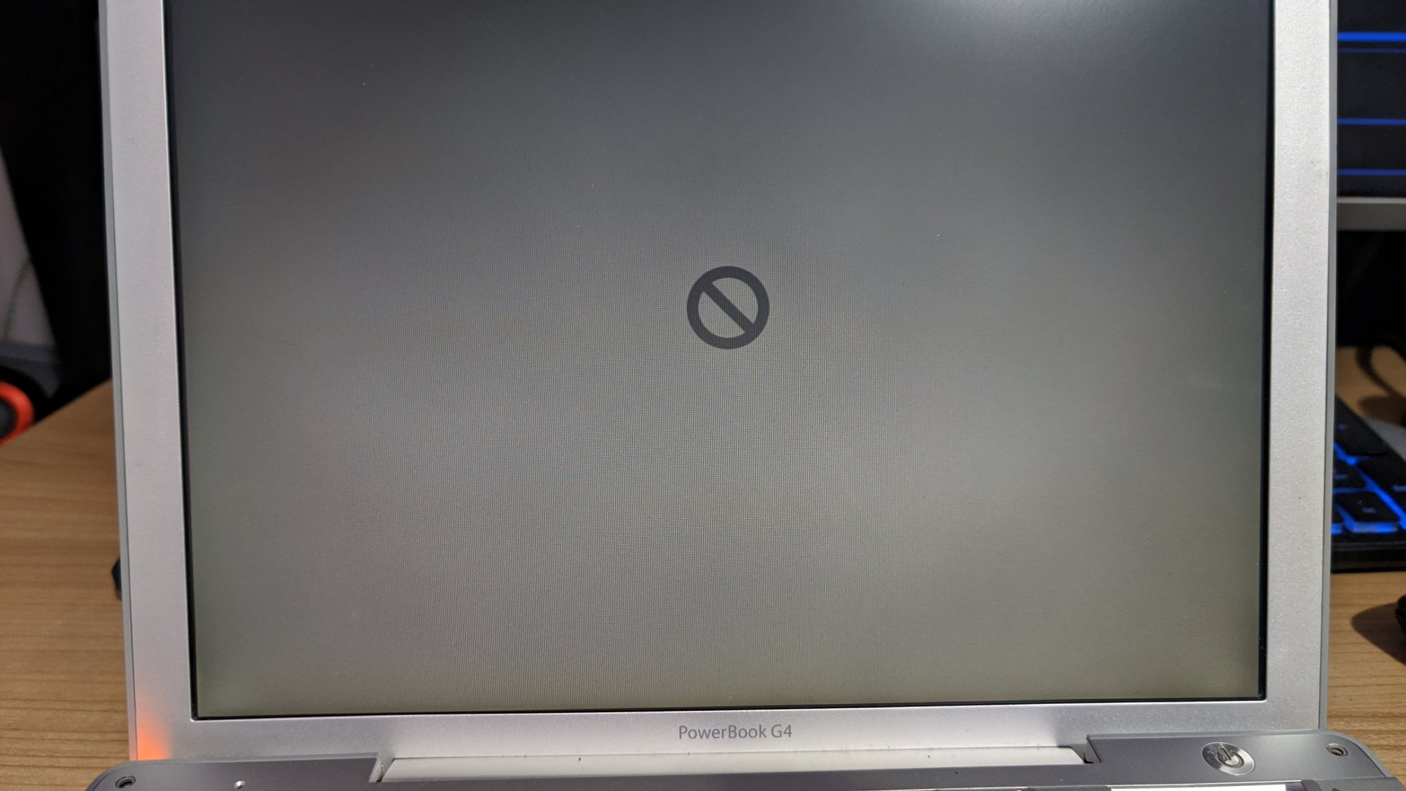

Seems that boot usb3/disk@1:,\\:tbxi is doing something but i receive just the restricted logo.
