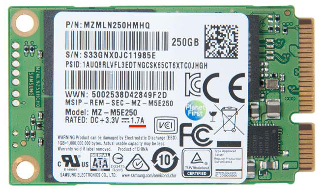

This is what I suspected. Have you ever paid attention to mSATA drive's current consumption?
The worst original mechanical HDD drive in PowerBooks that I have seen was spec'ed at 1A (the rest ~0,45-0,7A)
250GB 850 EVO draws 1,7A. Larger drives - 500GB and 1TB will draw even more..
You say your 12"-er runs hot? šŸ˜‰

That's interesting. While I don't have an SSD in my Twelve (it still has its original 100GB spinner), I did check this up on both the Companion and Old Companion and
LITEON LMH-512V2M-11 512GB - 0.95A
SAMSUNG SSD SM841N 128GB - 0.65A
So I guess here's a few SSDs that you could use in your Twelve that may reduce the heat issue.

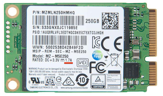

SM841N is good, I have one. LiteOn is probably ok on Delock adapter, but is already too much for white box chinese adapters. Those have voltage regulator with only 1A capability @25ĀŗC (less at elevated temperatures) and internal overcurrent protection. JMicron controller alone draws ~0,13A. That leaves 0,87A for the drive, or, to be on a safe side ~0,8A.
Any extra current drawn by the drive also means extra heat generated by the voltage regulator. Most of the heat is dissipated into air inside the 12"-er case and that warm air is pulled across the heatsink by the fan to cool down the G4 processor.
I bet the original rotating HDD had different thermal profile than mSATA/adapter combos.
