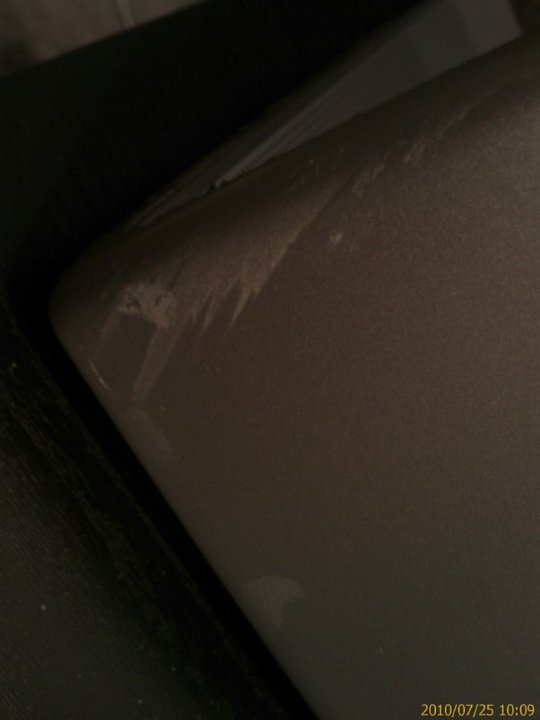

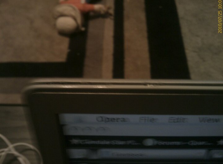

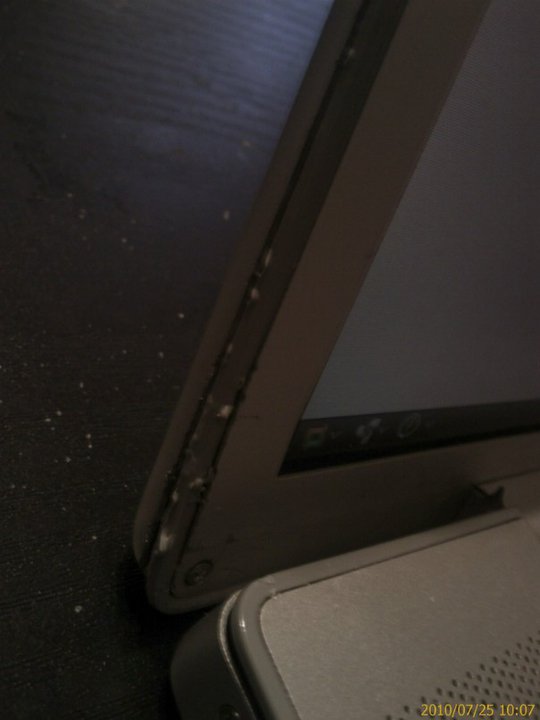

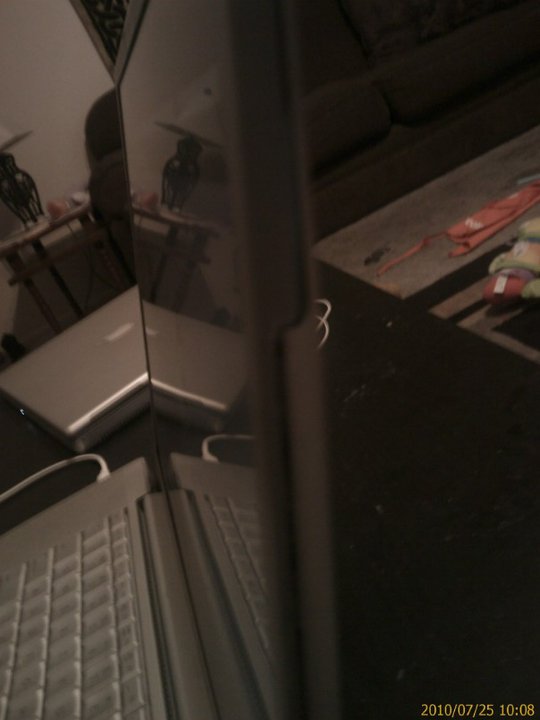

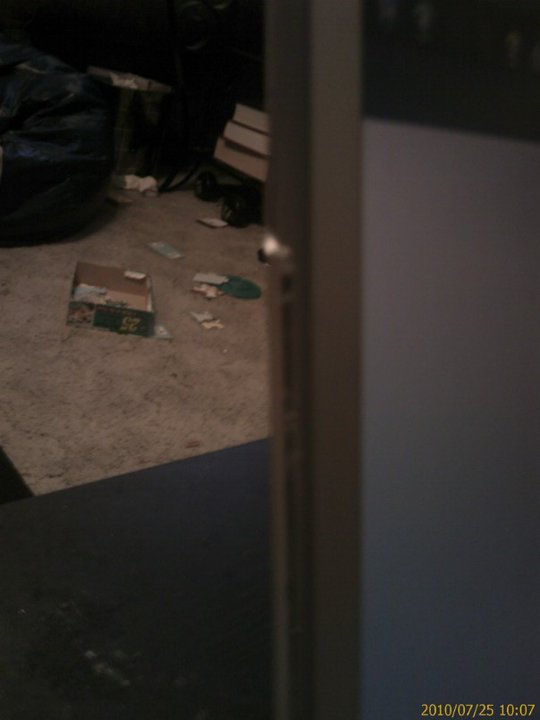

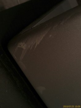

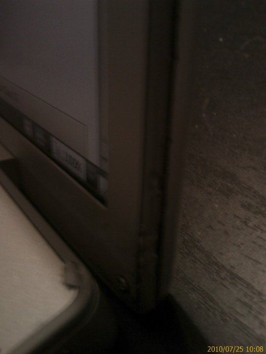

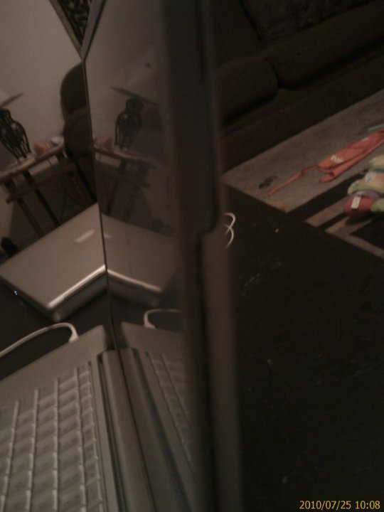

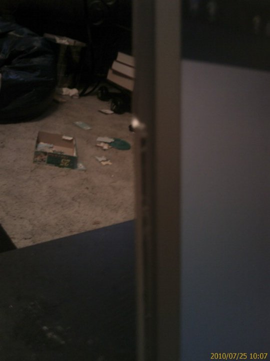

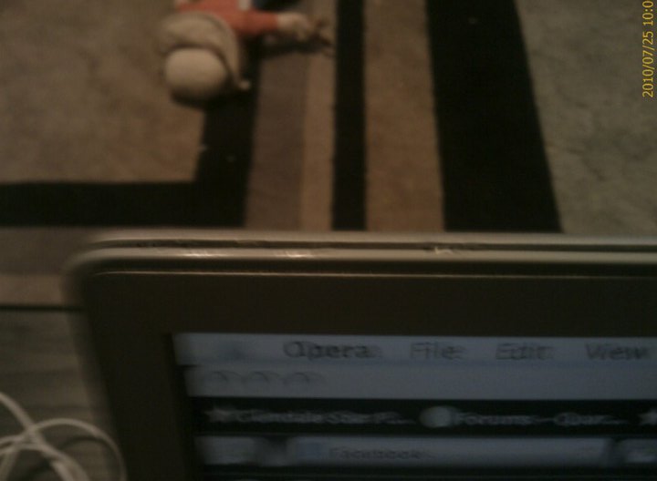

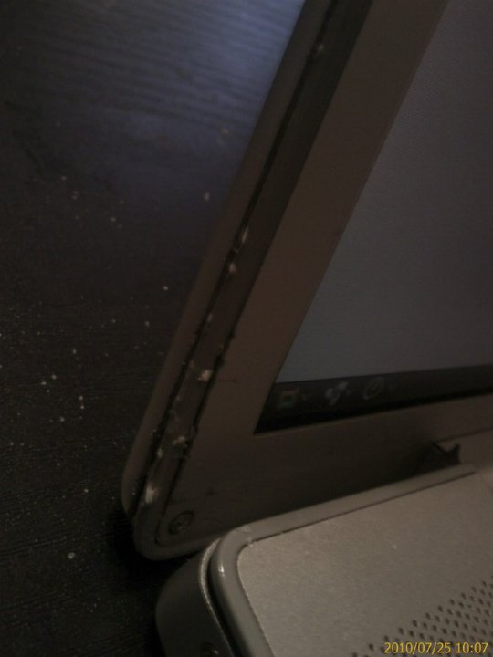

35227_145825402101154_7460065_n.jpg 37909_145825582101136_7918012_n.jpg 38095_145825525434475_1573356_n.jpg 38396_145825488767812_2251896_n.jpg 39240_145825358767825_4569847_n.jpg 39345_145825545434473_3117306_n.jpg
I cut the crap out of my thumb on that stupid G4 display when I took it apart... Theres still blood on the lid lol
This is why I strongly advise replacing the entire LCD as a unit, versus trying to replace the damn LVDS cable or a screen.
Lots of tiny, tiny hooks on thin aluminum (aluminium for you guys in the UK) strips. Damn near impossible to get the lid back on and you end up bleeding everywhere.
View attachment 571352 View attachment 571353 View attachment 571354 View attachment 571355 View attachment 571356 View attachment 571357

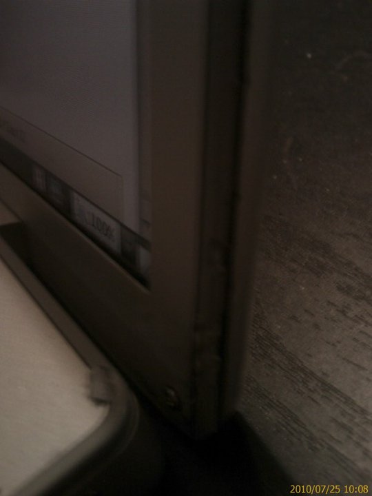

That's exactly what's going on here. I might have to resort to a new display, but I'll try anyway.
Sorry man. My pathetic attempt to get the screen lid back on used more super glue than anything else. And the problem was that damn, rough and ugly gap which could also be a safety hazard if something got in there through the gap.
I sucked it up and shilled out $80 for a new screen in 2010. I still have that screen and it's the most beautiful one I've had with my 17" Macs so far.
However, I wasn't willing to transplant it into my pristine new A1013 when it already had a perfectly good display.
PS. Is the hassle really worth the cost? I paid $25 for a working display for my wife's 12" PB. Still working. If you look you can find something in that price range, either a complete LCD or a dead 12" PB that you can strip extra parts from.
