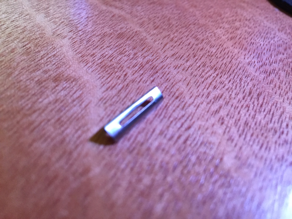

@Intell Ok two questions then. Where do these clips fit in?

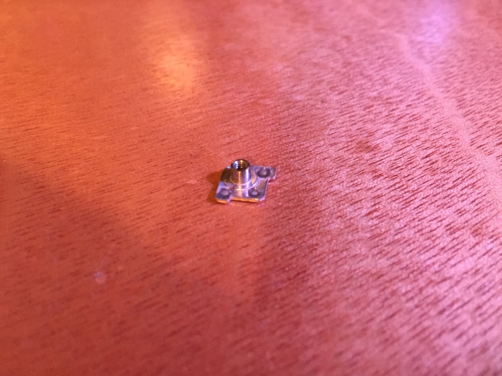

Second, what about this:
I see where it went but I don't see how it goes on
The rounded screw thing goes into the lower corners. Align the three spot welds and then affix them back onto the back cover. The other clip appears to be a retaining clip for either the top or bottom.

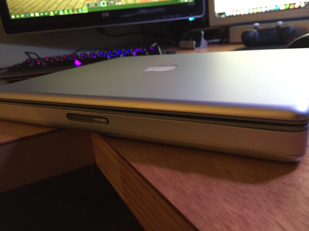

Finally, pics! That's the new back on.

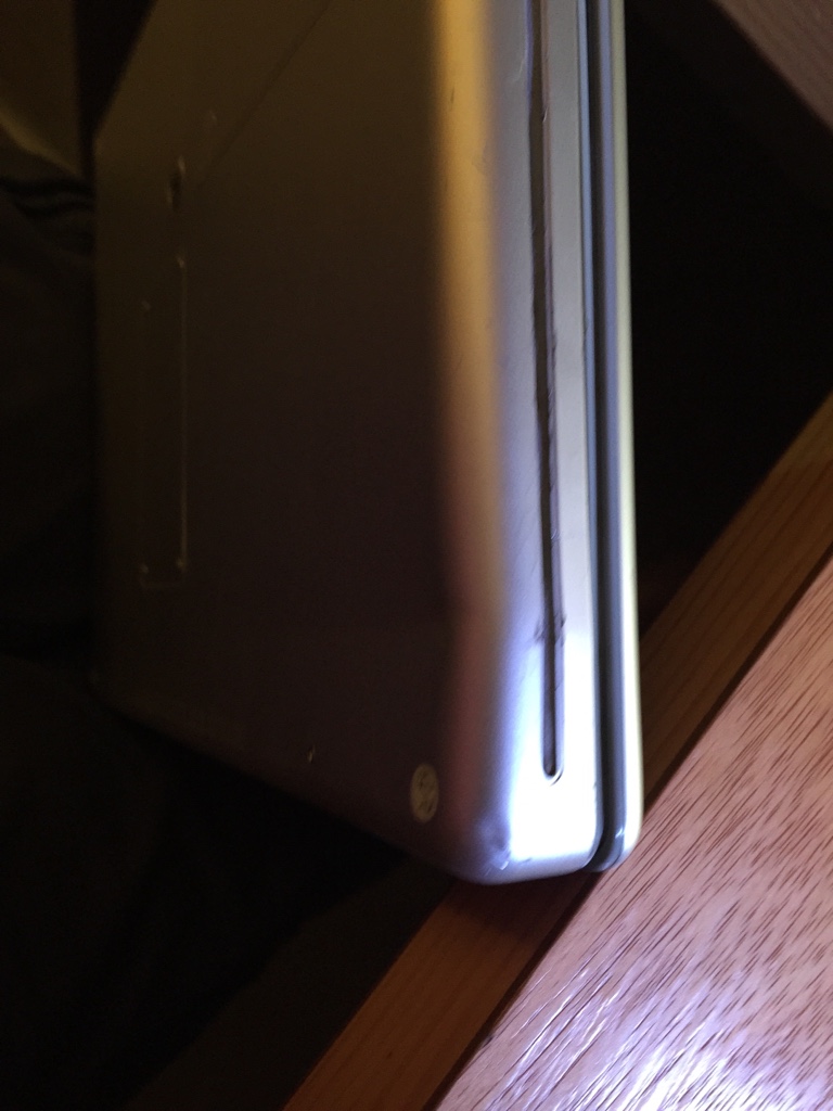

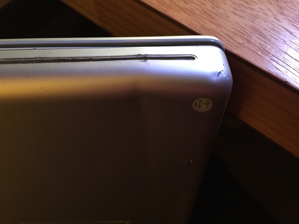

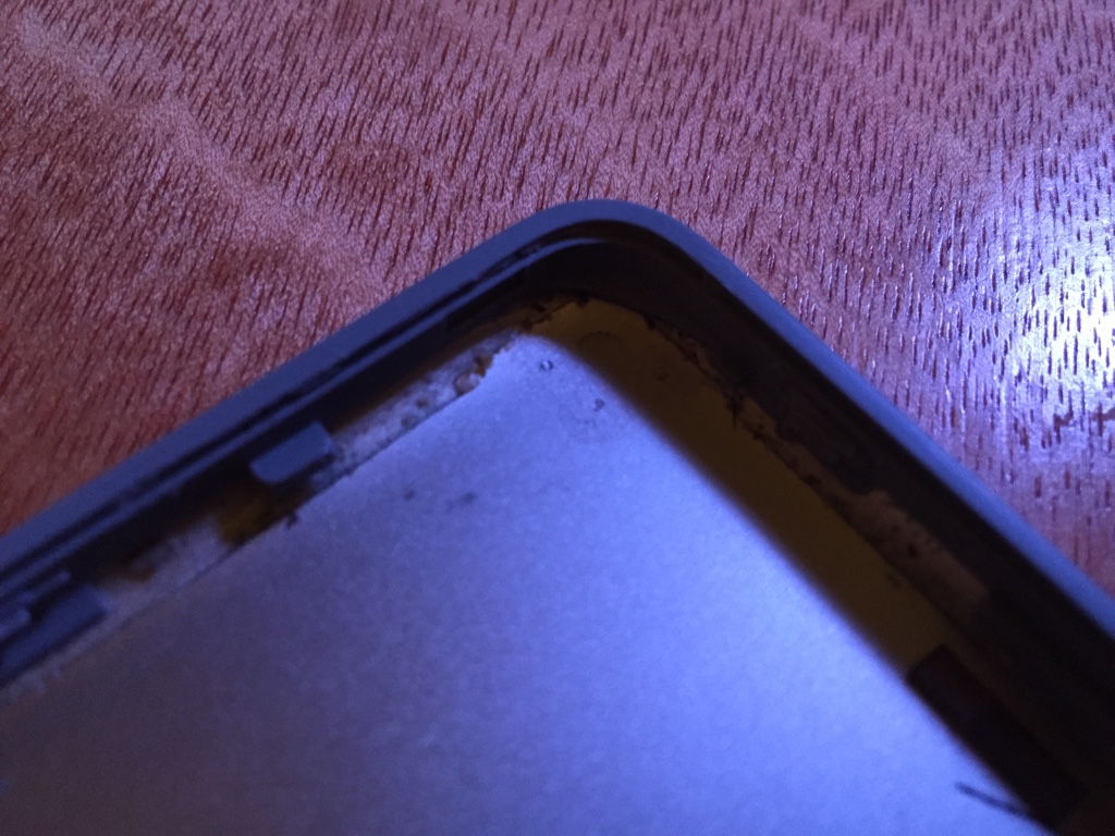

Here is a snap of the worst bend in the case.
So bad.

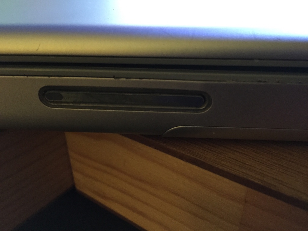

I also need to clean it.
If you plan on replacing the bottom case then go ahead and clean the power button, but if you don't plan on replacing it, don't clean it! I mad this mistake with mine and am currently using tape to hold it in place
Yes, its 100% getting replaced. I am on a hold list from PBM. I wont take it apart, I'll end up using Q-tips and toothpicks with isopropyl alcohol.
That dent can be pounded out. But you'll need to remove the logicboard to get to it.
That however, is pretty involved.
Yeah, the problem is its really warped. The corners are toast too.
Considering a new bottom pan is $3.75, I might just wait a bit.
The latch will shoot back due to the spring things that allow the latch to come back out after being pressed
That's a pretty nice PowerBook! The new lid looks beautiful as well. All you need is the new bottom pan and it will look brand new! Nice job, Keaton.
