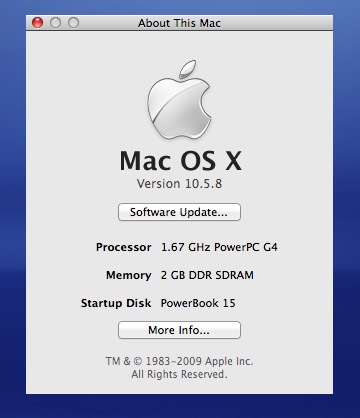

Sorry to hear about your problem,
I'm one of the lucky ones it seems, my 15" PB is quite happy to use the full 2GB.
Reactions: bobesch
Oh ho, thanks a lot encouraging me about the good in PowerBooks ...

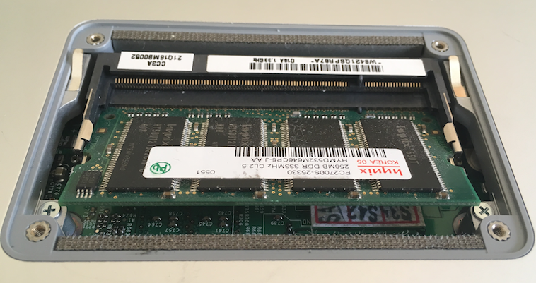

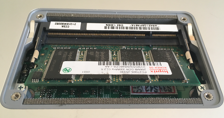

Old thread, I know, but I thought I'll add another piece to the puzzle.
In my (very frustrating) trip back to portable G4 land I bought 1.33GHz PowerBook G4 5,4 aka A1095 and, surprise surprise, it also has "dead" lower RAM slot.
While experimenting with various RAM sticks, I discovered that, if I put the stick in the lower slot, but do not push it all the way down to latch it, the machine recognizes it and boots normally!
So, my conclusion is that this is a problem of mechanical nature!
What exactly, I don't know. It might be that ram stick pads lose contact with connector, when pushed all the way down. It also might be that the strain on the ram connector disengages some of its contacts from the PCB. Those of you who have the loose motherboard could take a closer look.
If someone wants to repeat my experiment, be warned that you might damage your PowerBook. Do it at your own risk. 😉
