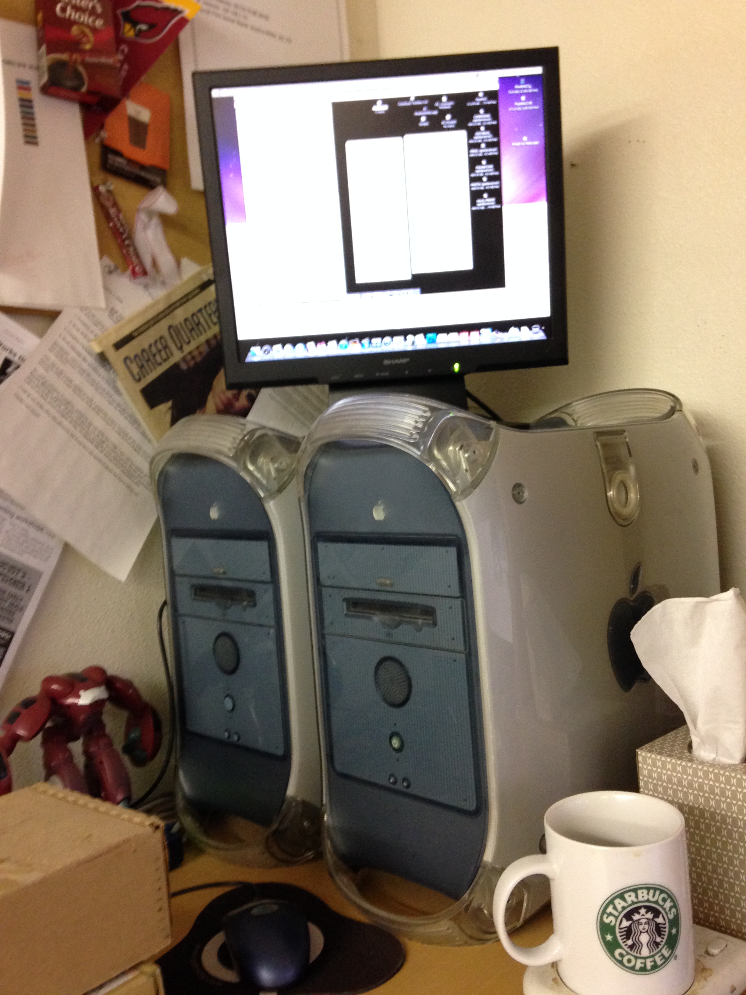

Adam, I ran Leopard for years on my TiBook/400. 1GB ram, 2001 vintage. Other than LeopardAssist you can also just install via TDM on a Mac that can run Leopard, or swap drives.
It's running right now on a G4/450 AGP at work with 192mb ram at the moment too. 😉
Leopard on 192 MB RAM, are you serious? How well does it run?
Originally, it had 1.75GB ram and I installed Leopard using TDM. My coworker used that Mac from Sept. 2008 to about mid-2013 when she got the G5.
Only then did I pull most of the ram for other purposes. Since Leopard was already installed I just left it. It does nothing harder all day then function as a print server for the Mac Pro so the MP can print to our Appletalk printers as well as running Chicken of the VNC so I can see the desktop of the G4/400 sitting right next to it running Tiger (that Mac is headless (no video card)).
Ocasionally I will use it for some specific purpose (such as breaking locked/encrypted PDFs so I can edit them) or saving out a lower version of PDF with Acrobat 6.
It functions very well in this roll. In fact, I think in the last two years or so I've only restarted it maybe a total of 3 times.

Ordinarily, I'd agree with you. However, the main function of this Mac is as a print server so the Mac Pro can print to Appletalk printers.
It doesn't need a whole lot of ram to do that.
