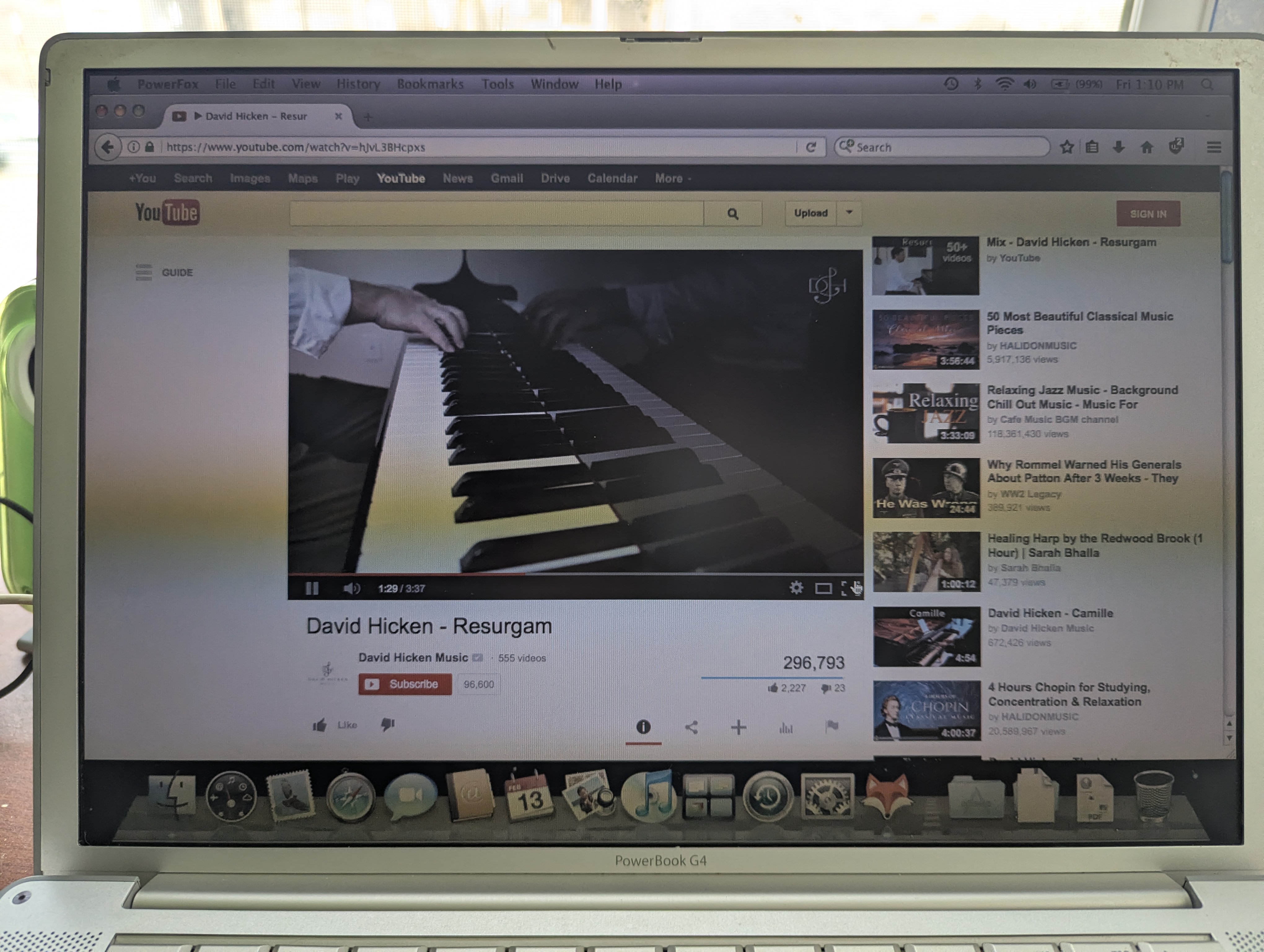

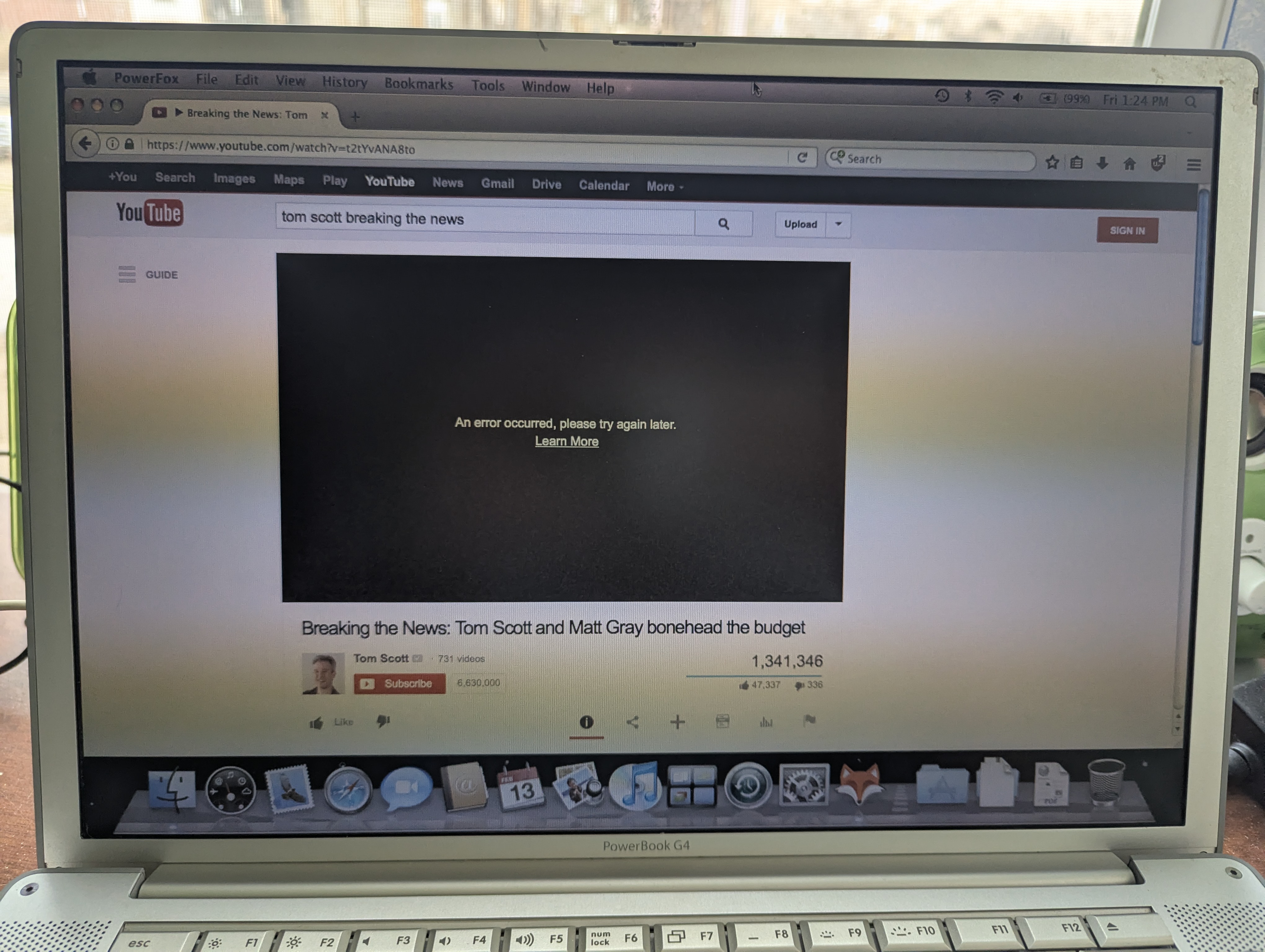

It's absolutely incredible to see embedded youtube videos playing at 360p with no slowdown whatsoever on a 1.67GHz DLSD PowerBook G4. Using UBlock Origin + NoScript makes so many websites completely usable, this is so much better than any other firefox-based browser I have tried in the past. I cannot wait to see what performance is like once JIT works. GPU acceleration is definitely the star of the show here, CPU might be pegged loading the site + scripts, but the actual webpage is still responsive.

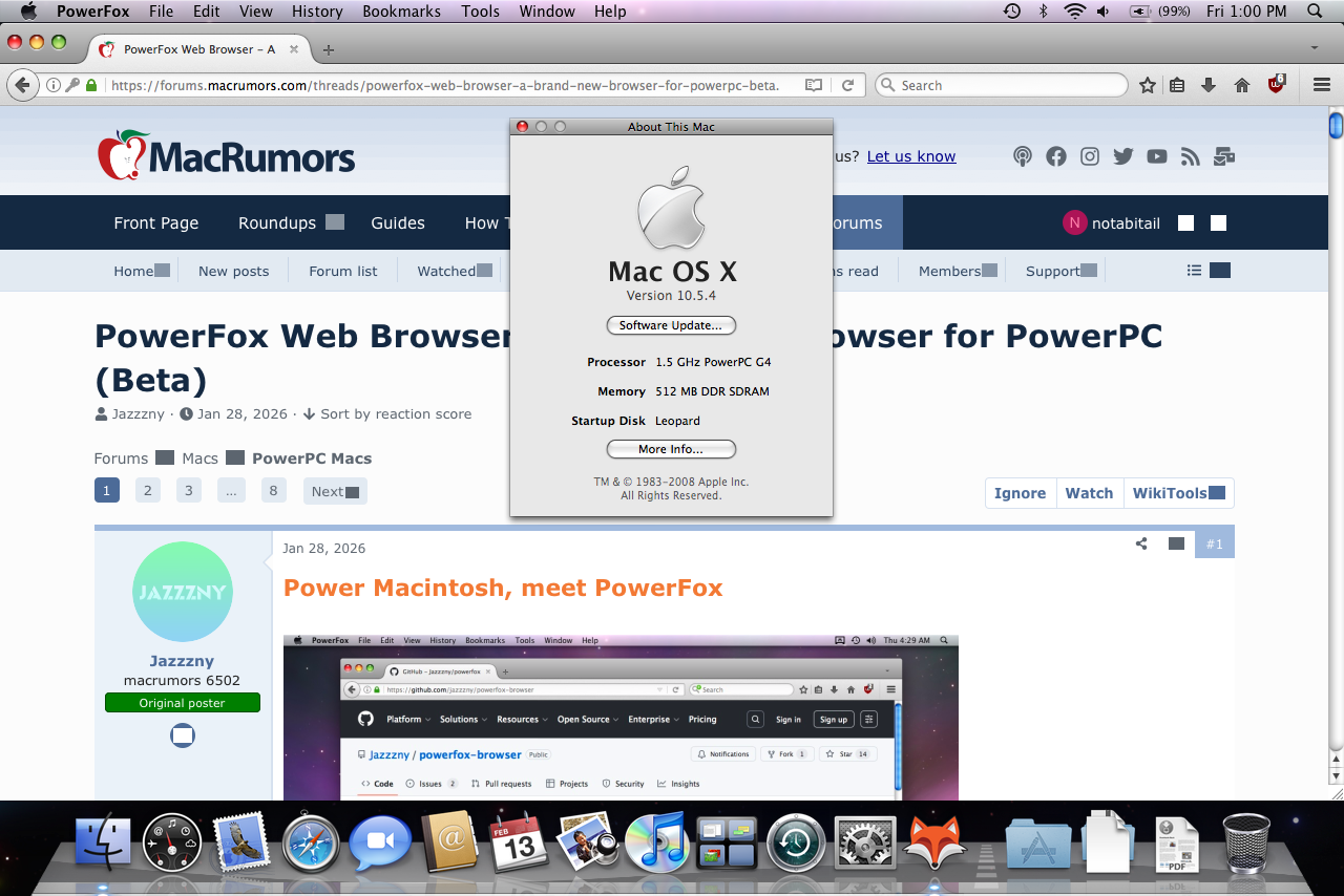

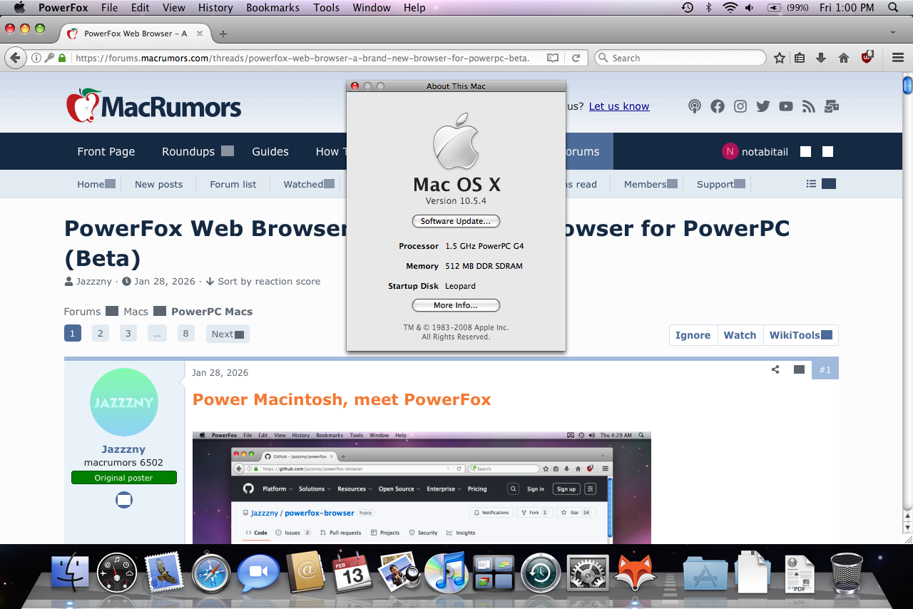

I just gave this browser a try on my PowerBook. It's slow, but I can actually browse the internet on it. I suppose having half the RAM this laptop should have makes a difference.
