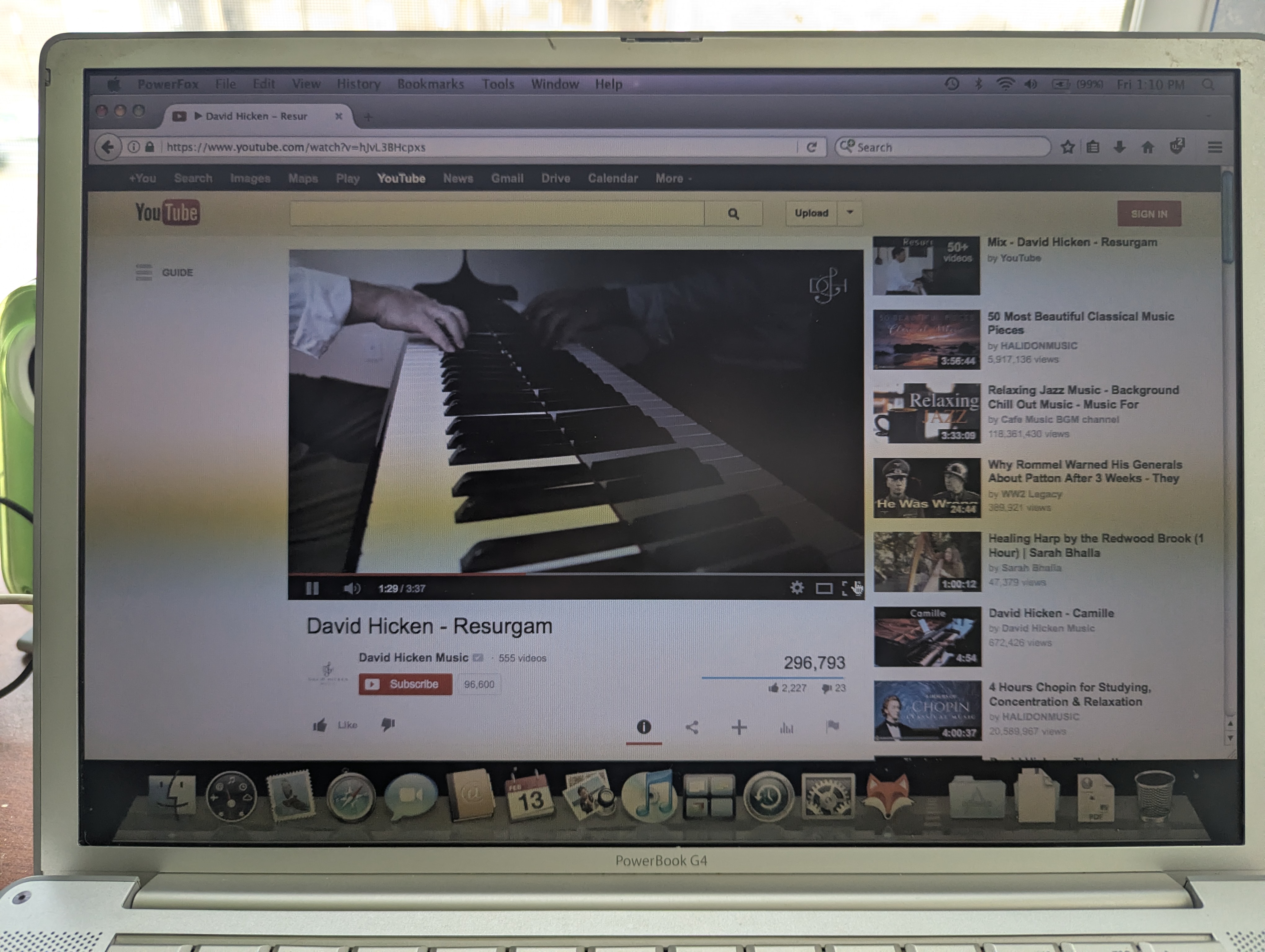

Youtube with uBlock Origin and Vorapis V3 kinda works. I was able to get a short video to play pretty smoothly in 360p:

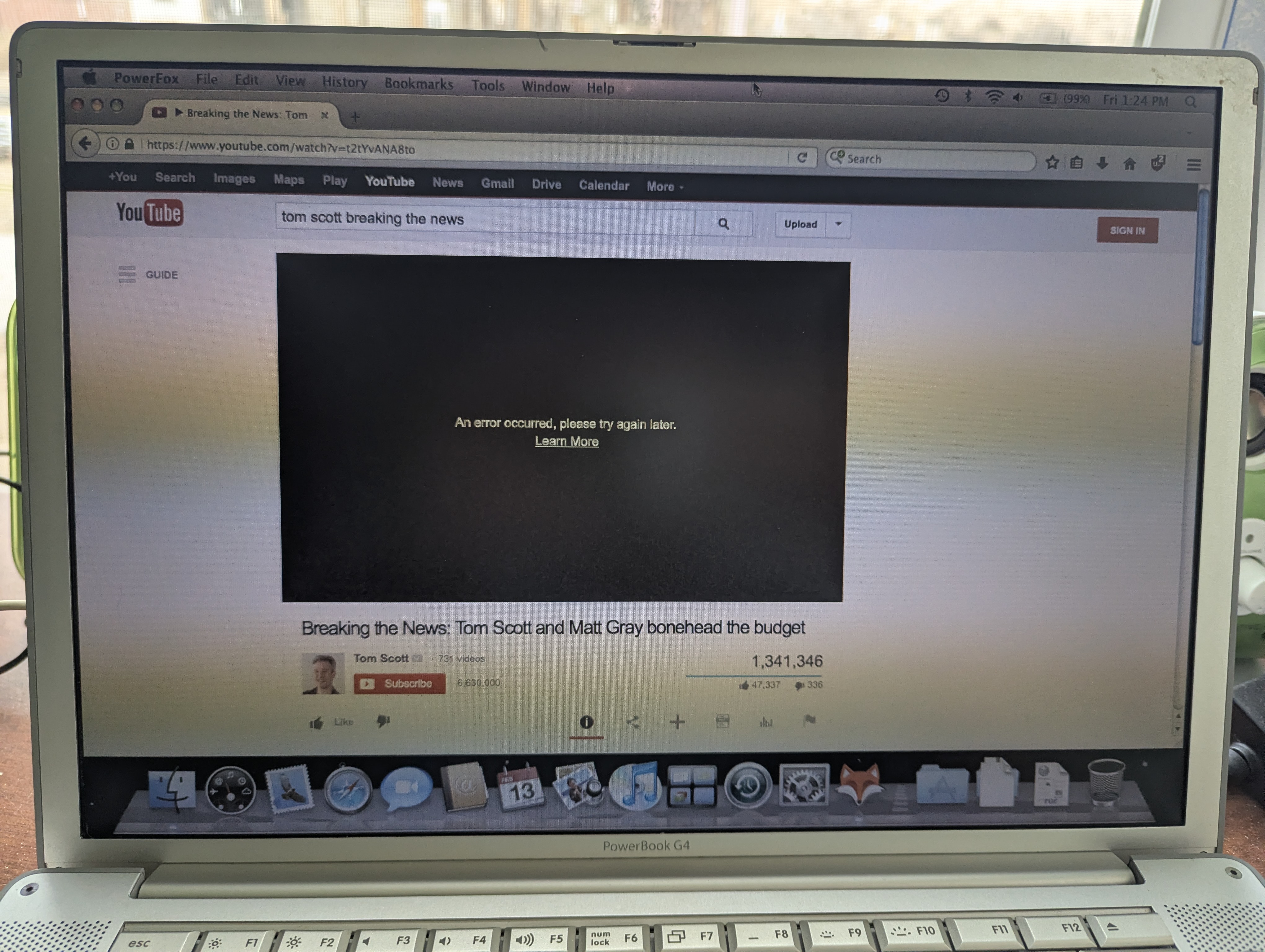

A longer video caused this to happen:
I'm pretty impressed with this. Best piece of software I've tried this year. I've never gotten this far on this laptop.
you can use h264ify and it stops that error almost completely as its just tied to trying to run VP8 and VP9 video. in the PowerFox addon manager you can install the classic Firefox addon store that has h264ify in it :3

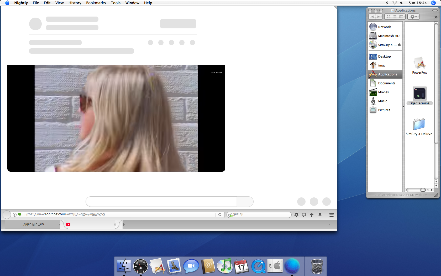

attempting a 10.4 version of powerfox. i got gpu acel working on an imac g5 and youtube vids play. got some major issues with the ui. maybe in a week or so i think i might have something half usable lol
Does this look like an endianness bug to anyone else?
Reactions: Trekintosh
It’s an issue with how CoreGraphics renders differently on 10.4, its coordinate system is flipped.
I had that happen to me too. It was extensions messing with Vorapis. Try disabling uBlock Origin for YouTube (or even completely disabled) and any other extensions, should work fine then. Also give h264ify a try, I’m able to watch 480p YT on my PowerBook using Vorapis and h264ify. It’s awesome.

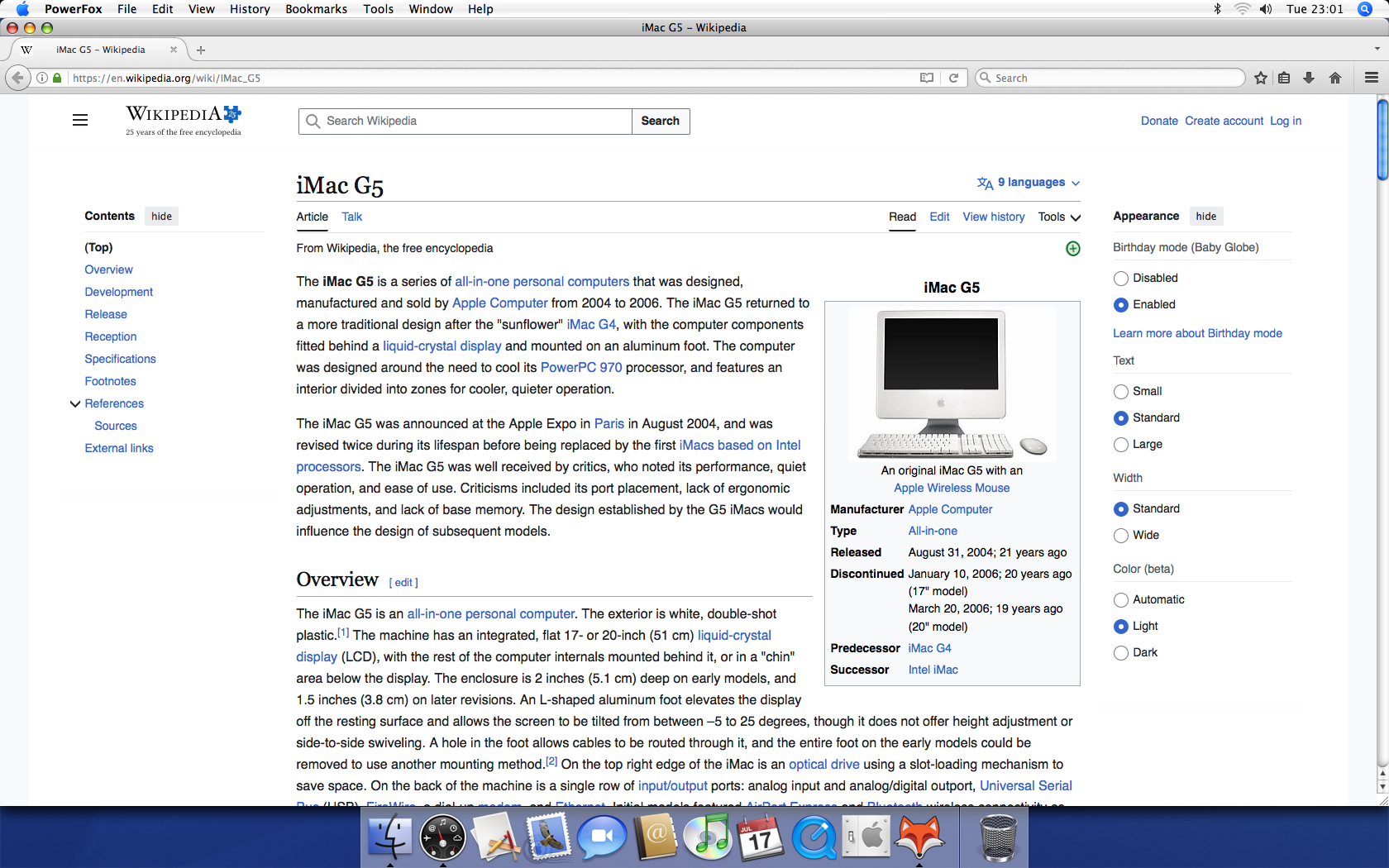

fixed the flipped pages. seems to work ok, fixed a few more bugs today. View attachment 2609728
The mere fact that we've gone from doubting the idea of PowerFox on Tiger to seeing *this* in less than a month is a real testimony to the power of a good forum with good people. I have a whole array of machines running Tiger (all the way from a G3 Clamshell to a 1.2Ghz iBook G4 to a 2.3 DC G5) so if there's a need for testing use on various devices feel free to drop a line.

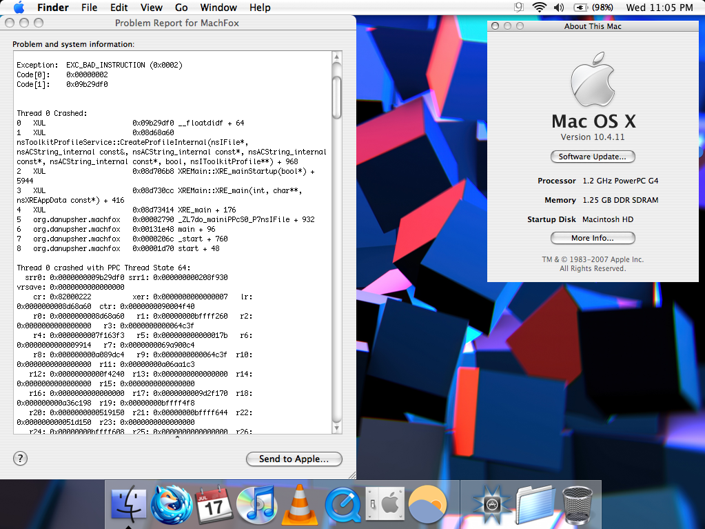

@Dronecatcher @sparty411 the G4 issue should be fixed — the binaries were tagged as G5-only (ppc_970 cpu subtype). v3.0 uses -force_cpusubtype_ALL so it should run on any PPC Mac (G3/G4/G5). let me know if it works on your machines!

Now it fails with an unexpected error occurred notification
