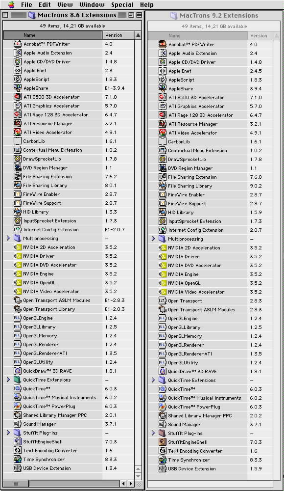

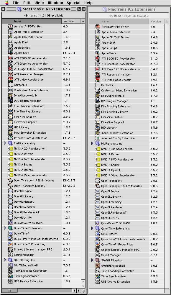

So, it is possible then that a 2002-2003 PB G4 1Ghz titanium can boot into 8.6 ? Of what advantage is 8.6 over 9.2.2 ? I never used 8.6 before and the original 350 sawtooth I bought in 2000 did NOT come with 8.6, it came with OS 9 - I checked the original serial number.
It's ever so slightly faster and uses less RAM.
According to thorough testing from MacTron from MacOS9Lives, not even that. Not sure about the RAM, but speed was greatly bumped up with 9.2.x, bringing it back to "8.6 levels", beating it or losing to it here and there in speed (more of the former than the latter, according to him). All this while retaining all the stability, extra features & other misc improvements from 9.x (9.1 in particular).
He used the same system extensions etc. whenever possible (and the most up-to-date extensions, which is very important -- OS 9.2.2 is not the same unless everything is truly maxed, AFAIK). Also same machine (Sawtooth), disk etc.:
So in short, it's very hard to justify 8.6 over 9.2.2, other than compatibility with extremely specific devices/software (the other way around is more common). But of course, the biggest reason is the novelty factor. Or to experiment with it to see what else it may offer that maybe 9 does not, if anything. (Different "About this Mac" screen?)
Most remember 8.6 fondly as fast (and stable) because OS 9 did slow down and was more broken with the 9.0.x subfamily, and also because the default OS 9 package is bigger and more loaded, which understandably would leave such an impression. In truth, you can manually remove anything extra you don't want (the original Mac OS is very modular), or add new things, and the speed results should be about the same as MacTron tested, on an equivalent setup between 8.6 and 9.2.2.
More testing is always welcome, though, of course. My knowledge could very well be incomplete, or wrong somewhere for all we know.
(Also, I see that this screenshot already answers my question I made in another thread about the Radeon 8500 in OS 8.6.)

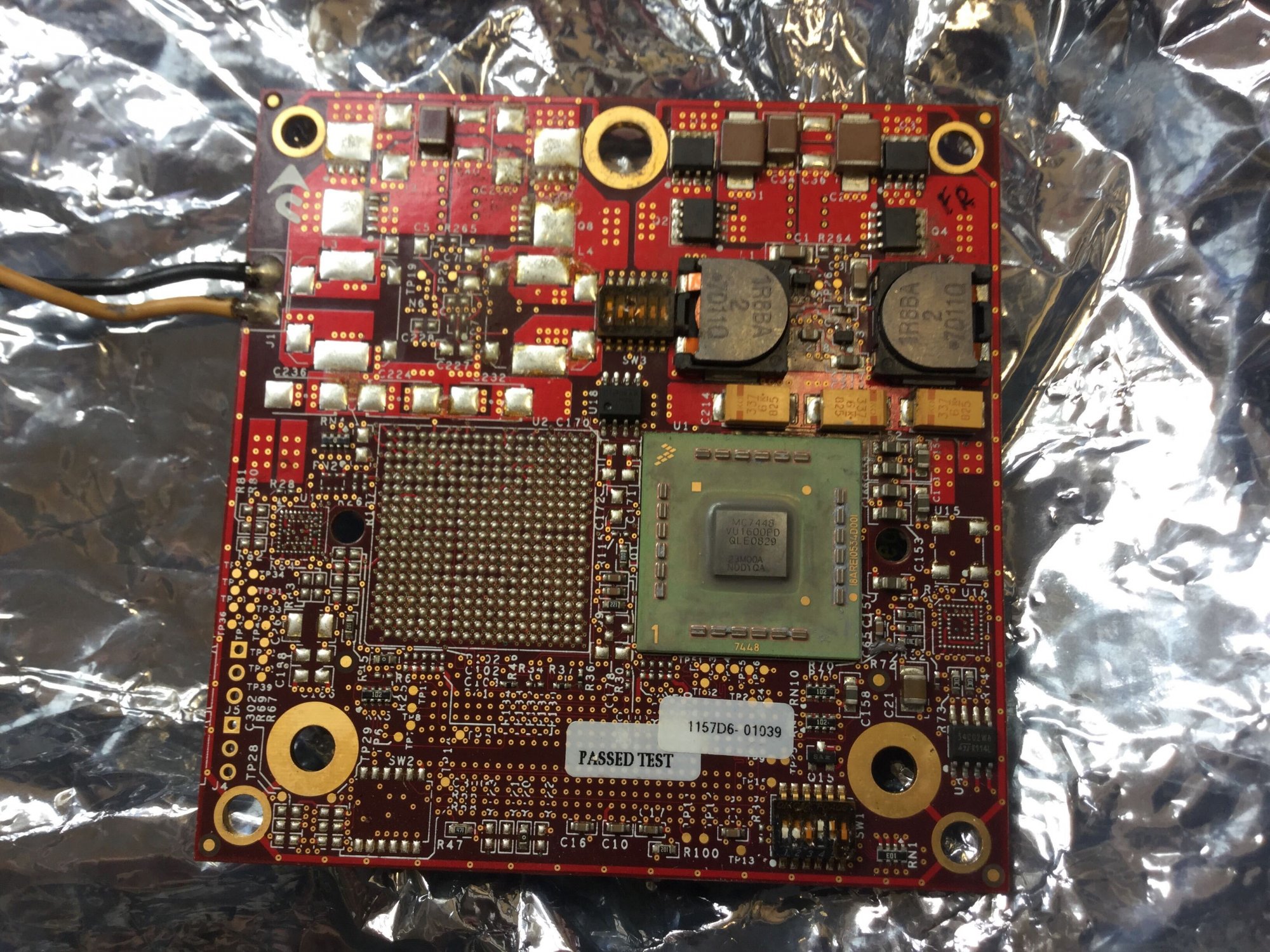

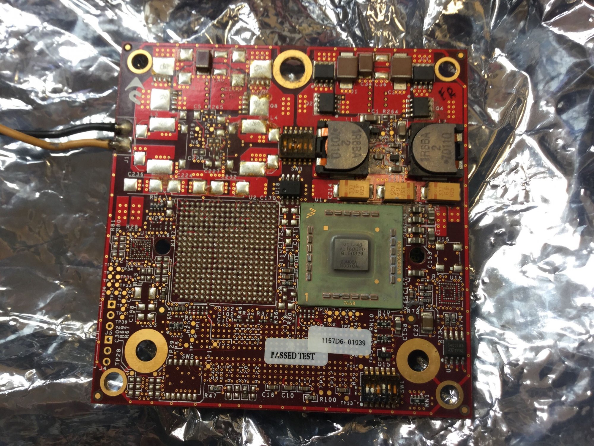

heres a picture of the CPU card, I plan to figure out the core voltage dip switches and see just how far I can clock this puppy! 🙂 the CPU itself is rated for 1600Mhz and was made on the 29th week 2008
I can't help but notice that it has pads for another processor and its accompanying passives... 🤔
The trick would be figuring out which resistors would need to be stuffed/unstuffed to enable the second processor; but, I mean, dual 7448s? How cool would that be? 😊
yeah I have looked at these cards and wondered
in theory it would be possible, but we would really need schematics and BOM to know exactly where what and how to stuff each component
(or some careful reverse engineering and comparisons with a preexisting fully populated dual CPU version of this card)
but in this particular case my Sawtooth is a Uninorth 1 Revision 3 machine, so is (sadly) incompatible with dual processor cards
but it means that this 2Ghz 7448 single CPU card is the fastest CPU I can stuff into this machine and im pleased to have been able to max it out like this
as this sawtooth was my first PowerPC Mac so im pleased to have been able to give it a few treats! I just need to get it an ATI Raden 9800 Pro 256MB Card to really max out (fastest video card that will fit)
but those generally are not very cheap these days sadly!
(no public OS X version supports the 7448 natively, while earlier OS X versions up to 10.2.8 will boot on an unknown CPU later versions wont, so PowerLogix needed an NVRAM script to get those later OS X versions booting)
