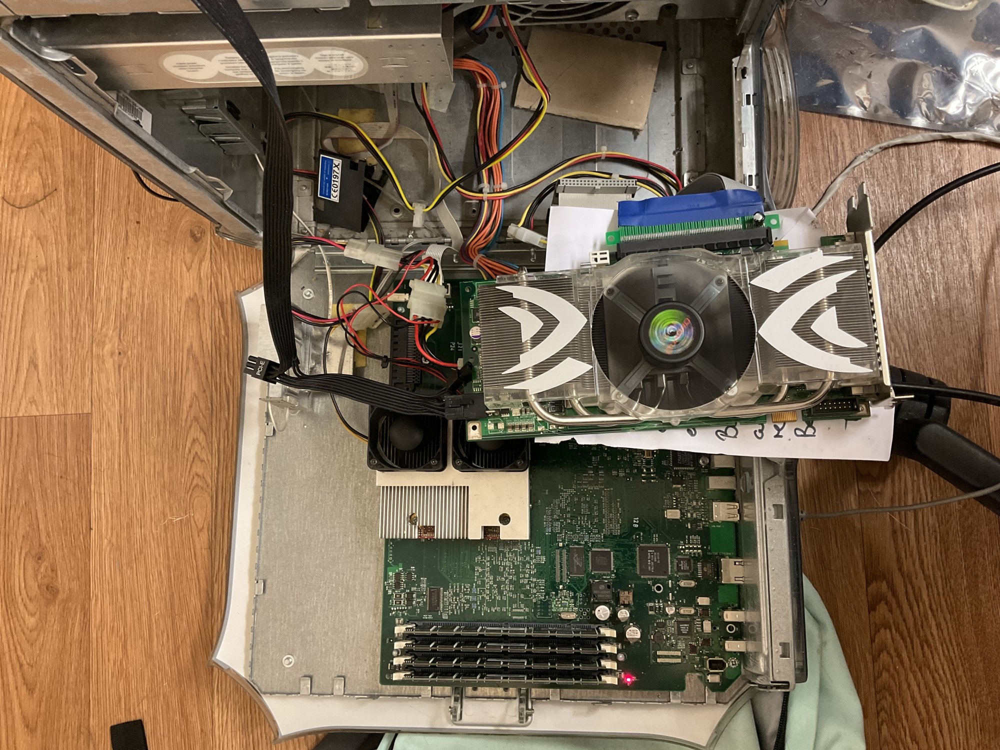

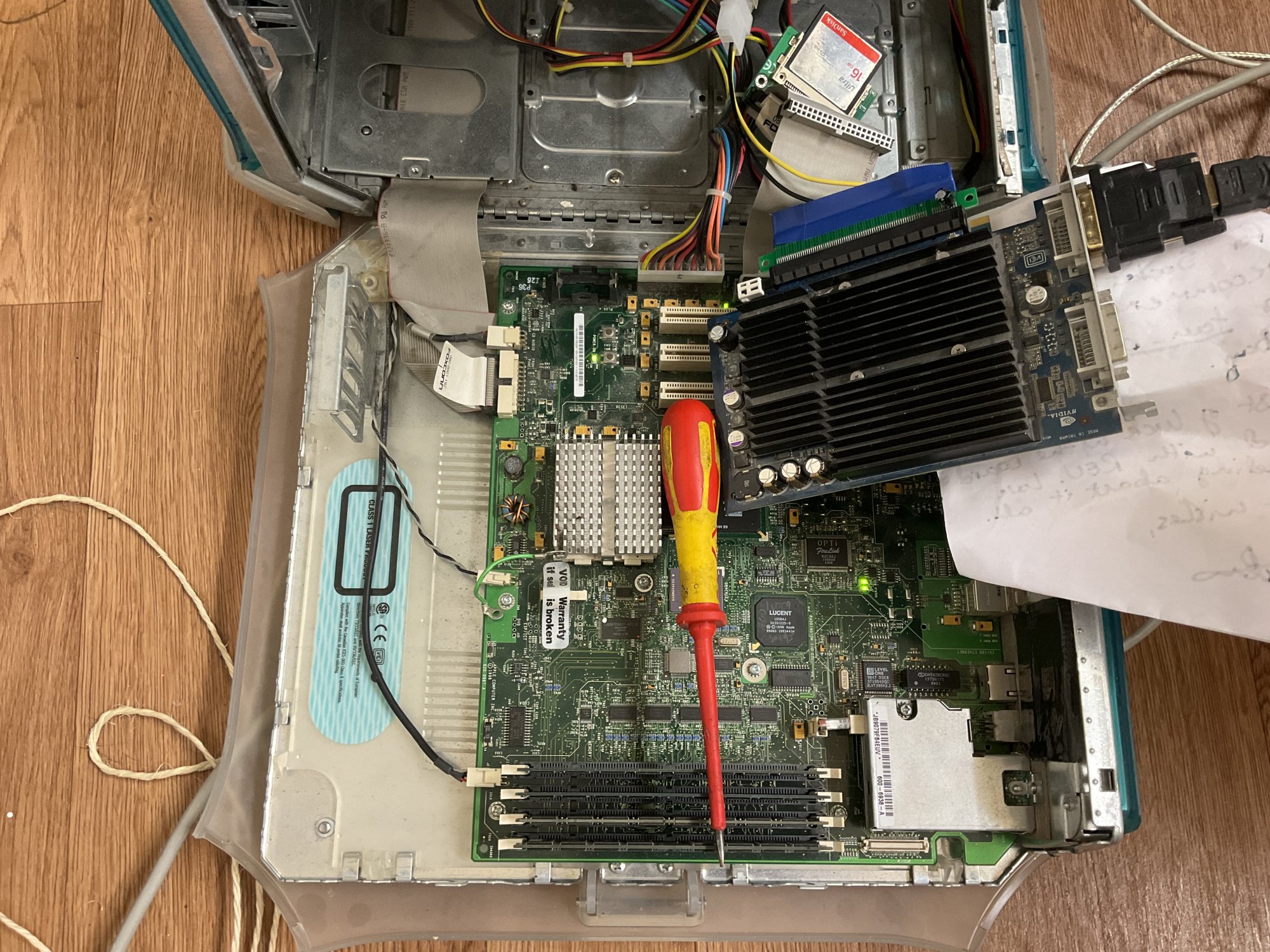

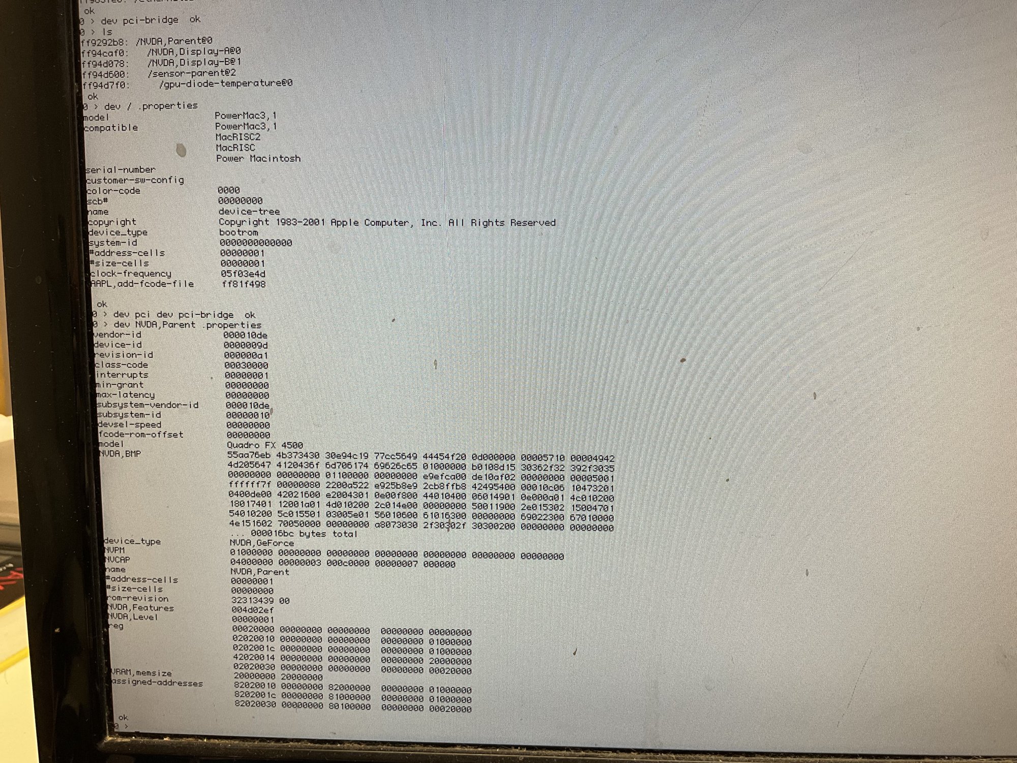

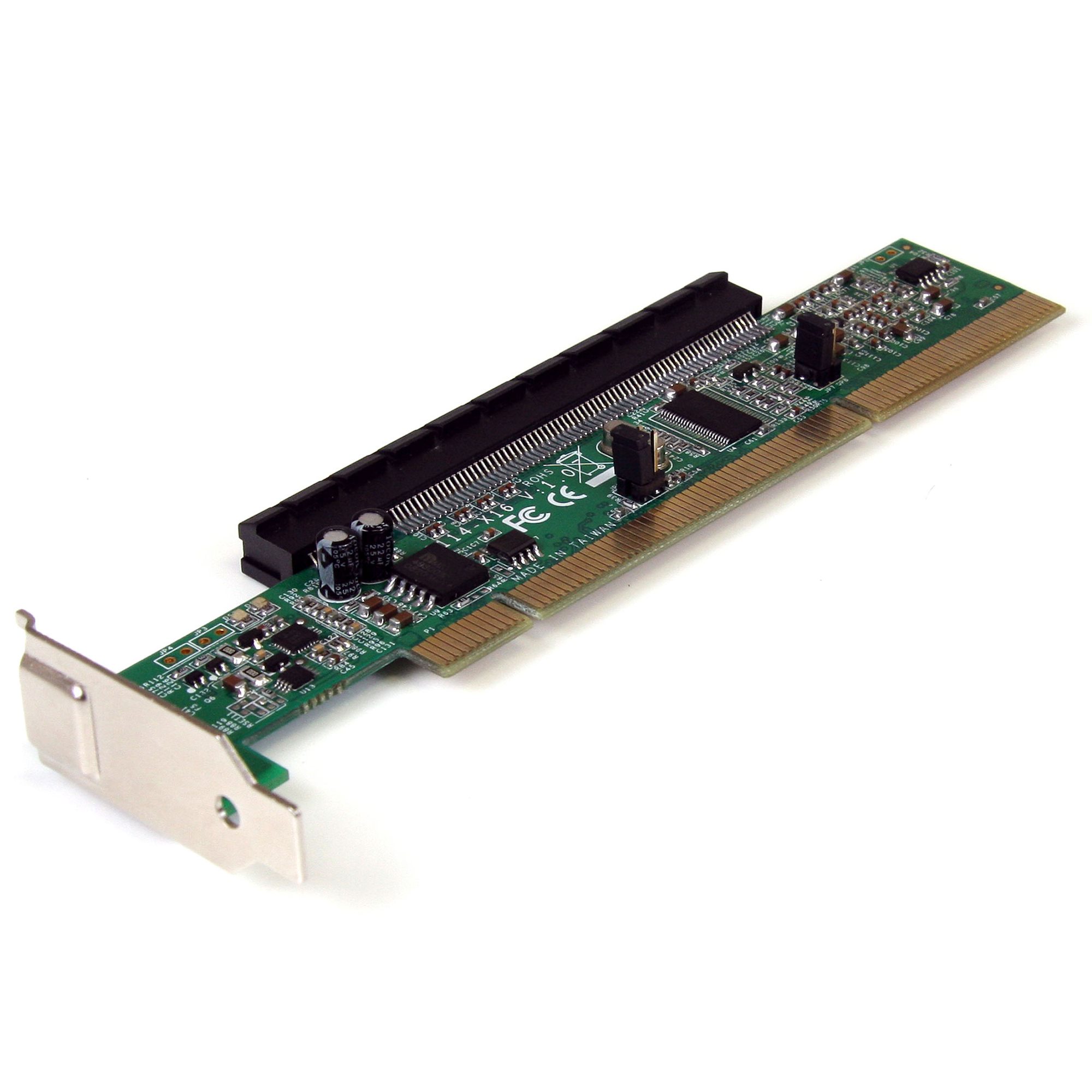

Yes I managed to "cram" a Quadro FX 4500 into my sawtooth, Almost! this is something I have been wanting to try for a long time now which is take a PCI to PCIe Bridge and see if a PCIe G5 GPU would work with one
I got the bridge a while ago https://www.startech.com/en-gb/cards-adapters/pci1pex1
and did confirm it did work in a PowerMac G4 and a PCIe device was seen, but it was only until now was I able to put everything together with a suitable GPU, and most awesomely OpenFirmware can load an Option ROM on the card despite the bridge :)
sadly this is as far as I am able to get, since for some reason, OpenFirmware hangs trying to output via the card, the monitor will activate, but then stay dark and OF will hang, I took the above picture with another GPU (in the AGP slot) to provide an output
with another GPU providing output, and nothing plugged into the FX 4500 I am able to see it in OpenFirmware as above, but trying to boot OS X just leads to a kernel panic on the NVIDIA Resman drivers
(the exact same happens in my Quicksilver as well for those curious)
but its still pretty awesome to see that OF will load an fCode Option ROM from a PCIe GPU through a PCI to PCIe bridge, I have a GeForce 6600 buried in my PowerMac G5 Quad but that itself is a bit buried atm, but will be interesting to try that and see what that does when I am able to unearth it

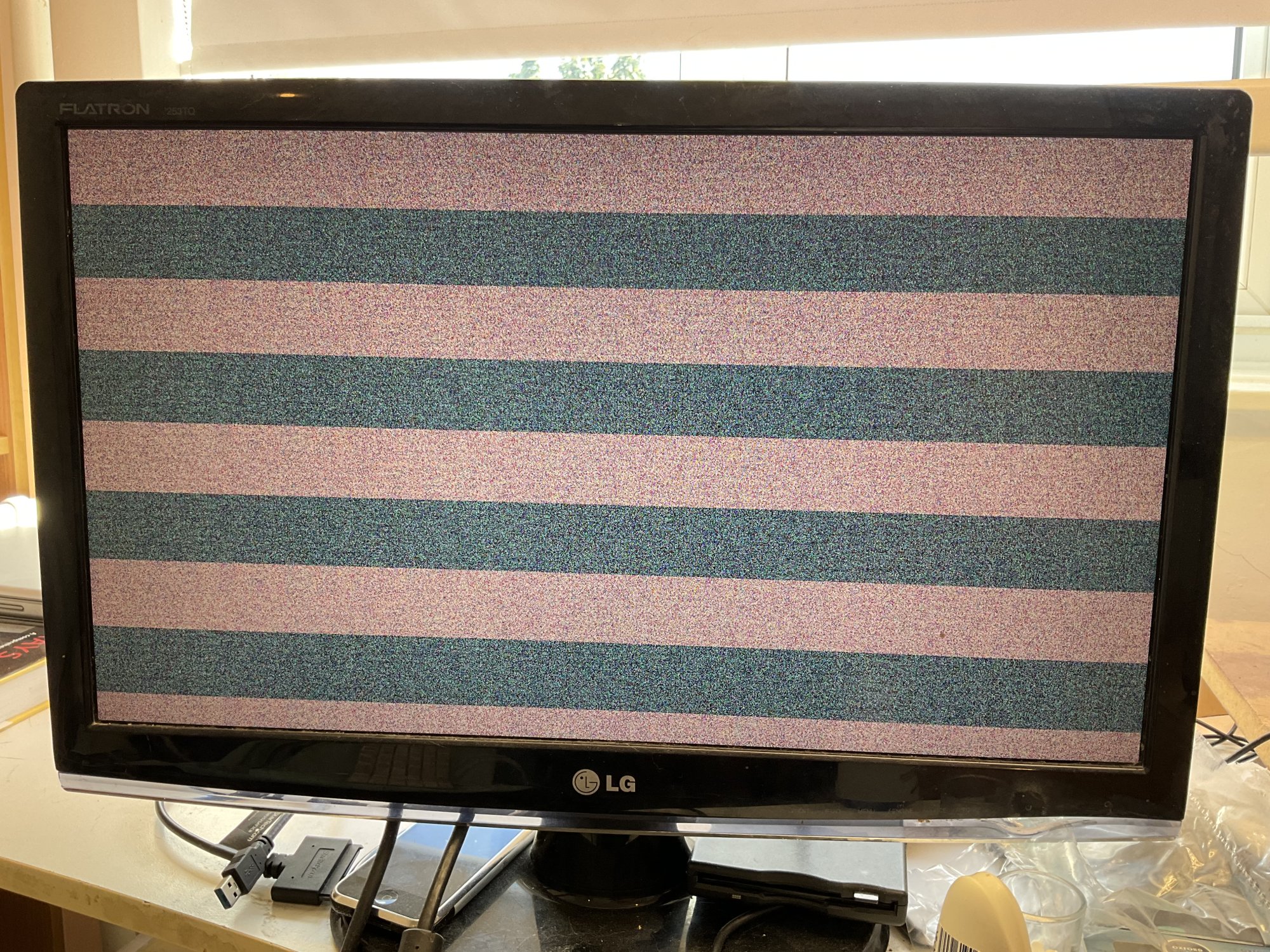

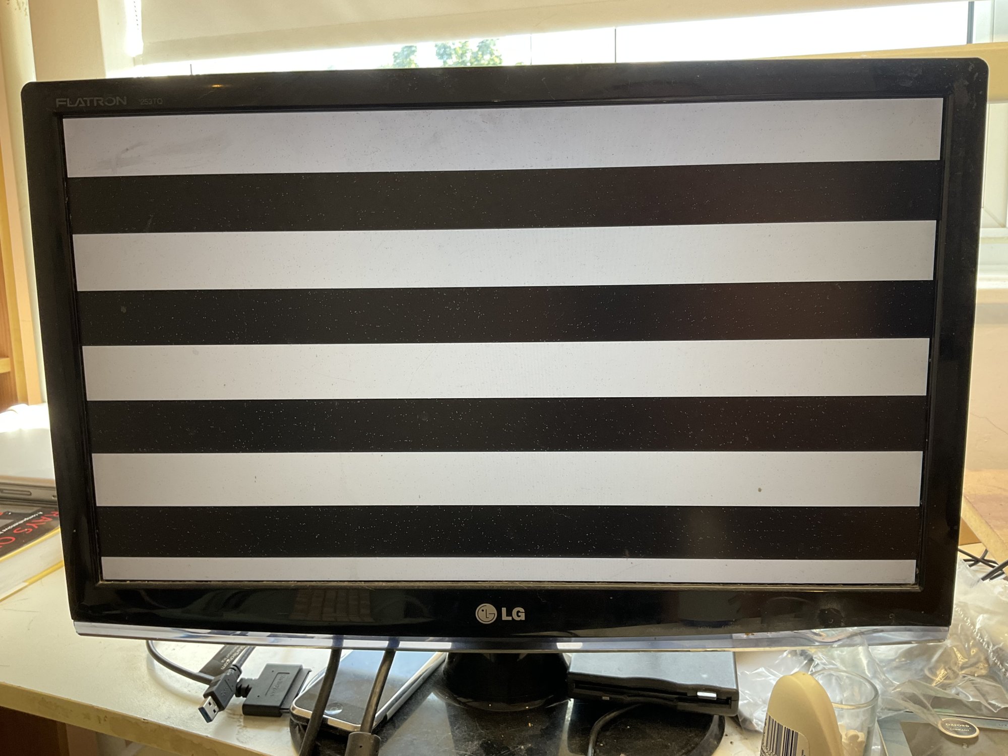

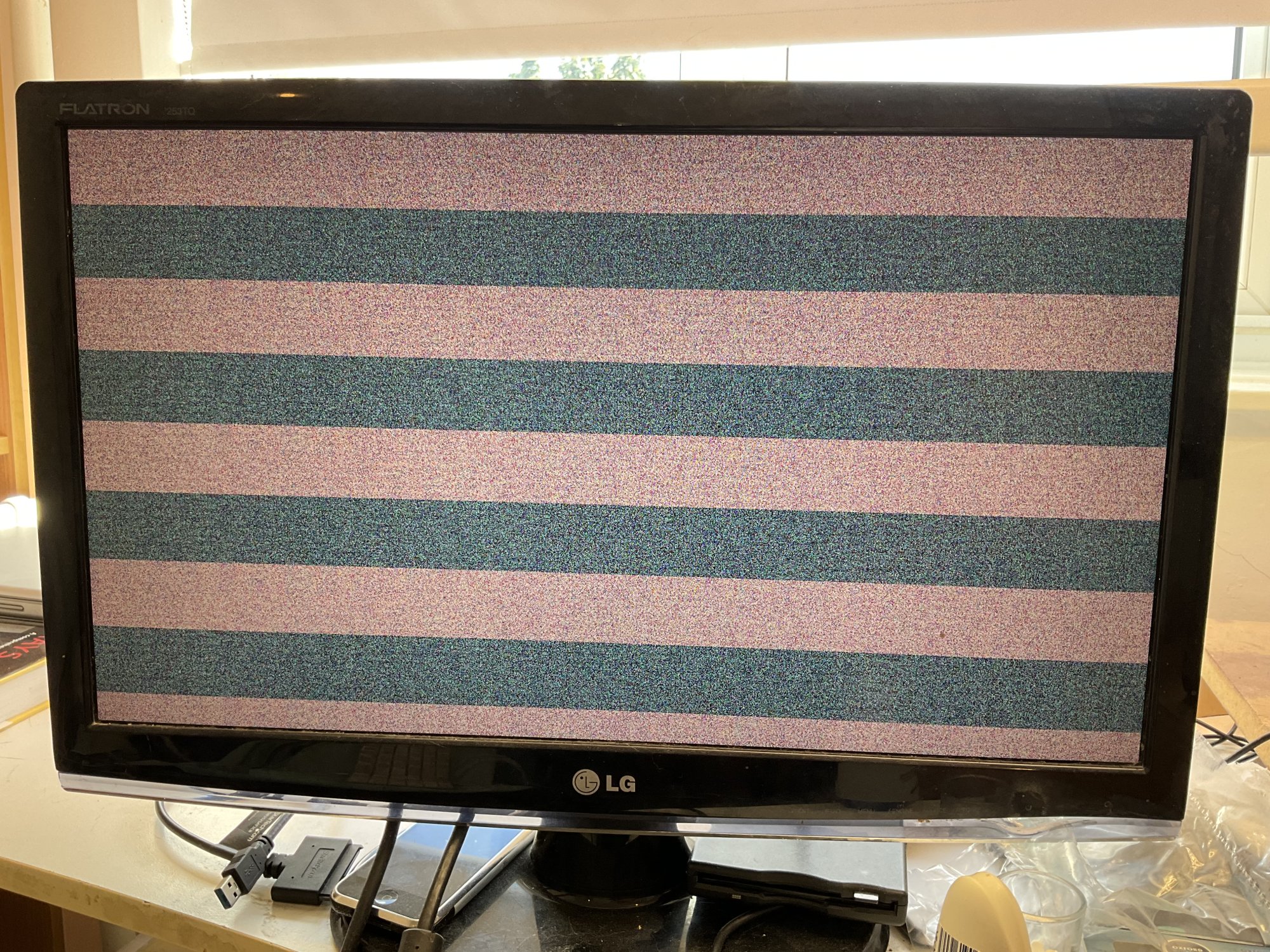

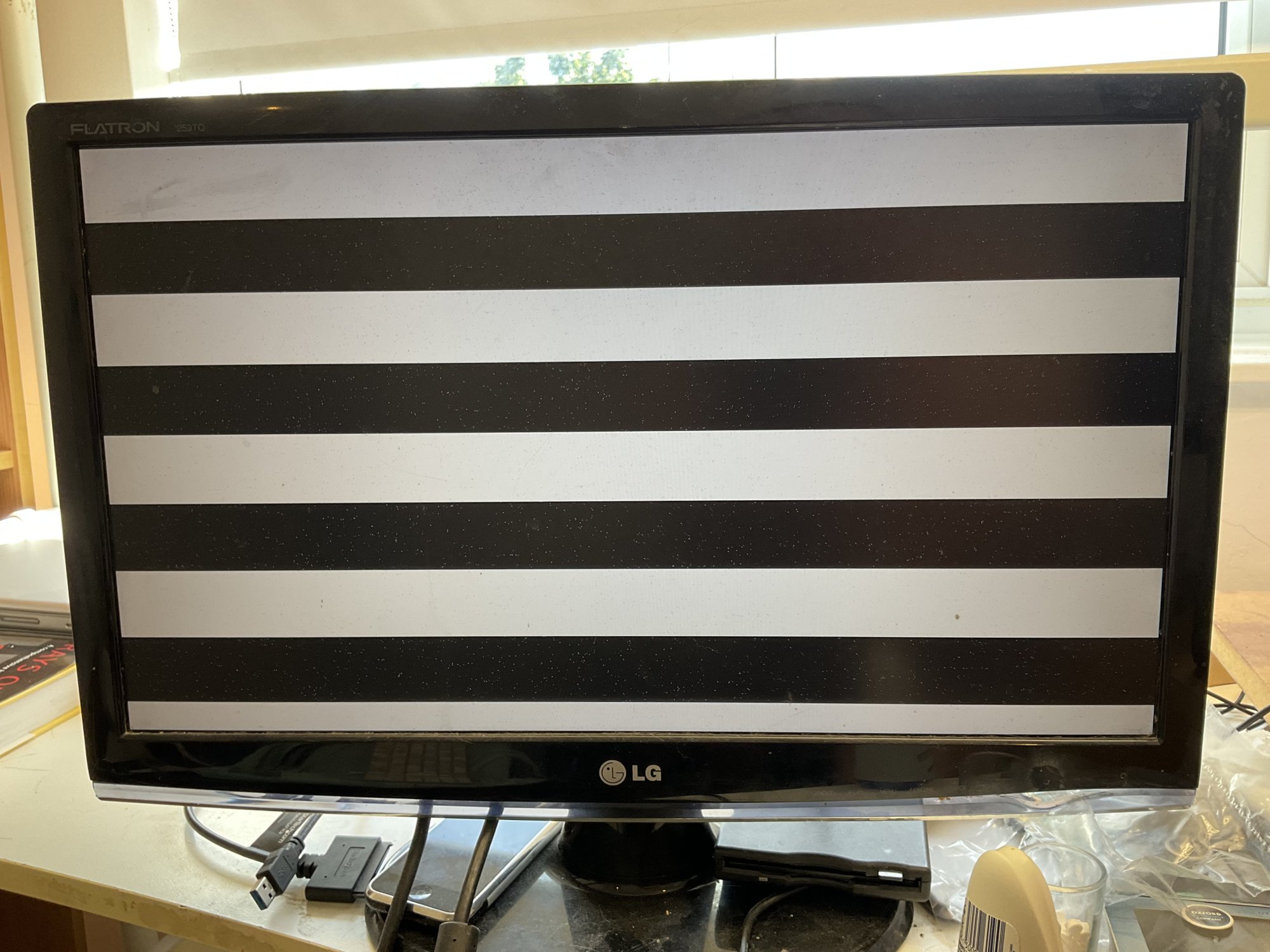

well this is very interesting! I managed to unearth an MDD and my G3 Blue and white, while the MDD does the same thing as the Sawtooth and QS,
the G3 blue and white does actually give me an image output!
it alternates between these 2 and sometimes gives me a black screen with white dots/pixels, depending on what exactly I call at boot up (be it the OF prompt or let it go to flashing folder)
its not a good one and I think OF is still hanging, but its certainly different and now has me wondering if the card is whats bad or a bad flash
I did verify the card worked in windows just fine before flashing it, but I have not actually been able to test it in my G5 Quad since flashing it
so looks like I may have to unearth that still to verify the FX 4500 and test the GeForce 6600 from it as well

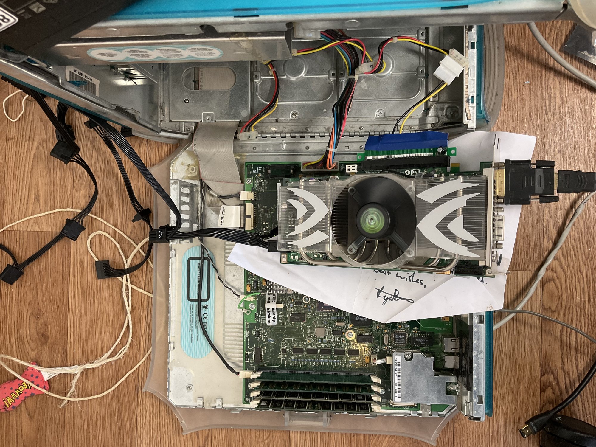

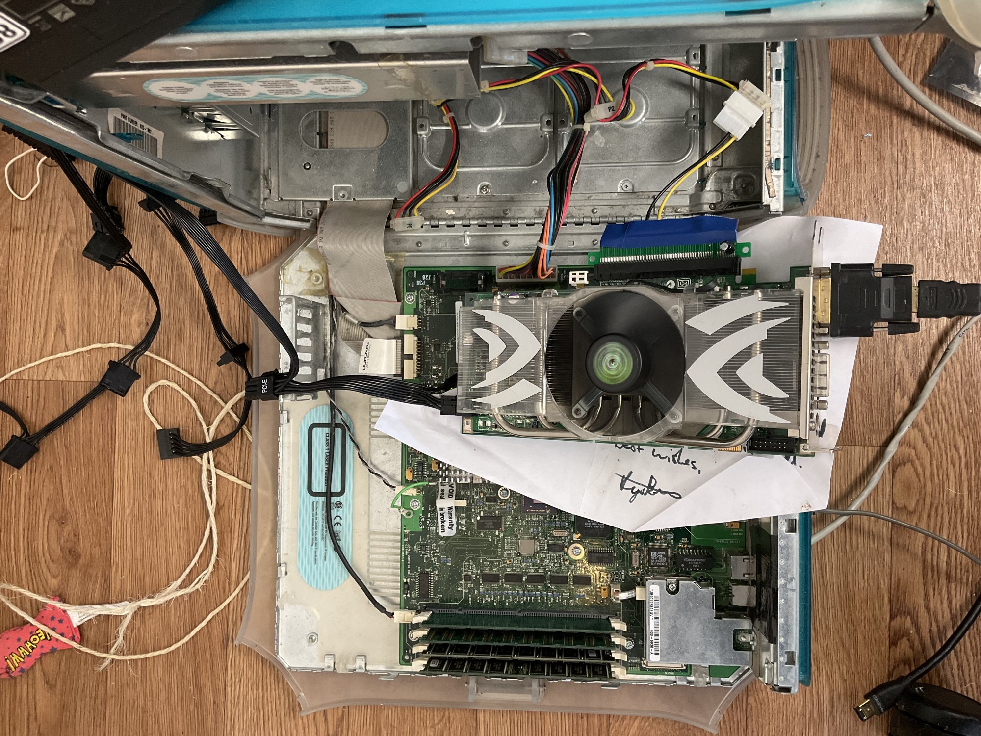

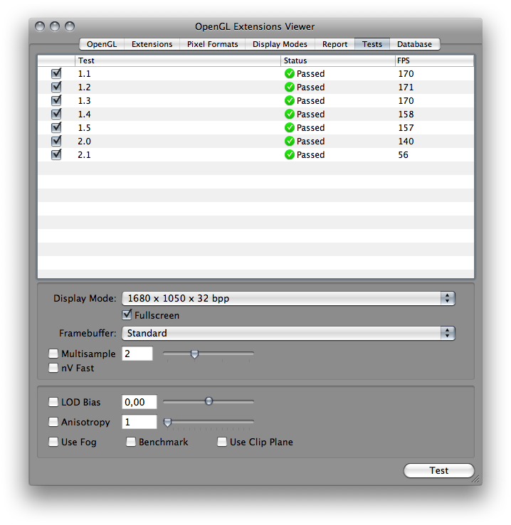

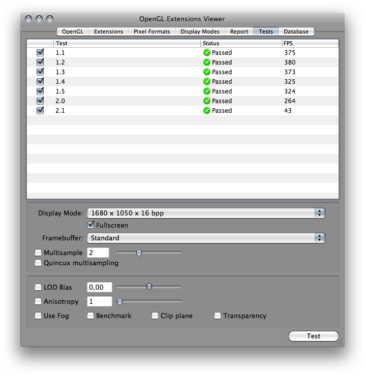

Tada! I now have the fastest graphically accelerated G3 blue and white on the planet LOL
although the Quadro FX 4500 did not work, I still wanted to persever with this, so I unearthed by G5 Quad, and did verify the Quadro FX 4500 does work fine in that (which is good because my last FX 4500 up and died a while back!)
and I dug out the GeForce 6600 from it, since although the Quadro did not work with this setup, I knew that the GeForce 6200 PCI that I use with my G3 Blue and white from time to time, uses a ROM that is based off of the 6600, so I figured anything has a chance of working it would be the 6600
and so low and behold I jabbed it into the G3 blue and white, got to an OF Prompt and it promptly booted Tiger no problems!
its really awesome to see this mad cap idea that I have had rattling around in my head for so many years does actually work!
I do wonder why the Quadro FX 4500 does not work, it would be interesting to see what a GeForce 7800 GT would do, I dont think anyone has ever used the Quadro FX 4500 ROM in any pre G5/OpenFirmware 4 setting (since the GeForce 7800 GS ROM is based off of the 7800 GT ROM im pretty sure)
so I do wonder if its simply a case of the Quadro FX 4500 ROM is incompatible with OpenFirmware 3 for some reason, or is it a memory space/configuration issue?
this also means I now have a G3 blue and white with a dual link DVI port, defo going to have to test that out :) and of course attention turns back to the ATI Radeon X1900, I am REALLY curious to see what one of those would do, and if it does work if it works in an Old World Mac? Core Image in a G3 beige or 9600 at long last?
as a side note Startech made a PCI-X to PCIe x4 adapter, sadly its been discontinued for a couple years now, but would be good for something like this to extract maximum performance, if your say intending to use such a setup in a G3/G4's 64 bit PCI slot

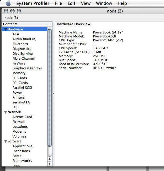

it says PowerPC G3 because thats the early OS X's default name for an Unknown CPU (its running in PPC generic mode) I do wonder if I can futz with the PowerLogix OS X 7448 NVRAMRC script to get it to make the CPU pretend to be a 7445 rather then a 7447A as it normally does, but i need to figure out how said script works/what it does exactly first!
(no public OS X version supports the 7448 natively, while earlier OS X versions up to 10.2.8 will boot on an unknown CPU later versions wont, so PowerLogix needed an NVRAM script to get those later OS X versions booting)
here it is for those wondering (note its diffrent to simple just changing the cpu-version property in Open Firmware, as OS X actually checks the PVR it seems rather then just looking at the OF device tree like the Mac OS 8.6/9.x ROM does)

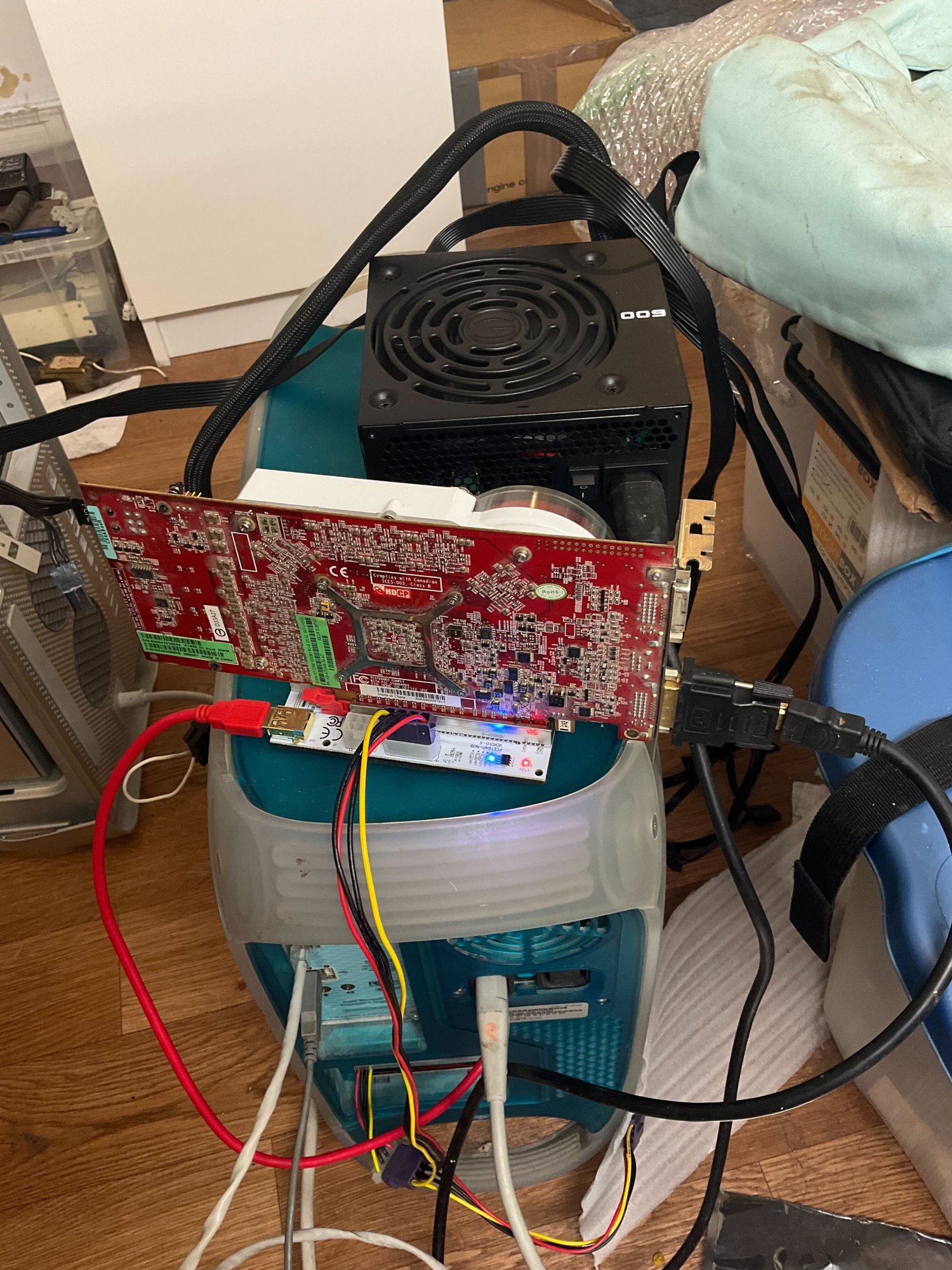

Managed to win an ATI X1900 GT on eBay from someone in France this morning, who has clearly just ripped all the content in their listing from the popular new OEM X1900 GT listing thats on US eBay
so place bets now as to what will actually show up LOL but hopefully it is actually an X1900 GT or other such R580/R580+ card so I can flash it and see how it does with this whole whacky setup :)

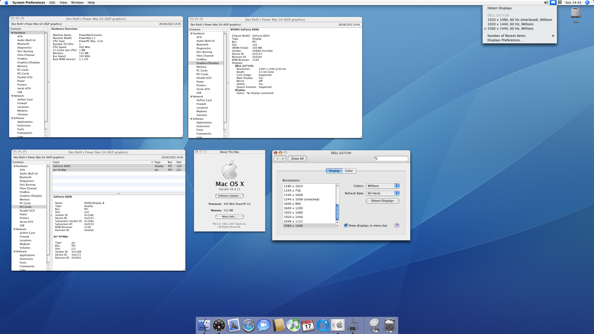

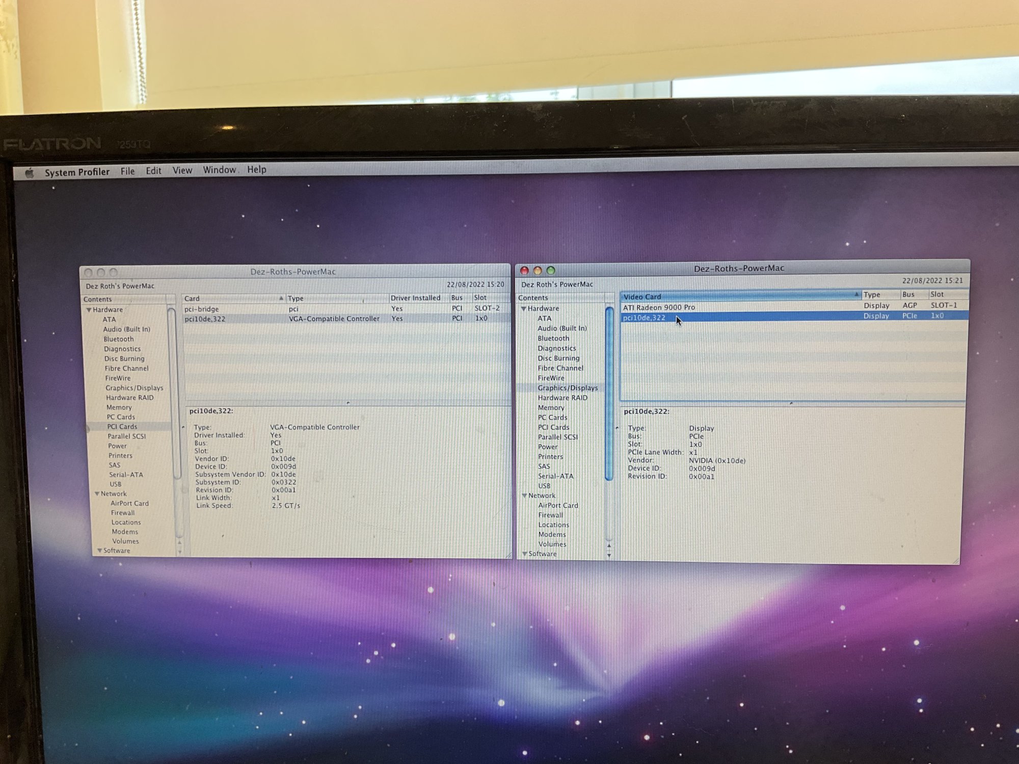

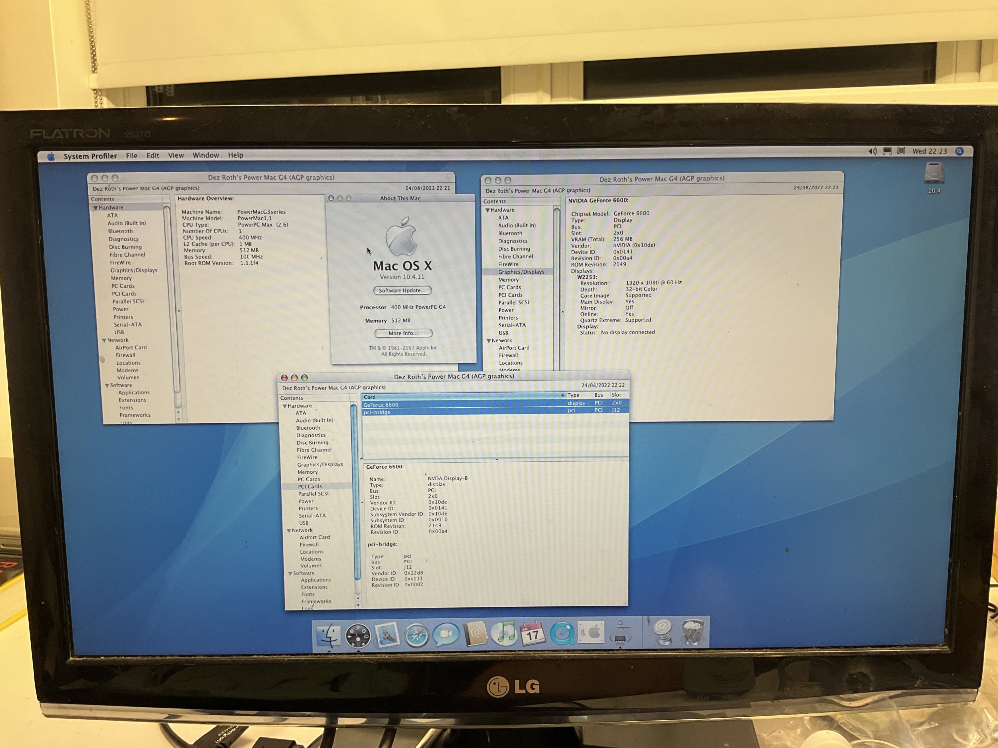

and speaking of, I can confirm that the NVIDIA GeForce 6600 with this setup works in my FW800 MDD and works in Leopard was well :) in Leopard it hangs at a white screen for about a minute before the window server finally comes up, but I think thats just the temperature sensor hang up that happens with GeForce 6xxx/7xxx cards in G4's if you have not removed the temperature sensor component from their ROM
(I should of plopped in an AGP video card just to get system profiler to display both "PCIe" and "AGP" under bus type in graphics and displays LOL)
it is a shame that I dont think theres any way to properly install this setup into a PowerMac G3/G4
can confirm the dual link DVI port does indeed work as expected! (via a Atlona AT-DP400 that @Amethyst1 very kindly sent me a while back) I think this is the first time anyones done such high resolutions on a G3 blue and white :) certainly the first time Dual link DVI has been done for sure! (maybe someone hooked up a big Bertha back in the day LOL)

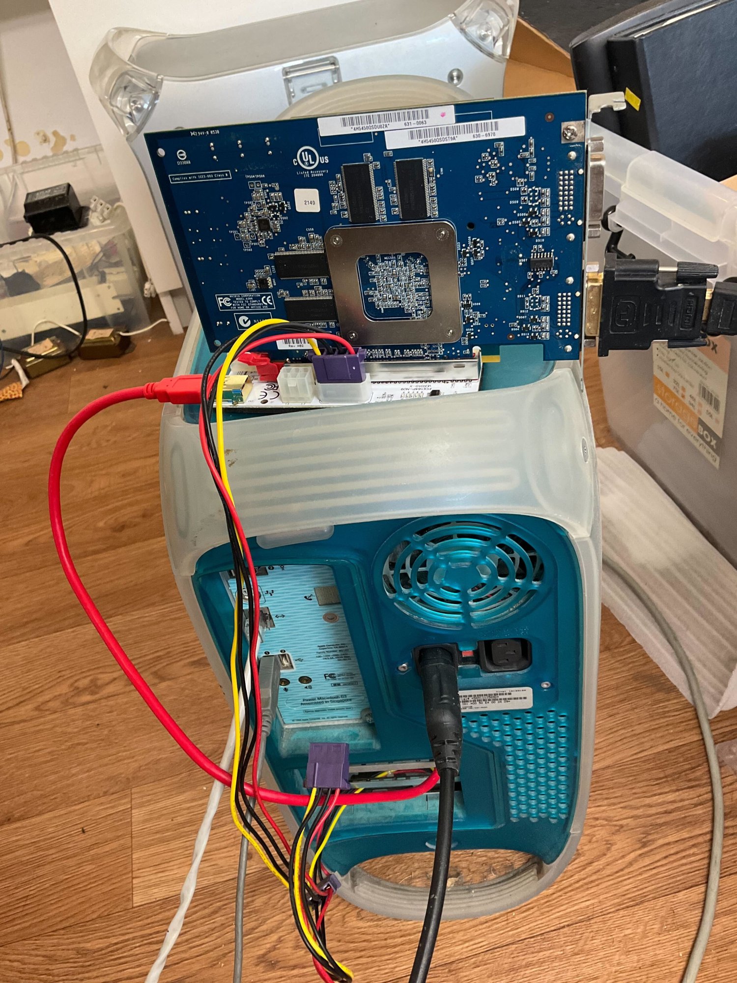

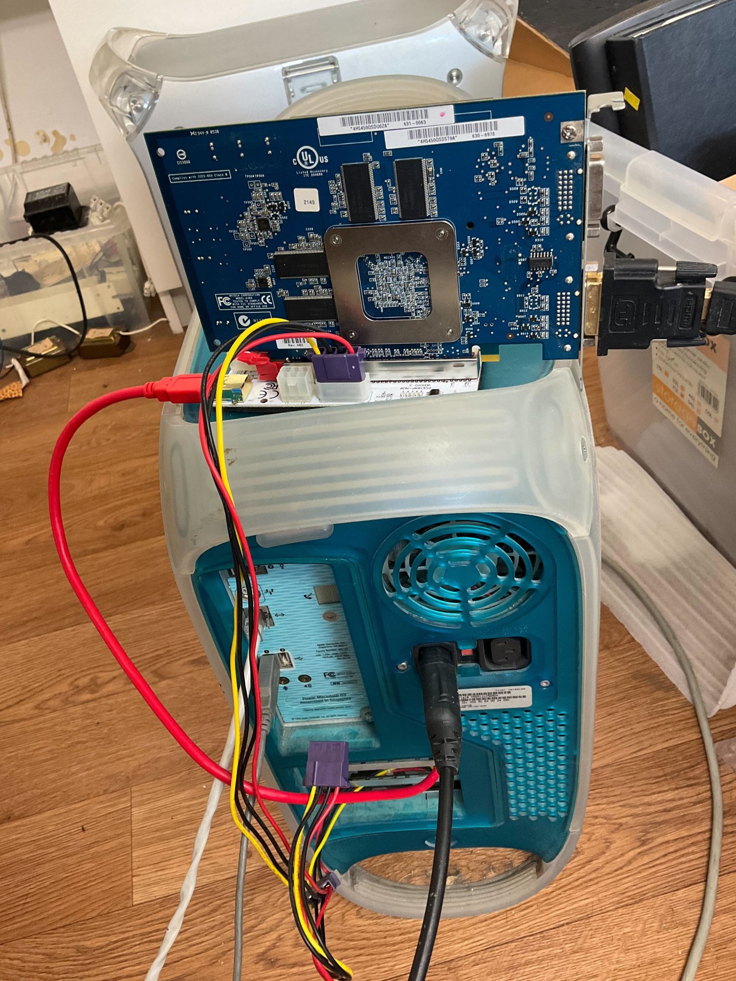

I gave this some thought, and although I cant install this setup internally, I bought myself one of those PCIe 1x through a USB 3.0 A to A cable to PCIe x16 risers, you see most commonly used in crypto currency mining rigs
as this is much more flexible (literally!) then the PCIe 1x to 16 ribbon cable riser im currently using, and the "USB" cable should let me fairly neatly route it outside of the system through the open PCI slot that the PCI to PCIe adapter is installed in, and have the GPU free standing externally
like some early 2000's version of an eGPU LOL hopefully it works! I know these risers can be a bit hit or miss, but should be a lot less kludgey then my current setup and let me actually close the door on the PowerMac!
this arrived yesterday and I put it together today and can confirm it works nicely :) and I am able to close the door on the G3 blue and white and plop it on top of the machine, rather then spread it across the motherboard in a very janky fashion! and everything still works as previously :)
its still fairly cable spaghetti, but a lot neater then previously! and since I can now close the door, should allow me to do more experiments with my other machines without fear of cooking their CPUs!
my only concern is the little "PCIe 1x to USB 3.0" PCB is not supported by anything much so could work lose over time (esp as the fairly stiff USB cable is moved), and thus ideally that could do with some support bracket being made up if you where to get really serious with all of this
but this should work nicely as is for experiments etc :)

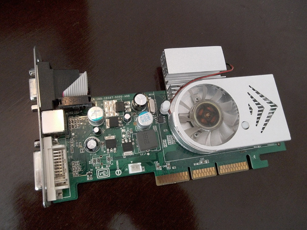

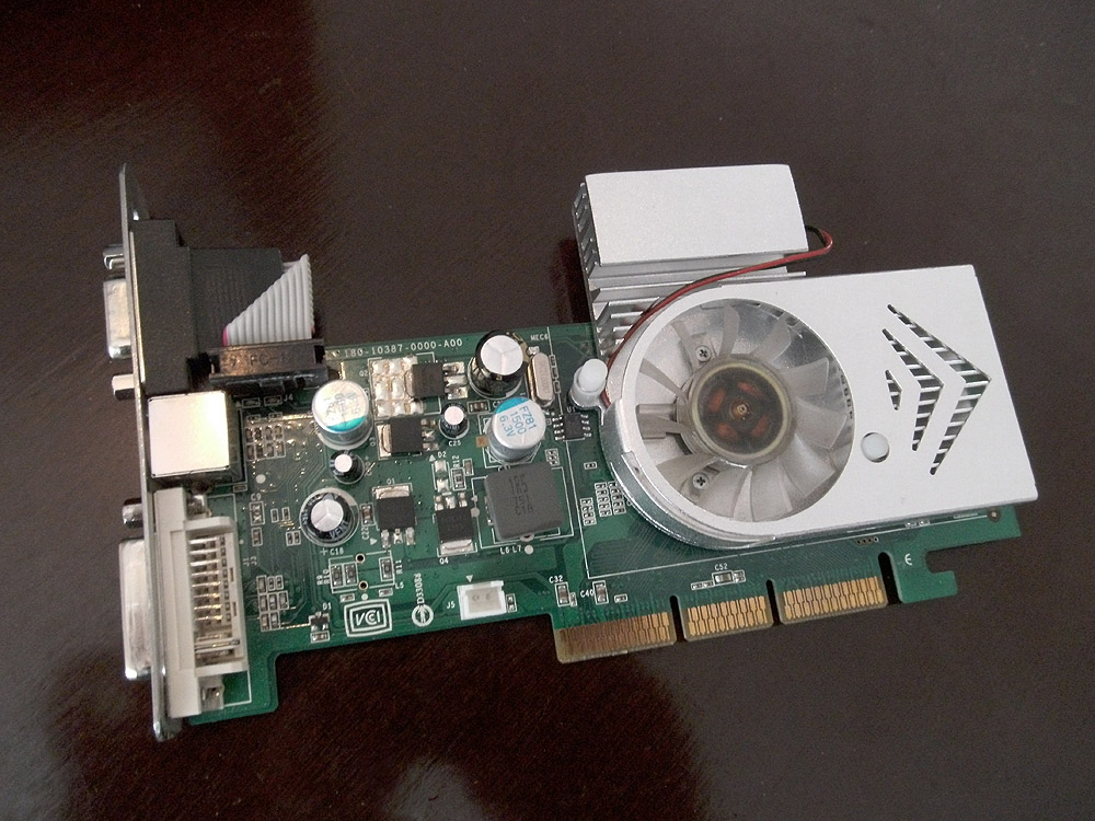

Thanks again for this note!
It triggered curiosity which made me fire up my Cube after a long time of just collecting dust...
...just to see/feel, that - even with the clocks at 1.6 - it seemed to be running way too hot! Constant smell of burning dust came out of the top grill and even optical disks felt hot when ejected. Two CPUs seem to deliver heat alot better than one does. And not running all the time might seriously have saved the life of the unit.
So first thing i did, was attaching the base fan to 12 volts instead of 5 (how could i ever?). It's now not as "unaudible" anymore. But the more important thing: Hot air is noticeably transported out of the box! (Which wasn't the case before).
Another thing, which i had almost forgotten about, was, how the particular breed of 6200 i have in there crushes the usual 6200s! 😎

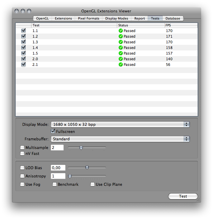

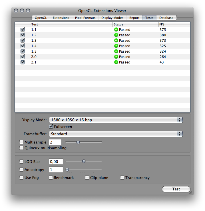

Here is, how it compares to a "normal" other AGP-card like i. e. the XFX, clocked at 350/266.
The thing about that card, an actively cooled low profile one by Club 3D, is that it is equipped with memory modules rated 400MHz, which could be safely run at 450. And also the GPU, with 430, runs at a much higher speed as 6200 standard. These clocks where even in the PC-ROM of the card, so should be safe to use (active cooling provided!). But 430/450 vs. 350/266 seems to make quite some difference. It more than compensates the 64bit-disadvantage to the 128bit cards like the Radeon 9000/9200 and is in fact more than half of what a power hungry "monster" like the 9800pro comes up with.
So, for the Cube, this should be the card to get!
(Blower cooler by Radeon 9600xt)
I am just curious have you tried some more benchmarks then just the OpenGL viewer one?
just to give a wider spread incase for some reason it say uncharacteristically favours one setup over another?
on the cube video card front, there is a very rare Radeon 9800 Pro built on a 9700 board which you can cram into a G4 cube :)
Reactions: Amethyst1
In others it is not just as "dramatic" as for OpenGL Extensions Viewer. With OpenMark i get around 7500. But there the "normal" 6139, a 6200 gets vs. +/- 9000 of a Rad 9800 are more than questinable anyway.
Sadly the most real life like benchmarks of Unigine are Intel-only. But if you know some other i could test, would be a pleasure to do so.
It's some kind of "philosophic" consideration. But for me a "Cube-card" is only, what can run safely in the stock enclosure (which - at least to me - is what finally makes a Cube the Cube). And that's exactly what these Radeon 9xxx cards, even if they physically fit, are very far from.
I also fitted the 6800xt in. Even solderd cables instead of the power connector in, to provide a molex connection which fitted inside.
Was able to run it with a Giga-C-VRM. With the Apple one the Cube instantly shut down as soon as any 3D load was thrown at the card. But within the closed box, the card totally overheated within minutes even with a strong and loud fan and just idling at the desktop.
So no Cube card at all. It's now the one i use in the Sawtooth, where it gets the air to breathe it needs and does a nice job.

So you took the cooler off a 9600xt?
Did you fashion that PCI bracket yourself?
Nice card BTW 400Mhz memory clock is a rare find on a 6200.
Yes! I found this a nice fit, as it directly blows the warm air out the top. But for the Cube one of the "fenders" in the back has to be removed. So the fan can suck fresh air from the side. Sucking from the top, as intended is not possible, as this opening sits directly against the wall of the Cube's enclosure.
Yes, i used one of the many i had around and matched it as close as possible to the original one of the Rage Pro. One of the standoffs at the DVI-port had to be removed to fit the opening in the case.
Yes, they where more around (and cheaper) some time ago. Same or even more for the PCI-cards. I got this one as "untested/defective" without cooler for 6 Euros years ago.
But they appear from time to time. Few other brands, i. e. PNY or EVGA are using this PCB-layout too. Don't know, if they also use 400MHz chips. So a look on the print/into the PC-ROM might be necessary before throwing these clocks at them. As a sign can be seen, that these cards se to have fans on them while most other 6200s ar passively cooled only.
I present to thee the most graphically over powered PowerMac G3 blue and white ever LOL
the french X1900 GT was a dud, but I managed to win the above X1950 XT a couple days ago, and successfully flash it :) where I am very pleased to report it does indeed work with my PCI to PCIe setup and G3 Blue and white!
It will be bottlenecked to buggery LOL, but this gives us 2 Dual Link DVI ports now :) , and I really look forward to trying this with some Old world Macs and seeing how it plays there!
