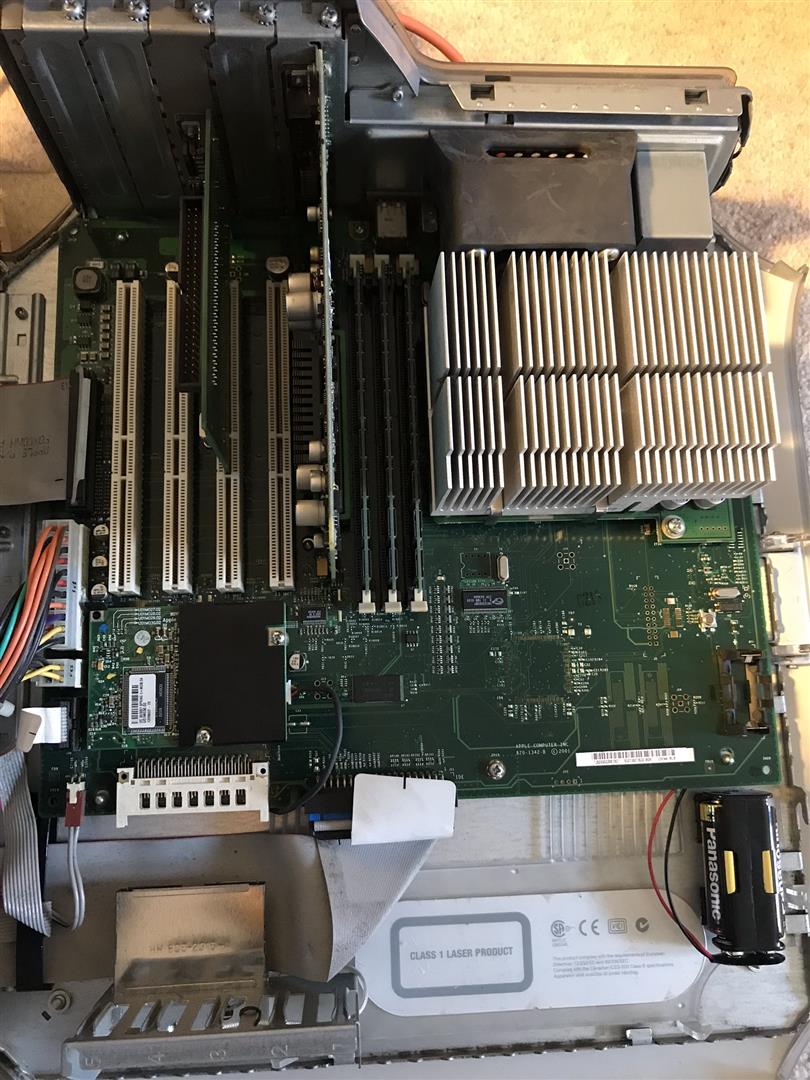

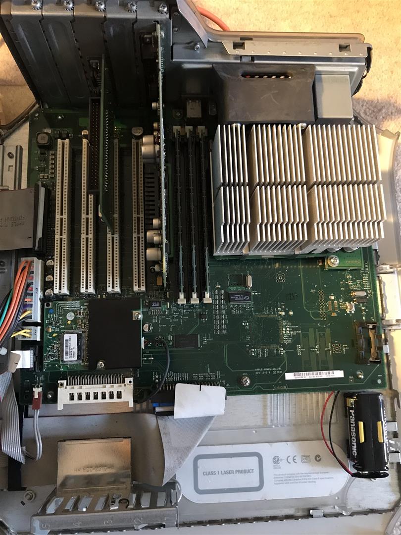

Quicksilver. Depending on the CPU inside it will be a 2001 or a 2002 model. The 2002 is better as it doesn't suffer from the 128GB HDD limit. What does the sticker on the back of the QS say about the processor speed?
QS 2002 Disk Set is here:
The 2001 OS9 disc is probably hidden in amongst the general OS9 pages. Possibly here:
If it is a single processor, it is a 2002 model, if a dual processor a 2001 version. The single CPU 800MHz 2002 was the entry level model and lacked L3 cache, so was a tad slower in some applications.

This is my motherboard - it looks there's a single processor under that heatsink.
One of the HDD is 164GB so I suppose it's a single processor then!
