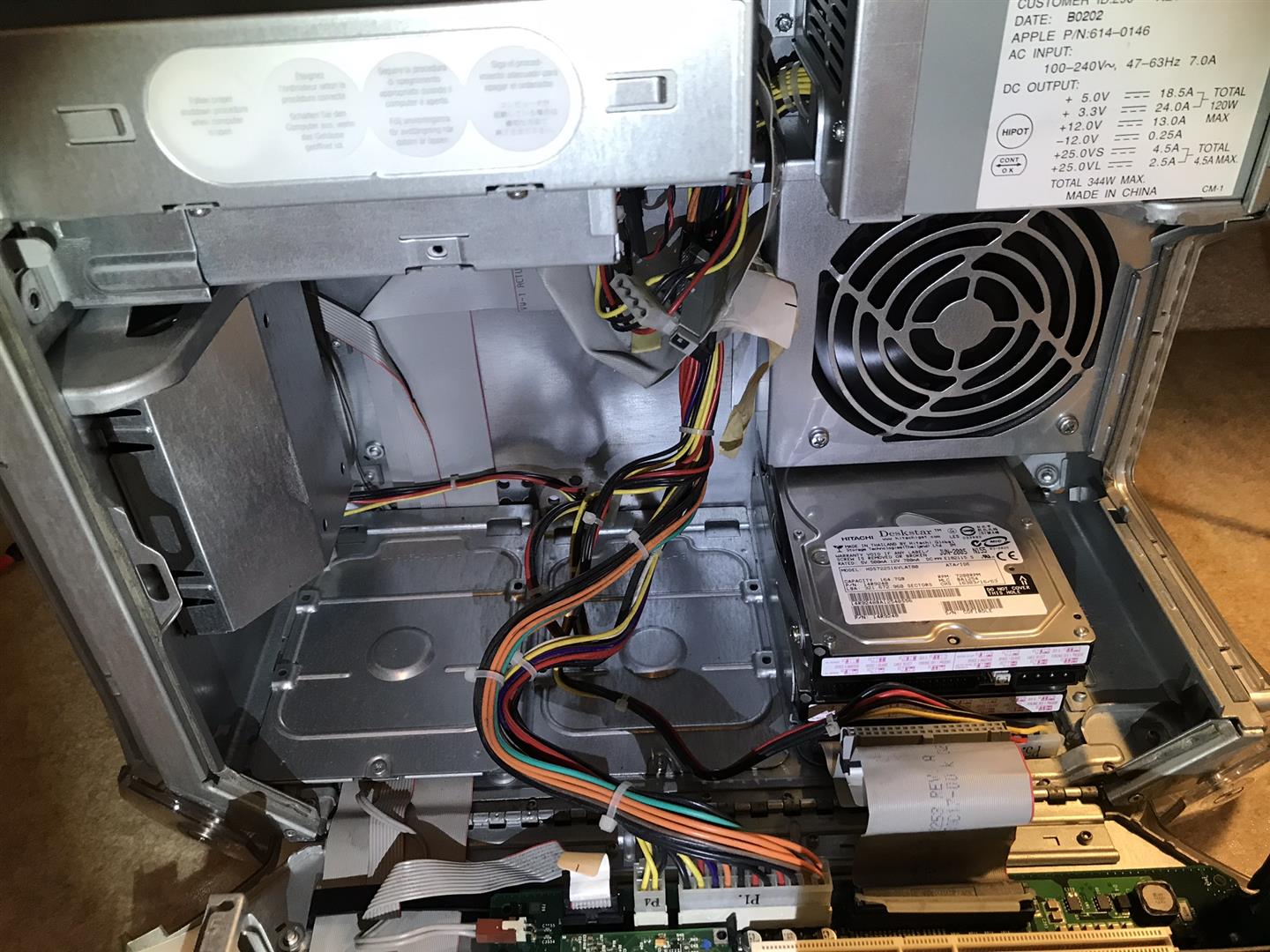

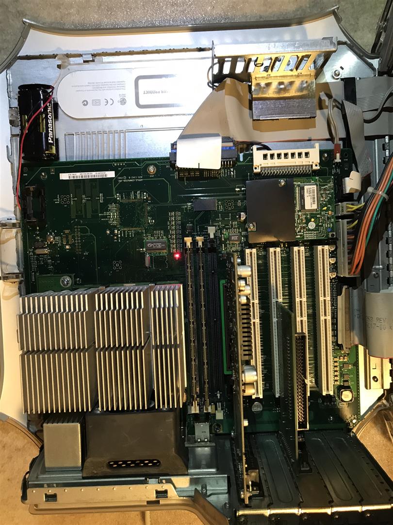

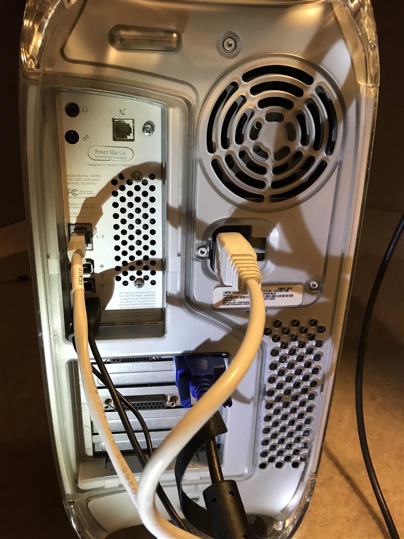

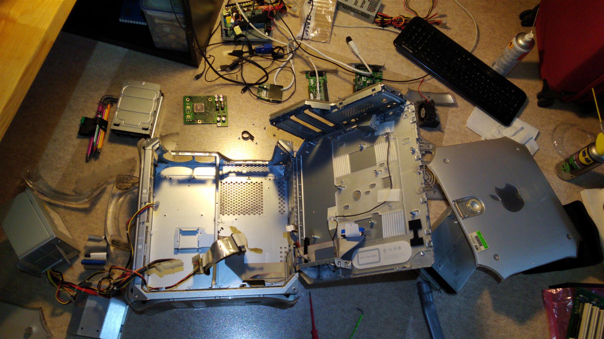

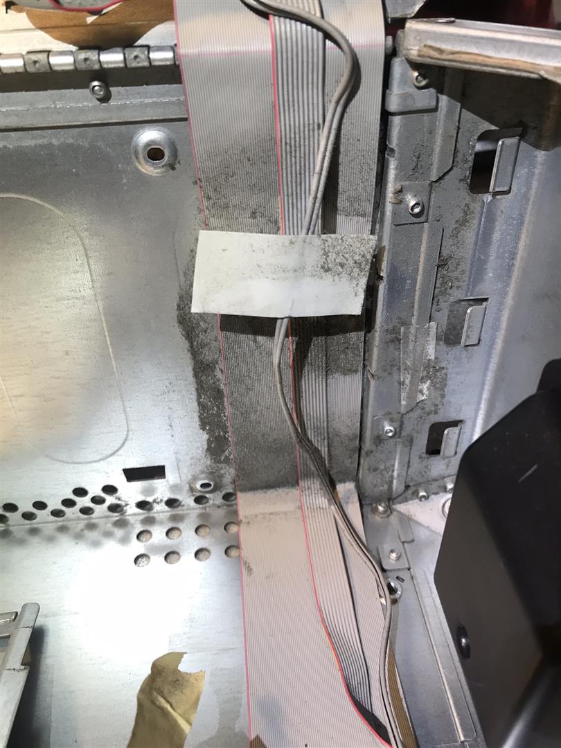

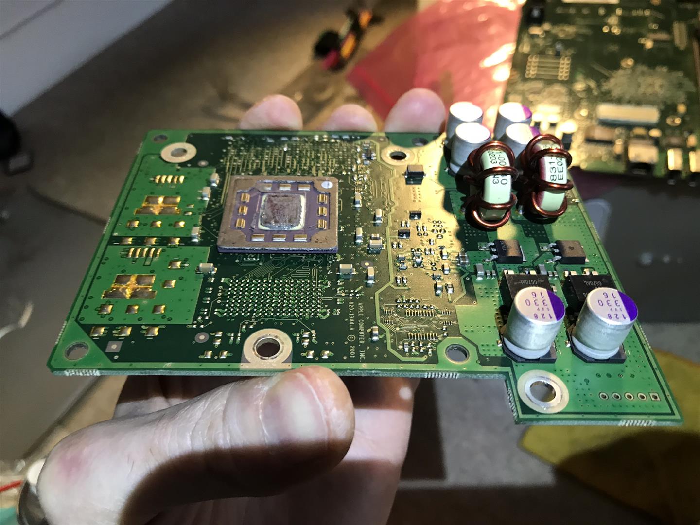

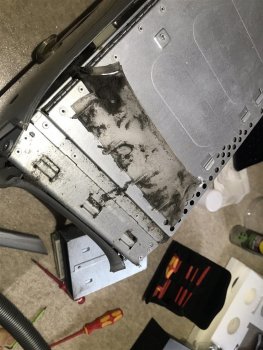

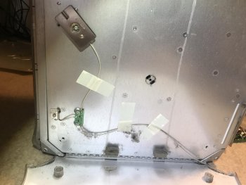

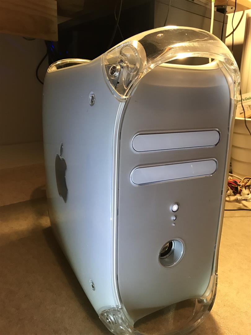

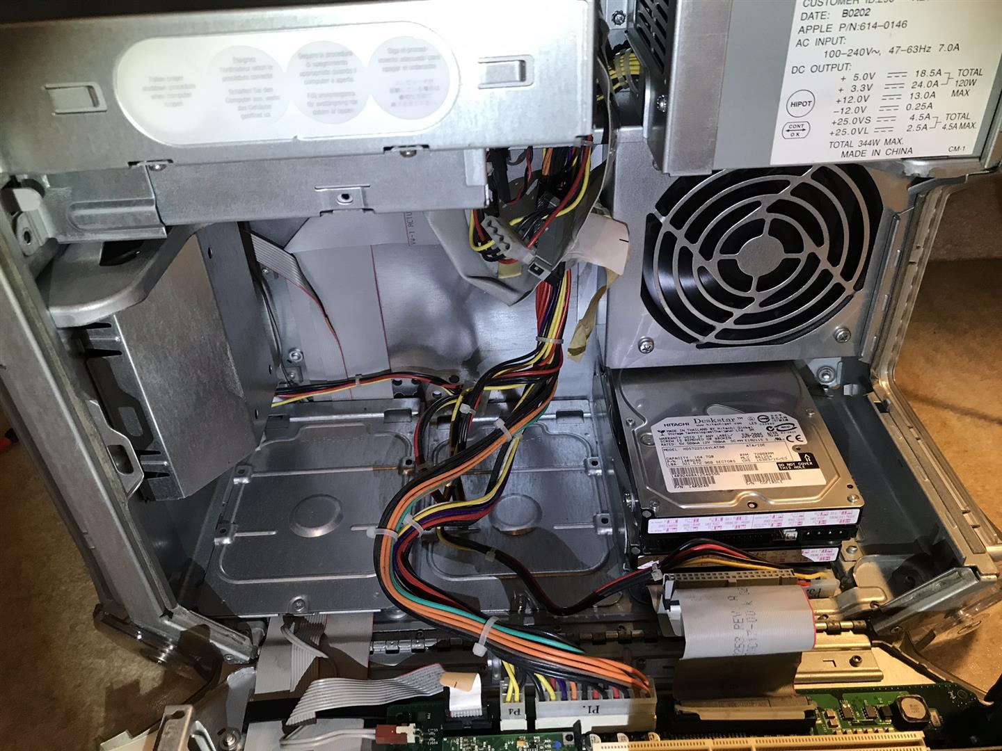

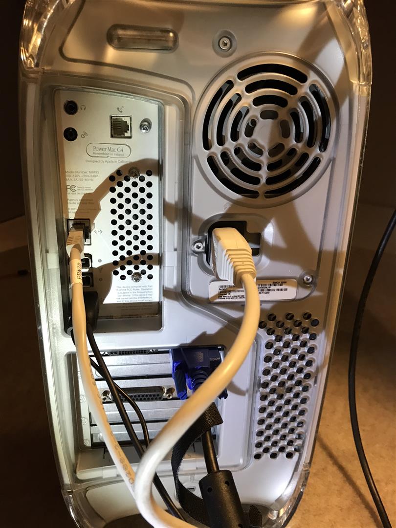

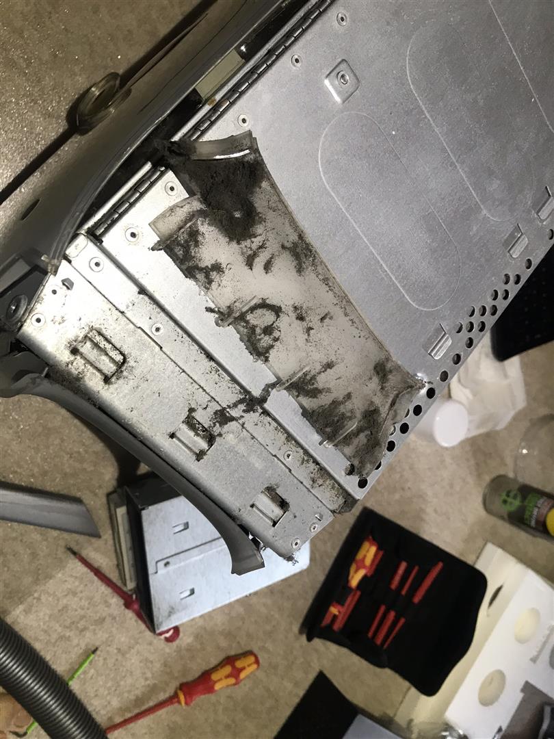

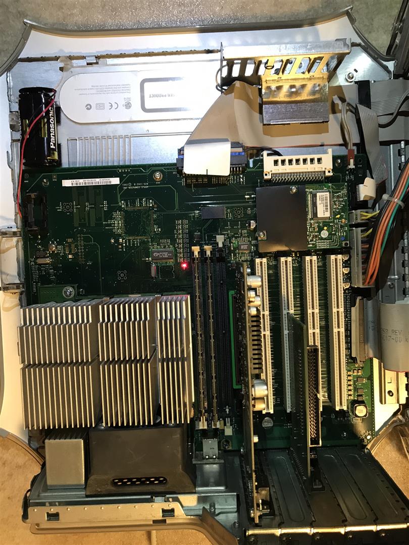

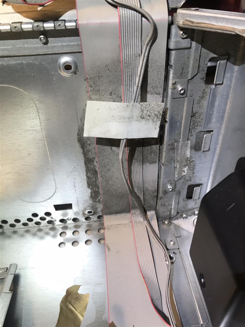

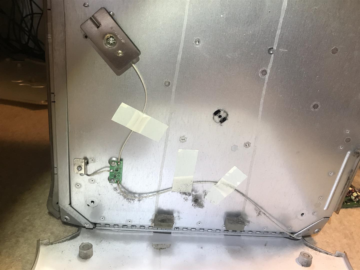

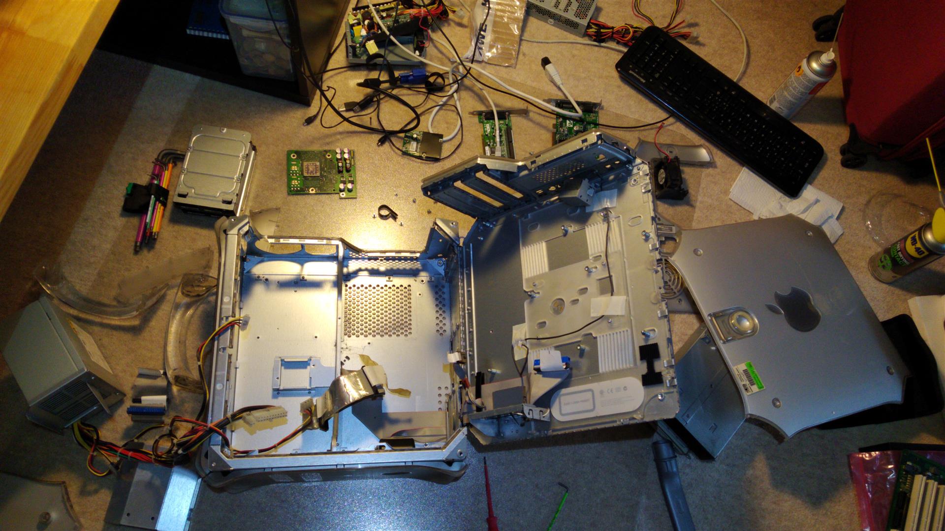

The G4 was filthy so today I decided to fully disassemble and clean it.

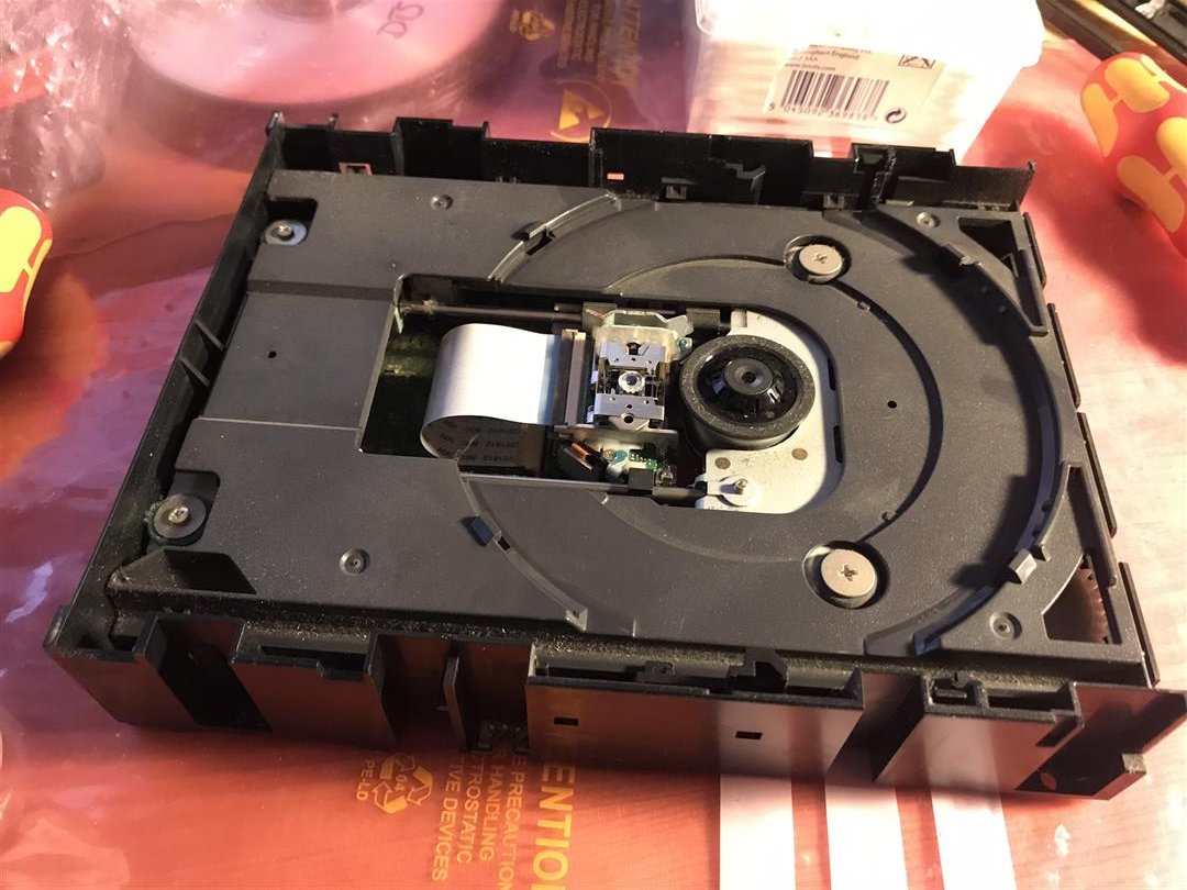

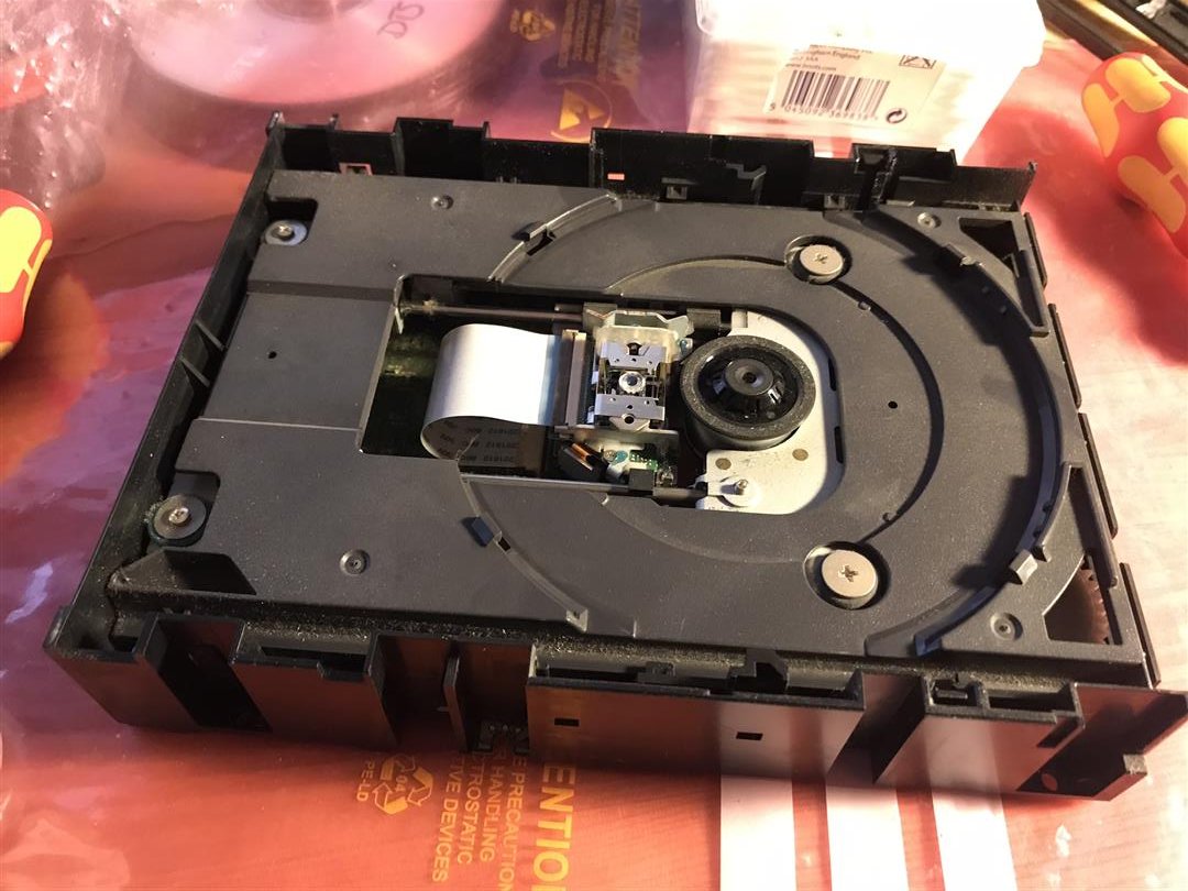

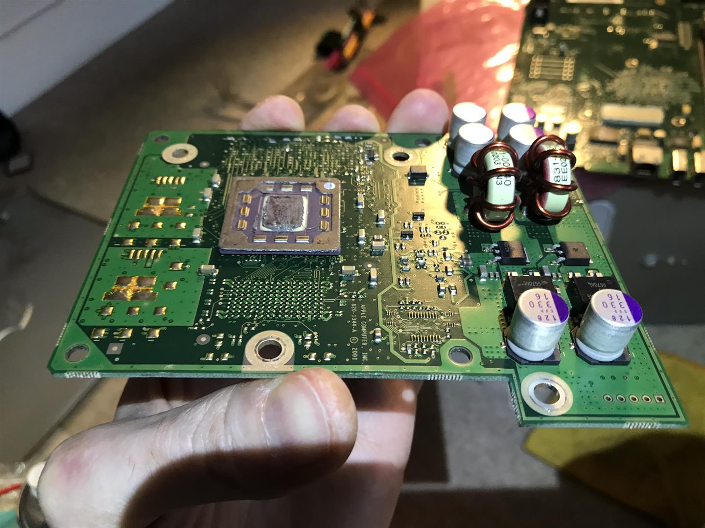

I removed everything, including CPU (I replaced the thermal paste of course), logic board, PSU (which I inspected) and all panels. I also opened the DVD rom (I thought it was a CDROM) as the drive would read CDs but not DVDs. I cleaned the lens.
Also discovered that the second mysterious drive is a SCSI ZIP drive, but the Quicksilver doesn't have the bezel for it, nor the SCSI cable - I'm on it!
With my surprise (LOL) everything worked fine when I reassembled everything! And the DVD drive now reads DVDs no problem - yay!

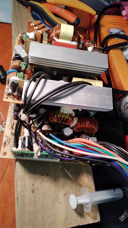

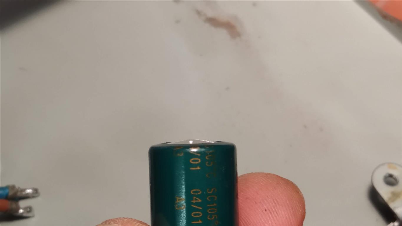

The PSU has 4 bulged capacitors which will need replacing. And I ended up with an extra screw... 🙂

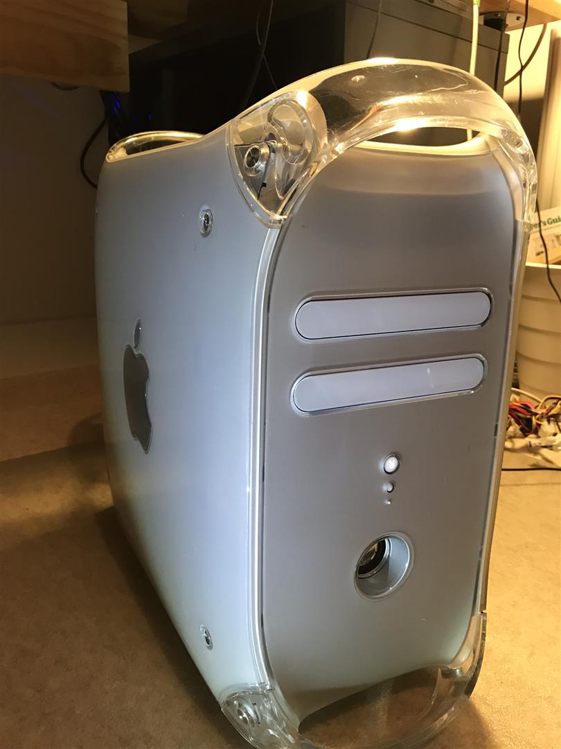

The computer now looks stunning!
Some pics "before" and "after" 🙂

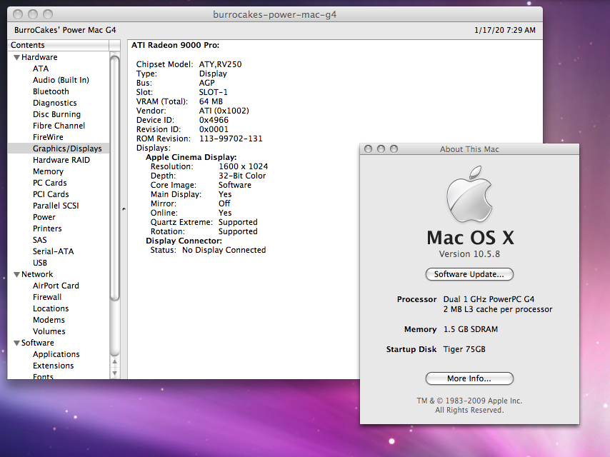

Hi Tony, The geforce2 mx is what I had in my 2001 box originally. Ive not used the geforce4 mx but certainly it would be an improvement over the 2mx. I currently use a AGP 64mb Radeon9000 pro in my QS 2001 for QE support but you could go up to a 9700 or 9800pro if you want to spend the $$ on it. I pulled the 9000pro from a dead MDD I had so no additional cost to me other than the tenner I bought the box with but the extra 32mb ram and QE support is noticeable and nice. I dont believe either card was an option when QS 2001 were in production but if yours is a 2002 you could config with a Mx4 or geforce4 Ti (pulled this from everymac - I certainly did not commit this to memory! 😀 ) If any of this is in error, Im sure someone will make us aware of it lol.
My QS started as a single 733mhz education box so a basic config that was sold to schools from what I gather. At this point I have made all of the above upgrades to this box (posted earlier) with the exception of a SSD which I will do soon and then reconfig the two 75GB spinners I have in there now from boot drives to a Raid1 storage array. The suggested upgrades made anoticeable difference in use, ability and speed.

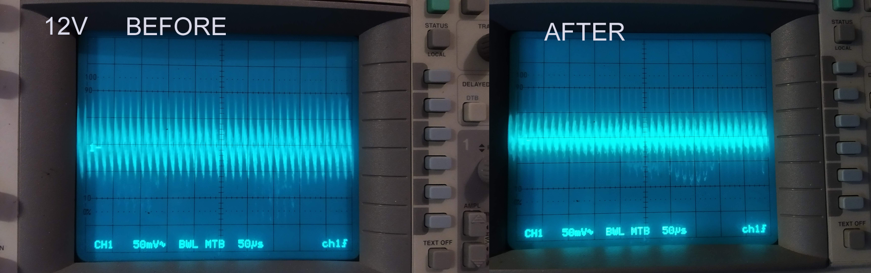

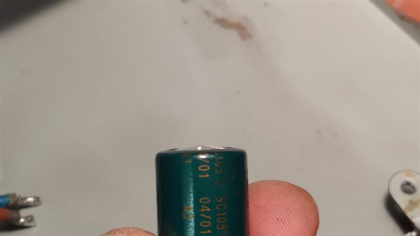

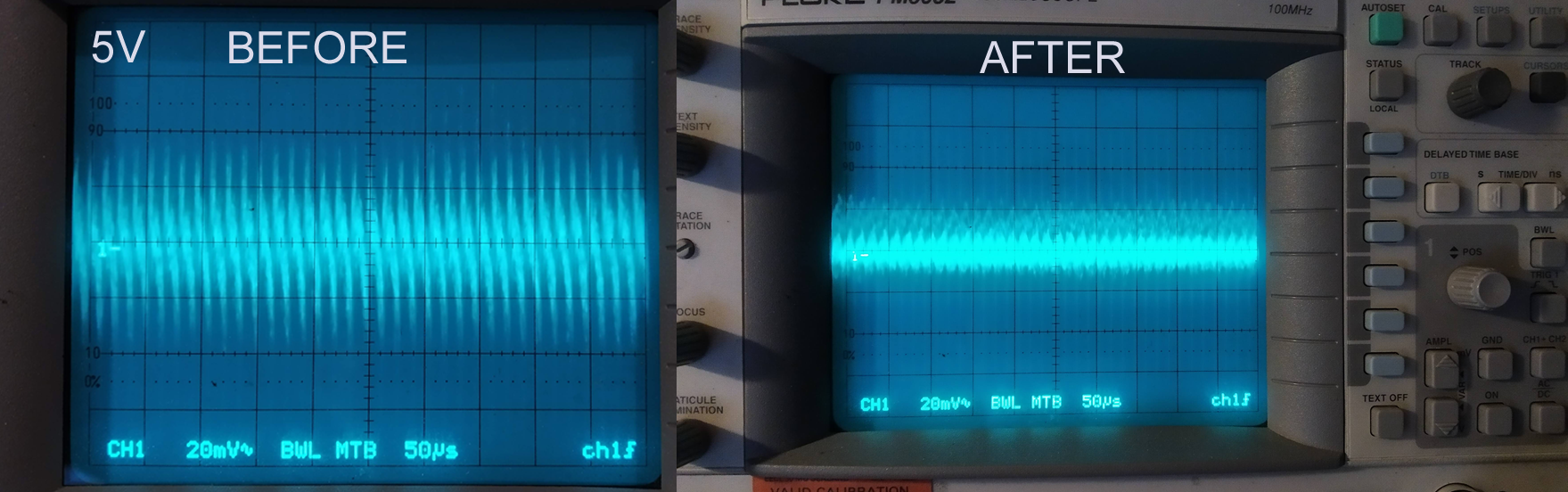

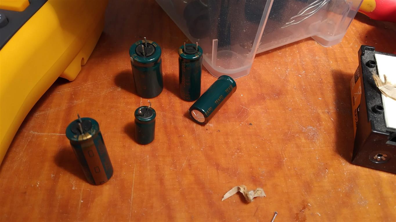

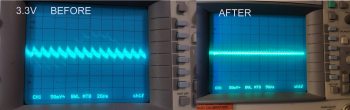

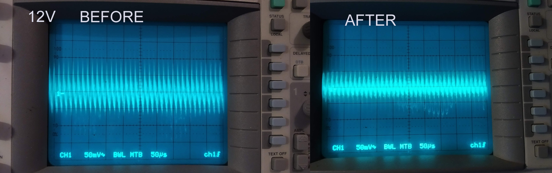

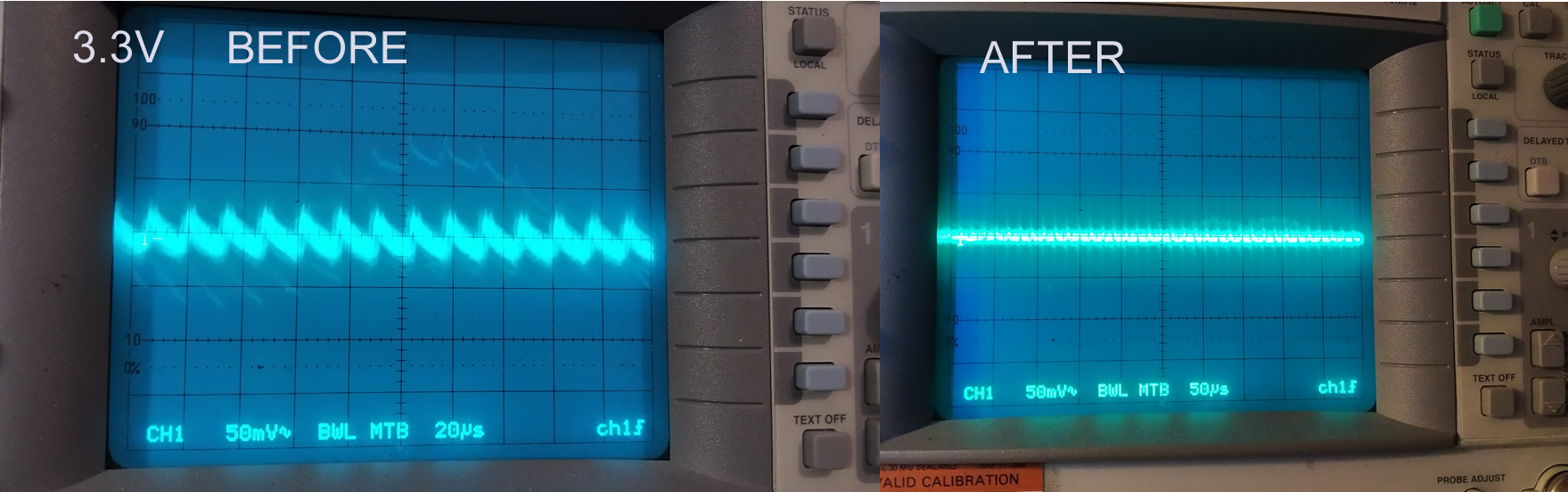

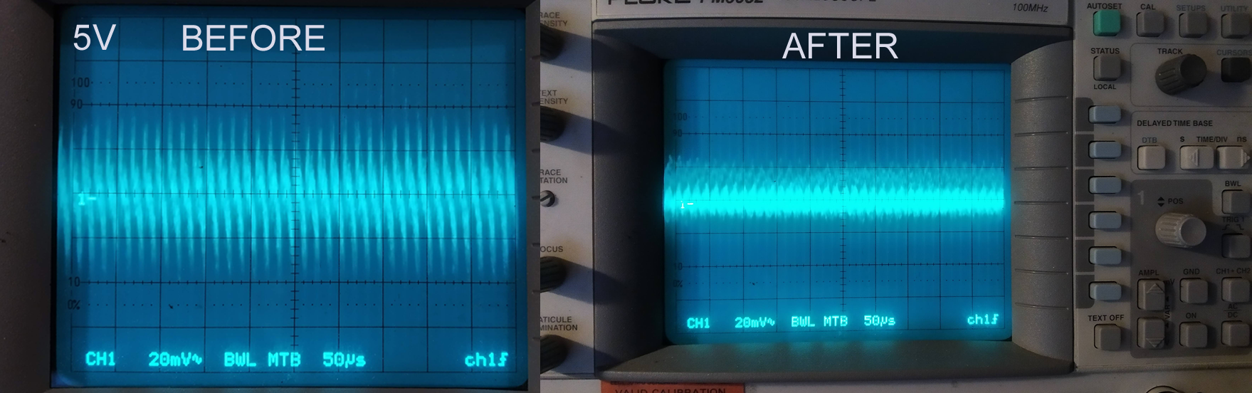

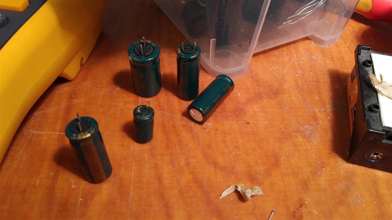

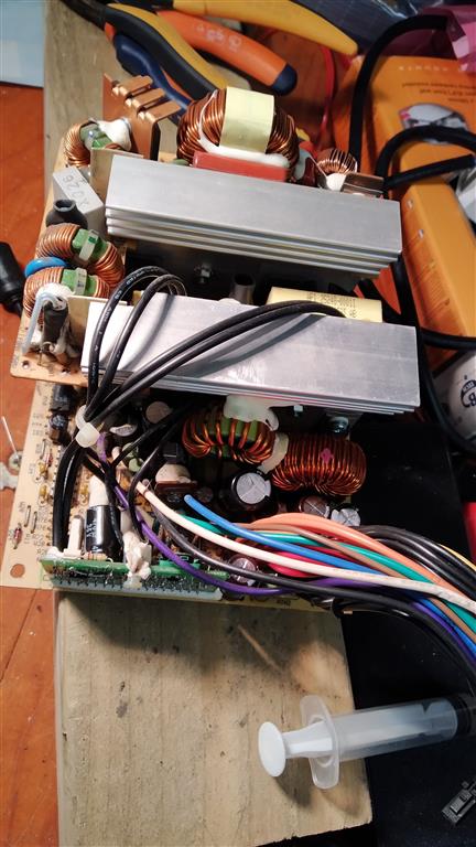

I have now replaced the bulged capacitors in the power supply. Out of curiosity I checked voltages and ripple before and after. There is definitely an improvement. Bulged capacitors were indeed reading half their capacitance - or less.
2200uF were reading between 500/800. 3300uf was reading 1900. Voltages are basically unchanged.
Attached some pictures - Sorry the 3.3V has different time base between before and after...

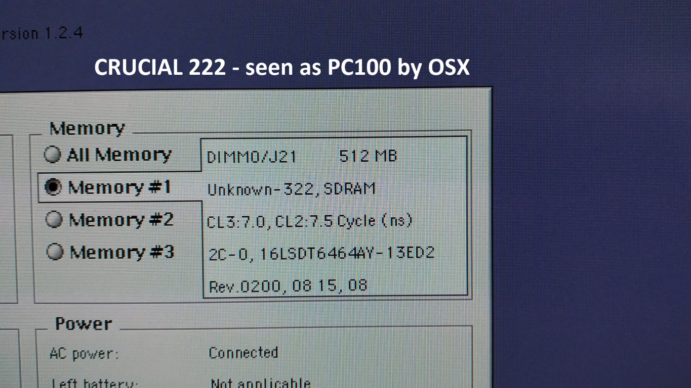

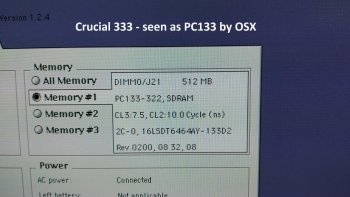

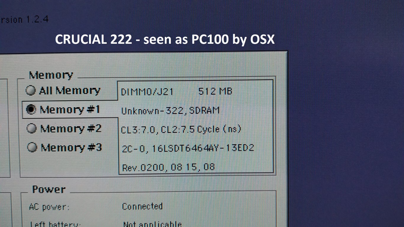

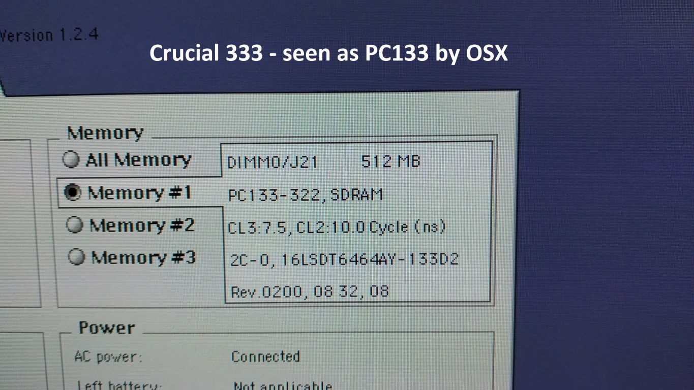

A little advise on my RAM sticks please.
As I mentioned before, I wanted to replace the faulty 256MB module and I wanted some matching sticks. I went on ebay and purchased some Crucial PC133 modules. After some misunderstanding with the seller (he sent me non-matching sticks in the first place) I managed to get some Crucial PC133-222 sticks which my OSX sees as PC100 sticks. In fact, Apple Hardware Test sees them as "unknown" but with a CL3 of 7.0us and a CL2 of 7.5us. Similar Crucial sticks, but labelled 333 (and all my other sticks), are seen as PC133, but showing CL2 of 10us and CL3 of 7.5us. Running XBench I see that the 222 sticks are slightly faster than anything else. I suspect the system shows them as PC100 by mistake as I'm not sure PC100 sticks would work with a 133 bus?
As those 222 sticks test faster than anything else I've got, I'd be inclined to keep them. Opinions?
See below what AHT reports:
Edit: I now see the "fast" memory is labelled CL2 while the other is CL3. Obviously the CL2 is faster. However it's labelled "unknown" on the PPC.
