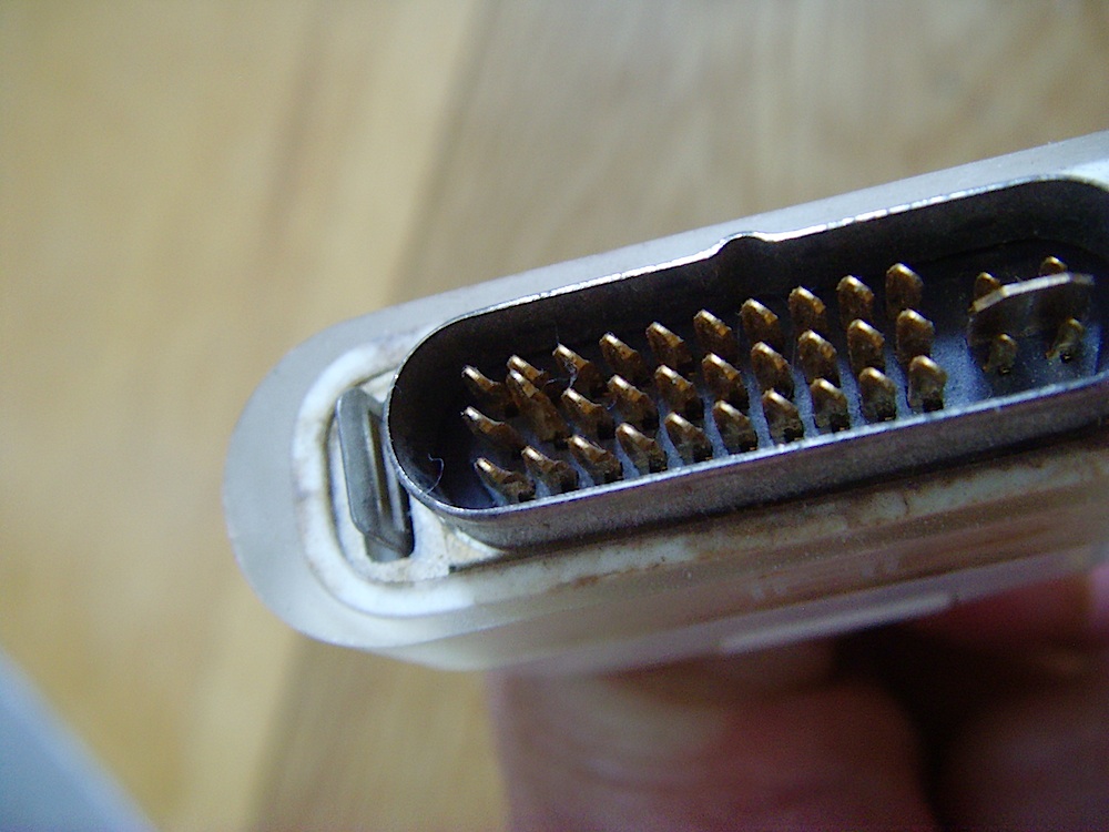

Have you looked at the ports on the graphics cards for the ADC/DVI connector? I once hard a mac that the ADC connector had flattened a pin which caused it to bridge and not boot

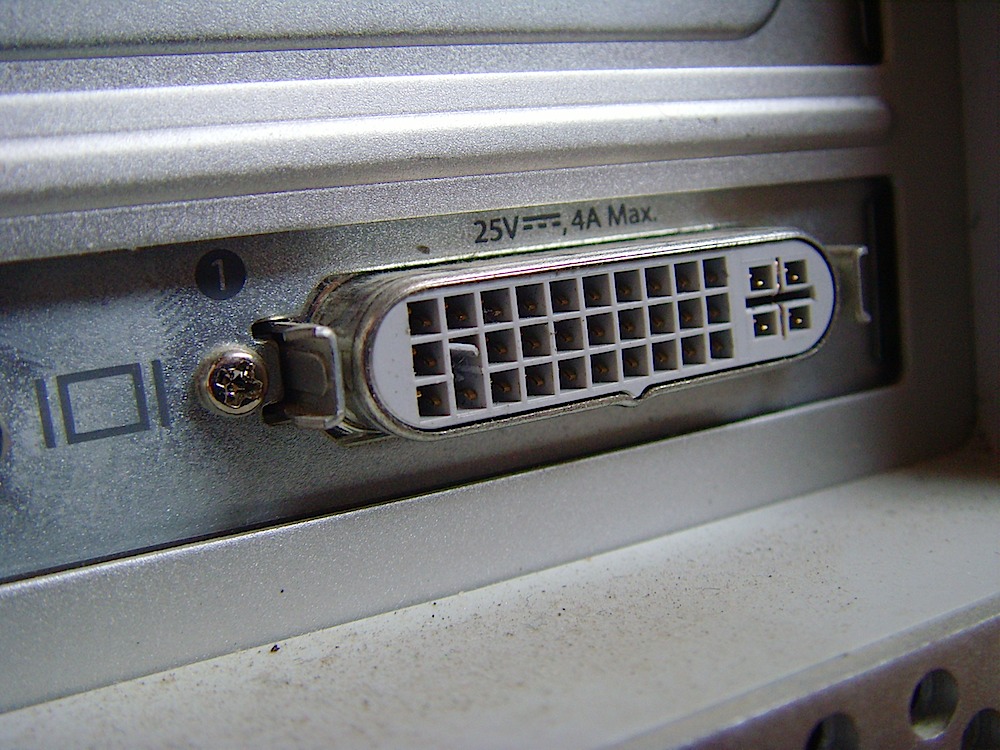

I take all that back @Dannyshing27
As these photos testify, that's exactly what happened - I guess I disconnected everything before putting more RAM and did the damage then :/
Tried again through the DVi port - still the same and removed the card altogether but still gives the triple flash (I'm right in thinking it should start with GPU removed?) I don't have another G5 card to try out unfortunately.
Damn - kicking myself if I killed it by putting the ADC in :/
Reactions: z970 and AphoticD
looks exactly how mine looked, I did manage to coax it back to life after I sorted the pins out, however you may not be so lucky. You should be able to get a boot without the GPU in however
That's what I thought. Incredible how the bins could even get bent - the fittings is so precise.
I think one of the pins in the GPU is beyond repair - the pin on the Cinema ADC plug however bent back no problem. Either way the G5 isn't waking up, so time to move on....I have my first Mac Pro on the way....
