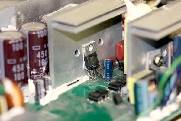

PS: Look if this is broken:
It's near the four big reddish capacitors. If it's broken (looking like the photo above) and nothing else looks damaged, maybe you can find someone willing to try to replace the broken part (I bought it for 5$ shipped).

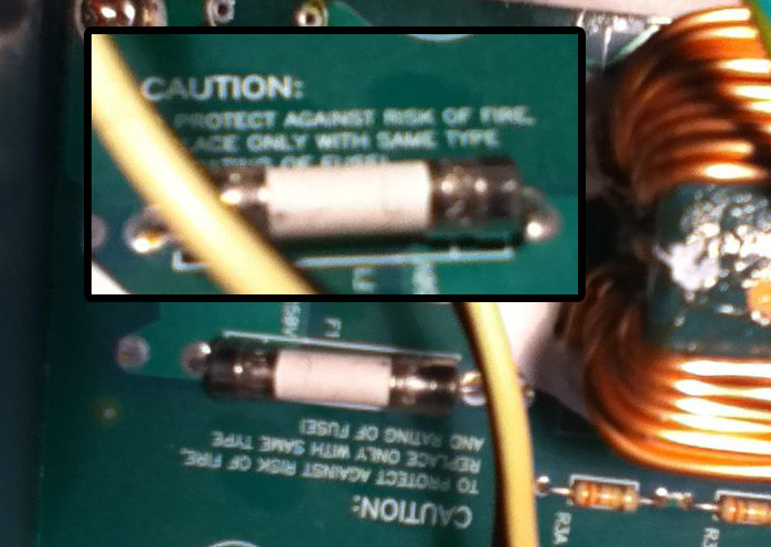

That component looks ok. I don't see any thing that looks broken.

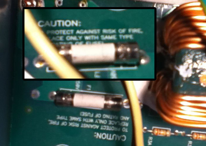

Using a multimeter, i can confirm the fuse is blown, or as best i can do without removing it. I don't think I can get the fuse out without pulling out the soldering iron.
Gonna search for anything on how to do that.

I know, its a 7 years old thread, but who knows? I have the same exact mosfet (is it a mosfet?) broken. Cannot get to read because its literally disintegrated, what code should I be looking for?
