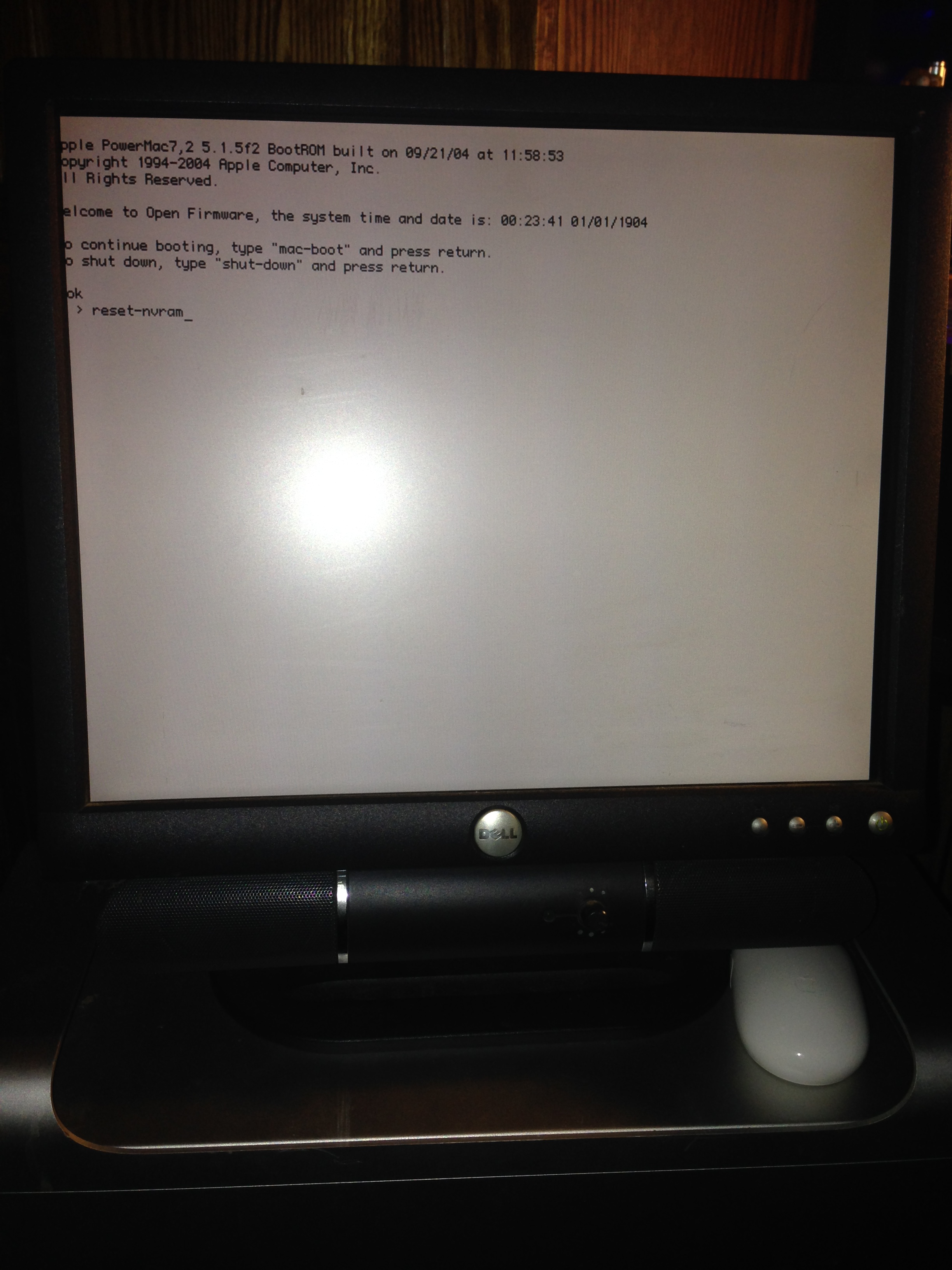

From another post-
Sorry if this is to old of a thread to reply to but I was having the same issue on my G5.
Turn the machine off. hold down the power button. You should hear a tone and it will reboot/chime again but keep holding the button and the G5 will boot into the Open Firmware.
From there type "reset-nvram", press enter, then type "reset-all", and then again press enter. It should reboot and begin to accept key presses/commands again.
Doing this will wipe the stored time/date, volume setting, and monitor resolution.
I have done this without a change as well.

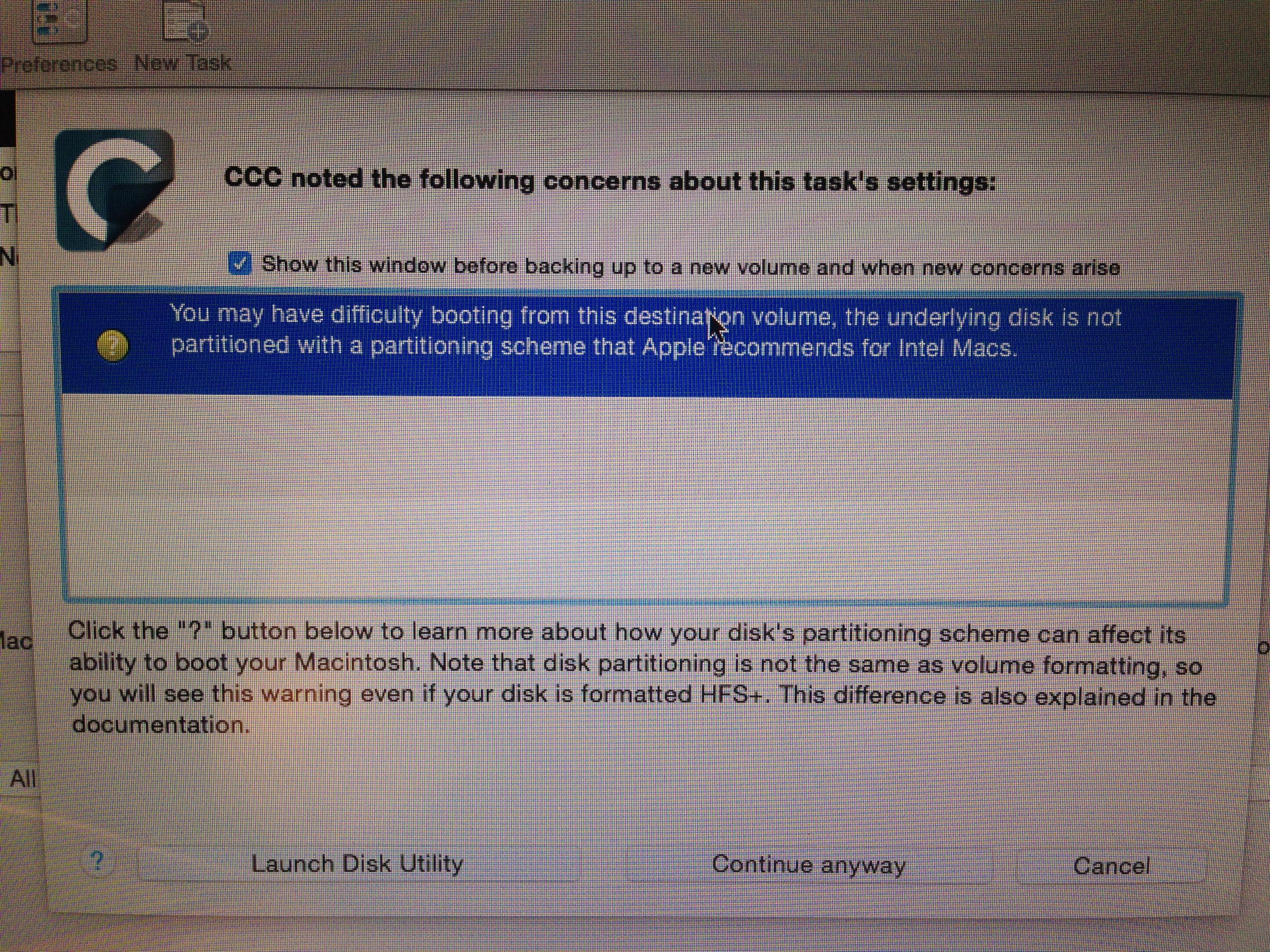

I've used Carbon Copy Cloner to restore the USB. I had come across an error about using the USB to boot with Intel Macs, but considering I'll be using PPC Mac, I don't think it should be an issue.
There still appears to be no change. I still just get the 'No OS' icon.
Thanks,
-Hunter
EDIT: One moment! It appears that I forgot to set the USB's partition scheme to 'Apple Partition Map'! It has been on 'Master Boot Record' (DOS/Windows) instead! This could have been the issue! Let me try this again...

Restoring on an Intel Mac generally sets it to GUID or MBR. You need APM.

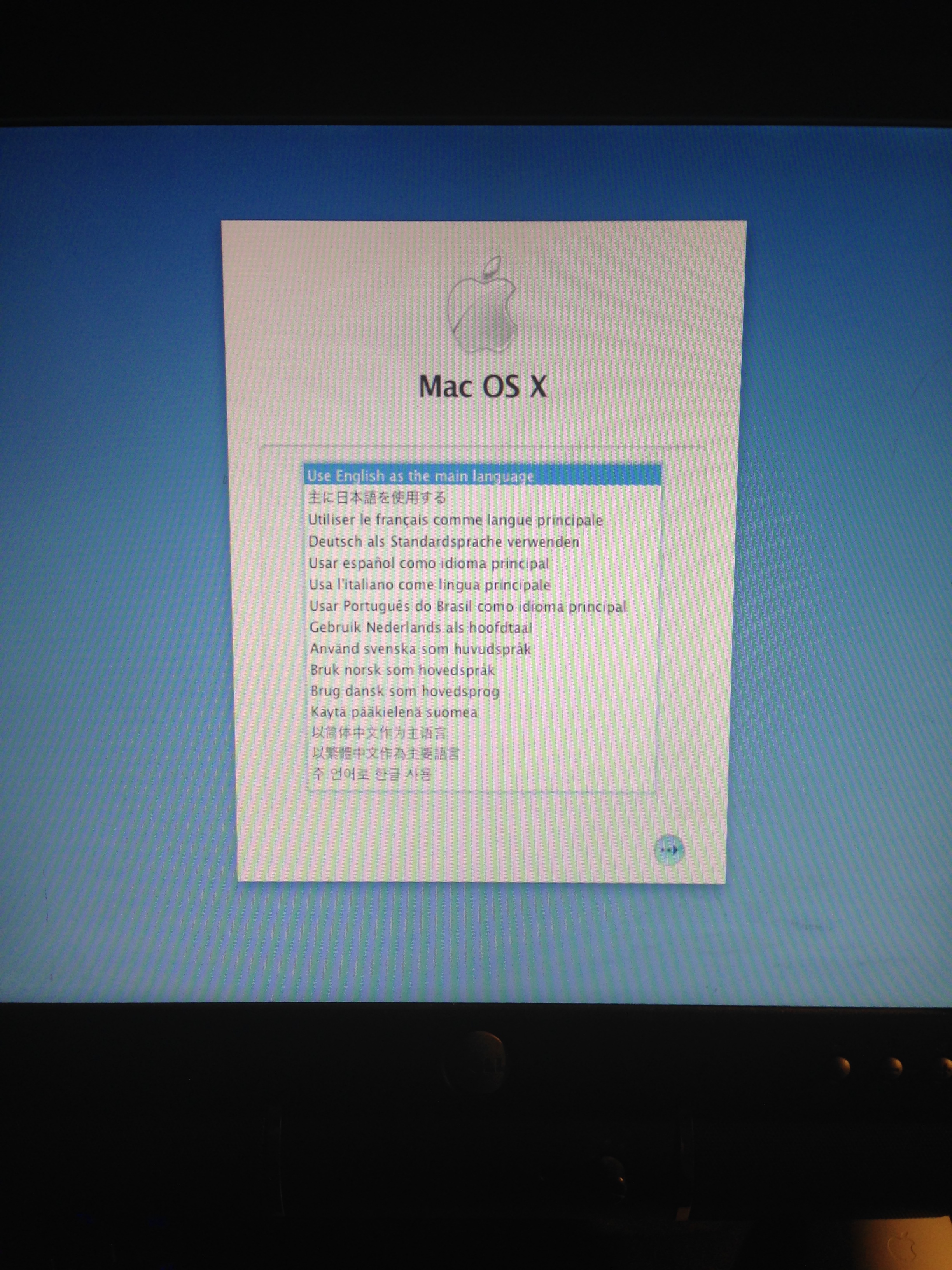

Here's another issue; I don't have a formatted hard drive! I have plenty spare drives, although I can only format them over my Windows machine. What now?
Thanks,
-Hunter
EDIT: I had forgotten that I had plugged in the unformatted hard drive prior to turning the G5 on! I'm using Disk Utility to erase, format, and partition the drive now!

Just hit Utilities --> Disk Utility. Select the drive on the left, hit erase, enter a name (usually "Macintosh HD") and hit Erase. Disk Utility will automatically format it as Apple Partition Map.

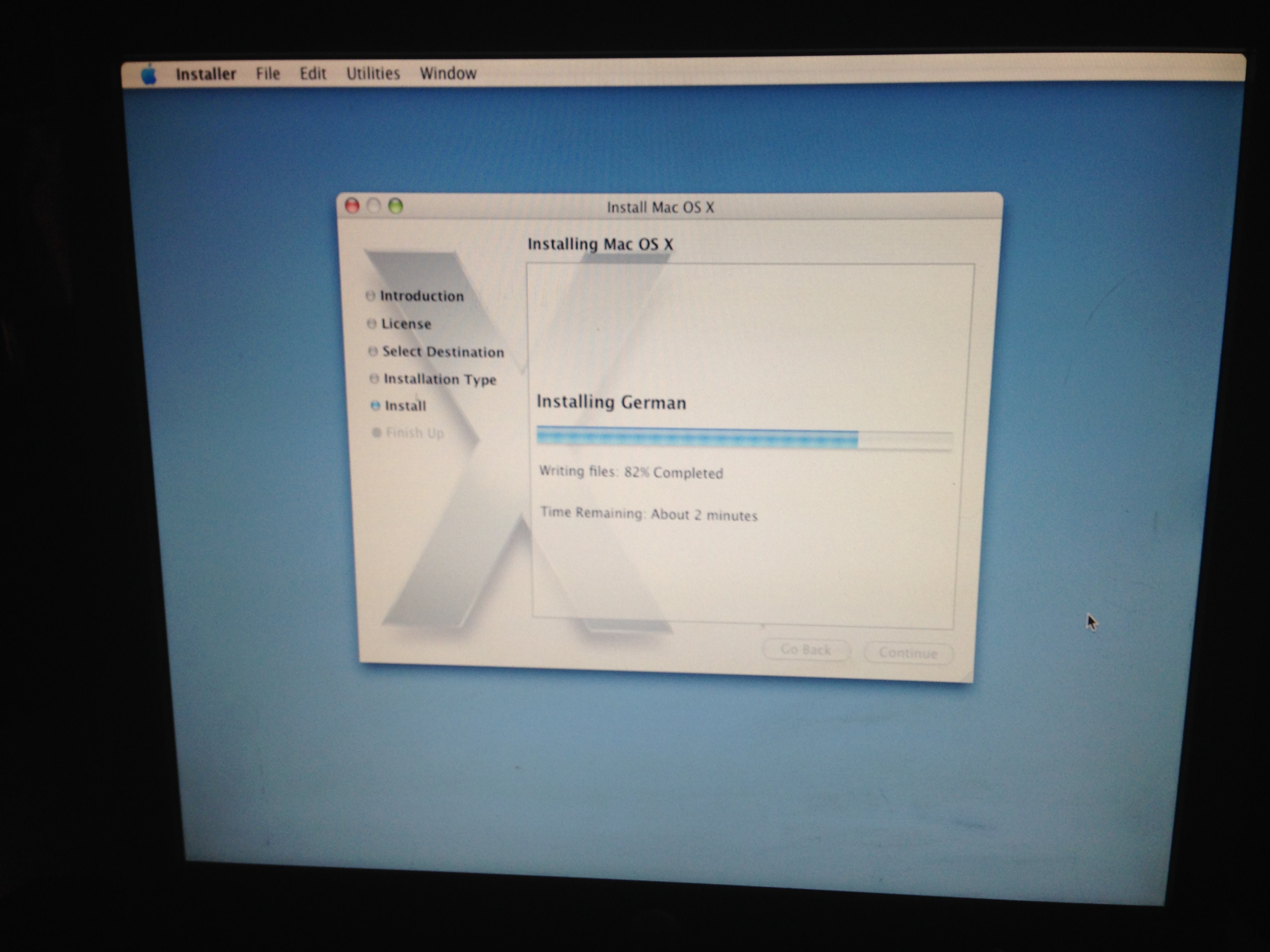

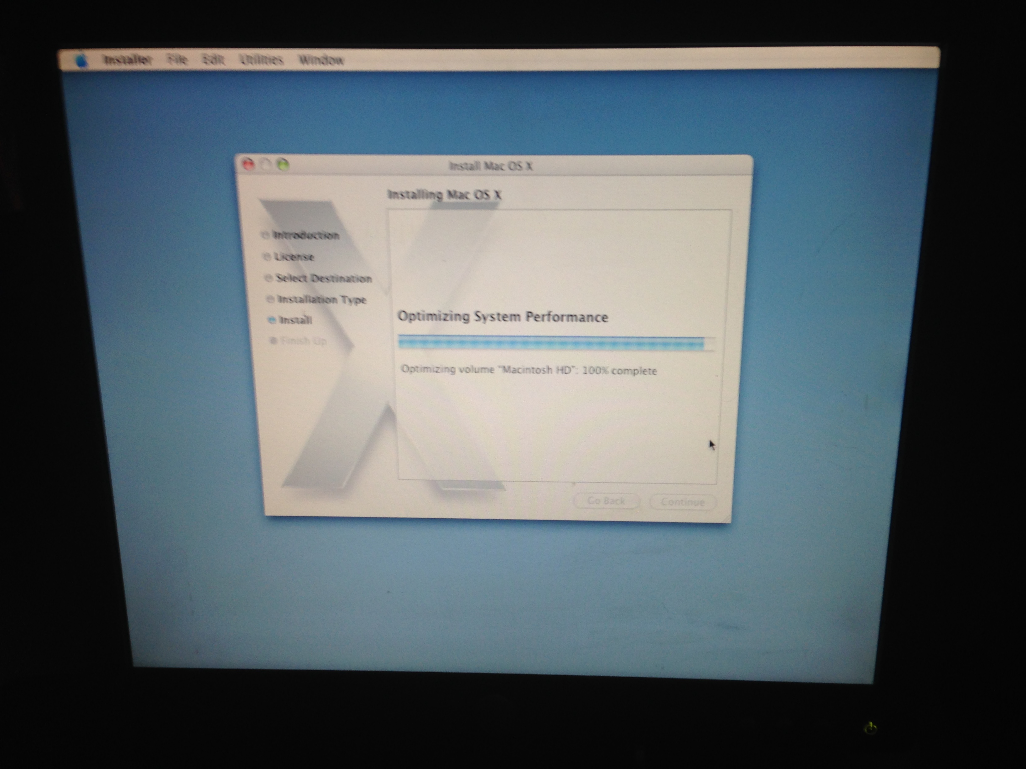

I've just done this, and it works!-
Except it doesn't.
This time, the disks are read and all appear to work, however, when the G5 reboots, the startup chime is heard, but nothing else happens. The screen is dark, and the fans become quite loud.
I turned the G5 off for a few minutes and came back to it. I turned it on, this time I didn't get a startup chime, but I got video. Unfortunately it only showed the 'No OS' flashing icon, once again.
Not really sure what the problem is. Hard drive issue?

Probably worth completely erasing the HDD, recreating the HFS+ partition and trying again. If that fails, then it's likely a hardware issue. Oh and make sure the scheme is set to APM. If it's an old PC HDD it might be set as MBR.
