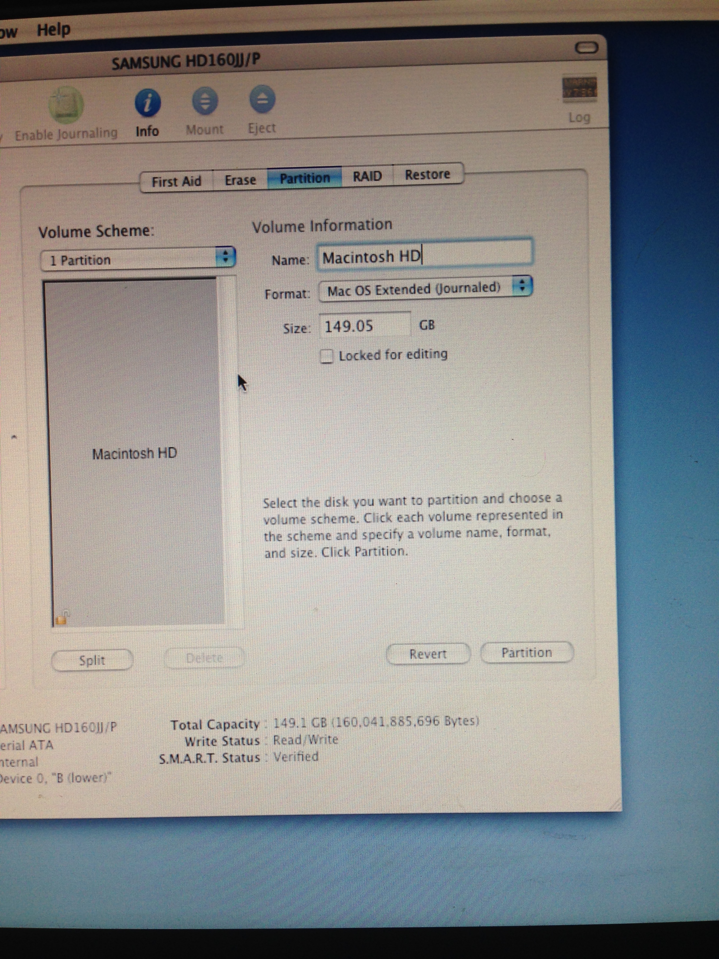

bunnspecial and MagicBoy,
That's what I thought, but it doesn't appear that I have the 'Options' box.

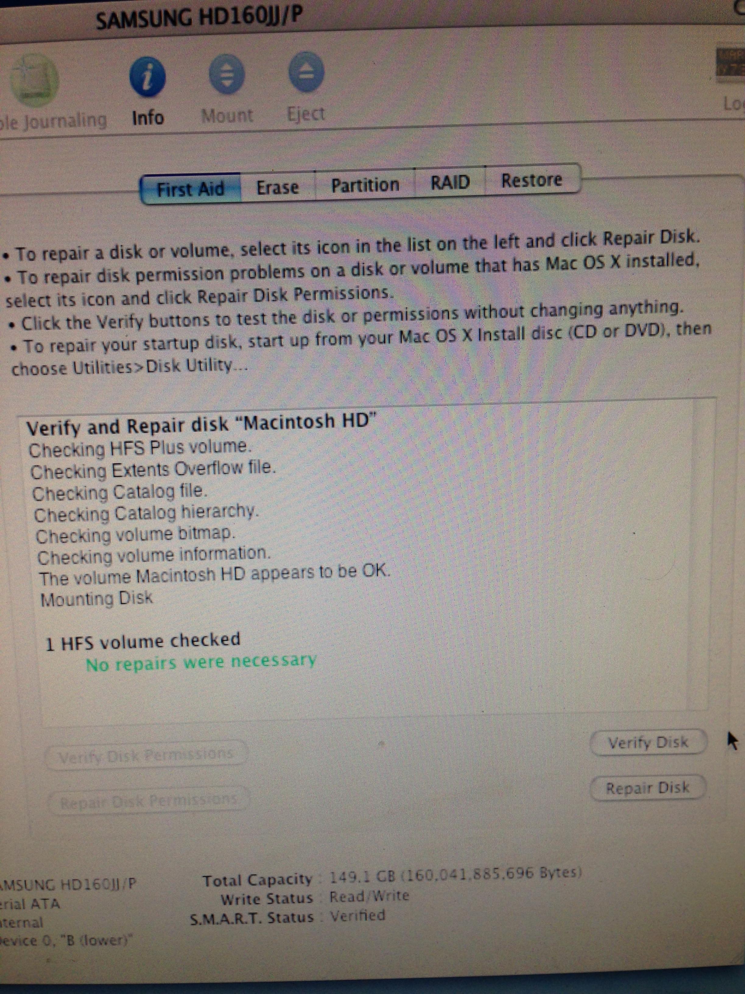

I also ran a disk check and found no issues.

Try going to Disk Utility in OS X Installer and select the drive itself on the sidebar (not a partition). Now name the drive and hit erase. After it formats re-run the installation.
Hello, all.
I took your advice, and everything works!
Thanks for all of your help!
