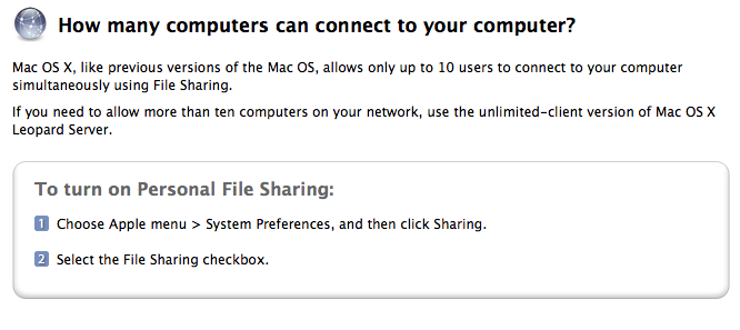

Yes, this is baked into Leopard (and maybe subsequent OS versions too). A server version would let you go past this. (see the attached screenshot)
I think the error message other users will get will be something annoying like - Can't connect to server. Please try again later. Not super helpful.
My question is whether other software gets around that limit, like if you compiled and ran a separate FTP app instead of the one coming with your Mac. Is it just built-in software and underlying OS things - like file sharing, afp, etc? Or is the limit on 10 users deeper than that even?
