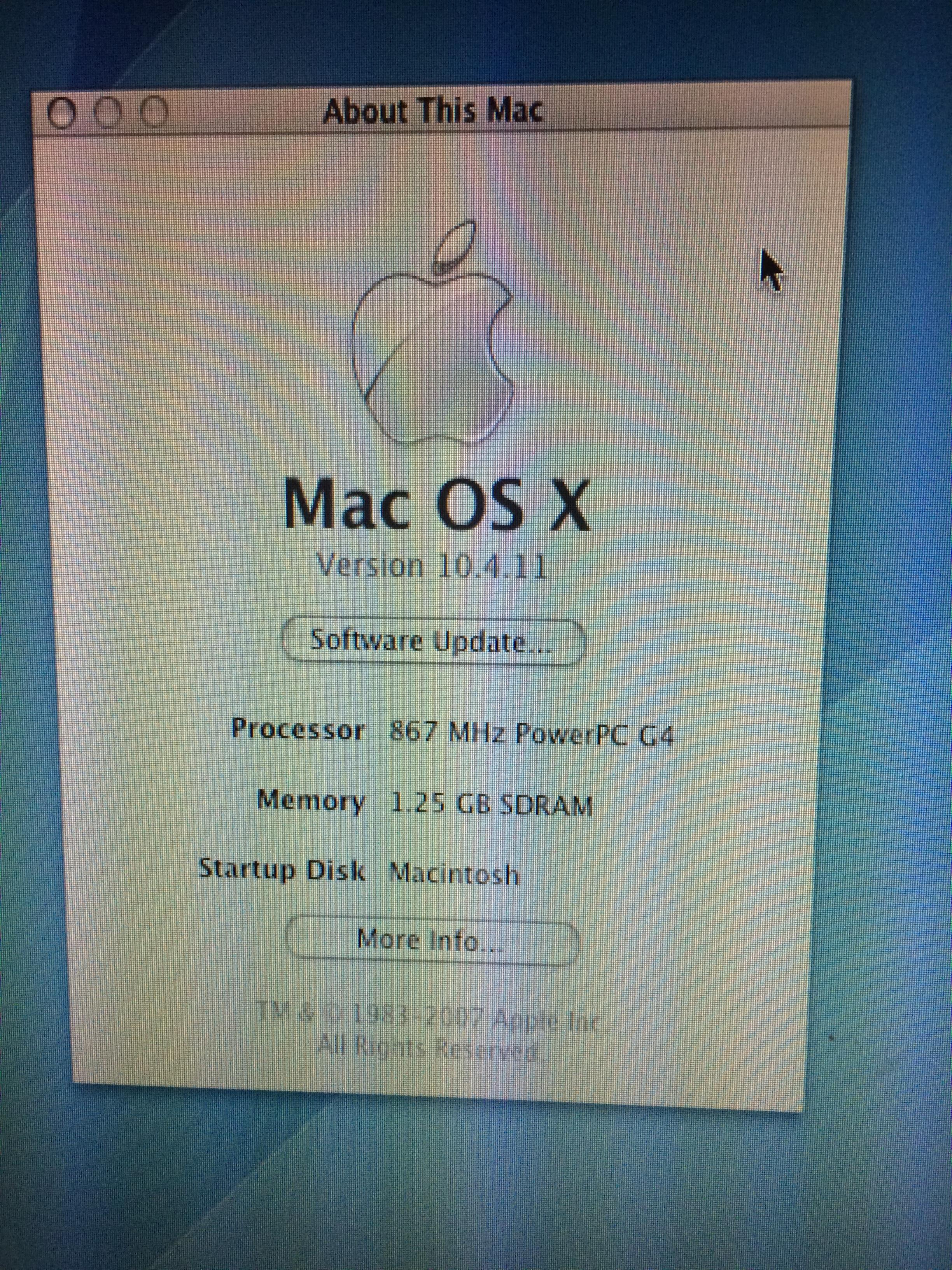

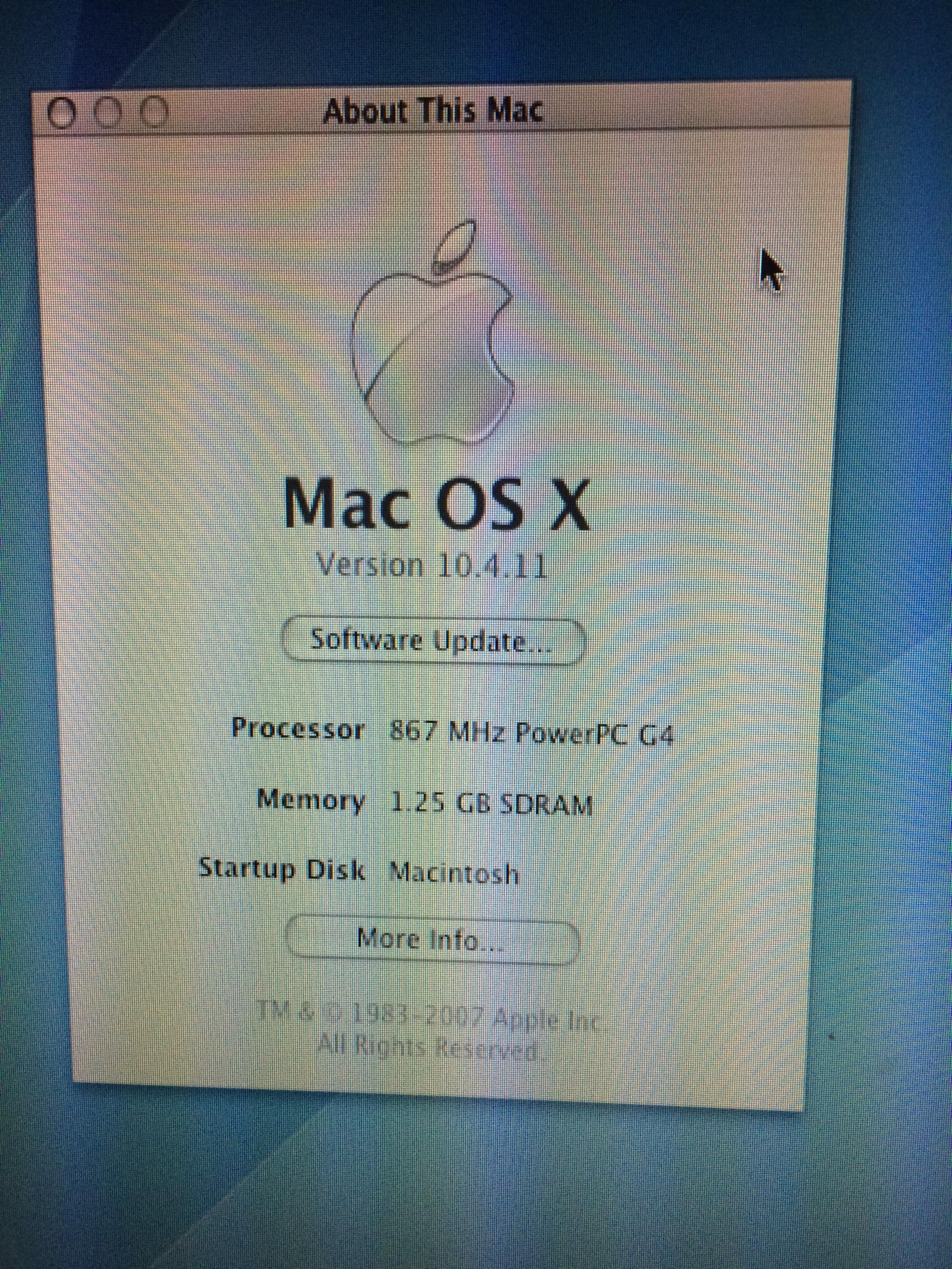

Ohh yeah.. thats what i thought, well then its just to restore i guess, i have been thinking about overklocking this 800Mhz to 867Mhz... it seem simple and i cant imagen it would be any danger at all, its just 67Mhz more than it is now.. I guess a major overclocking is not a great idea due to overheating and such.. i think 800Mhz to 867Mhz would be just fine.
Well.. this is what i did, now i will not have any issues with installing Leopard.. its running nice and smooth.

Nice. How did you go about overclocking your QS?
This method?
http://power-mac-g4.com/g4quicksilverclockup.html
Since my DP1ghz is humming along, the above method is a weekend project waiting to happen with my single 733Mhz.

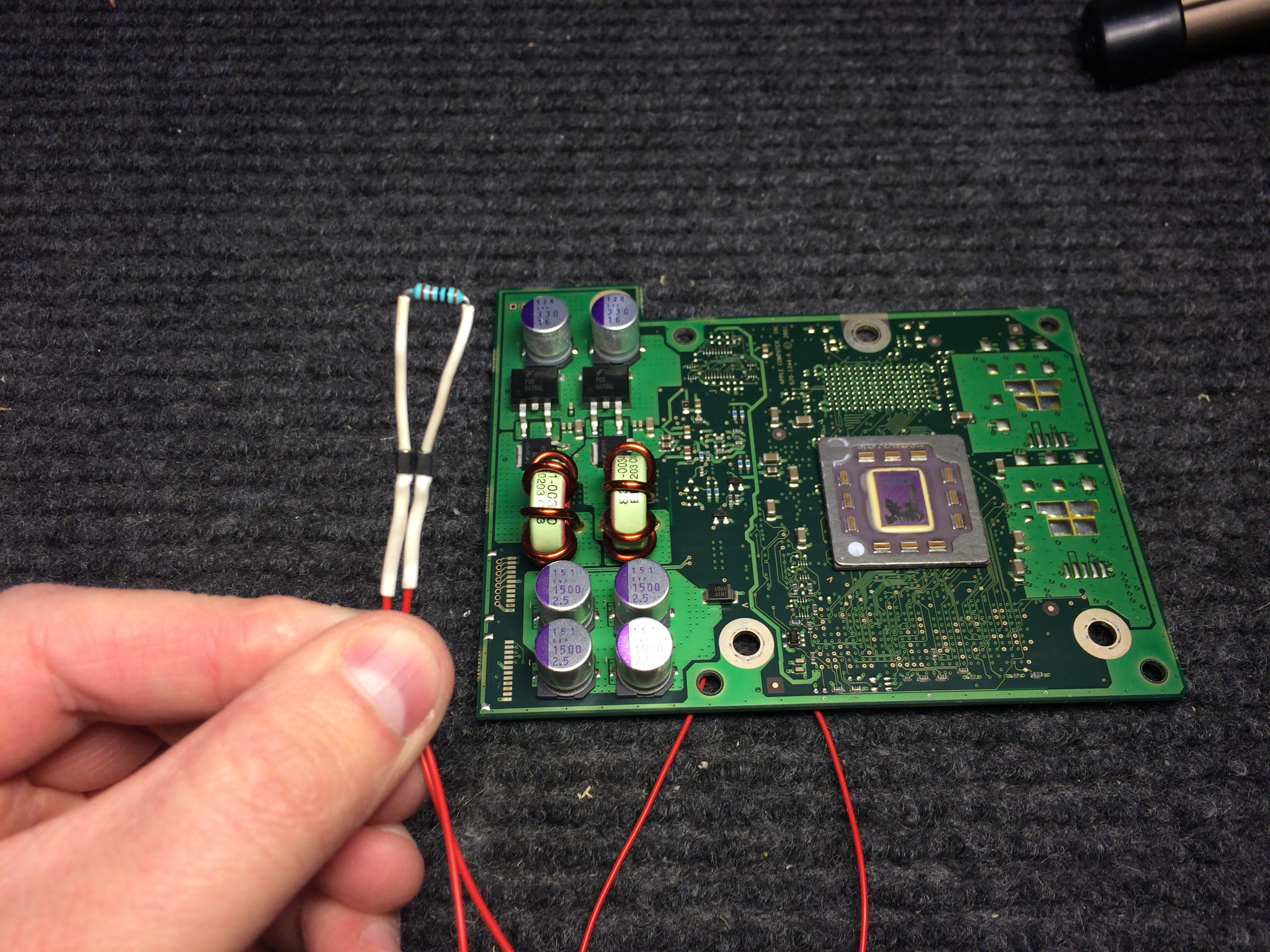

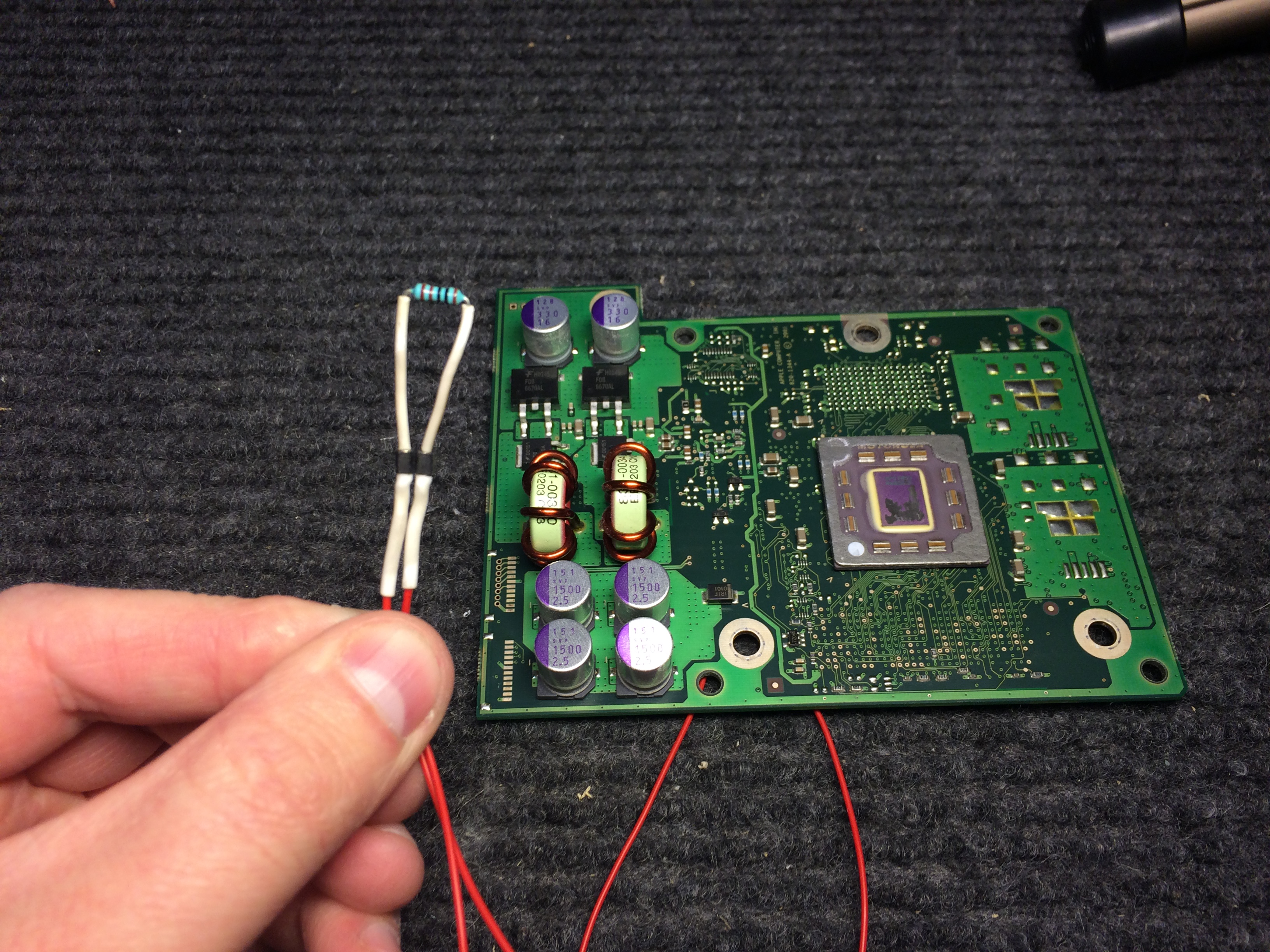

Yeah, pretty much but i did a different mod, i used a hole mounted resistor and soldered some tiny cables on to the PCB so that i can take the resistor out and go back to 800Mhz without taking out the CPU. In the past i have done similar things with dip switches and several resistors on some of my friends Power Mac´s so that its possible to choose what ever Mhz is wanted. We did not get the computer to start over 933Mhz though, i remember at 933Mhz it was getting very warm as well so i think with standard cooling 867Mhz is the best.
[doublepost=1492287794][/doublepost]Ohh.. this took me 35 minutes at the most..
Clean job - nice. Did you use an online resource or did you knock it out from memory?
It was getting more and more clear to me when i was thinking about this modell that this is what my friends used to have back in the days when i didnt know a **** about Mac OS, and i remember more and more when looking att the CPU, i had to check online where to put in the new resistor though, i could not remember that. Maybe i will put in some type of switch for the three stages that would possible be working for this model, 800Mhz, 867Mhz and 933Mhz, if this one will boot with 933Mhz i will have to get some more CPU cooling.
Right now with 867Mhz, its not getting even a tiny little bit warmer than with 800Mhz, so thats good.
