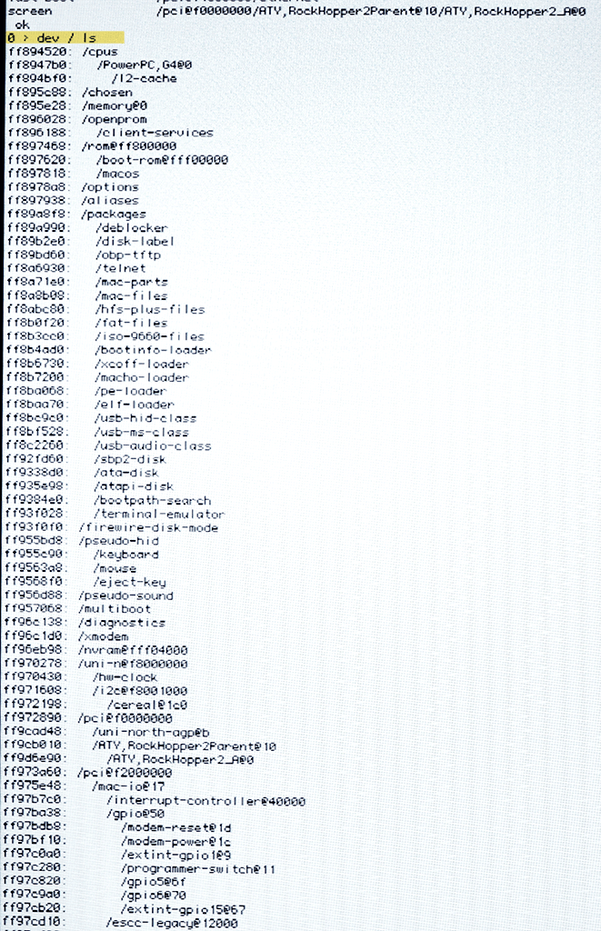

Your G5 will boot from any Mac OS X 10.4 or 10.5 retail DVD. The minimum OS for your model G5 was 10.3.4. You do not require a pre-installed system of any kind.
(Assuming your MacBook Air is running a more recent OS such as 10.11 El Capitan or later, otherwise the Disk Utility instructions are a little different)
1. Insert the USB drive into the MacBook Air and use Disk Utility to Erase the device. Choose the "Apple Partition Map" option to prepare it as a boot device for your PowerPC Mac.
2. Once formatted, restore the .dmg file to the USB drive by selecting the new volume (e.g. 'Untitled 1') from the left panel and then choosing 'Restore' from the Edit menu, selecting the 'Image...' option.
3. Once completed, eject the USB drive and plug it into the G5.
4. Boot the G5 into Open Firmware by holding command-option-O-F.
5. Type 'dev / ls' to view the G5's OF device tree and look for your USB device which has a 'disk@X' attached, this will be your connected USB drive.
6. You then tell OF to load from the USB device with a command such as;
Code:
boot usb1/disk@1:,\\:tbxi
(Using the appropriate numbers as per the dev tree lookup).
That should boot the installer.
If you burn the .dmg to a DVD, the boot sequence is simply "hold C on startup" instead of using the OF commands.
EDIT: Match your USB device 'alias' (e.g. usb1) to the device tree by looking it up with the 'devalias' command.

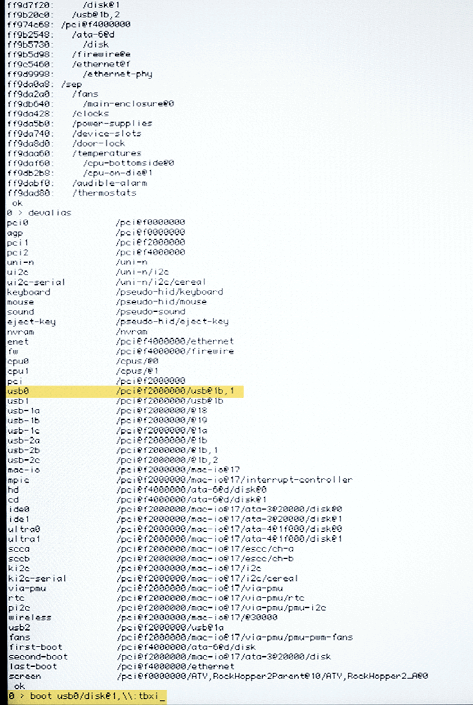

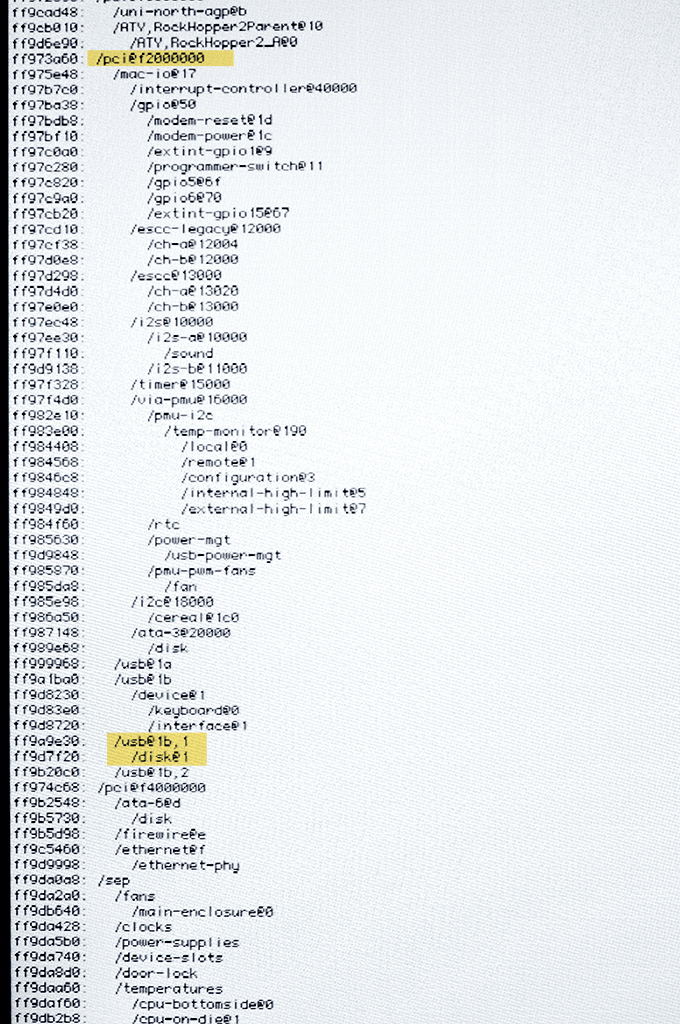

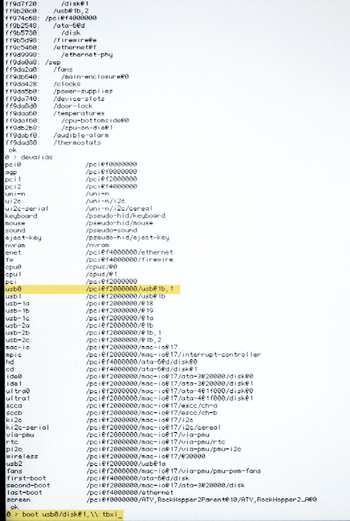

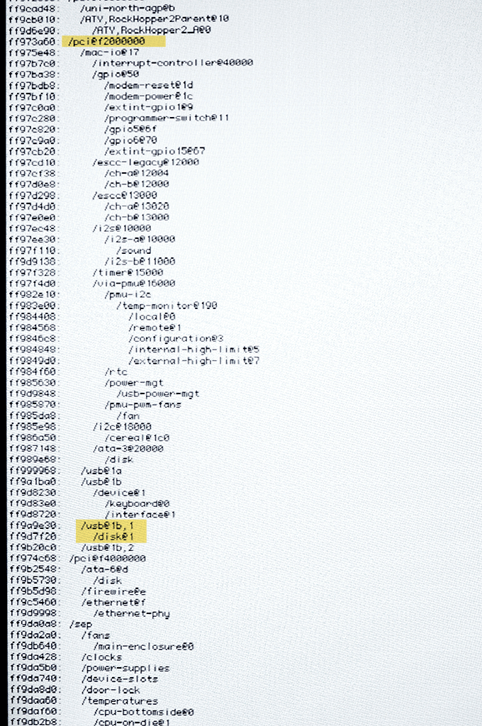

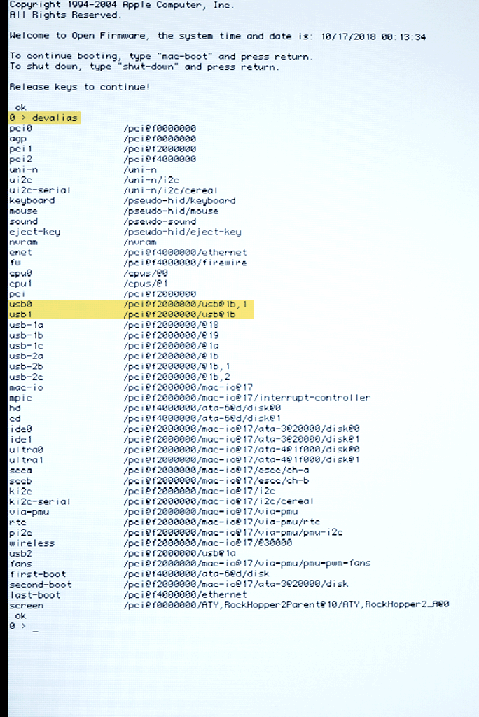

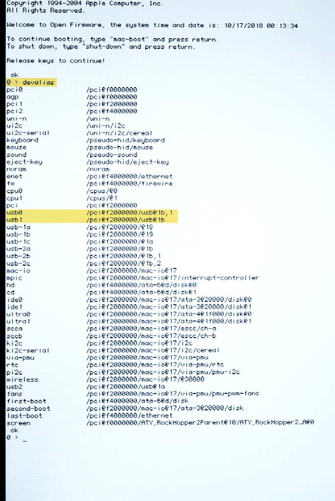

Hi John,
You came close. The USB should still be bootable, despite the manufacturer's recommendation. Navigating Open Firmware can be a fine art. It's not like any other Mac interface, nor like a standard PC BIOS in any way.
Try going through the following;

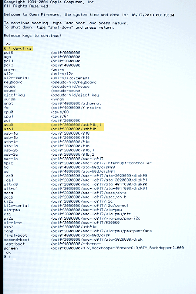

1. Boot into OF again with the USB drive attached and get your 'devalias' listing to see the shortcut / alias names to the USB devices. Here on my Mac mini G4, 'usb0' points to the full device tree address of '/pci@f20000000/usb@1b,1'.

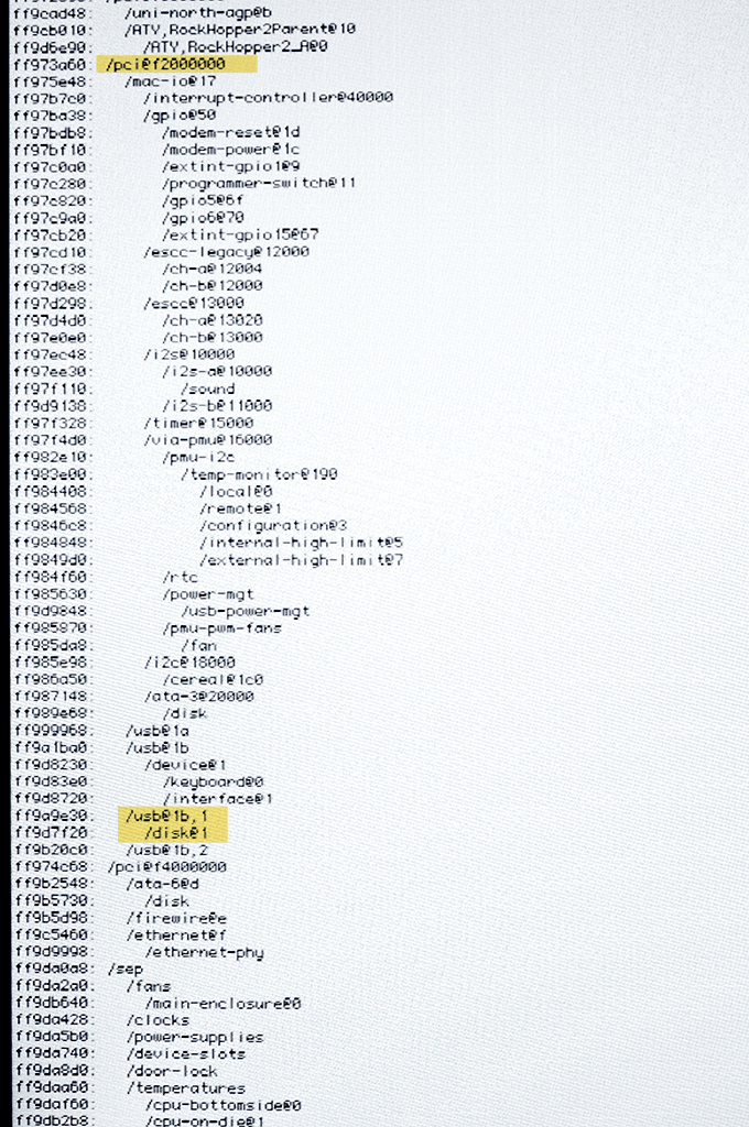

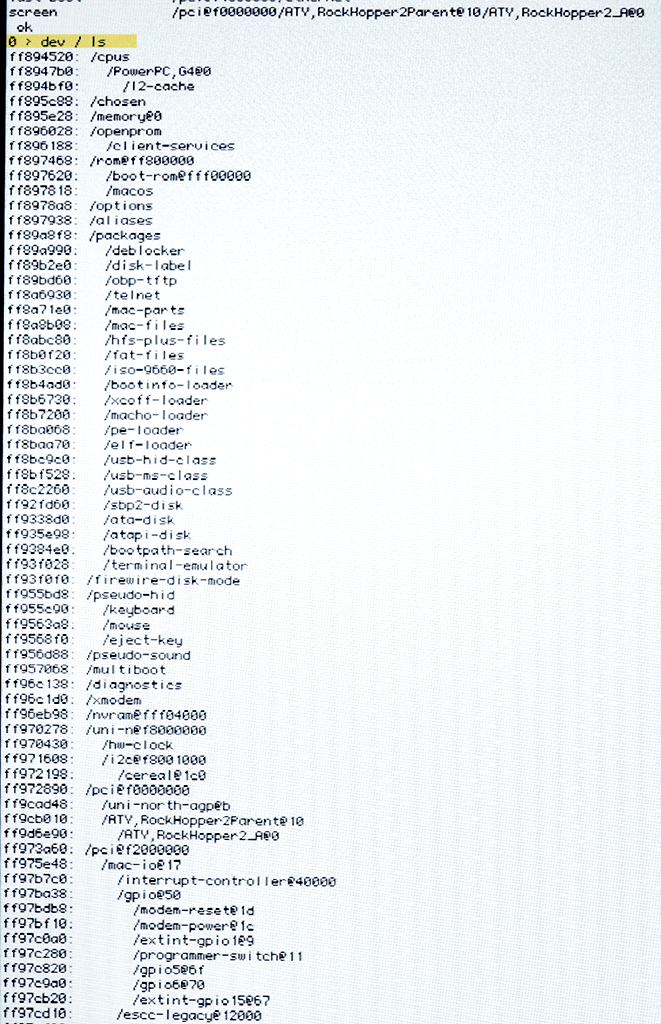

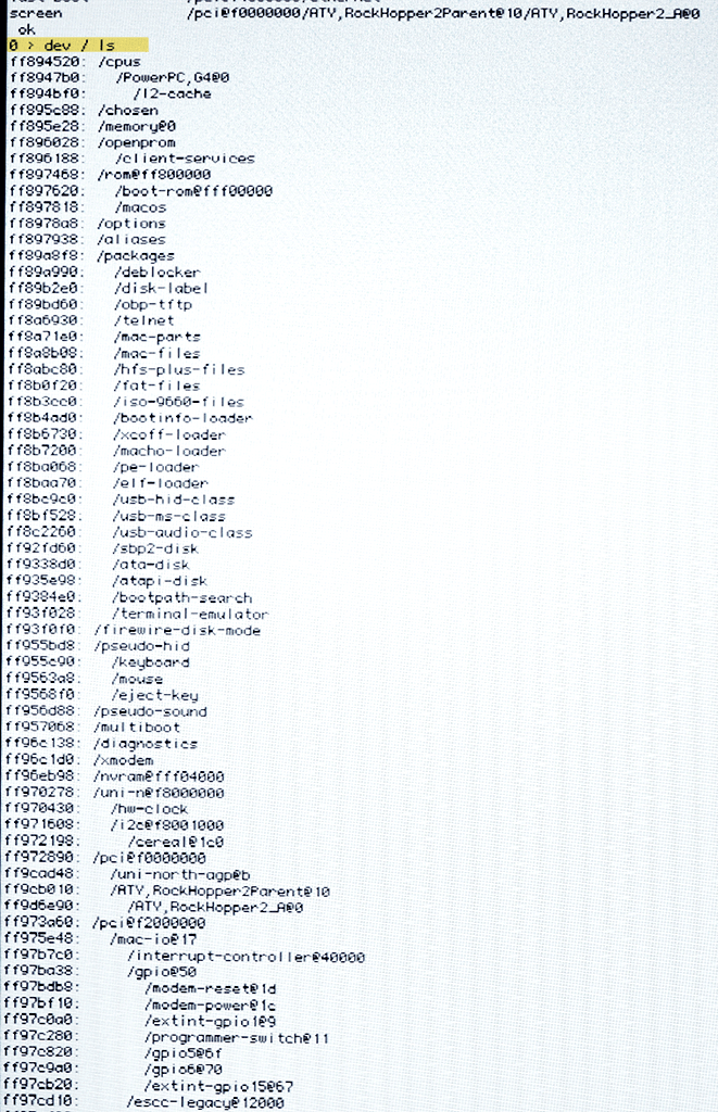

2. Next, I've executed the device tree listing with 'dev / ls'. You'll likely be prompted to view the next screen before you see your USB drive in the list.
3. Here in my Mac mini G4's device tree. I can see the '/pci@f20000000' device in the tree, which is the parent responsible for the USB buses. I can see 'disk@1' which is a child of 'usb@1b,1', which is a child of 'pci@f20000000' at the root of the device tree.
4. Executing 'devalias' again, I can confirm that the '/pci@f20000000/usb@1b,1' device has the alias of 'usb0'.

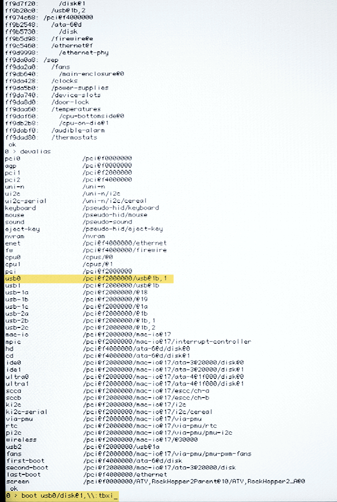

5. Lastly, I have instructed OF to 'boot usb0/disk@1,\\:tbxi'
Because of the device alias, this is shorthand for:
'boot /pci@f20000000/usb@1b,1/disk@1,\\:tbxi'
If you're curious, you may find the ',\\:tbxi' part of the command is superfluous as this is the standard behaviour of 'mac-boot'. Open Firmware searches two levels deep ('\\') for a TBXI compatible boot loader. In our case, this boot loader is called 'BootX' and is located at '/System/Library/BootX'
