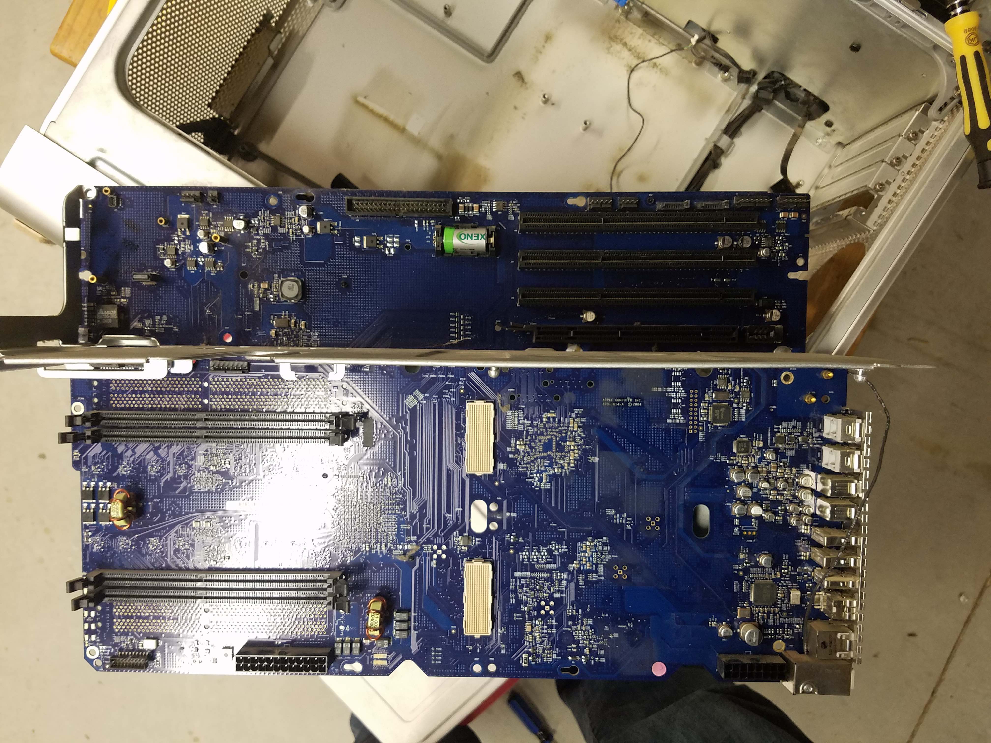

I removed the the logic board and flipped it over and discovered a whole different world. Any good diagrams of what I am looking at? Or is there a detailed diagram of the whole system?

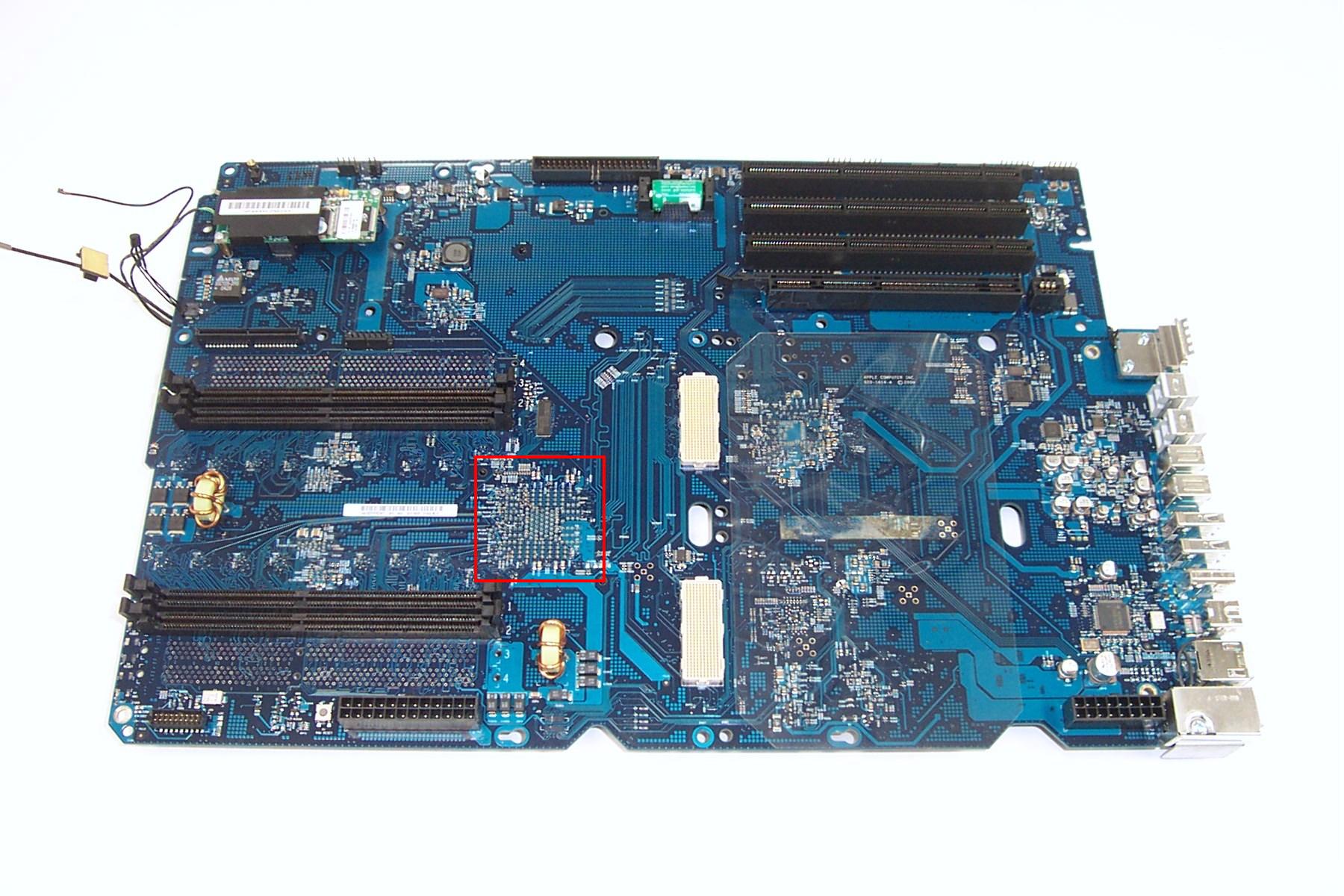

Is it possible you could provide us the specific model information? That would make it easier to assist. Without knowing I quickly looked up a picture of the system board and found the following. The red square is the area where the problem lies. It's thought the solder for this chip becomes brittle and cracks. Heating it up is supposed to reflow the solder so that it works:

[doublepost=1508809412][/doublepost]PowerMac G5 Model No a1047 EMC no 1969c
Pretty sure it's 2.5ghz

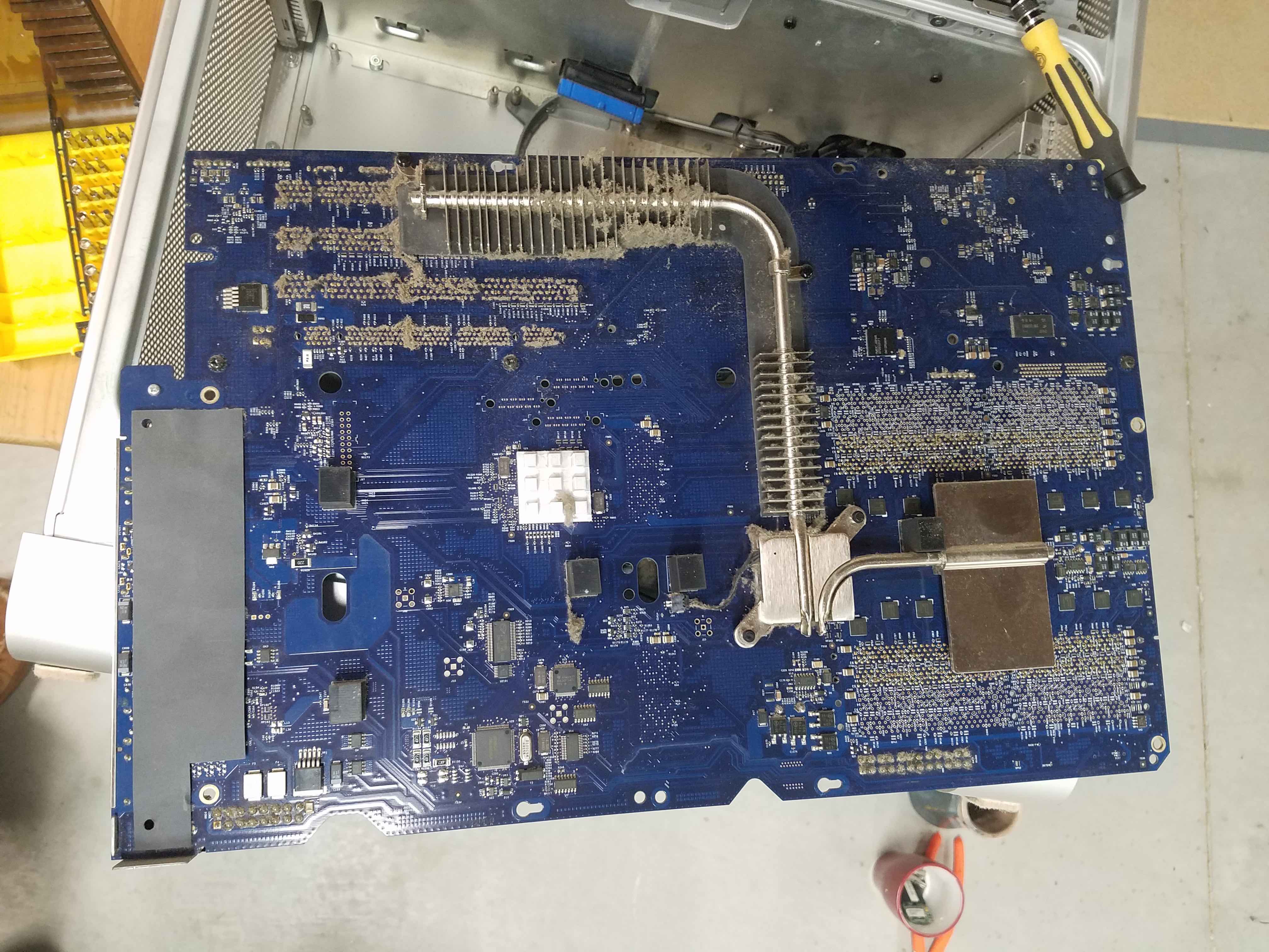

I realize the dust balls are pretty extreme, I took the photo seconds after removing the logic board. I didn't know there was anything behind the board.
In all honesty, would simply removing all the dust bunnies bring this steed back to life?
Not likely. Dust won't cause anything other than higher running temps.. and it looks bad.
Once you've cleaned it up, look for any blown components and clean up any corrosion which may have built up from humidity.
The build up at the backs of the lower two power connections looks suspicious. Get some Isopropyl Alcohol on a cotton tip and see if that cleans up at all.
As already mentioned it's unlikely to do so if the problem is a failed system board. However if the system board is OK and it is merely overheating then cleaning up the dust could resolve the issue. Or the dust could be causing electrical shorts which would clear up after a cleaning.
If I had to guess I would say the system board has failed and cleaning it won't fix it. But the cleaning is free with the only cost being your time to do so and reassemble the system. Given how dirty that board is it just might be worth that time.
