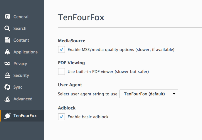

Stuff like youtube and cnn dont even work.
As you can see in my video all of this is possible and more so on your more powerful G5. One starting point, for Youtube make sure you have MediaSource box ticked in preferences. After this, it's just a case of streamlining your apps.

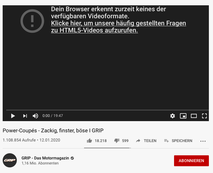

Now i have tested youtube with TFF for the first time but i dont get a video. Is this normal?
On Roccat youtube is working well
Your browser currently can not recognize this video formats.
Click here for our FAQ related to HTML5 videos.
