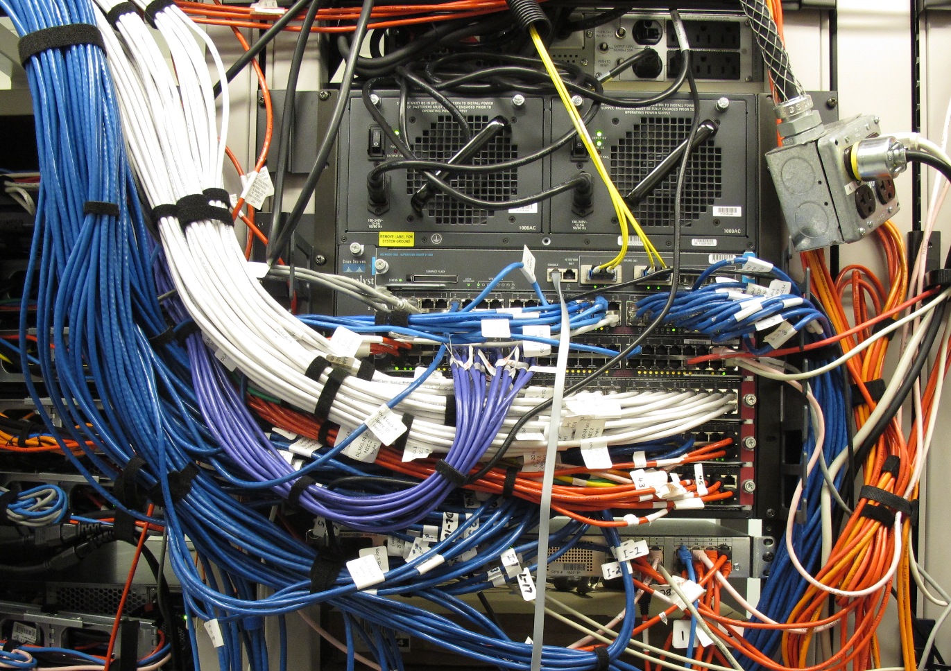

Oh man that looks like a fire hazard waiting to happen. So many people on here are drinking too much thunderbolt kool-aid. Apple got a couple peripherals out the door with it, and beyond that it's unlikely that they care. The people who expected fast adoption and immediate cheap peripherals were all out of their minds given the required driver and hardware development combined with the chip cost for a product that serves a very limited market (high bandwidth requirements and stuck to a macbook pro).
