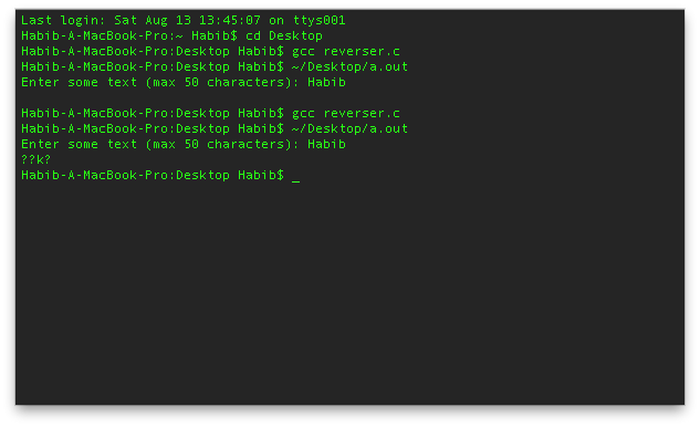

Hi guys, I think this is my first post here. I am looking for a solution to a problem to a programming problem that I've spent ages on, but can't seem to fix. I've searched for other threads, but none are using the same code as me and they seem to be complicated.
Okay, so I am a beginner to programming and am using this problem as an exercise. I am basically trying to print out text input by the user, but in reverse. Here is the code:
Code:
#include <stdio.h>
#include <string.h>
int main ()
    char text[50];
    char reverse[50];
    int t;
    int r;
    int null;
    printf("Enter some text (max 49 characters): ");
    scanf("%s", text);
    r = strlen(text) - 1;
    null = r + 1;
	for (t = 0 ; t <= null ; t = t + 1, r = r - 1)
        text[t] = reverse[r];
    printf("%s\n", reverse);
    fflush(stdin);
    getchar();
I am using TextMate and compiling using gcc in the Terminal. Whenever I enter the string, it just prints out garbled nonsense of the same length. I've introduced a null variable, which is equal to the length of the string plus 1, so the for loop knows when to stop. Before I used that, I used the r variable for that, then I spotted my mistake. Problem is, the output hasn't changed much, still just junk.
Bizarrely, when I change the text and reverse character amount from 50 to 51, it just outputs a blank line. This is really confusing, please help. 😕
Here's a screenshot of me compiling and running the app, once with the 51 chars in the arrays, the second time with 50.

Thank you so much! I went over the code so many times, I can't believe I missed out such a tiny thing. I've reversed the location of text and reverse in relation to the equal sign. I now have:
Code:
 reverse[t] = text[r];
This seems to have fixed it, but now I see a question mark at the end of the reversed text, is this the null character?
Back to the drawing on the sheet of paper. Look at the very first and the very last characters that are copied. Where do you take them from? (I don't have the latest source code, so I don't know if it's the first or the last character that goes wrong).
I see! Because null is r + 1, that's where the null is in the text, but then the for loop takes the character before 0 as well, because I didn't start at the null character.
So, null just equals r now, and then I'll just assign a null terminator to the character after the last assigned one.
