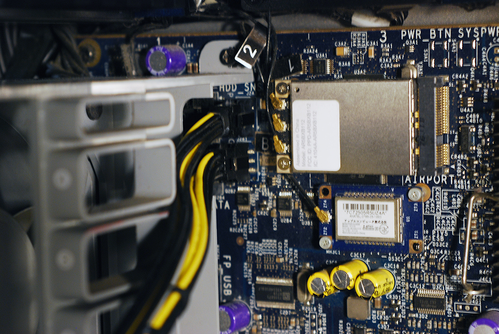

In the above photo you forwarded, i see the cable sockets ok, thanks for that !
BUT i also noticed something that puzzled me some weeks ago....
When i opened my macpro 2 stickers fall out of the case. Both black labeled 1,2. And now... i see them in the image you attached !
Do you know what cables are those with the black stickers numbered 1,2 so i can write notes down and make 2 stickers for those please ?

The numbers you've encountered are numbers for Airport (wifi) antennae. While Apple insists they are numbered for a reason, a lot of users (myself included) think the numbers were assigned at random and do not mean a thing. Oddly enough, my Airport card works best when number 2 and BT is connected, BT standing for bluetooth. The BT module, on the other hand, is more than happy with number 1 connected. Short read: if your wifi works, you don't need to care.
