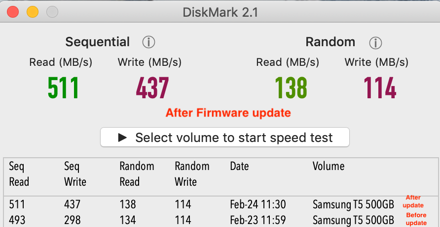

I was running in Journal Encrypted for a week with no eject issues but It was only writing 300 mb/sec and disk marks would show that after the 1st or 2nd run it would slow down on the bench mark from 400's to 300.
Yesterday I reformatted to APFS encrypted and the write speeds was identical as Journaled. But I had an eject during sleep overnight so it brought me to this thread again.
I just downloaded the latest firmware and tested the disk speed and it has improved. I am hoping the firmware update also fixes the eject issue. If not I am confident I can run in Journal extended encrypted with out issues.
I will report back later of any eject issues.
Thank you again. I have new confidence in my T5.
