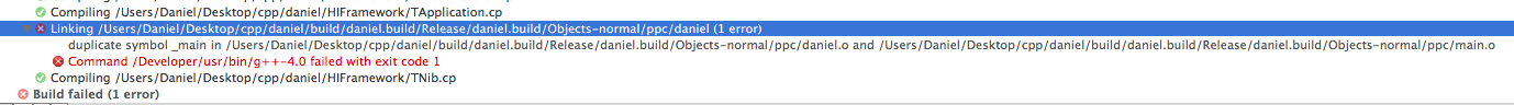

Ok so i now realise that i didn't enough information so this is whats happend now.
I copied the code that lee wrote and put it straight into xcode and i'm still getting the same problem and to show you exactly what its saying i took a screen shot. Hopefully this will enlighten you as to whats going on.
By the way thank you for the help either way.
so the code is exactly what lee1210 wrote.

This is a link error, not a compilation error.
It appears that you have a file called daniel.[m|c|cp|cpp] that has a function called main, as well as a file called main.[m|c|cp|cpp] in the same project. Compilation succeeds for all of your objects, but when XCode tries to link all of the objects and build an executable, there are duplicate symbols for the function main.
It may be the case that when you started the XCode project it created a default file with a default main function, and you added a new file and put in your code, which including your own main function.
To resolve this remove one of the files mentioned above, and put the code you want to use for your main function in the remaining file. This should take care of it.
