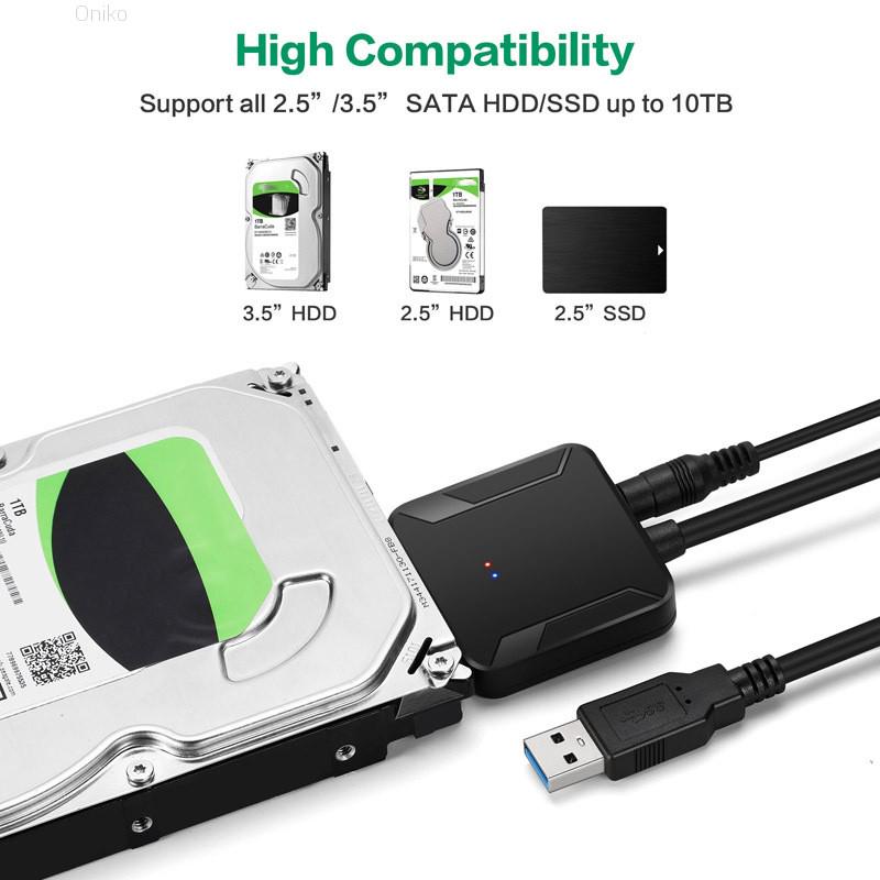

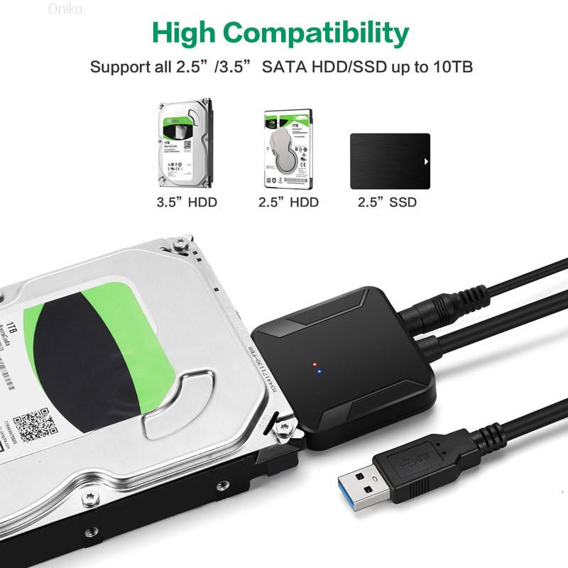

It's either the drive or the SATA controller on the G5. I suspect the latter since DW says the drive is fine.
One way to test is this…SATA to USB.
Essentially, plug your drive into the adapter, plug USB into G5 and boot (hold down OPTN when starting the Mac and choose the USB drive). It should work on the G5, but probably not the iBook.
If the G5 boots from the drive via this then it has to be your SATA controller.
BTW, these are useful to keep. You can quickly access bare drives for formatting, quick transfer, etc - so it's a good investment anyway.
If your SATA controller is gone then you've got two options. New G5 (I'd go for that Quad you saw) or get a PCI-SATA card.
EDIT: An external SATA/FW case will also work, but those seem to be hard to find.

OK, I know my brother has a SATA-USB adapter (he's not a Mac user tho), I might borrow or I'll just buy my own...

Well, I bought the adapter already. Tried to boot with it, but the hard drive doesn't even show up at Startup Manager... It always shows up when connected to SATA, just doesn't boot.

The HD doesn't even show via a SATA/USB adapter.
