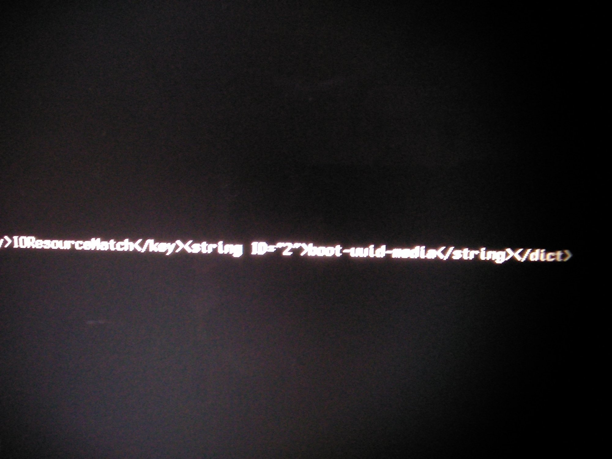

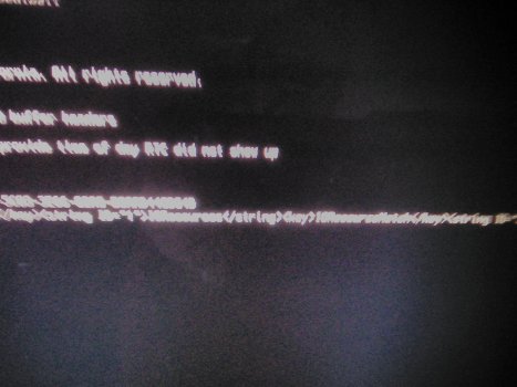

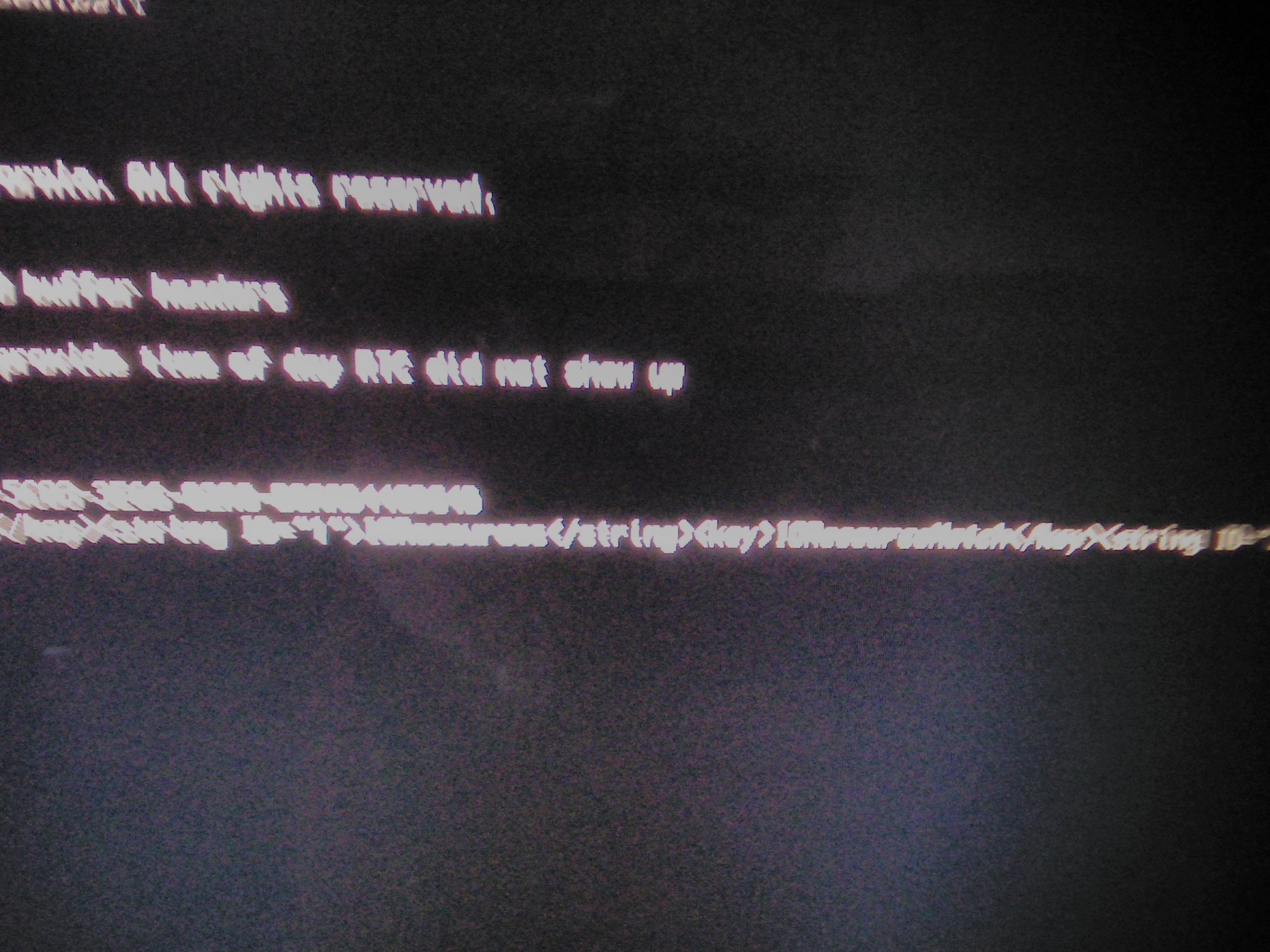

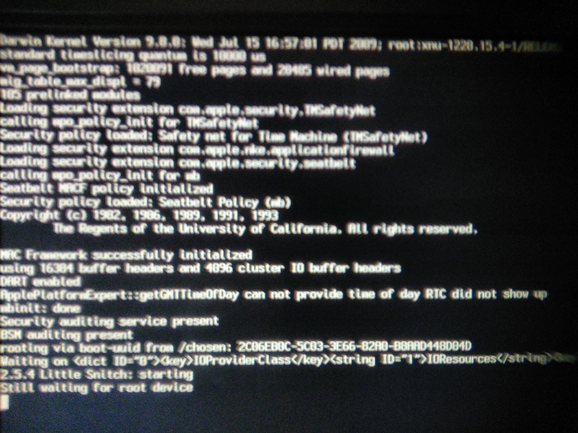

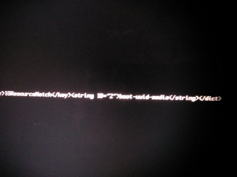

Thanks Onre. Sorry for some blurriness, I think you should be able to make out what it reads.

Wouldn't this suggest that the hard disk is just dead? If it were a logical problem with the data on hard disk, you would get further, I think.
Well, Disk Utilty via target disk mode found no problem with the HD. And I can't boot DVDs either.

This is more or less my best guess as well, but wouldn't target disk mode use the controller too? That's what puts this in the "really weird" category for me.
I see. Yeah, kind of weird. I suspect that a PCI-SATA card might solve this, but who knows.

LB = Logicboard. Or motherboard if you prefer.
The SATA controller is a chip on the logicboard (motherboard). It controls the drives. I've suggested a PCI-SATA card because that would bypass the SATA controller and if it works then it would indicate that the SATA controller (the chip on the logicboard) is damaged.
