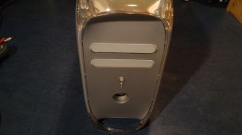

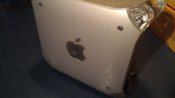

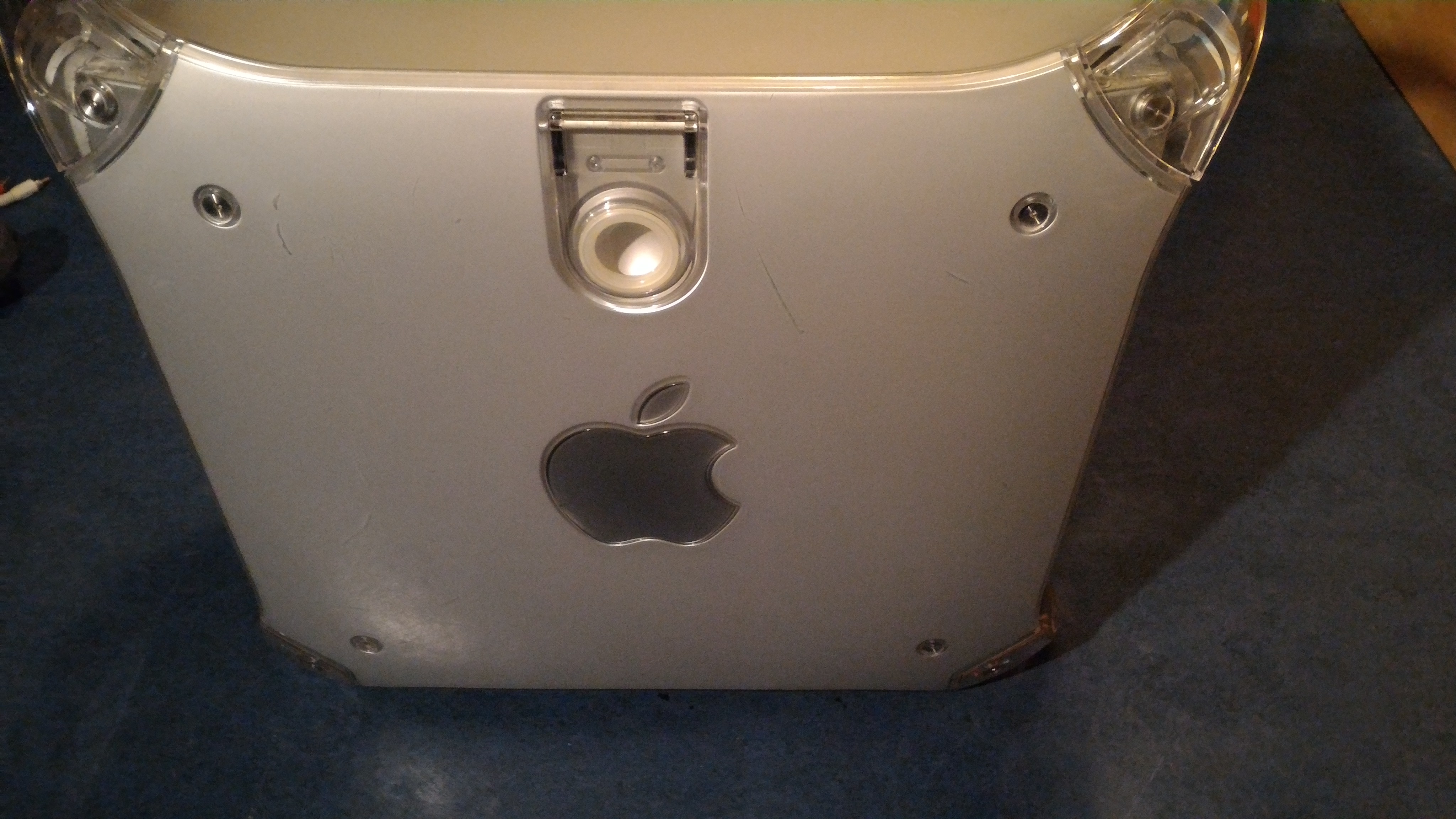

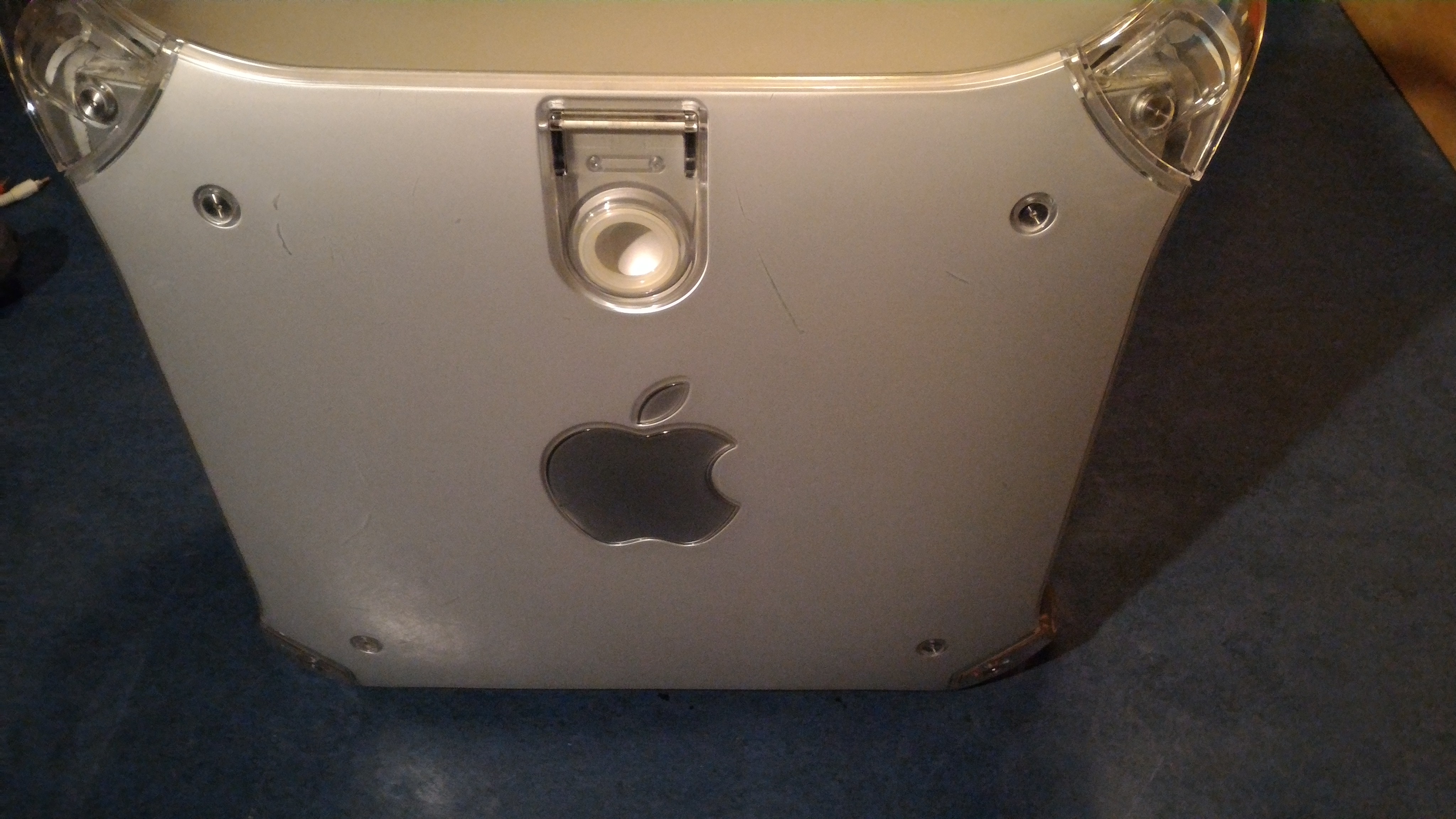

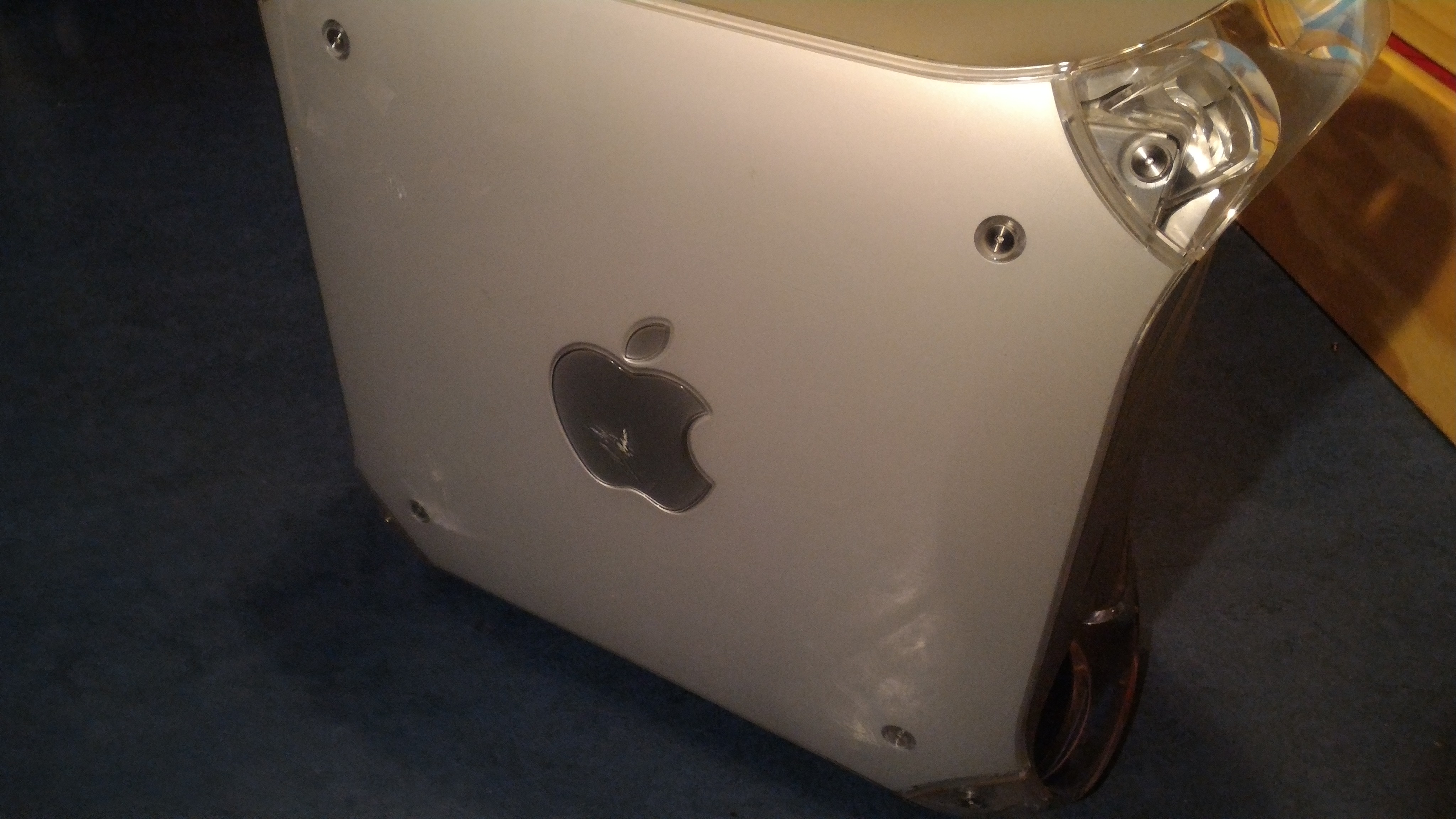

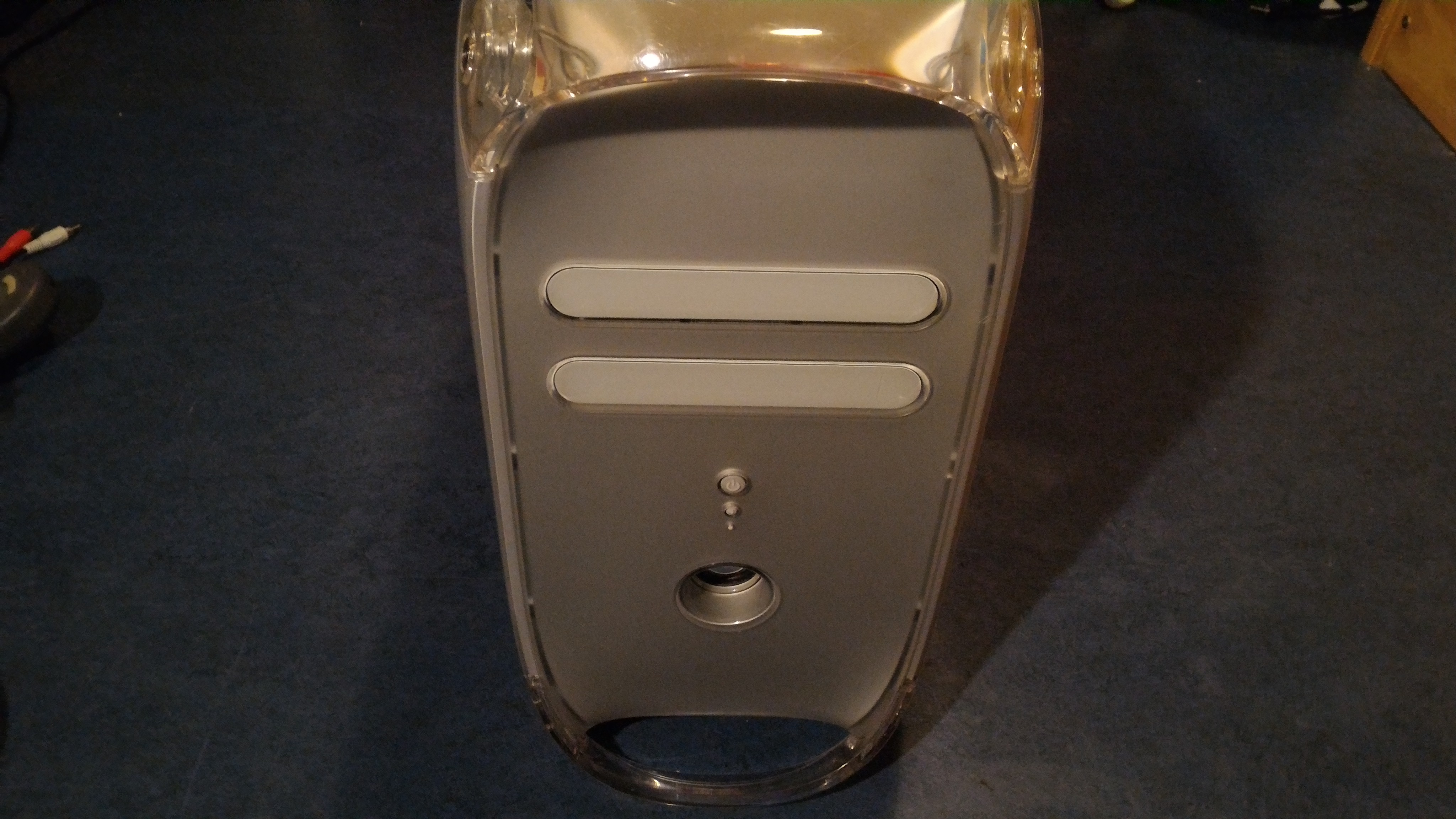

The case has some scratching and scuffs, as seen in these pictures (not the front though), but I think I can camouflage it at the least by giving it a good polish job. I will also remove the handles in order to clean out the nicotine dust stuck behind them. The rest of the case will also be cleaned out. I will need to replace the big 120mm case fan, as it had a cracked fanblade. I might also look for more silent fans to replace the others, because I don't want it to be audible on microphone recordings. Quite silent would be good enough, I suppose.
