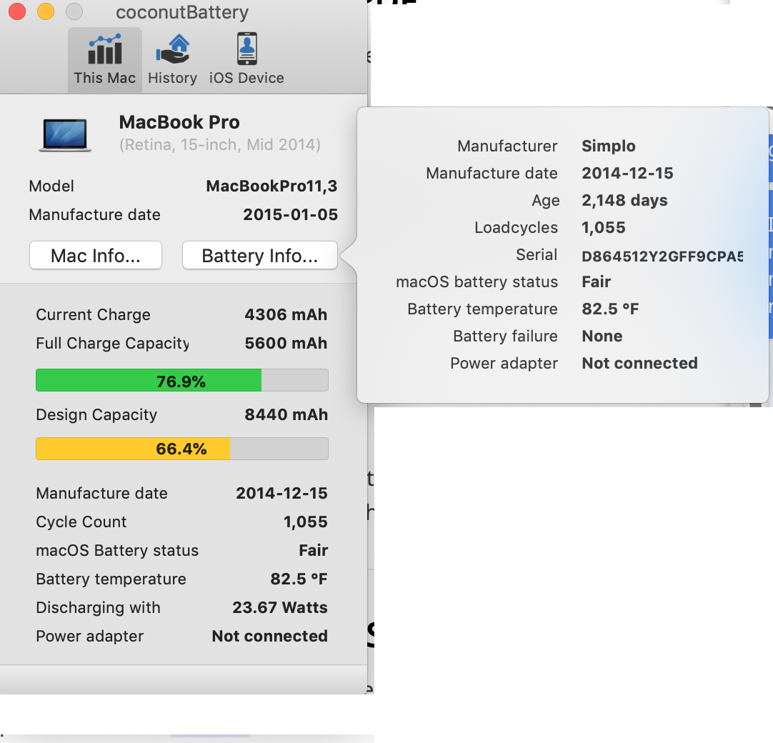

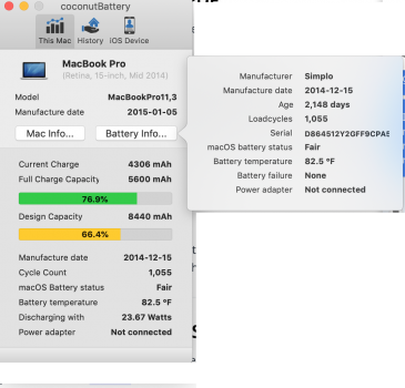

install cocunutbattery and add screenshots of the info.
