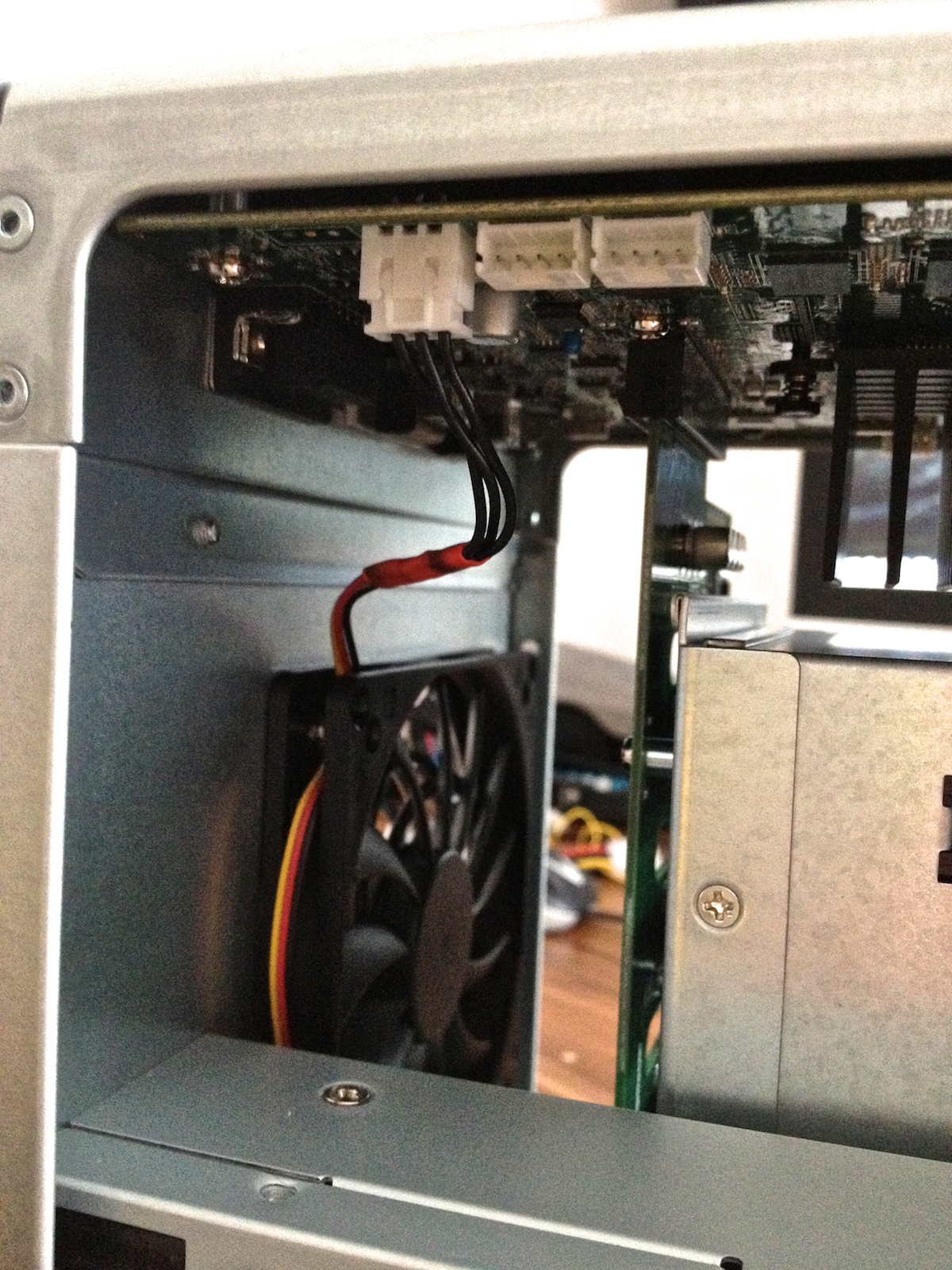

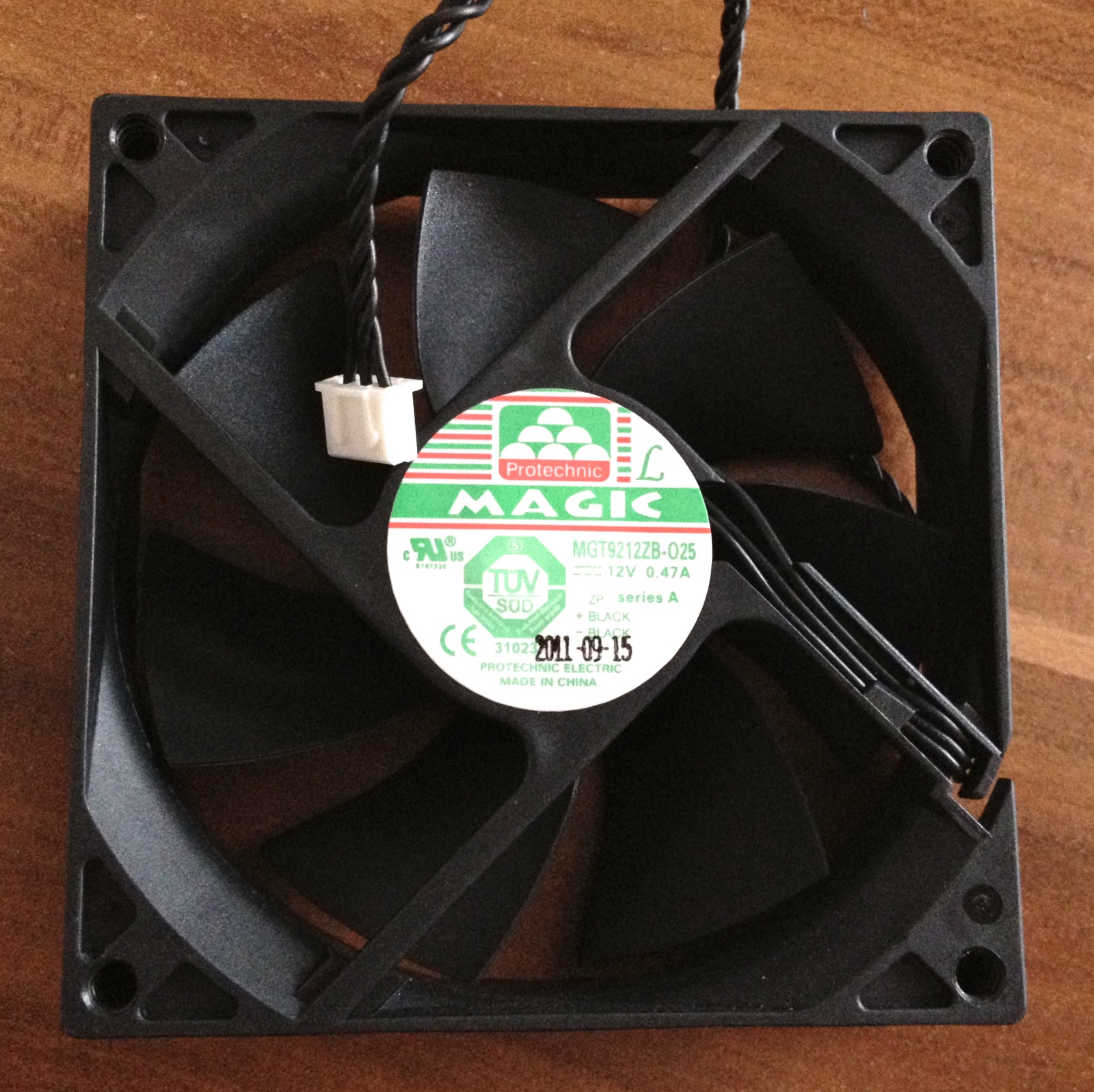

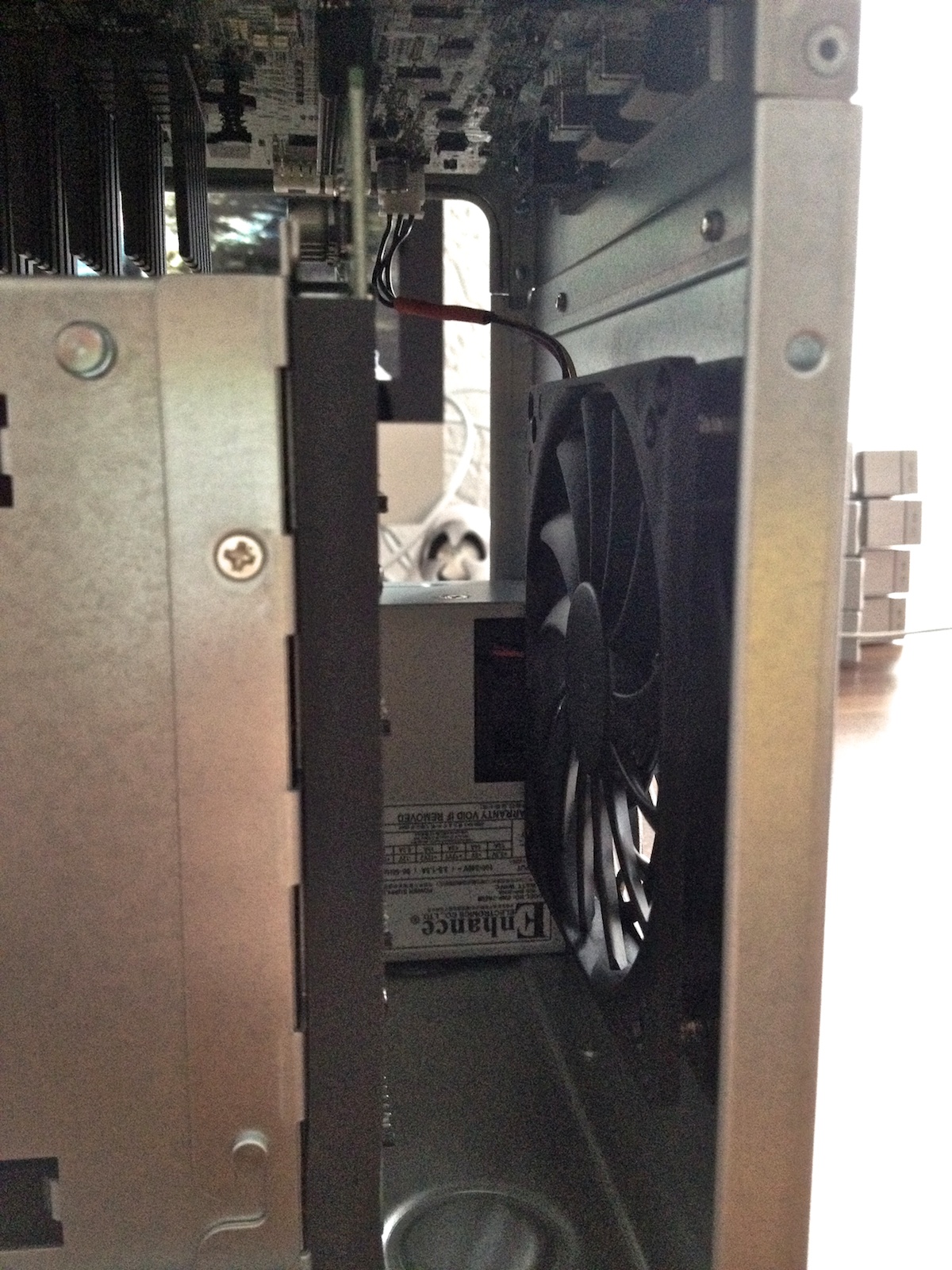

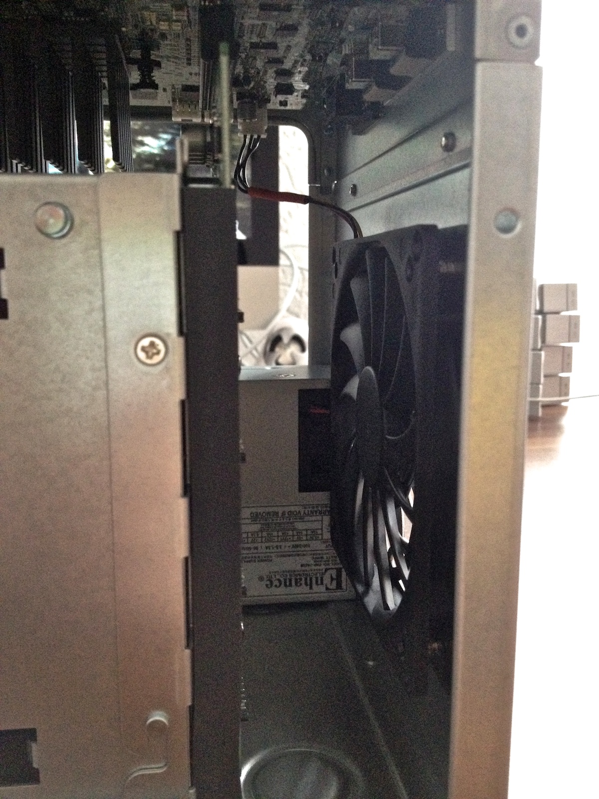

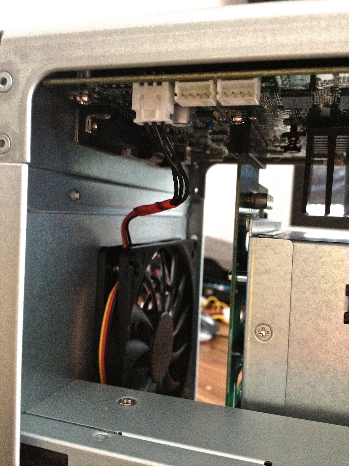

Go ahead and call me crazy XD but I felt like ripping my Pegasus apart and swapping the fan for a more silent one 😉
It's not the standard fan connectors, but using the same fan type. 12VDC with signal for RPM. So i soldered the old connector to my new fan, works flawlessly. Exception: The utility now reports 700-800 RPM instead of 1000 so it's marked slightly orange now =D (the fan check) but I'm using WDC Green disks in it, so temperature won't be a problem, as it sits right next to my windows (and the cool air stream).
The fan of the power supply still makes some noise but it has gotten better than before.
Wanted to share this with you. Anybody else done something like that?
I used a KAZE-JYU Slim fan by Scythe. 2000rpm, 100x100x12

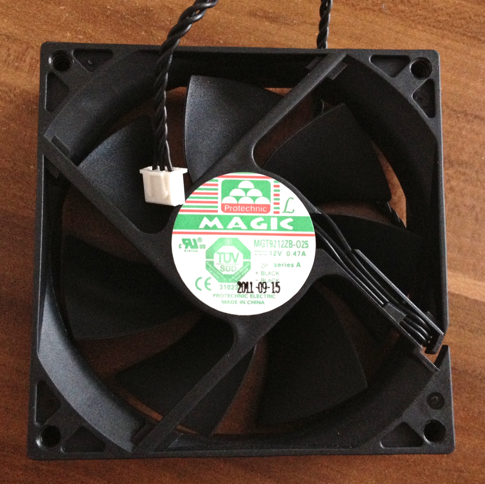

The photograph of the fan is the original one. the one installed is my new one.

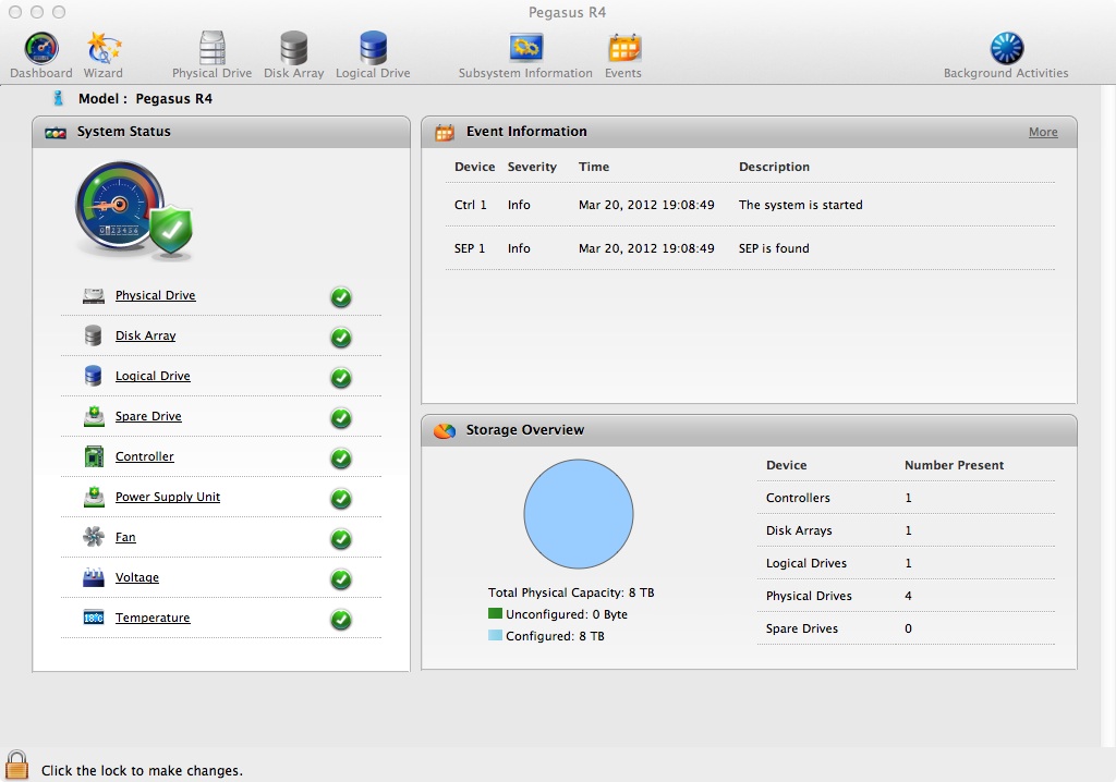

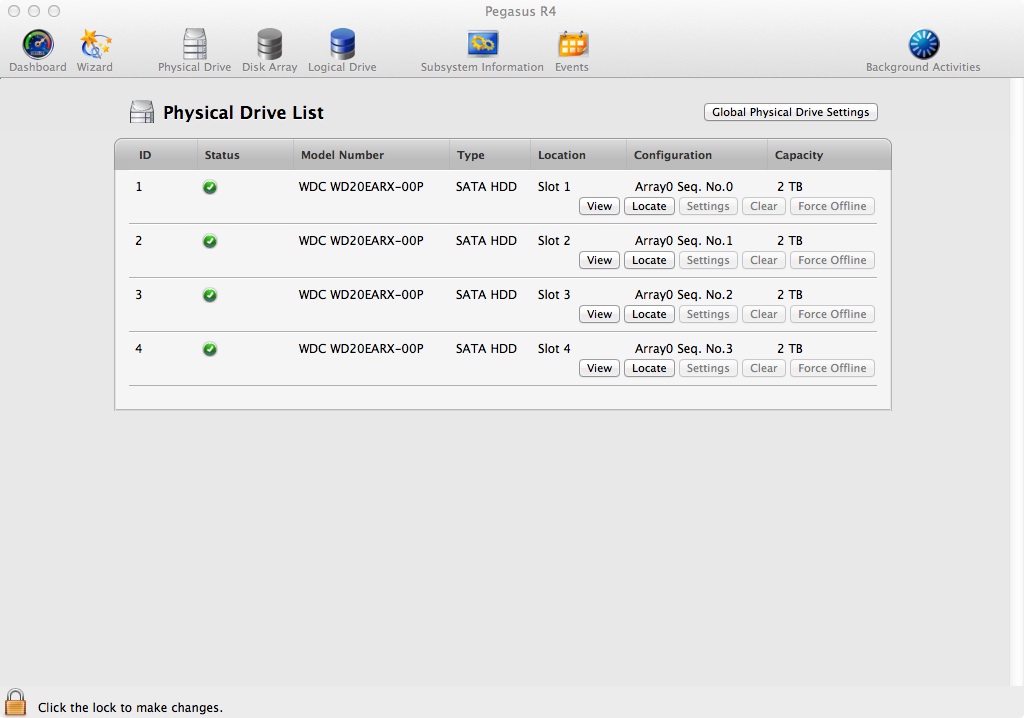

EDIT: With all four drives now installed the fan is raised to 1000RPM and still remains more quiet than before. So no warning now 😉 All lights green pretty much.

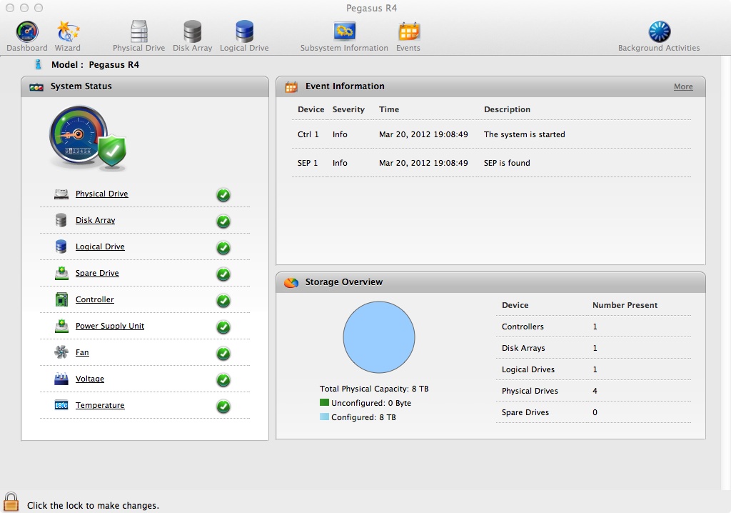

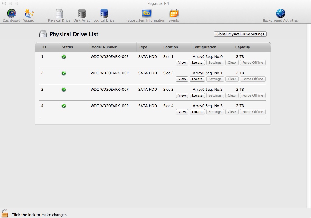

Update
Due to the recent software and firmware update of the Pegasus R4 and Promise Utility, the minimum fan speed for green light has been reduced to 800 RPM and baaammm.. I'm all good now. RPMs vary between 800 and 1000, which is now perfectly within limits =) And this thing is now soo much more quiet and actually acceptable on a desktop right next to your imac 🙂

That might be the case. I realized that the louder noise is coming from vibrations (of the fans or HDD) that are caused by the case of the Pegasus. If you push on the top or sides, the noise becomes much less annoying. (Still, the PSU fan is making a higher pitch noise due to the small build size)
But I though of maybe even adding either the computer case sound protection foam that you can buy to the inside of the case or put some sticky foam where the case is mounted so it can't start vibrating.

Hm... the fan certainly will spin.. all you have to make sure is that you connect the correct wires! 😉
the easiest way is to remove the sticker off the original fan and check which leads end where... it is labeled with gnd, + and sens on the circuit board of the fan in the center.
hope this helps

I dont mind the fan noise. BUT is there a way to turn of Blue LED?
sorry for the late reply. you can always disconnect the LED wires or install a switch inbetween to be able to turn them off when needed. but electronically/via software, there doesnt seem to be a way.
