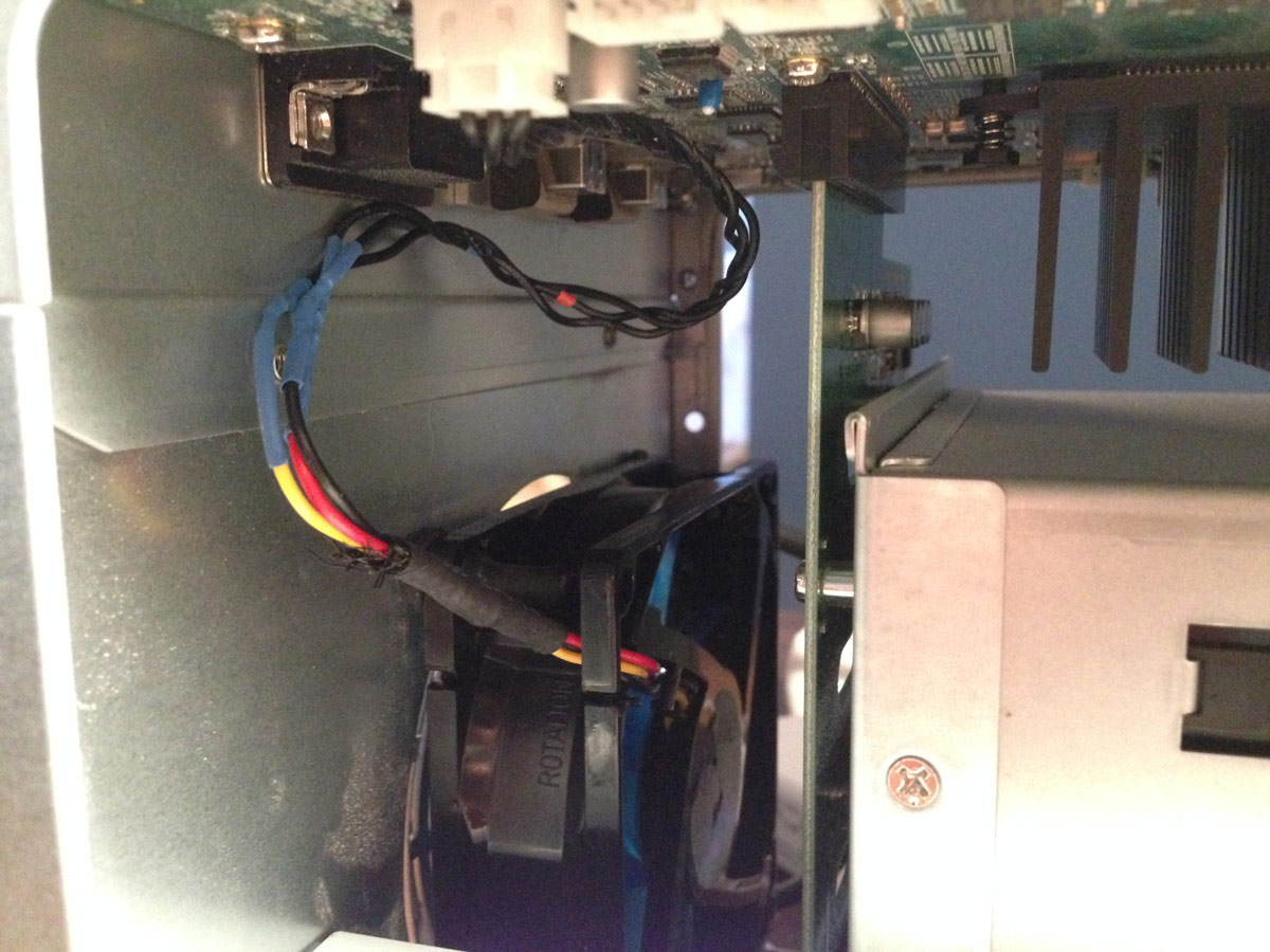

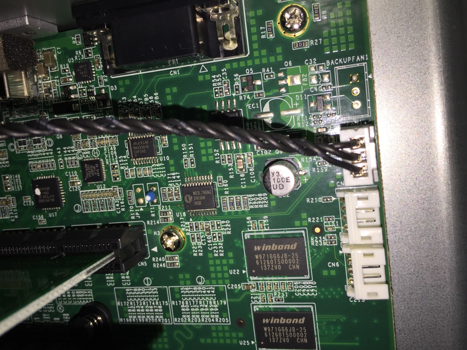

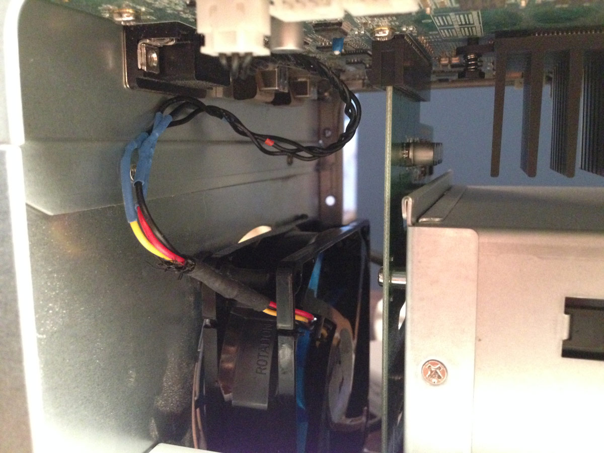

No problem at all. I don't think there is any way to go about doing it without damaging the stock fan. It looks like a proprietary connection they are using that I've never seen before. I've never seen any aftermarket fans with that type of connector in all my years... 🙁
Your best bet IMO is to build an adapter from the stock fan connector and then put a regular 3 pin on the stock fan so you can swap it back in if needed.
This is what I ended up doing with mine for testing.
You can sacrifice an old fan you have laying around or pickup 3 pin fan tail.

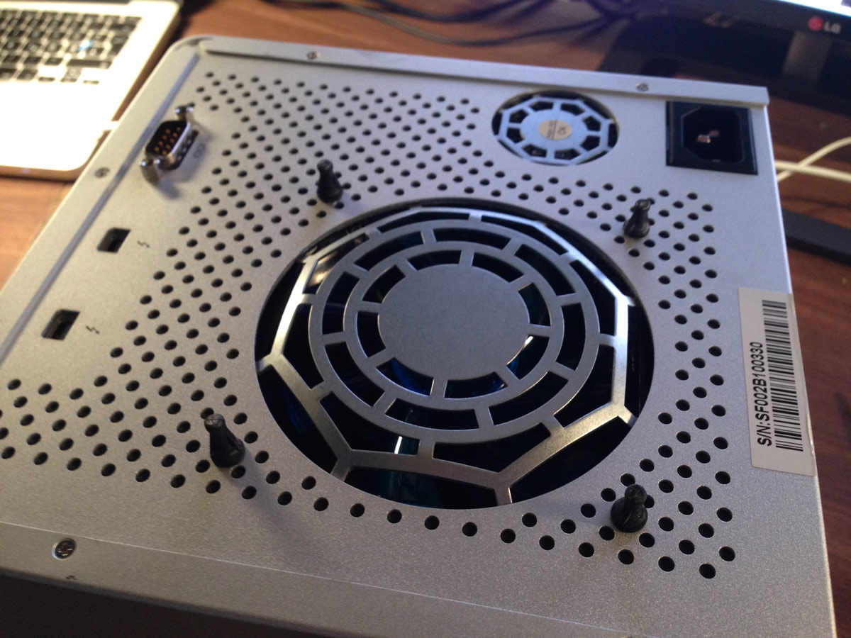

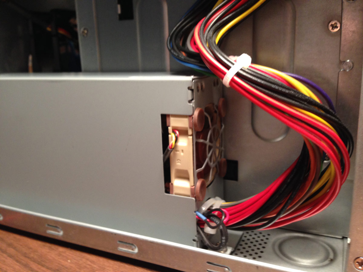

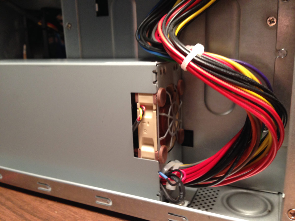

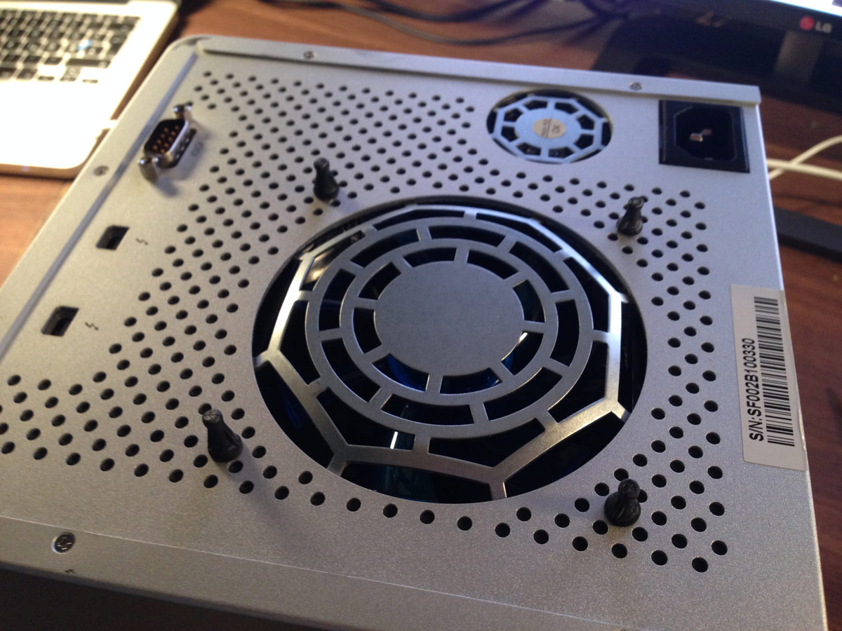

Thanks everyone for this much needed thread. I also just replaced the fans in my Pegasus R4 (Version 1). I always thought the noise level is incredibly high. And now that I switched to a new Mac Pro which is almost silent the Pegasus had to be tuned.
I used the Noctua NF-A4x10 FLX 40mm for the power supply and the GELID Solutions FN-FW09-20-B 92MM for the case, just as cfs.matt suggested. Thanks a lot for that extensive testing!!!
Opening the case and closing again took about 5 minutes each way. I just removed all the screws from the power supply, soldered in the new fan and covered with shrink rubber. The larger fan was a bit more difficult as I cut the wires without checking the correct positions.
Also I used those rubber "screws" that came with the fans. I had to cut off some of the rubber after pulling it through on the power supply and I made holes into the aluminium backplane to accommodate the rubber sticking out on the case fan.
Now the Pegasus is virtually silent. Really I had to double check if the fans are actually running after turning it on. The noise difference is about 3% of what I heard before. Didn't expect that.
In the Promise utility everything is green. Backpane FanSpeed shows as 900rpm and temperature after 30 minutes with 4 (green) harddisks is 45 and 35 °C.
Cheers!
Attached are some pictures

Your mod looks great cinema5D! Glad it worked out for you. It's a shame these units come so loud to begin with. I'm surprised more people aren't complaining.
Enjoy the peace and quiet 🙂

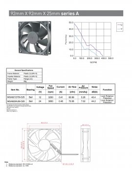

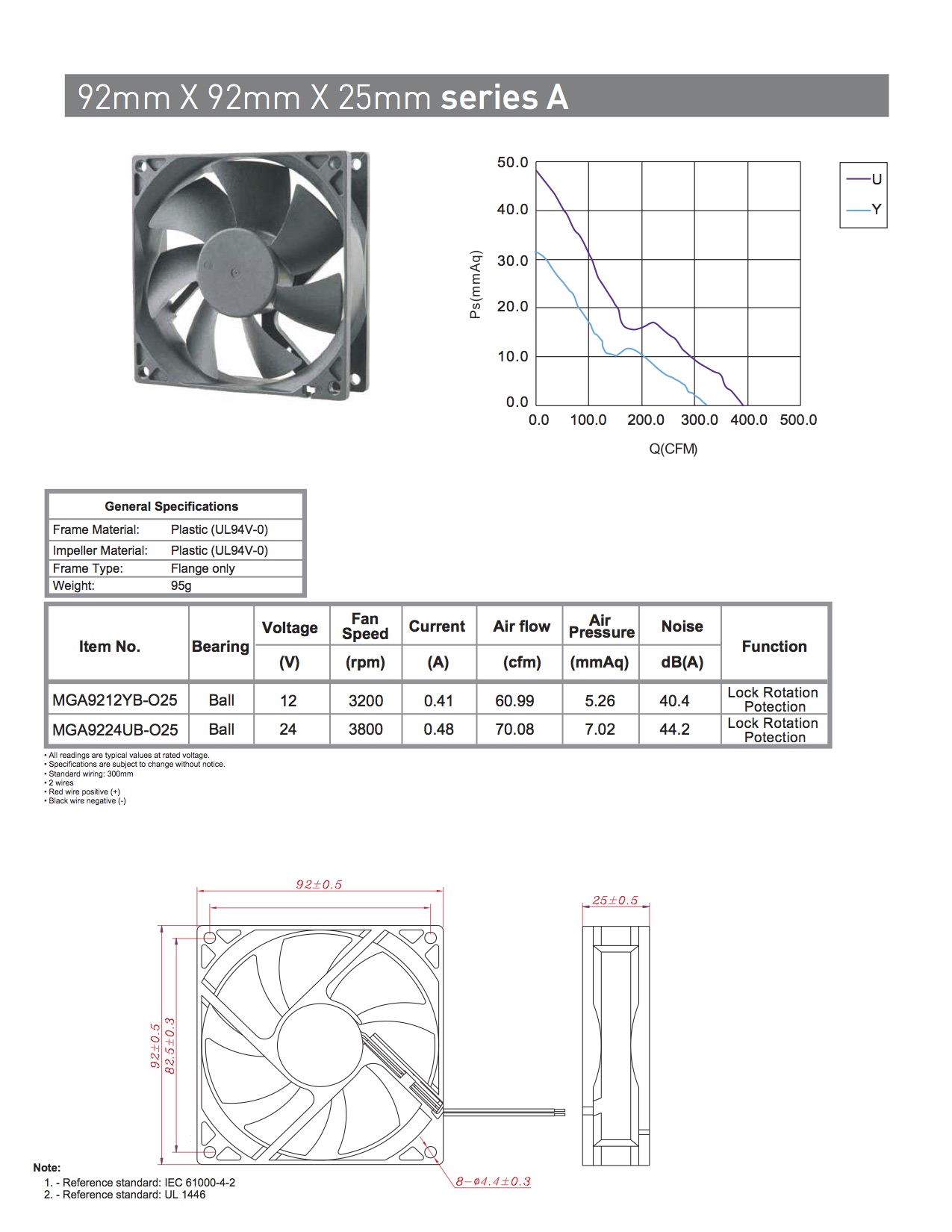

Hi all,
I am in a very similar situation as you guys. I have a T1 r6 Silver model and I am getting a bit fed up with the noise levels. Especially as it constantly shifts in speed and pretty much sounds like when you change gears in a car. 1) One fan speed 2) At shift it accelerates 3) Falls down slightly to lower speed (but higher than at 1.). Another note is that the external casing seem to give off some vibration that adds additional sound. I have already applied those "felt" feet that you can buy at IKEA to dampen any direct contact with hard surfaces. It seems to have helped a little bit in terms of enclosure-caused noise.
As for the fan sizes, would you reckon these are the same in the r4 and r6?
I will most likely open this one up to check anyway but just though I would throw the question out here first.
Looks very similar to the other models.
[doublepost=1455106840][/doublepost]And the closest info I could find at Protech was a newer model of their fan, perhaps provides some insight into some aspects of the fan, but as this is not the same model as the one bult-in (potentially custom made or adjusted for Promise)?
To add up to this nice knowledge base (thanks to all the contributors!!!)
I changed the stock PSU Fan today on a Pegasus 2 R4 to a Noctua NF-A4x10 FLX 40mm.
The Pegasus 2 R4 is a bit more than three years old and I was about to sell it because I could not stand the noise of the PSU Fan anymore. I barely used it lately because of that.
Then I stumbled on this thread (again) and decided to give it a last shot.
Changing the PSU Fan went without complications and the noise levels are drastically improved. I am on the latest Firmware 5.04 and all indicators are green. The Noctua Fan is working flawlessly so far, no problem spinning up or whatsoever.
Thanks again. I am considering now to change the big fan as well even though it is not as bothering as the PSU fan. I will see.
