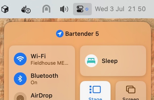

Did you figure out the cause?
Nope.
Still showing as using my location on startup.

Really weird. Have you checked System Settings > Privacy & Security > Location Services to see if Bartender is still in there? Perhaps another option would be reinstalling some version of the app, enabling and disabling location services and anything else (screen recording, etc) before uninstalling again

Yeah, it's very strange. There's nothing relating to Bartender in any of the Privacy & security settings. I read you can use Homebrew to uninstall everything even if you didn't use it to install by doing:
Code:
brew rm --zap --force bartender
but even doing that made no difference as it still shows as accessing my location on restart.
Think I might give your suggestion of a reinstall and disable Privacy & Security options before uninstalling again.

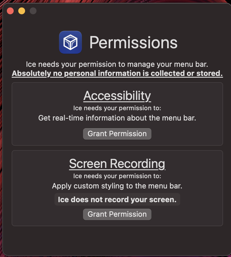

HiddenBar is great. I've also come across Ice (GitHub link for those interested) being recommended recently, but I haven't tried it myself yet. It seems to offer a bit more visual customisation than HiddenBar, which isn't really something I need. Has anyone here tried both?
I have looked at HiddenBar, it doesn't quite do the job for me on my main computer but I do use it on an old spare MacBook I have as backup. Ice is interesting and looks like it would be a viable replacement for Bartender for me but this is the problem in a way. It's so good that I'm wondering how long it will be before Jordan Baird sells his currently donationware app to some big developer just as Ben Surtees did. It's kinda the way of things, honest small time private developers come up with a good app, improve on it until it becomes the benchmark then sell it on to a corporate developer and suddenly it's subscription only and privacy issues begin to arise. We saw the same with MalwareBytes and others and I can only imagine we will continue to see more of the same.
Anyhow, I think I too will remove Bartender (a pity I have a lifetime licence) and give Ice a try. It's not so much the money involved but the underhand degrading of our "trusted" apps that I resent.
