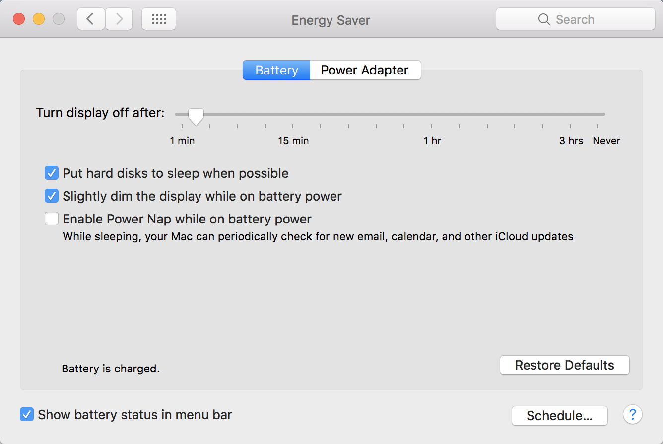

Even when Power Nap is off in the settings, its still working?

Power nap is only when the computer is plugged in. I also tried completely disabling power nap and it made no difference.
