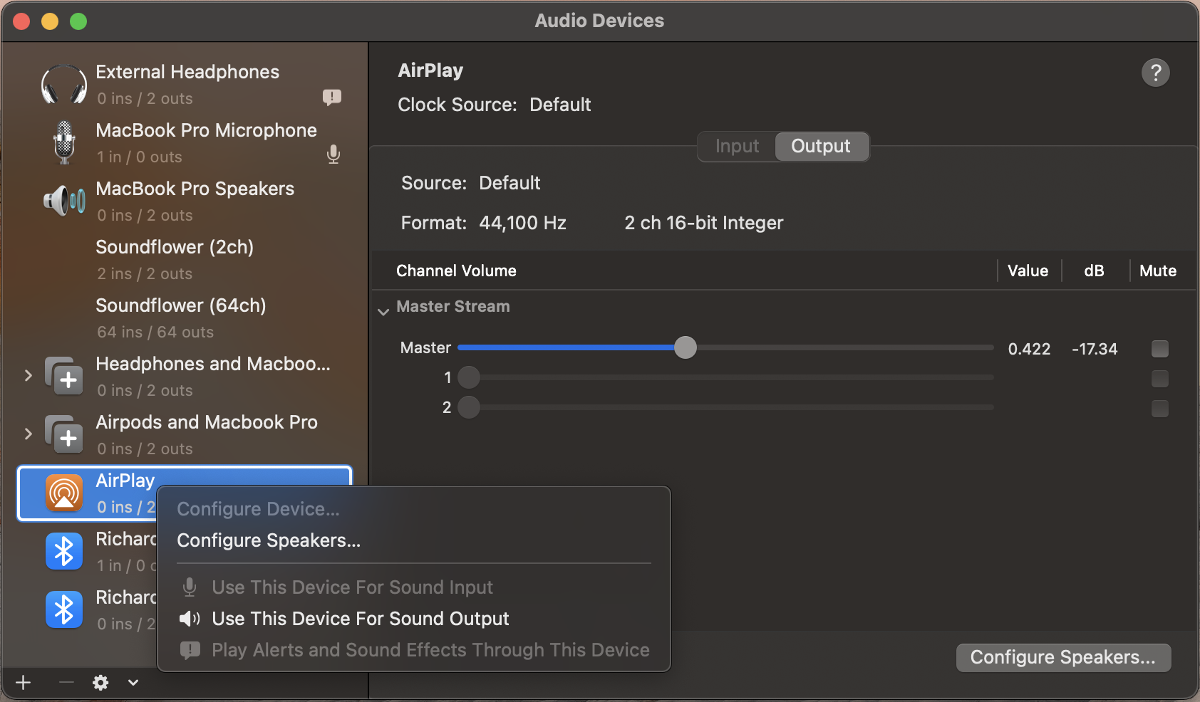

  1. Launch the Music app on your Mac and select your stereo-paired HomePod minis as the audio output.
    Now, minimize the Music app (don't close it), then launch the Audio MIDI Setup app located in the Applications -> Utilities folder.
    In the Audio MIDI Setup app, click the + button in the bottom-left corner of the interface and select Create Aggregate Device from the dropdown.
    Select the Aggregate Device in the sidebar and check the Use box next to AirPlay.
    Close the Audio MIDI Setup app, then select the Aggregate Device from the volume dropdown in the menu bar.
As for the caveats to this workaround, using it means you can only change the volume by tapping the physical HomePod controls themselves – you won't be able to adjust it from your Mac's menu bar. You also have to keep the Music app open at all times, otherwise you'll lose your audio and you'll have to repeat the steps.
Another thing to consider is that this is only AirPlay 1, so there's a delay in the sound output between playing/pausing, and audio will be slightly out of sync when watching videos, although checking the Drift Correction option (circled in green above) in the Audio MIDI Setup app can compensate for this.
As mentioned, the solution is far from ideal, but until Apple brings system-wide AirPlay 2 support to Macs, it's the only way to pipe your Mac's audio through stereo-paired HomePods, short of purchasing a third-party app like Airfoil.
Update: As MacRumors reader B4rbelith points out, if you play something in the Music app, you can then right-click AirPlay in the Audio MIDI Setup app's sidebar and select Use this device for sound output. This lets you control the volume from the menu bar, but the other caveats still apply.

You don't need to create an aggregate device. Just play something from Apple Music to your stereo HomePods, then open 'Audio Devices', right click on Airplay, and select 'Use this device for sound output'.
It's not ideal, and media players like IINA and VLC lag. Youtube through Safari works fine though, as it buffers the video to keep in time.

That works, too! I like it. Added it to the article. Thanks!
