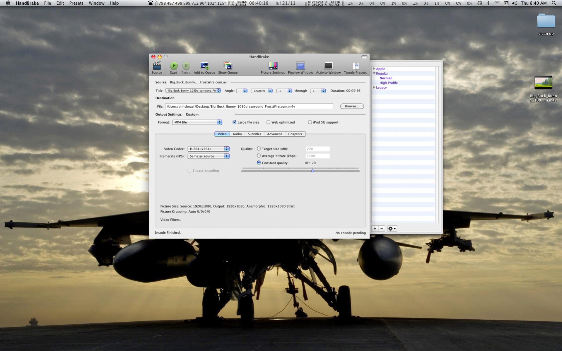

I can also do a rip with your instructions. I am downloading the file on my mac pro with utorrent I will use handbrake to encode it. I just encoded it on the mac pro hex 3.2GHz the first encode was about 5 min with about 50 to 52 fps . done in mp4 1920 x 1080
the clip was fun to watch. I think it will be nice to toss in the mac pro scores for hand brake so I did.
I will post screen shots of the handbrake settings.
2010 mac pro hex 3.2 ghz with 32gb ram and an intel 600gb ssd and the 5870 graphics card
1st 5 min fps about 50
2nd 5 min fps about 50
3rd 4 min and 59 secs fps about 48.1

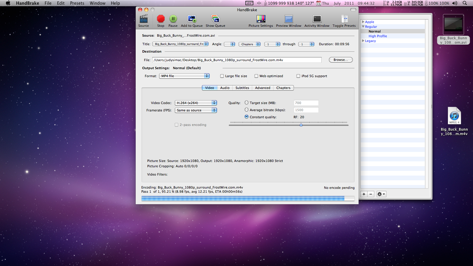

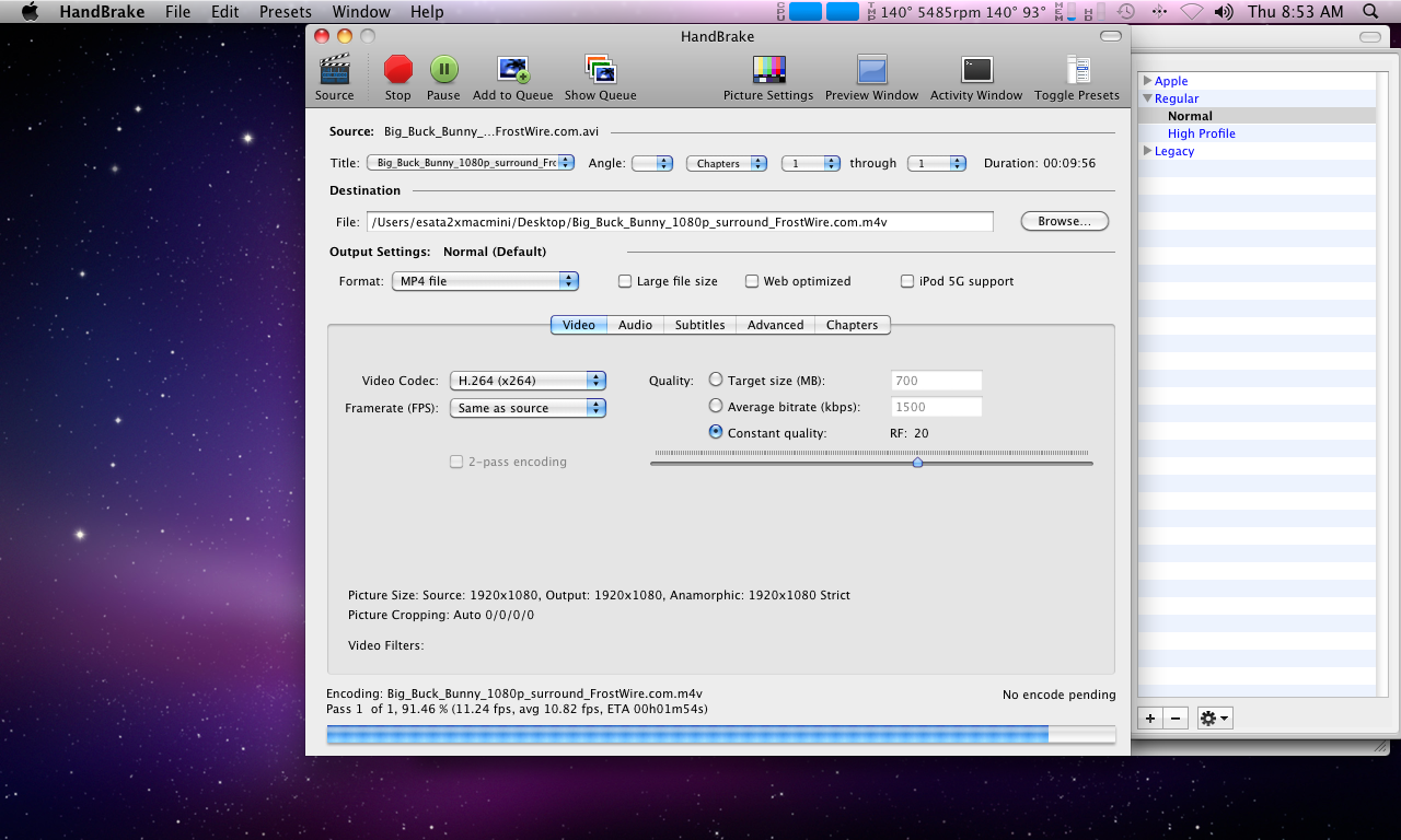

below are screen shots of the handbrake settings on both the 3 machines tested.

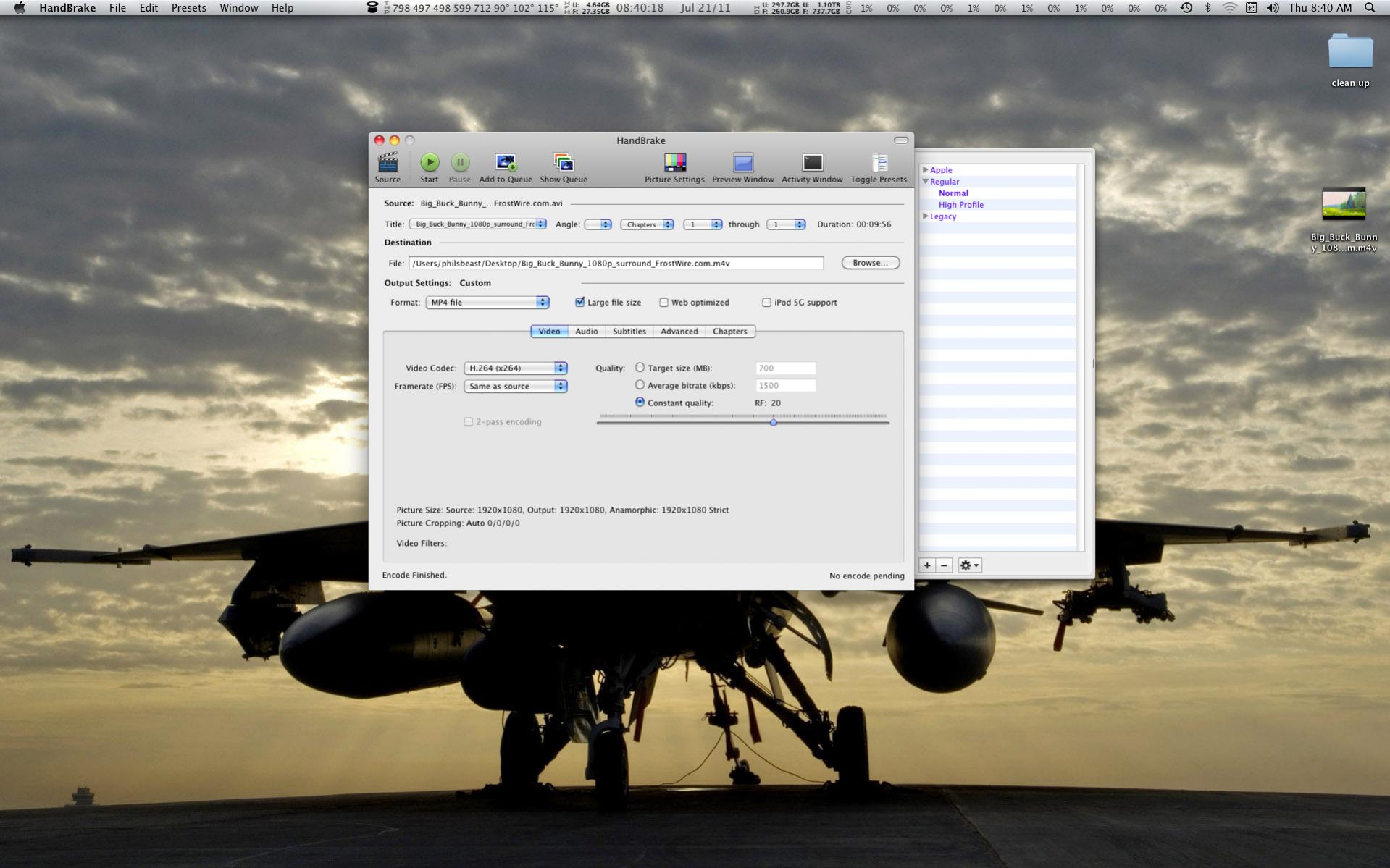

I went to this link and I used
utorrent to download it. I did the mp4 .torrent version 1920 x 1080
http://www.bigbuckbunny.org/index.php/download/
I then used hand brake.
I used large file just in case 1920 by 1080 in and 1920 by 1080 out same film rate as the source and i set audio to stereo
2011 MacMini Server
Average of 3 encodes: 6:45 @ 35.472408 fps
that is amazing. triple the speed of the 2009 mac mini and I am certain it will be more then three times as fast as the the 2.4 2010 mac mini.

It is impressive for such a little machine. It's been a while but I seem to remember my 2.93 i7 doing this task at right around 40 FPS and 5:45...should be on par with whatever last year's high end iMac 2.93 comes in at.
EDIT: For Reference: 27" iMac 2.93GHz i7 Quad Core 8GB RAM (2010) - 5 mins 39 secs @ 42.06 fps

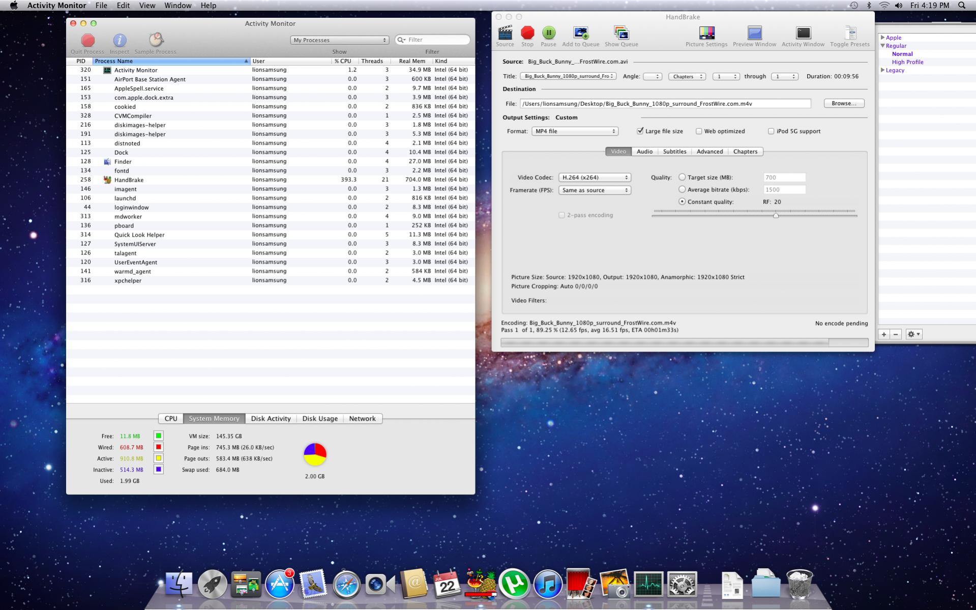

okay I have the base 2011 mini hooked up it is the 2.3 model. I added a samsung 256gb ssd to it but that should not affect the score for handbrake as handbrake is cpu based. I will post up tests but i think I should get 9 minutes with this machine. the down load of the file is slow. I can't use the copy I have on my Nas server lion says i need an update and i should contact synology for an update. so I have to down load the file again.
19 mins so far to do the down load. this is not about the mini but the internet it is slow today.
first hand brake score was 14 mini 32 sec and 16.50 fps I shut all programs off for the second handbrake I got;
13 min 40 sec and 17.33 fps
I have discovered that 2gb ram does not cut it at all. i maxed the ram for all of handbrake.
handbrake needs 4gb ram. I was helped somewhat by the ssd but page in's and outs were bad. I am waiting on the ram so I am ending tests for the day.
