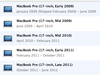

Hey guys, my macbook pro 17' has a purple and white lines and it's not opening. I didn't see any same problem on forums. Do you know the solution?
I changed my mainboard 3 weeks ago. They can repair it free. But if it's an another problem, I must pay for it
Well, it's out of warranty for sure, so any repairs would have to be paid for by you. Like maflynn said, it's probably the GPU. Or it could be the connector cable that runs from the logic board to the display is going bad too.
I think, it's not the cable because its not opening système. it shuts up at the beginning of startup. And why the it's out of warranty? Gpu and mainboard are on the same board right?
Well, I could be wrong about the warranty status. What model do you have?
The GPU is integrated into the logic board.
