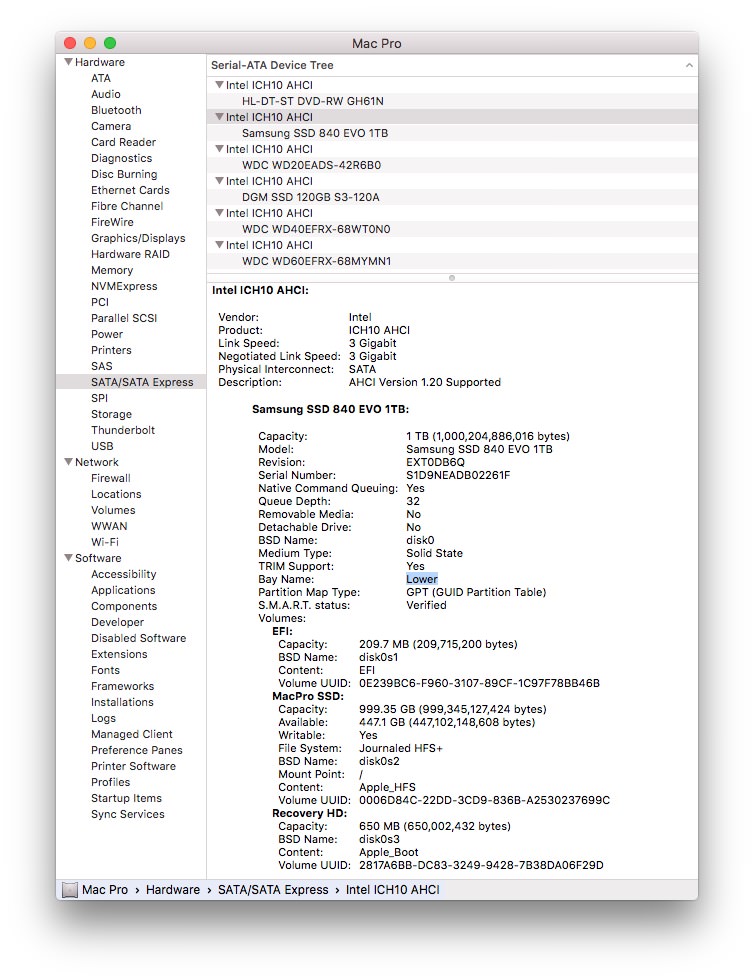

1) exactly the same, that's what I am doing now. Just plug it in, leave it there. There is no moving parts inside the SSD, so, no need to mount on anything, nothing to worry about.

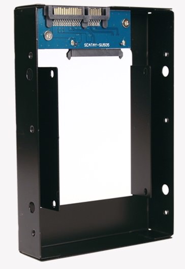

3) Some adaptor with no SATA connector, those are for PC with cable connection, but not making the 2.5" SSD has 3.5" standard mount point and connector location. Some adaptor only has standard mount point on the left and right side, and nothing on the the top. Which means you can't mount them inside the Mac Pro properly. e.g. This one.
