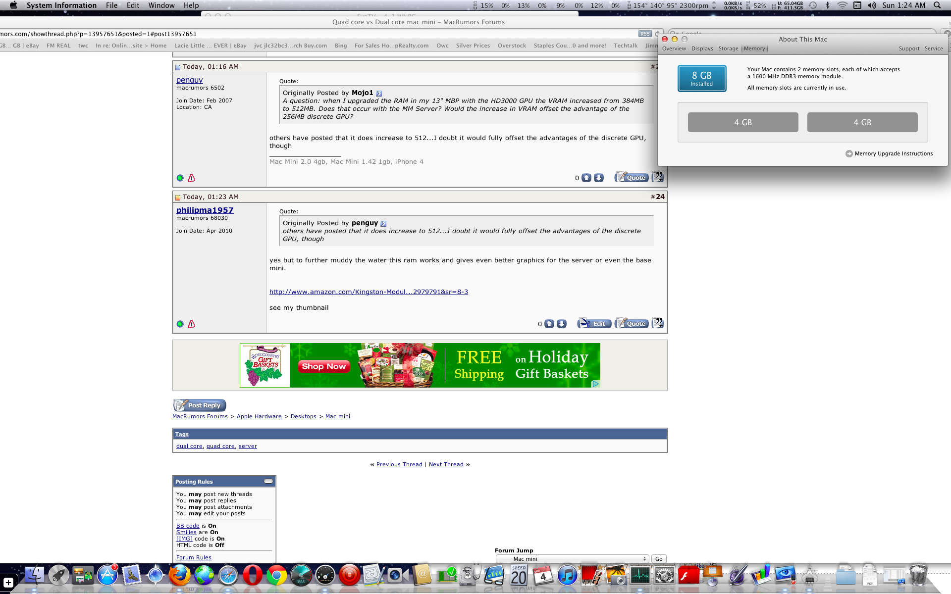

yes but to further muddy the water this ram works and gives even better graphics for the server or even the base mini.
http://www.amazon.com/Kingston-Modu...XAAK/ref=sr_1_3?ie=UTF8&qid=1322979791&sr=8-3
see my thumbnail this also works
and is faster yet
http://www.amazon.com/Kingston-Modu...8ZQE/ref=sr_1_1?ie=UTF8&qid=1322979946&sr=8-1
neither of the above fully catch up to the disctret gpu but the discrete gpu use more power and runs hotter.
