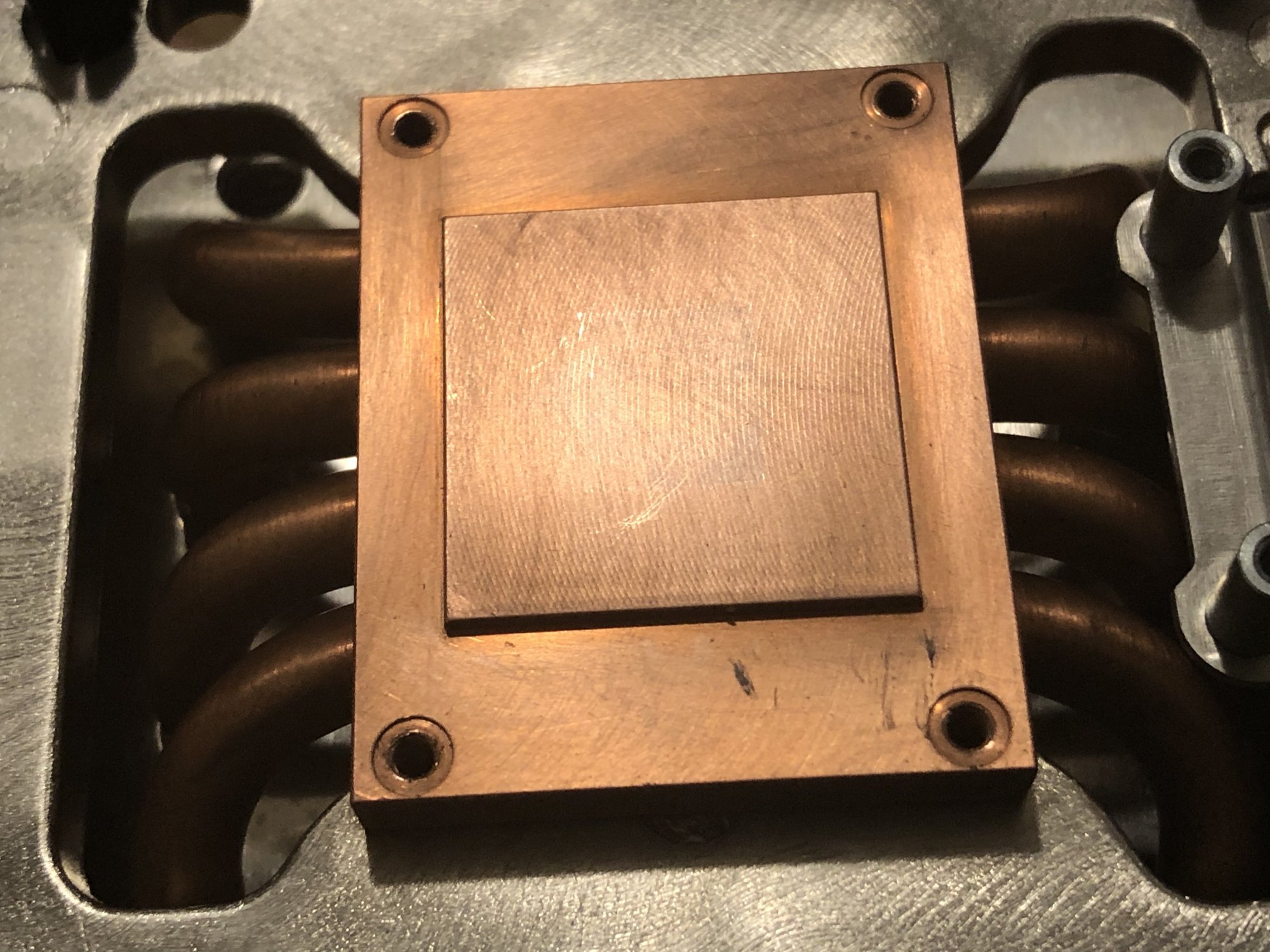

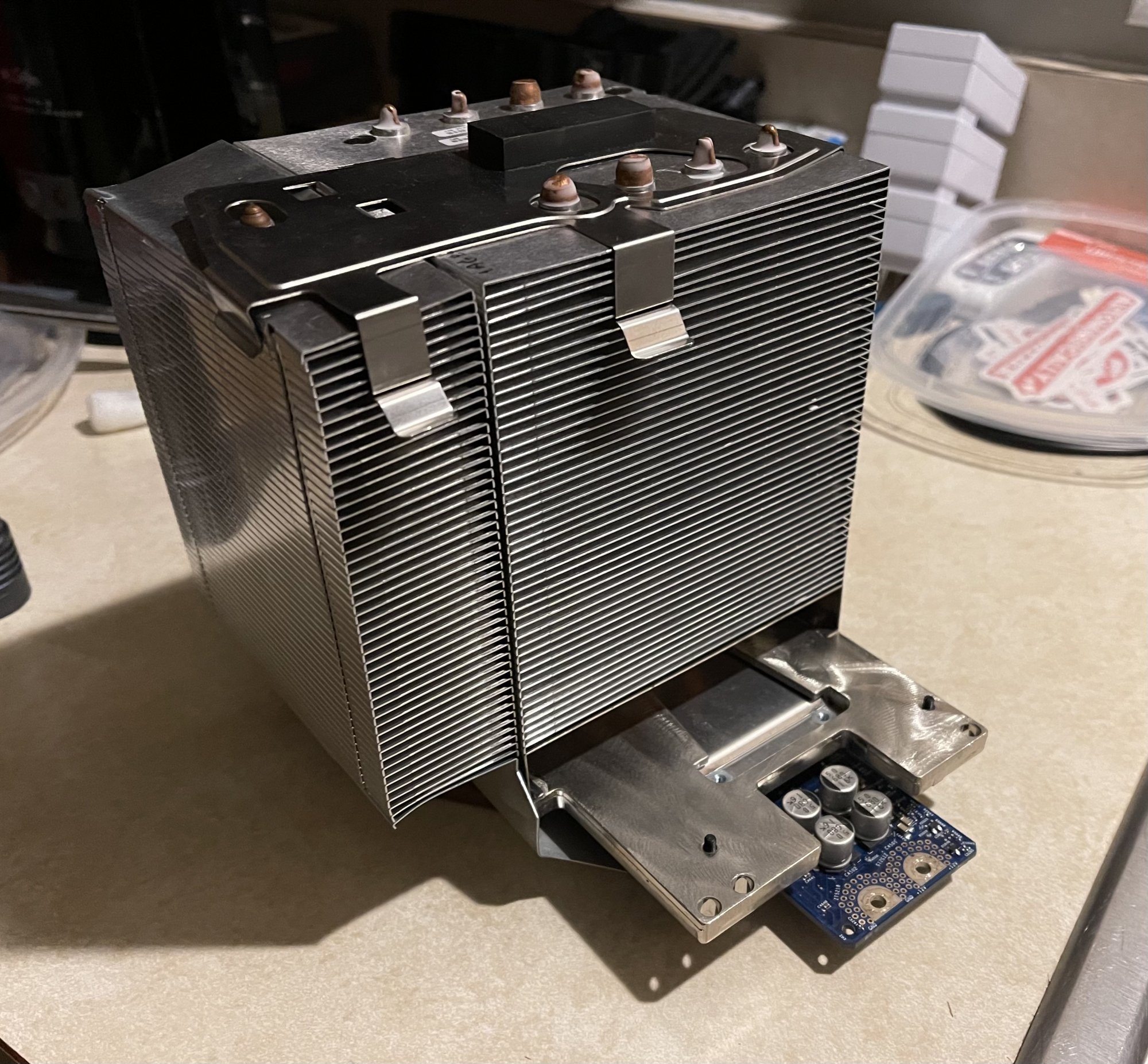

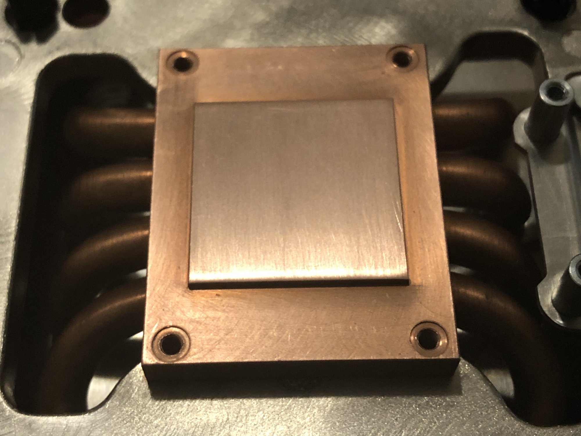

I picked up this 2.3GHz heatsink with the processor card still installed from eBay. On the lookout for another one but I’m not sure how I’d go about modifying it since I don’t have the proper tools. Might have to take them to a machine shop or something.
I’m actually considering just putting it on one of my 2.5GHz cards as is and running a single processor for the time being. Might end up being faster since I’ve been running the quad in reduced mode anyway to keep the fan noise down. The LCS can still keep the temps mostly under control in automatic mode but it has to run the fans at near full blast during anything intensive.
Noice! that Definitely wouldn’t be a bad idea to do that for the time being. The job can mostly be done with a sawzall and a decent metal file. Just takes some patience. However if a machine shop could do it it for a feasible price that would be the best route however it would probably be difficult to find one that would have the equipment that would want to do such a job for a private customer. Most that would have machinery like that wouldn’t wanna touch em and if they did they’d charge an astronomical price. But I’d love to be proven wrong in this aspect. Hopefully you can find one. 🤞
Machine shops that make injection molds usualy have wire edm. Ask nicely 🙂

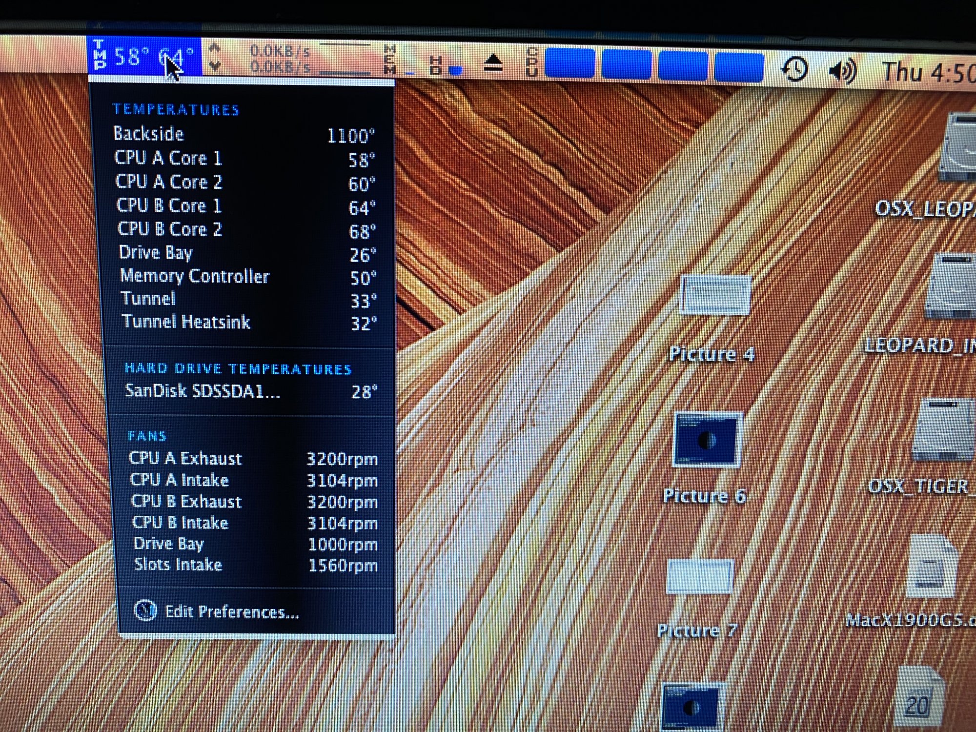

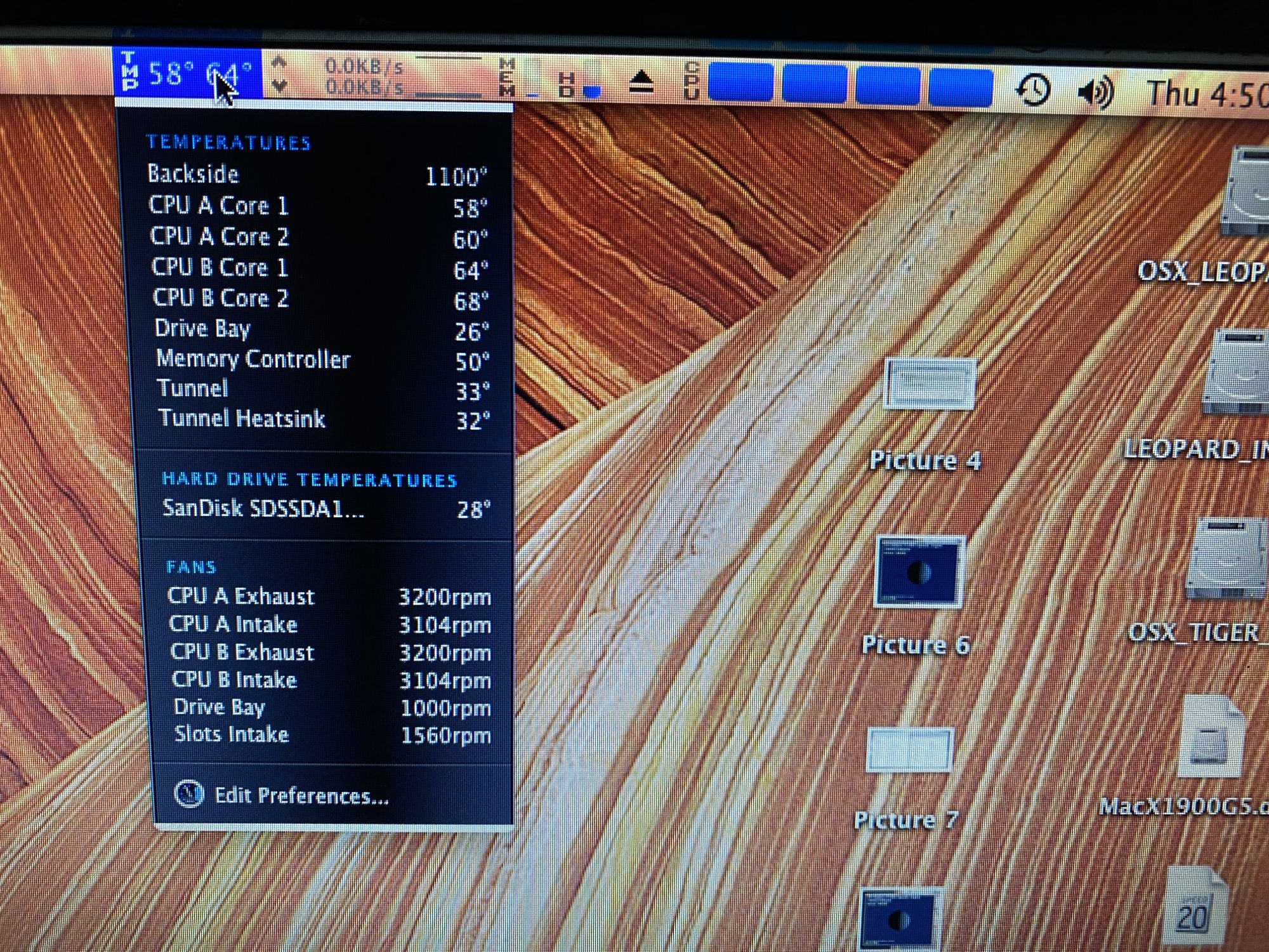

Did the test. Maximum fractal count. It doesnt go over 70c (room temps is 21.5c)
I dont know how the original lcs handle this task but I’m happy with it. 😁 Thats a good stess test imo heyhey.

I forgot to ad idle temp. Cpu B is notably hotter (not something hard to fix).

@Wizzlemane96 did it without special tools. Check out what he did. Theres another guy that was sucessfull with 2004 heatsink (no cutting).

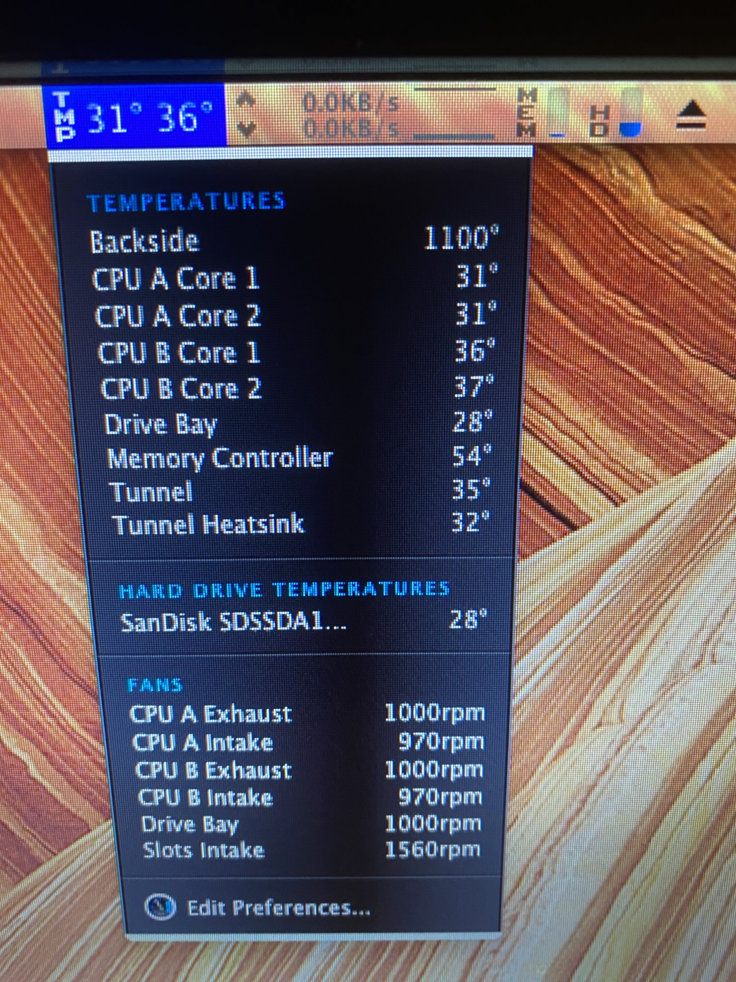

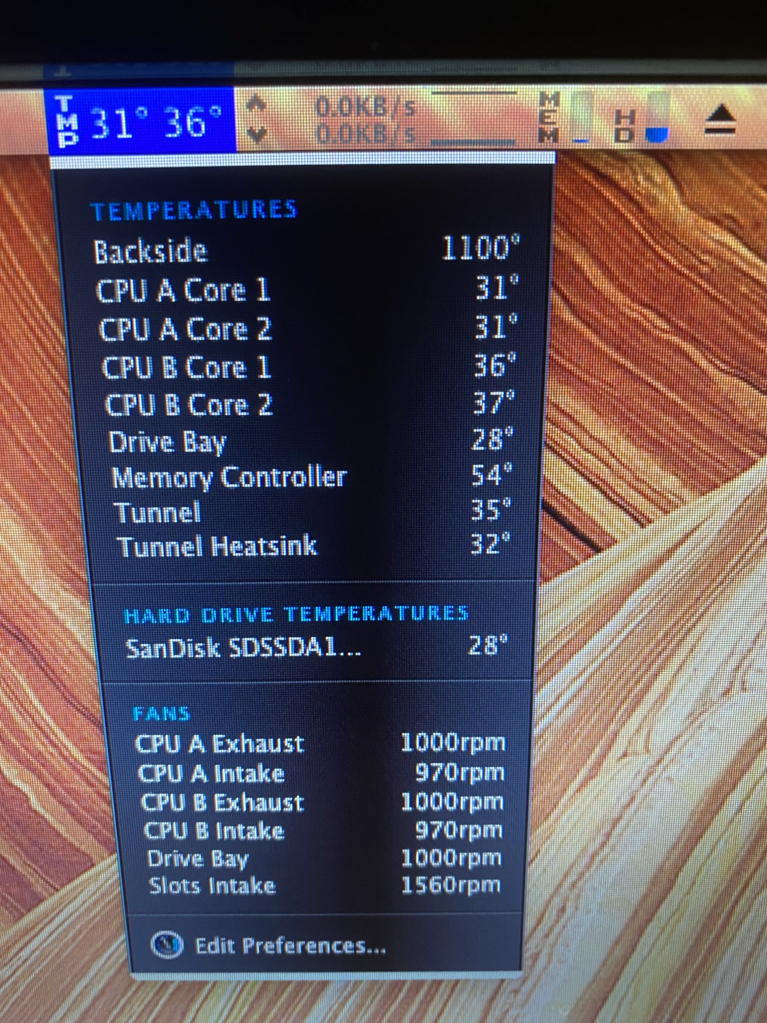

I forgot to ad idle temp. Cpu B is notably hotter (not something hard to fix). View attachment 1735278
Your idle temps are great! Mine always idle around 45c.

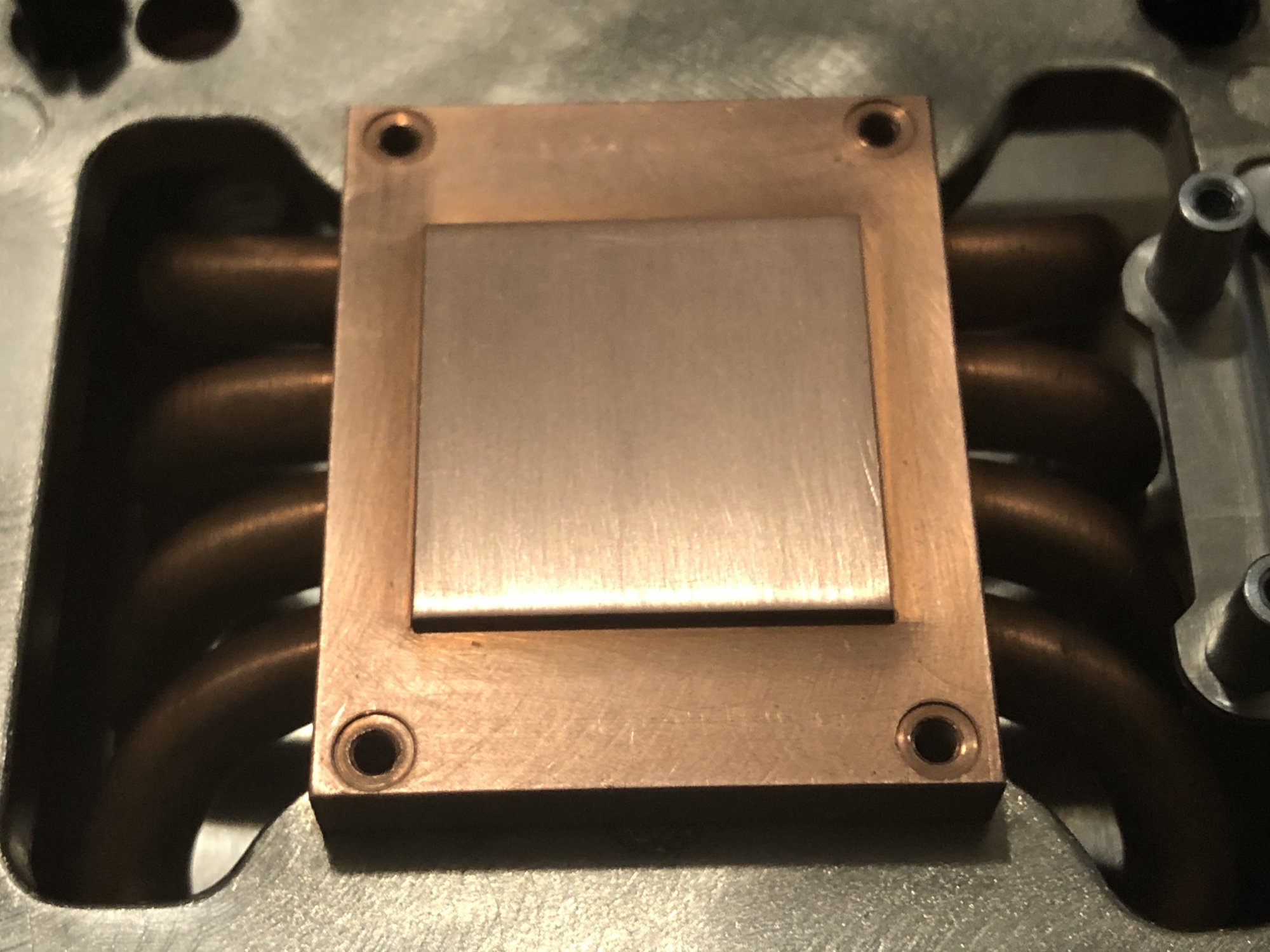

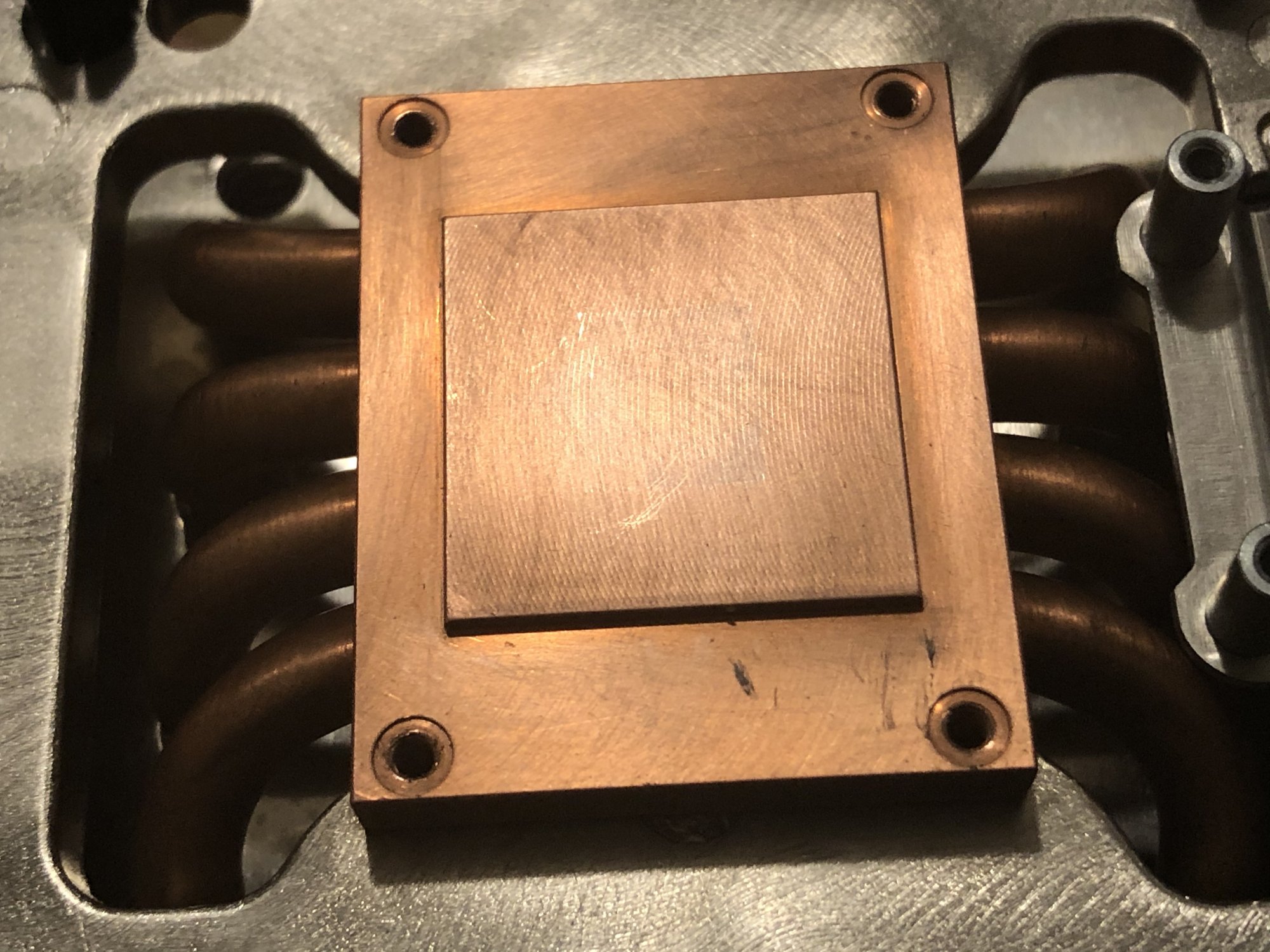

I plained my heatsink surface on my cpu b heatsink it seemed to stabilize the temps just a hair better. Approximately 2c less under load same idle.
Next I’m going to thermal calibrate it and I’ll experiment with the air cooled fans to see if they make a difference as well. I am still using the 7 blade stock quad rear fans vs the 3 blade deeper air cooled fans. Theoretically I figured the 7 blade would be more beneficial in the tighter quarters because it creates more static pressure. On the air cooled ones they have their VRM heat sink on the side and have a lot more open space with only 1 CPU which would make airflow way easier. Hence the low static pressure higher airflow 3 blade fan. I report my experiments once I try!

I plained my heatsink surface on my cpu b heatsink it seemed to stabilize the temps just a hair better. Approximately 2c less under load same idle.View attachment 1735865View attachment 1735866
Thats super cool. Let me know the end result. I still run 3 blades fan in the back and maybe I could revert back. Lapping the block make sense ! Good work sir 👍

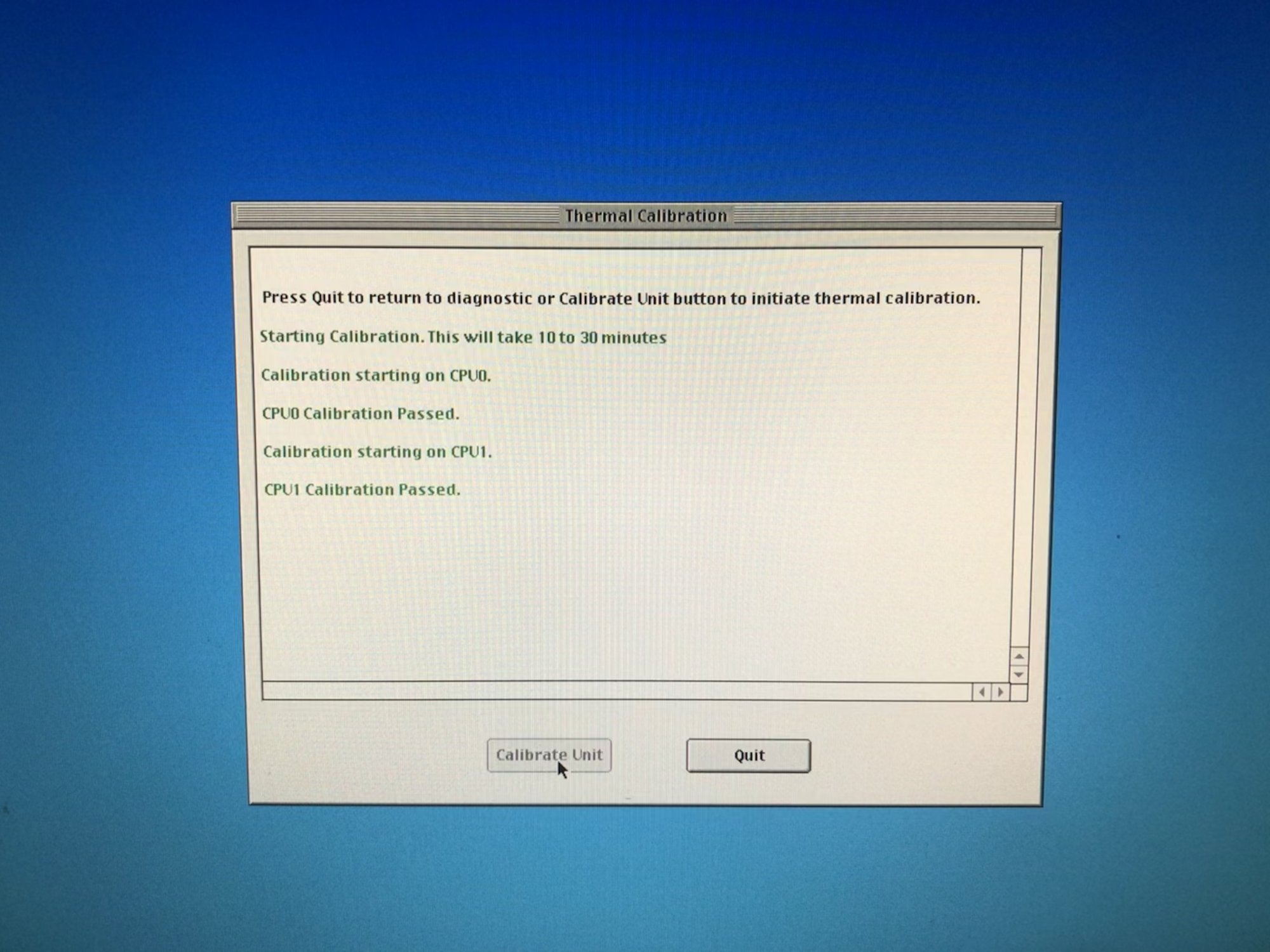

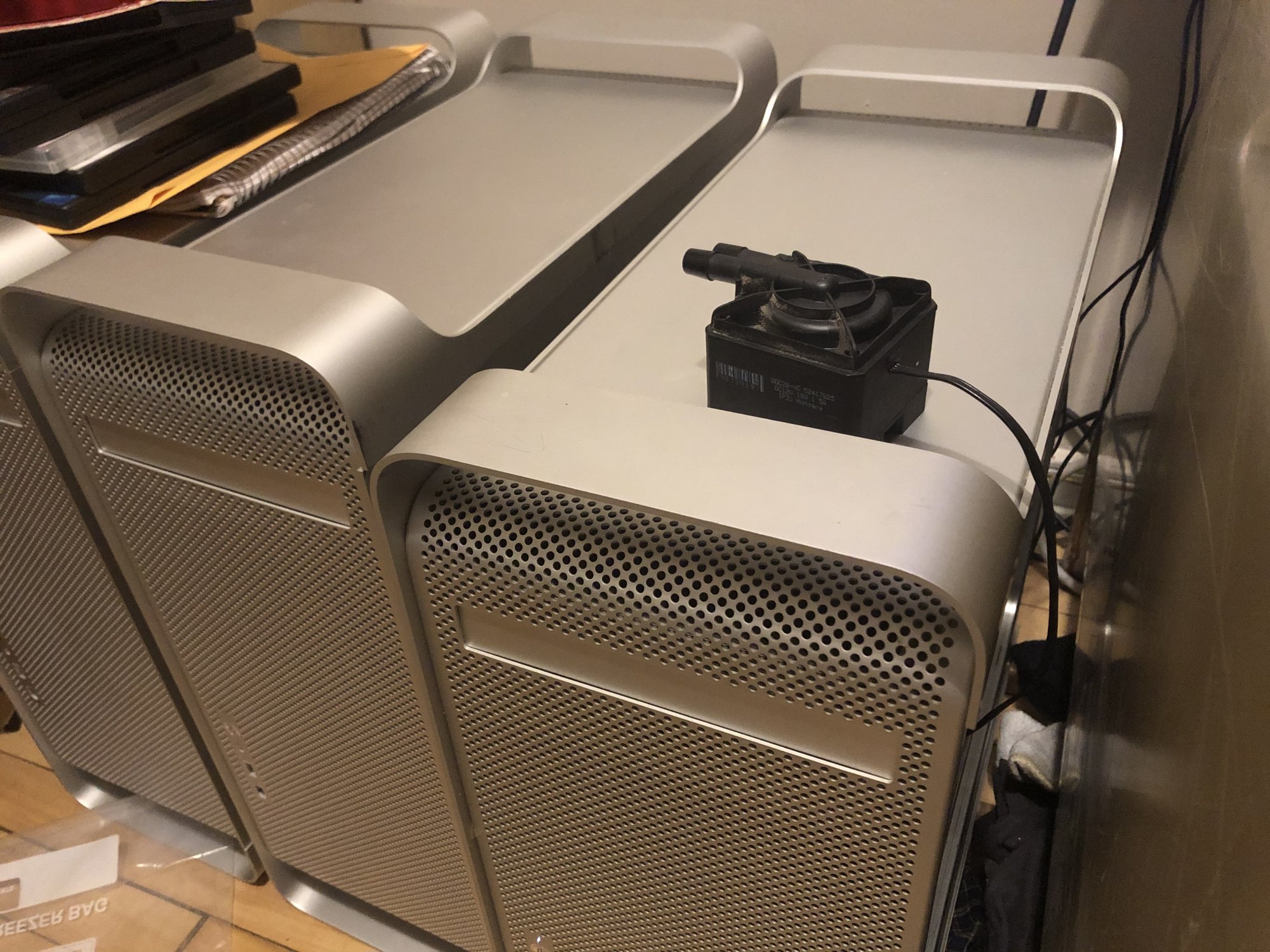

Ok so update! I tried both sets of fans and with the 3 blades in there my temps were indeed slightly worse! My cpu a climbed to 71c and cpu b went to 76c! I reinstalled the 7 blades and did the thermal calibration. Since my old LCS is laying in pieces at my shop I figured I’d experiment and I can now confirm you can just use only the pump to thermal calibrate the machine it doesn’t need to be under load or anything like that it can just free spin outside the machine.
The end result is a little better but not by much. They do seem to run closer to the same temp but they aren’t really any lower.
