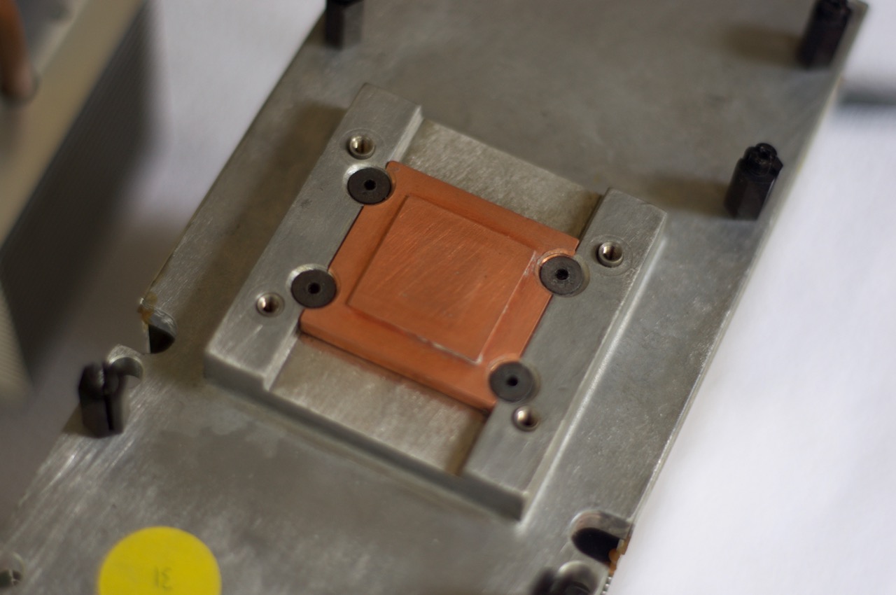

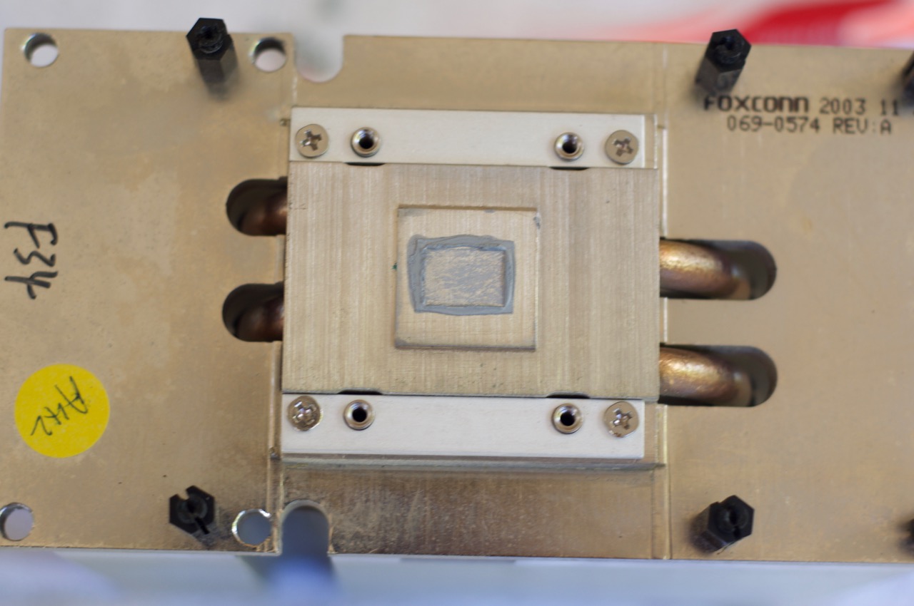

with the older heatsinks there is only a difference with the cold pads where the CPU meets the heatsink. some are magnesium/nickel while others are made of copper. the copper ones being better of course.
copper example:
Magnesium/nickel example:
these heatsinks will work but the fit and finish is not as ideal as cutting down dual core heat sinks. during the G5 line apple did not seem to have a rhyme or reason for doing anything in particular. ideally you would want to see the copper cold pads on the higher clocked CPU's but i have seen copper cold pads on single 1.8ghz units stock and nickel on 2ghz. I have also seen the close quarters heat pipes (2.0ghz dual core supposedly) heat sink on 2.3ghz Dual core chips stock. So unfortunately it’s a real gamble which heat sink you are going to get until you take it apart. Apple must have had alot of parts lying around and just used what they could when they could.

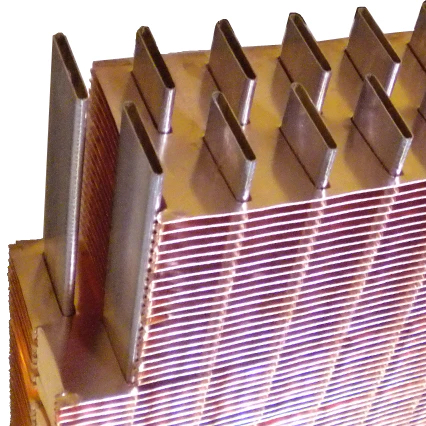

To our machinist: invariably in car cooling components it is taken for granted that tubular radiators are vastly inferior to flattened ovoid pipes. Flat pipes allow more air flow while exposing more surface of the pipes to air. The benefits are substantial. Your cross-sectional obstruction to flow is significantly less and thus allows a greater volume of air at sustained velocity and laminar adhesion (less turbulence). I can imagine that by flattening your copper through the fin stack you would need fewer RPM's to maintain the same or even better temps. Use of a rolling mill would be preferred if the copper is merely solid. You could use thinner copper cores and have equal surface area to your current tubes once flattened.
Photo here shows hollow pipe but the principle is the same for solid pipes.

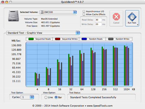

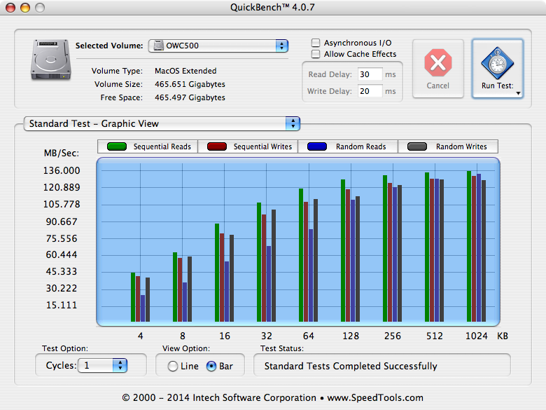

Matches my result 135 MB/s
SATA I max is 150 MB/s without accounting for overhead (1.5 Gbps * 8b/10b) so 135 MB/s is reasonable.
Reactions: Amethyst1
Perhaps there is some loss when switching to different interfaces in these drives. All I can do is speculate and show test results. Here they are in my Mac Pro with in-built SATA II.

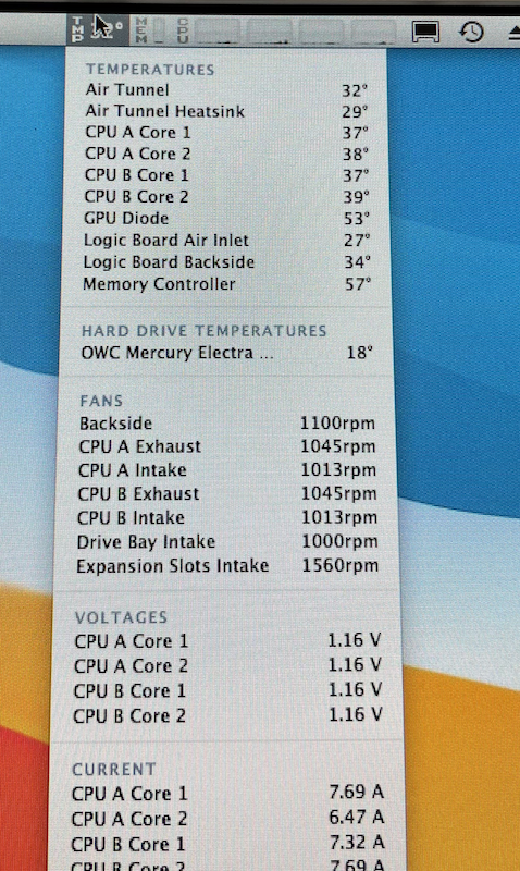

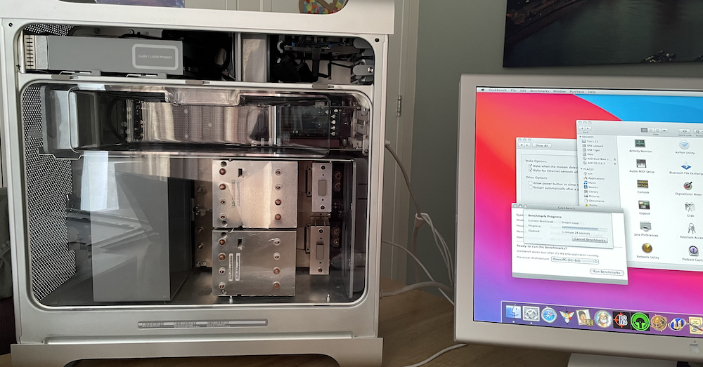

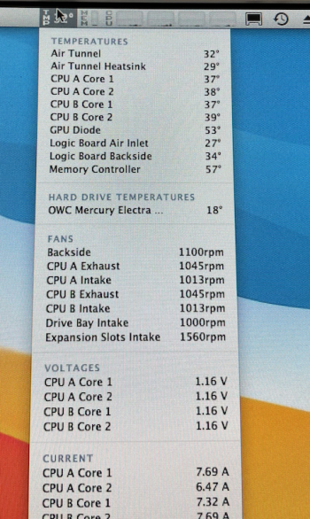

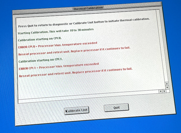

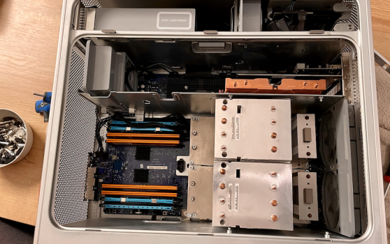

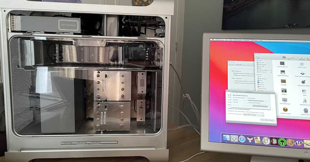

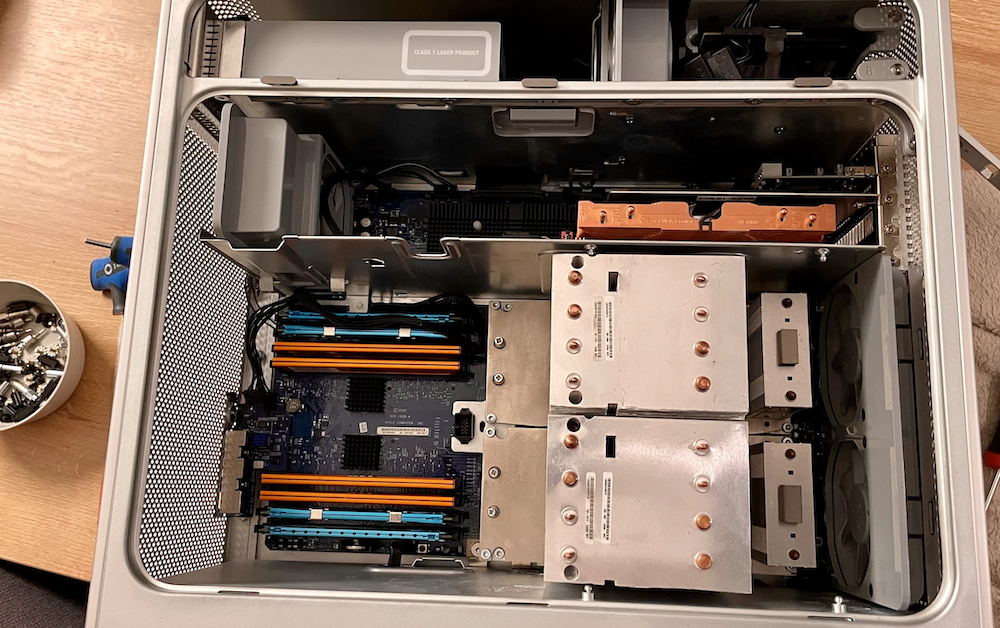

I need some advice! 🙂 I've done the same conversion on my Quad G5 with 2 of the better air-cooled heatsinks. However, the machine is not passing thermal calibration (gives me a Max temp exceeded on both CPUs). In OSX it seems to run perfectly fine and stable. When pushed the temps are a little on the high side; Idle hovers around 37-42c (with automatic mode). When I push it with a couple of Geekbench tests or games the performance is great but the fans are full speed (3000-3200 RPM) around 65c with peaks of up to 76-77c. I've used fresh Noctua thermal paste and generally the air cooled setup seems fine (I went the hacksaw route so the heatsinks aren't as clean as a laser cut... but they generally fit well and look ok'ish). Any ideas to make my Quad run a bit better to pass the thermals? What temp do I need to get rid of the warning and is my Quad fine for use without the calibration?
