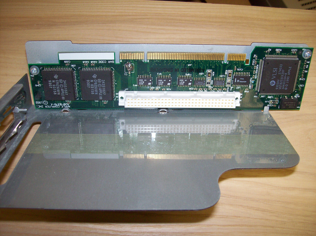

"The Macintosh Centris 610 computer uses an AMP type 650231-5 connector for PDS cards; the Macintosh Centris 660AV uses an AMP type 650231-3 connector. Because the corresponding pins are aligned, it is possible to design PDS cards that work on both models."

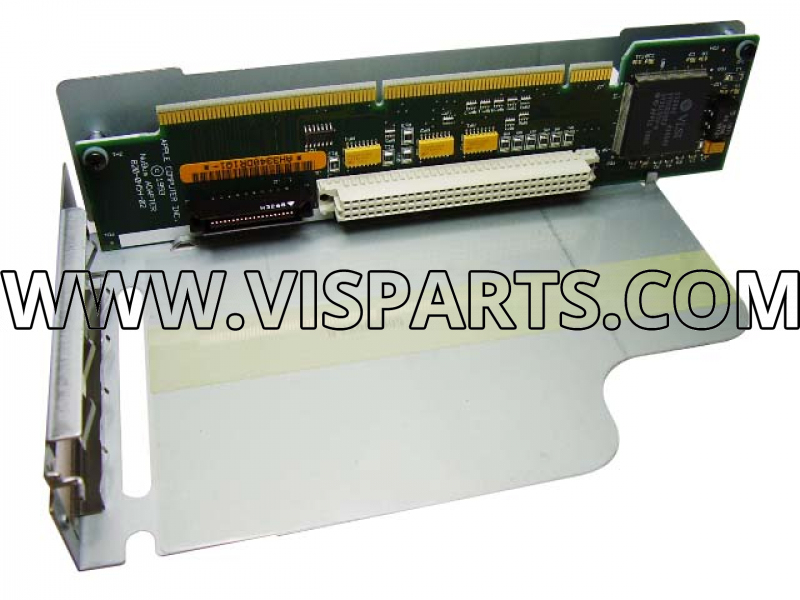

5. Again, the physical shape of a Q610 adapter looks like it could be plugged into a Q660av PDS slot. It seems like the additional pins on the Q660av adapter are used to connect the DSP connector. I mean, what could be the point to have this white notch on the Q610 adapter if not to mimic the lenght of a Q660av PDS slot?
So yeah, I am about 90% sure that could work, but since I don't want to risk toasting anything, I am here to ask if any of you actually tried something like that? I am unaware of a Q660av PDS to 040 PDS adapter, so that kinda rules out the possibility people turned their Q660av's into DOS COmpatibles using something other than the adapter straight from the Q610, am I right?
