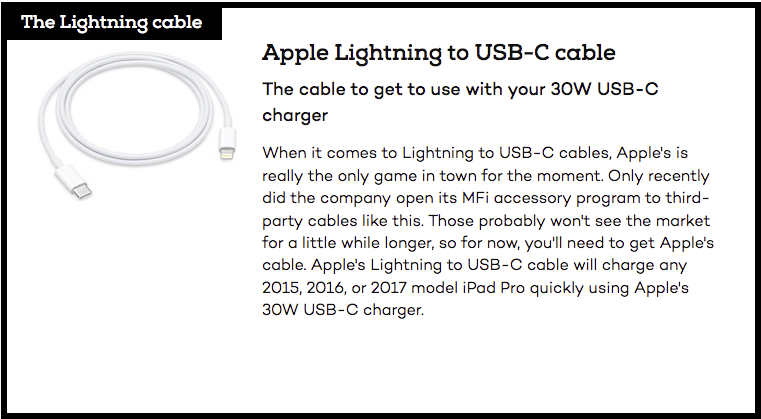

I ask because I read the following here:
USB-C carries more power than USB-A. USB-C standard (3.1) can delivery up to 240W which USB-A can only deliver up to 7.5W using USB 3.2 Gen2.
So in other words, to take advantage of more power delivery for faster charging, you have to use USB-C.
As per differences in USB cables, I would stick to the Apple-branded Lightning to USB-C.

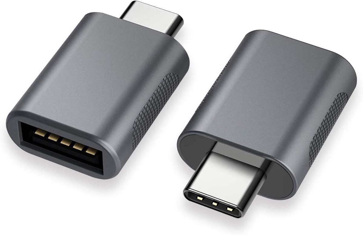

I see. So there's no way around it (by for instance using a USB-A to USB-C adapter so I can continue to use my USB-A to Lightning cables)?

Using adapters will not help as the charge speed will be limited to the slowest charge standard in the chain.

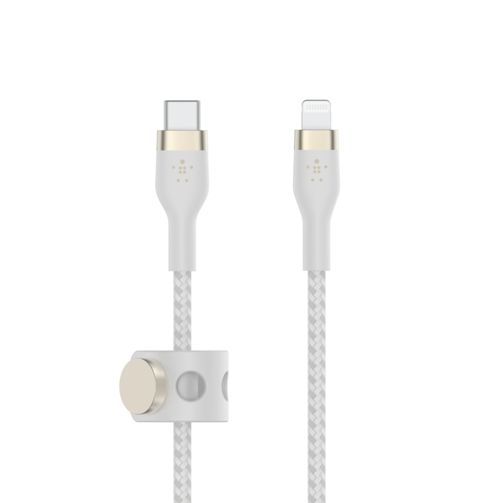

I've done a bit of reading on the subject and found out that the most important thing to look out for when buying non-Apple branded stuff is that it should be a reputable brand with "MFI certification" ("Made For iPad"/"Made For iPhone") meaning the product in question had actually been approved by Apple so it meets their specs.
That said I've found some braided cables from Belkin that should outlast Apple's cables and at a lower cost as well, so I think i'm going for that.
