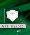

whenever i try loading the att file onto my phone it wont click because it downloaded as a bundle. its unzipped and i changed the format to ipcc. help? below is a pic of the bundle-file-thing
If on a mac you need to right click the file - click get info - hit the triangle next to Name & extentsion - take the .zip out there you go. (this is the zip file that may get placed in trash just move it to another location)
Try following these instructions: http://reviews.cnet.com/8301-19512_7-10265889-233.html?tag=TOCmoreStories.0
The carrier files are from gizmodo and come as a .dmg file.
