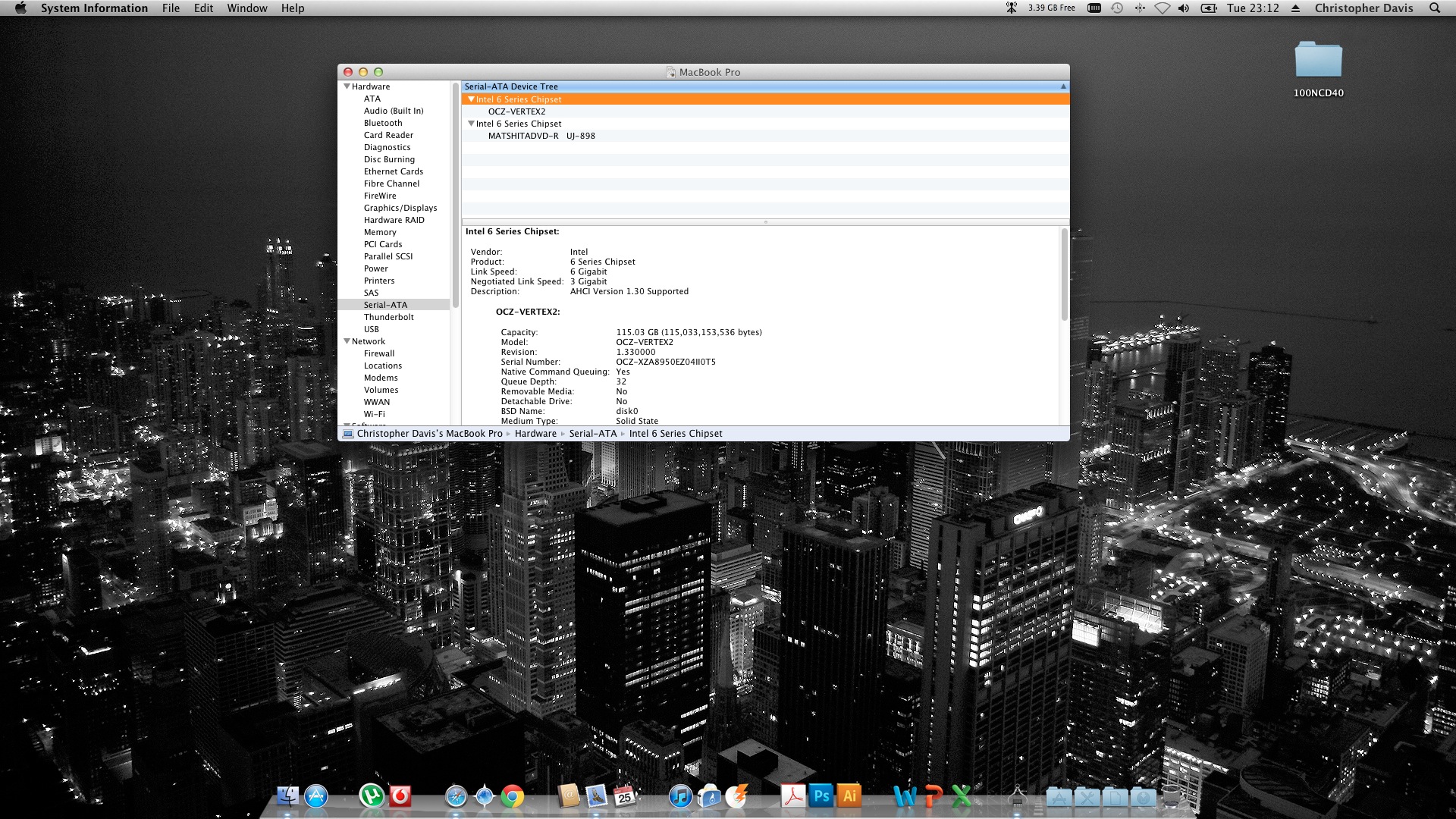

13" never had the issue of a SATA 2 in the optical that I can find..mine doesn't thats for sure. The early 15" had that problem
http://www.amazon.com/Drive-Unibody...placement/dp/B0058AH2US/ref=pd_ecc_rvi_cart_4
I bought that and I have it installed...its amazing! Quality is unbelievable! It was easy to install as well. I have a 2010 13" MBP with dual 250GB HDD's and 6GB's of RAM. I'm planning on putting an SSD in the main bay when I get the funds...I have a WD 1TB external USB 2.5" HDD but its the new model where there is pretty much no way to hook it up to a SATA link 😡😡
Again put the SSD in the optical...
Optical bay = SATA II = slow speeds
Main HDD bay = SATA III (2011 models only) = faster speeds depending on SSD supporting SATA 3 connection.
again 2011 has SATA 3 in both ODD and HDD..
Are you sure? I wasn't aware of that.. Anand didn't mention that the new MacBook Pro's use SATA III in the optibay, or so I think. I might be mistaken, could you provide a source or link that confirms this?
Early ones don't, newer ones do. You need to check your system profiler to be sure. Eg, I don't.
Either way, I think only the 13" 2011 MBP has a reliable enough SATA 3 port on the Superdrive to use this for the SSD. 15" and 17" are a no-go, according to OWC's tests. Unless there's more recent post-Firmware update tests that say otherwise.
2010 model is obviously another story, as it only has SATA 2.0, assumedly in both main and secondary bays.
