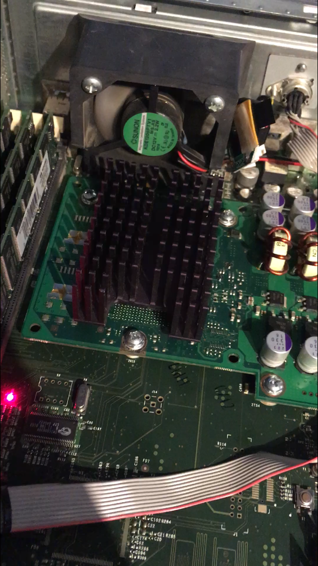

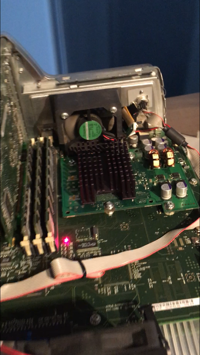

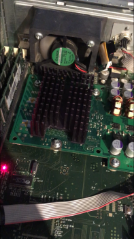

Anyways, with the help of a regular here on the forums we where able to diagnose the CPU card being at fault. Sadly it is the 1ghz Dual Processor card that is to blame.. I now thanks again to this kind person have a 800Mhz card for it, and rigged up a heatsink that I believe is from a old Pentium 2 era PC just to test it and it worked, as the DP heatsink is much too large. The other issue is the case fan, located at the bottom of the PC is cracked and was very loud and therefore unplugged, and for now I have put back the dead 1ghz DP card back in it..
What I would like some feedback on is how can I mount the heatsink that I have or possibly a different one securely onto the machine? The way you see it below had temps monitored and they sat around a high 30 to a low 40c and only shot up past 50 slightly when I launched a windows 2000 virtual machine on it.... I was thinking just doing zip ties but fear the heat might melt them..

I'd go with 4 sturdy black zip ties for the heat sink. I have zip ties holding a fan onto the heatsink of the GF2MX on my QS and they work like a champ. I wouldnt worry about heat as common plastics melt at 100C. You're nowhere near that.
The reason why I say four & not two zip ties is because IME they mount better. Using 2 on each side gives you 2 right angles that will snug up well to the edge of the daughter card and not spin where as if you use just one and go around it like a circle, the zip tie does not snug up as well and does tend to spin allowing your hillbilly heatsink to slide around.
