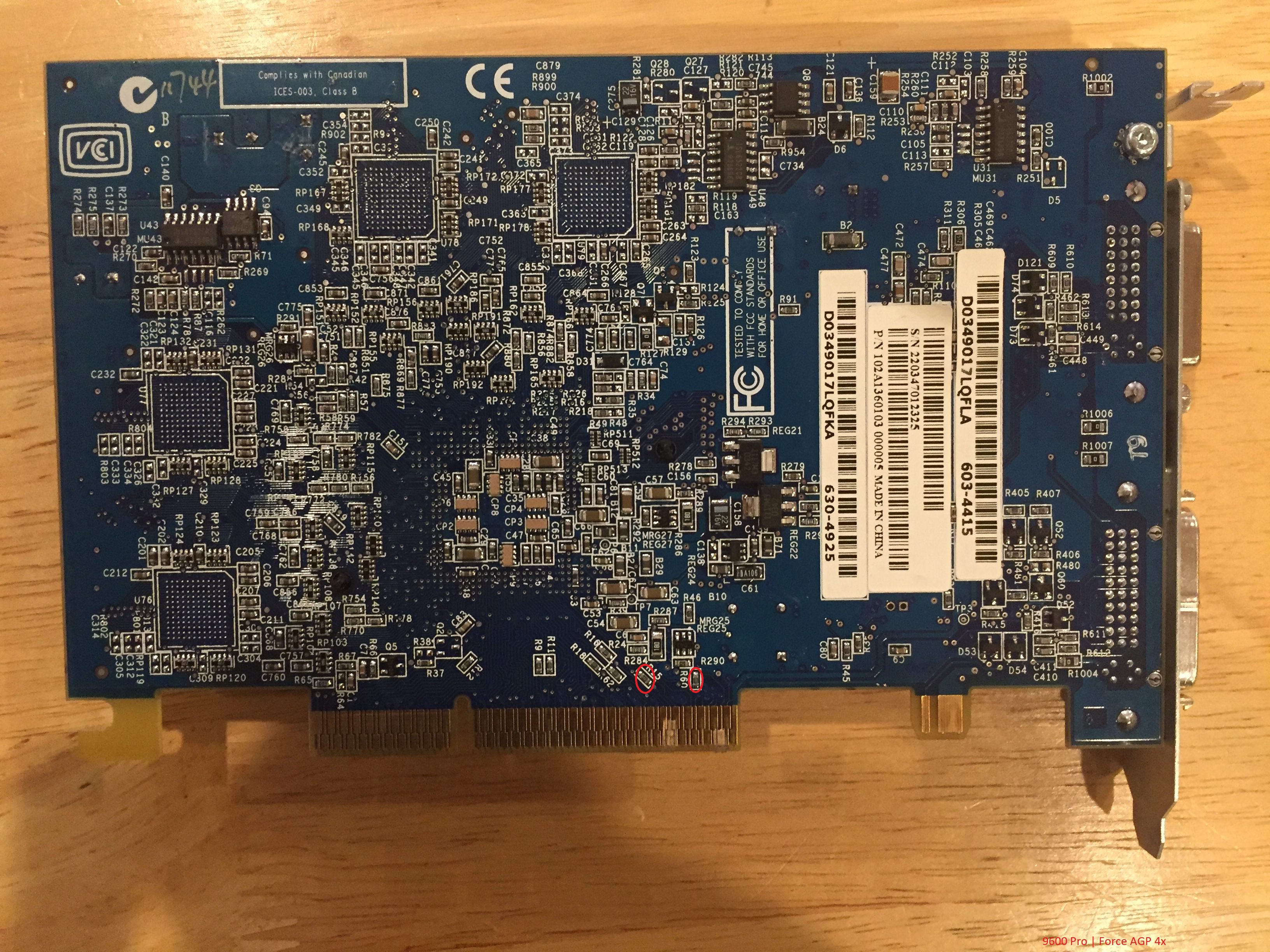

I just got an ATI Radeon 9600 Pro off eBay, and it’s having some trouble working with my Power Mac G4 Digital Audio. I taped pins 3 & 11 to make the card work at 4x, but I still get a black screen. I am able to VNC into the Mac, so I checked System Profiler, which says that no cards are present. I’ve looked around and found that some cards have an incompatible ROM, though I think it only affects display output and not detection. I already have Graphiccelerator to flash it as well as a version 120 ROM, but I can’t do anything with them without seeing the card on the system. I don’t have access to any other desktop systems, so I can’t use a compatible Mac to flash it, though I do have Linux installed, so that might be able to see and flash it. Any ideas?

It's an OEM 9600 Pro for Mac with 64 MB of VRAM. It has model numbers 603-4415 and 630-4925 on the back.

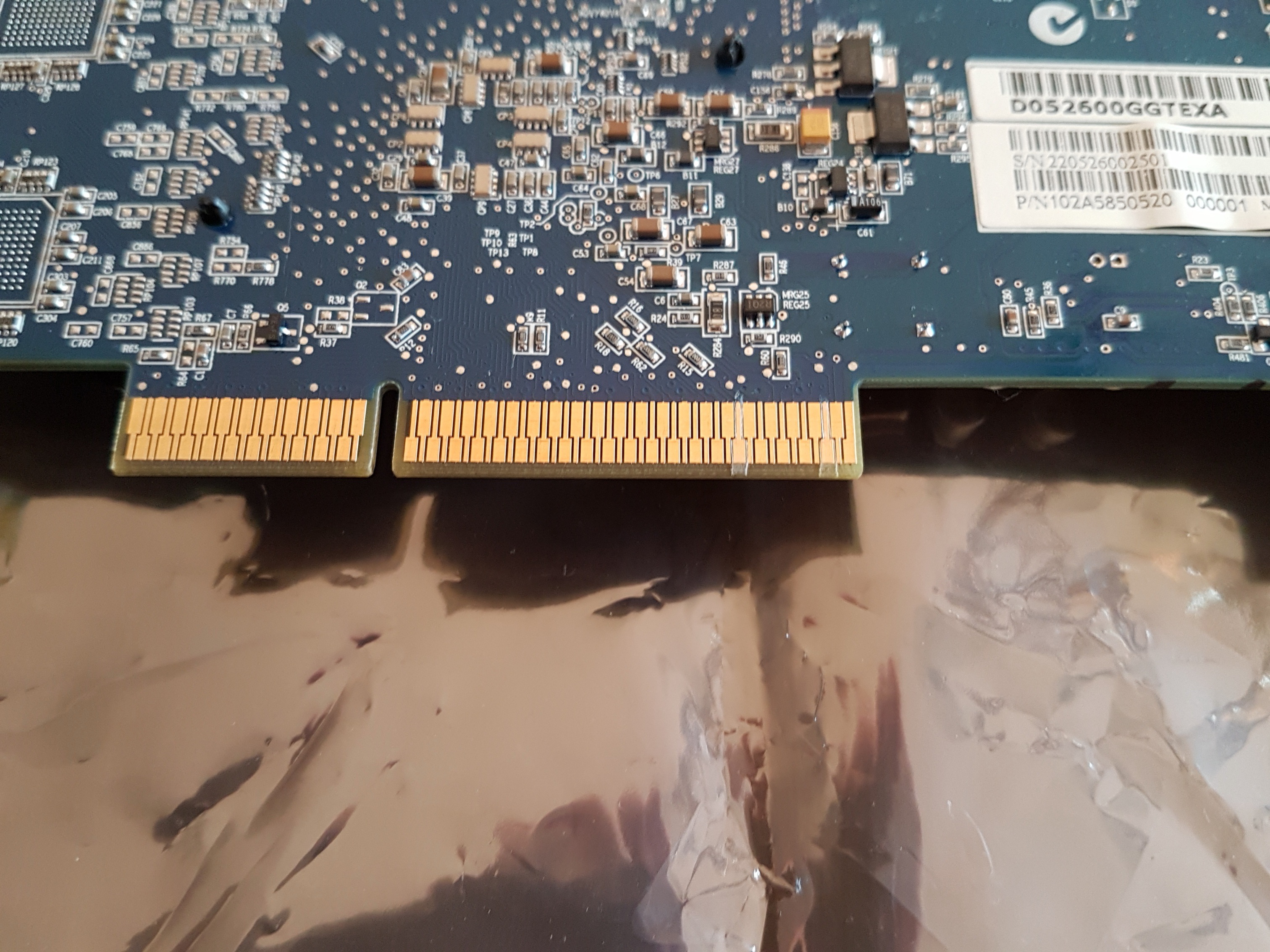

From the photos you provided you should definitely cover the pins properly before investigating. The whole pin should be covered neatly by tape. Here's one of my cards as an example (also a 9600)
This was done by applying a scotchtape strip first, then cutting where desired with a cardboard blade and removing the superfluous parts. You should never cut horizontally, nor tape anything above the pin. I'm having a hard time describing the procedure. I've forgotten the url I had that explained it perfectly with pictures. http://themacelite.wikidot.com/pins-3-and-11 also has resources on this but the taping photo is gone and there's no description
You shouldn't have any trouble with a G5 9600 in a digital audio once pins 3 and 11 are properly masked.

I retaped it following your instructions, but still no signal. I'm going to see if I can find a friend with a newer Power Mac to test if the card even works at all.
Many ATi cards dont need this tape method. It can cause problems like electrical short, a dirty AGP Slot, or a simple malfunction (if you lucky)
For a 9600 Pro -> I recommend removing resistor R15 & R60 on back of the GPU Board to disable Pin 3 & 11 effective.
Here is a picture of yours with resistors inside a red mark. Ofc you can remove that tape after mod 🙂
