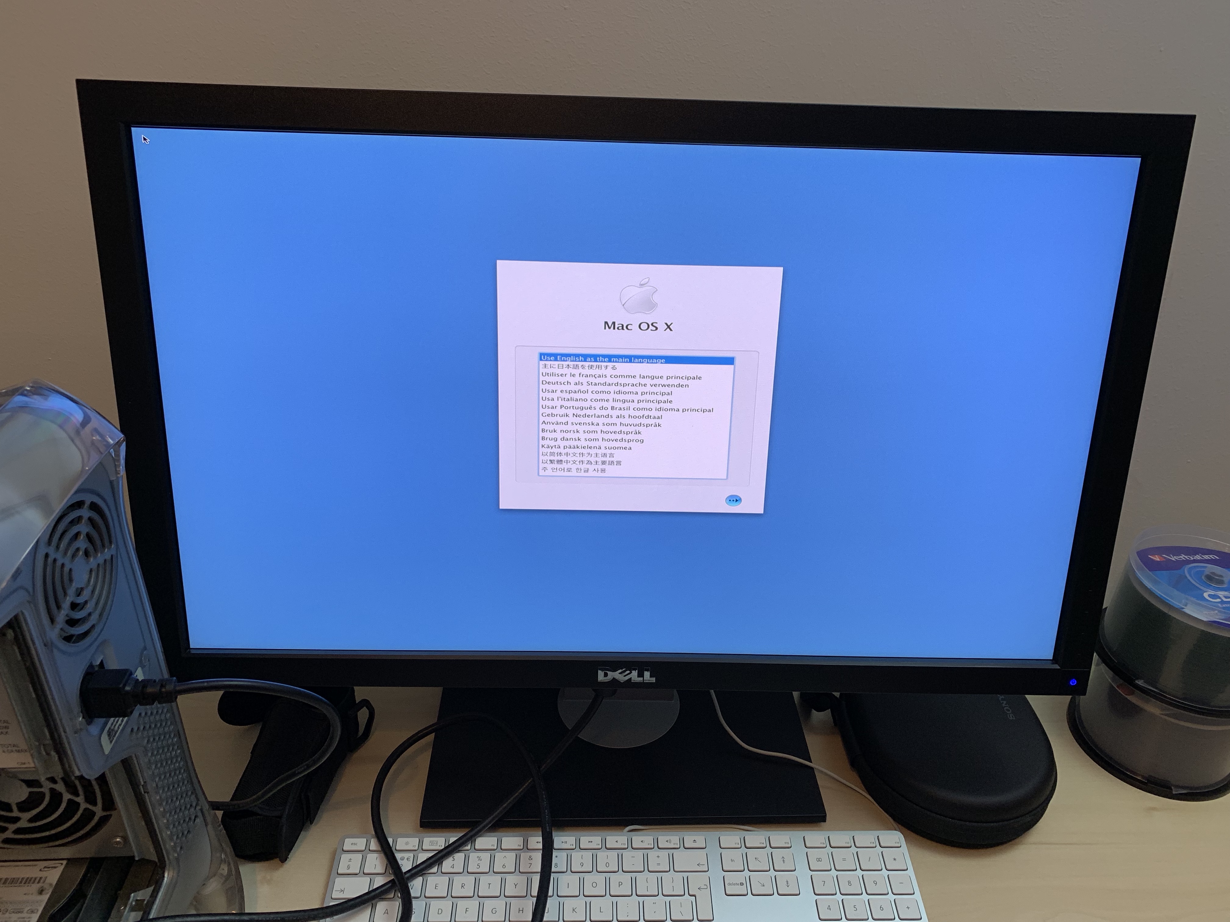

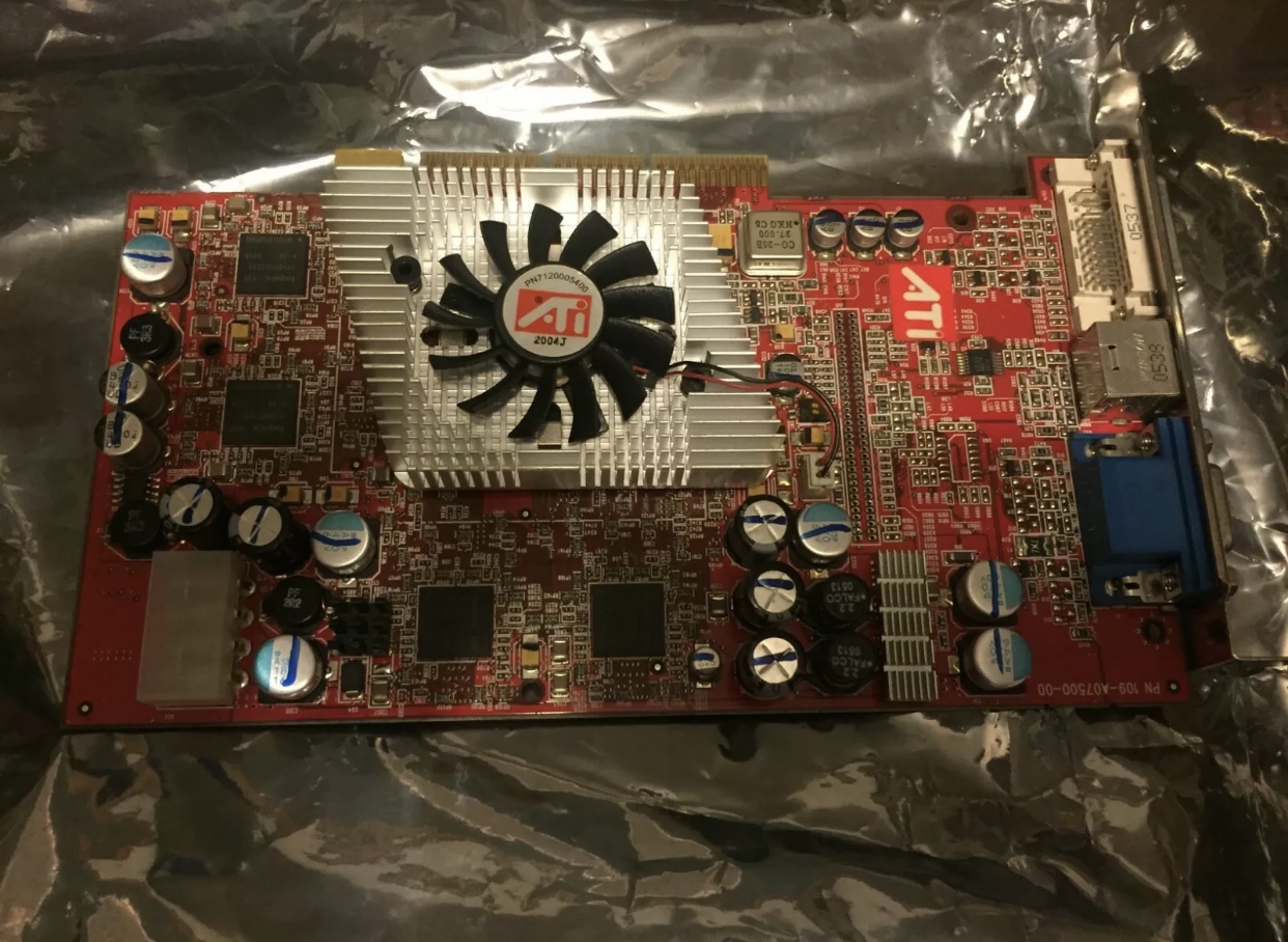

This morning I received what I thought was a genuine Radeon 9800 Pro 256mb Mac Edition. Excited as I would be, I installed it into my Quicksilver. Of course I forgot to plug the power cable into it with the rush, and a symbol appeared on the screen with a flashing power icon to remind me it needed power. So I plugged the molex end into it, fired it back up and it started normally. Showed the grey screen with the Apple logo as normal, but after that it just displayed a blank Aqua blue background, where the login window would also normally appear.
Tried a PRAM reset, button on the logic board, open firmware reset and defaults etc, but it still does the same thing?

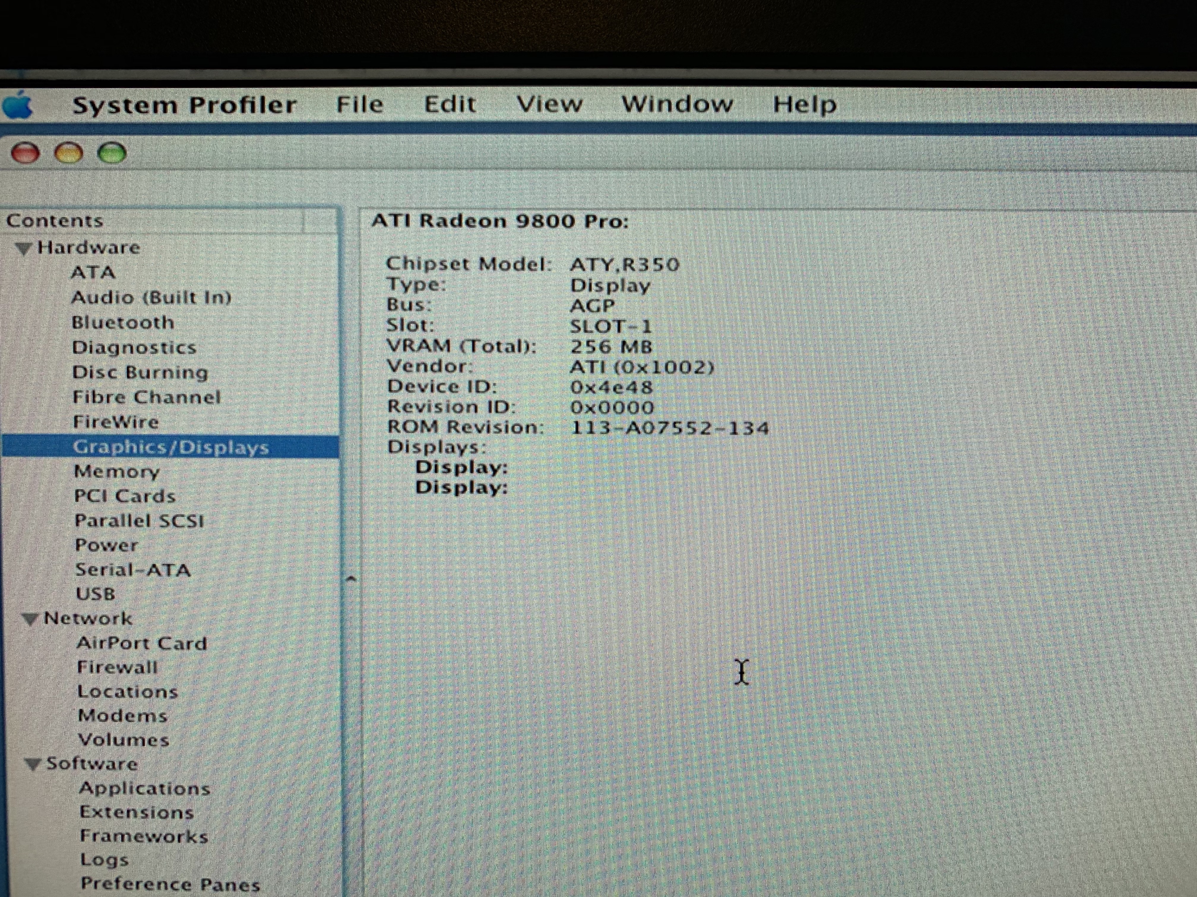

I'm finally back home and can confirm it is indeed a genuine Mac edition card. I can also confirm it shows the boot menu fine, as well as the OS X installer. I plugged the Radeon 9200 out of my G3 in at the same time and powered it on as normal, with the DVI cable in the 9200. It took a while to show the OS X loading screen, but it appeared eventually. Logged in and it recognised both cards. Installed the latest ATI driver for it, shut down, removed the 9200, powered it back on with just the 9800 Pro, and the same thing again; stuck on the blue aqua screen with no log in window.

I’m still stumped. Tried it in my G4 QS and 2 MDD’s and still the exact same issue, and I’ve tried a clean install of OS X on every machine too.

Tried VGA, tried 2 different monitors, clean install of OS X Tiger from my 10.4.6 retail disc, attempted to install Leopard from my 10.5.6 retail disc but the installer won’t even load with the card in, just sticks on another Aqua blue background with the addition of a mouse cursor, tried it in my G4 QS, MDD single 1.0GHz, MDD dual 1.42GHz (on all machines I’ve done a PRAM reset, etc etc, clean install with the same Tiger discs and with Leopard, the same thing mentioned happens on all machines, and all monitor combinations and DVI / VGA tried on all machines too). Not tried Linux, no, but really wanted this card to work under OS X 🙁

I can boot into OS X in safe mode, forgot to mention.
Hmm sadly it sounds like the card is damaged
as in the card will work in basic framebuffer mode but the moment anything 3D loads it falls over and hangs
(normally id expect some sort of artifacting however)

Doesn’t seem to be loading anything beyond that screen, it’s as if the OS just won’t start at all. Hot plugging a monitor does the exact same thing, just the blue screen. Even with the 9200 installed at the same time which it’ll boot with, then unplugging the monitor from that into the 9800, it does the same thing, and then plugging back into the 9200 it’ll take a long while before displaying anything beyond the blue screen again. Said screen shown here.

You can try removing the kexts. The problem with that is that you don't get the full functionality of the card. I have a Radeon X1900 XT in my Quad and it exhibits this behavior. I get the same screen you do or I can only boot so far before the computer becomes unresponsive (mouse still works).
In the past @LightBulbFun has told me it's because the card is overheating and I need to try repasting it. I just haven't gotten around to that.
In any case, if you want to give it a shot - boot into Safe Mode. Go here: Macintosh HD>System>Library>Extensions and find all the kext files that start with ATI. Move them out into a folder on your desktop. Reboot.
If you can get to the login screen this way then that's the conflict. If not, it's something else. But if you do get there just be aware that you have now hosed QuartzExtreme and CoreImage for the card.

Thanks for the suggestion on that. I tried it, and it does boot into the OS without safe mode, but as you mentioned the graphics might as well be in safe mode; everything is choppy, no smoothness of anything, moving windows is laggy etc. Just defeats the object of owning this card really.
Tried installing the drivers again after moving then kext files which didn’t fix the issue, both from the installation disc and the latest versions online. Also tried moving kext files back or by one that may correspond to this card, restarting after each kext move and again, still no success.

On a whim tried the ATI August 2005 firmware update, and the installer for the update says it can’t detect a retail Radeon card, even though this is supposed to be a genuine card. The firmware revision also seems different to that of other users who have this card on the Apple forums. This one being ROM Revision 113-A07552-134, whereas the other users have ROM Revision 113-A14402-126 / 113-A14402-116.
Look for either ATI Displays software, or something called ATI Rom Xtender. I remember that I needed the latter extension when running the retail 9800 on my Mystic, or else it had the same general issues that you're having. I think that the Displays software supplies this extension.
I found some info here- https://discussions.apple.com/thread/1206116
It's for the 9600, but it also applies to the 9800.
