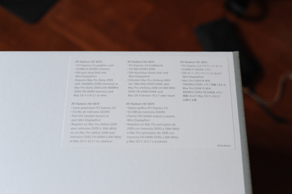

Perhaps it comes with a CD? When the Apple Store first listed the 4870 upgrade kit, it had 10.5.7 as a requirement. Then a whole bunch of articles and threads popped up about the 10.5.7 thing, and Apple quickly changed it to 10.5.6.

Well just got mine in my Early08 MP and Quartz Extreme is not supported w/ 10.5.6. Guess we need 10.5.7 for "official" support. No cd included, and nothing avail other then using the posted driver... I Certainly woul think :apple: would release 10.5.7 tonight or VERY soon 😕

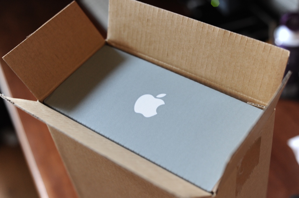

Got it but...
... in a quandary on whether to install or not with the 10.5.7 requirement. Kind of a bummer.... I guess it will 'work' and can use the system in non-accelerated mode but still...

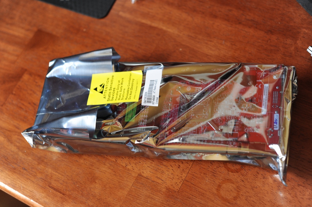

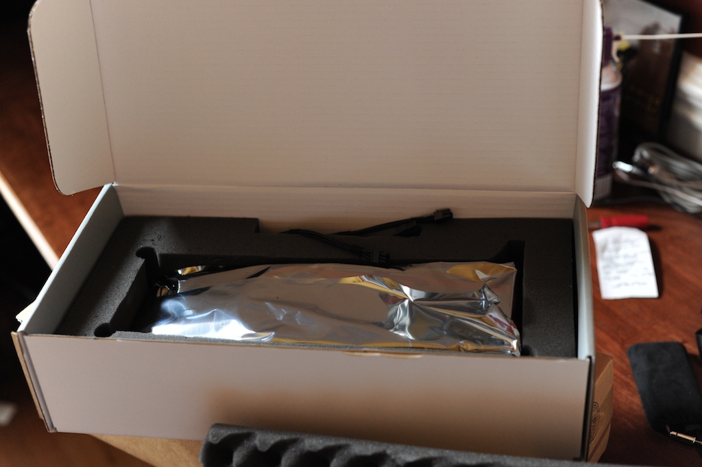

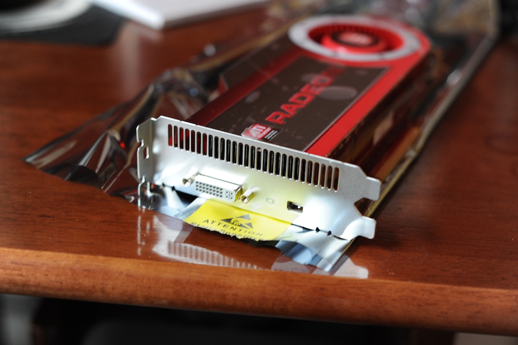

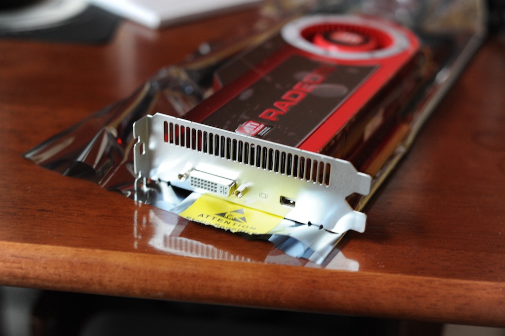

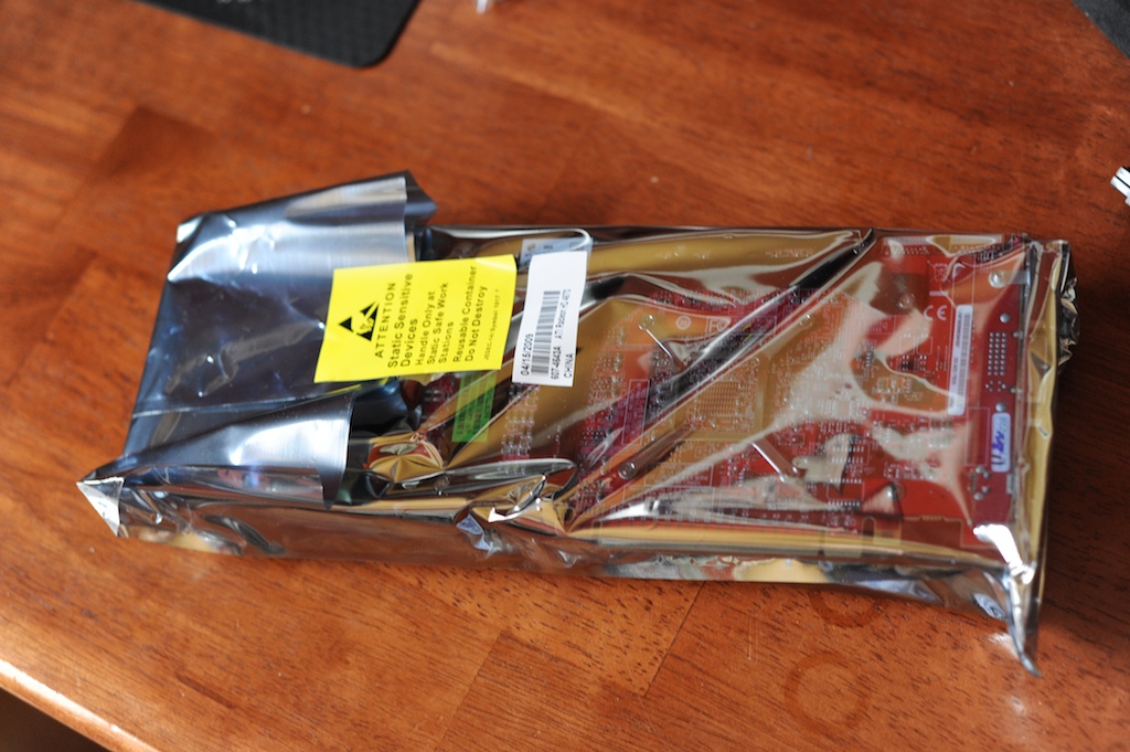

Well, here are some pics anyway, will post more later...

I wish I could find a mini display port to display port cable (or adapter). Would be nice to use that connector on my LCD rather than DVI.
