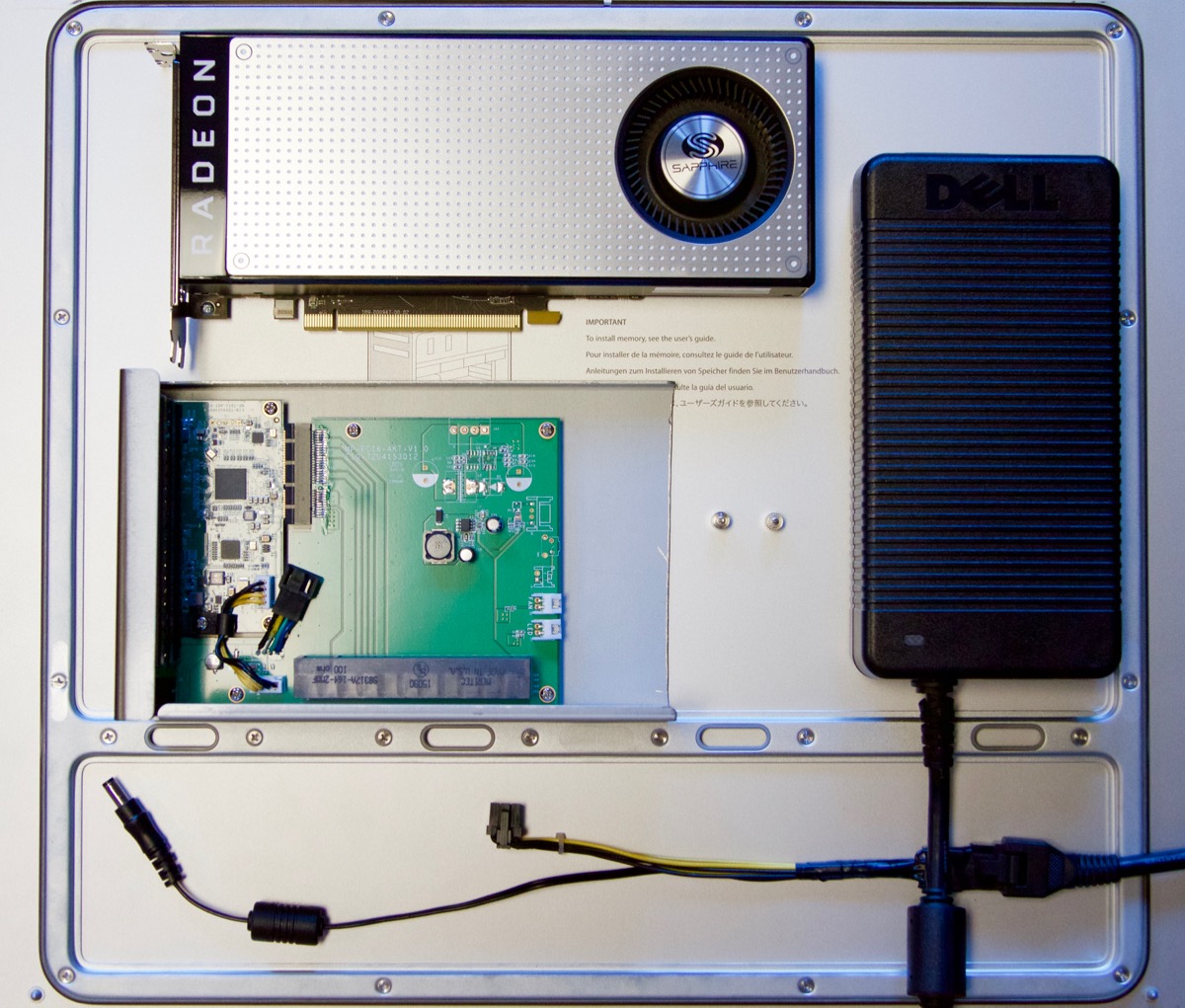

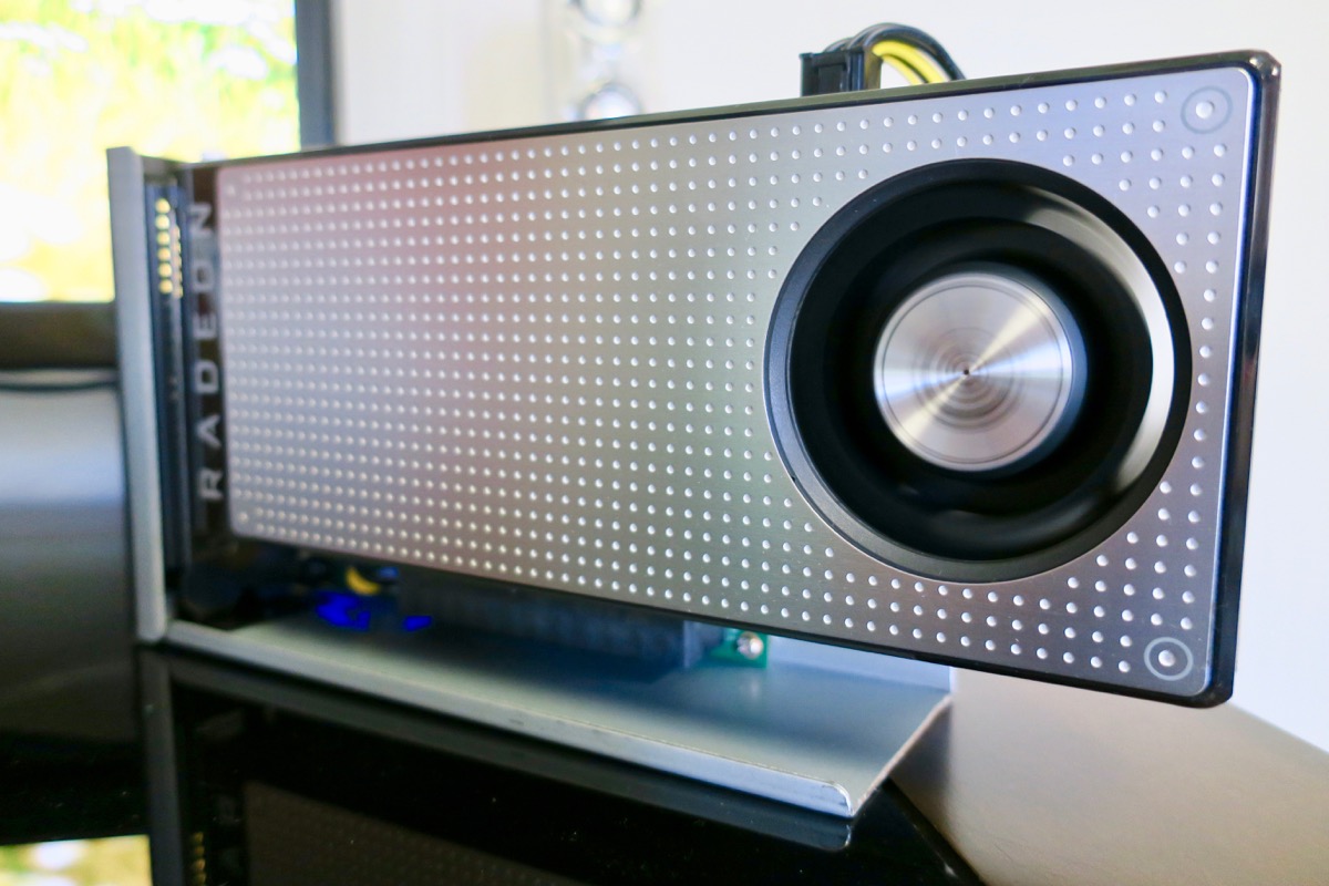

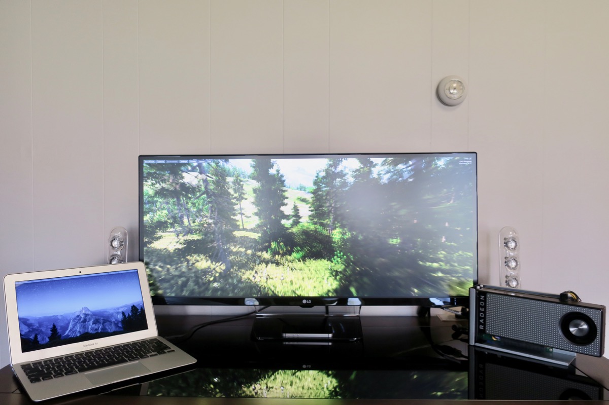

After trying different custom coolers for the RX 480 board, I've decided to stick with the stock cooler and housing. In order for the whole card to fit, I cut off the front part of the inner enclosure.
Honestly it doesn't look bad exposing the GPU this way. This eGPU setup now uses a Sapphire RX 470 with a brushed aluminum front and housing similar to RX 480 reference cooler.

What model power supply did you use? Also, were there any additional hardware mods needed? lou
I've used both a full size ATX 500W PSU and a Dell DA-2 220W power prick. For this RX 470, the DA-2 is more than enough. I cut a barrel plug from an old external hard drive and soldered one end to the PSU. Same thing was done with the 6-pin power cable. This photo shows all the components of this ePGU build.
Is this so you do not have to have 2 power cables? Barrel plug for the AKitio and 6 pin for the Radeon. Correct?
